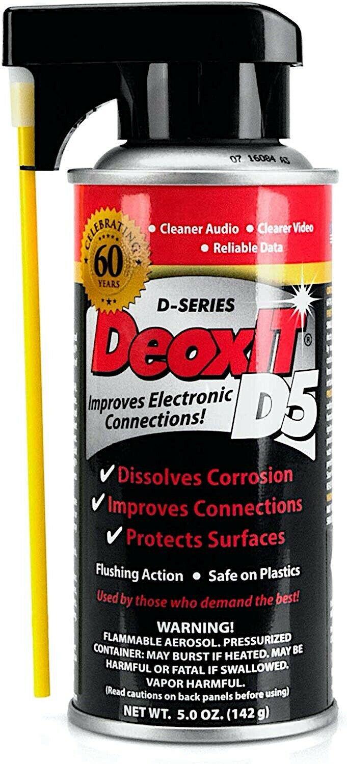

Member Contributer Thumbs Posted July 20, 2020 Member Contributer Posted July 20, 2020 I’ve got a similar problem and bought this to get the contacts clean of oxide/rust ..... I’ll let you know how I get on BTW regular “contact cleaner” is isopropyl alcohol so all it does is wash mud off Quote
Member Contributer AndyE Posted July 20, 2020 Author Member Contributer Posted July 20, 2020 cheers Thumbs, I happen to have a can of iso from my days of cleaning thermal paste off CPU's. Why that never entered my mind I dont know! Quote
