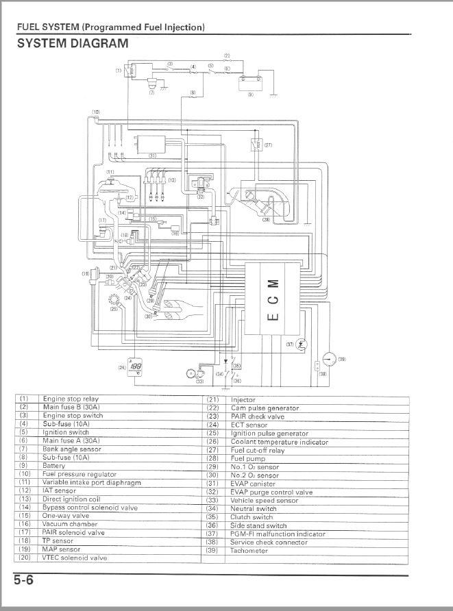

Basic understanding of fuel pumps... the pump doesn't build
pressure... the pressure relief valve (10) builds pressure... if the
pressure relief valve offers no resistance then fuel circulates from
pump back to the tank at 0 psi...

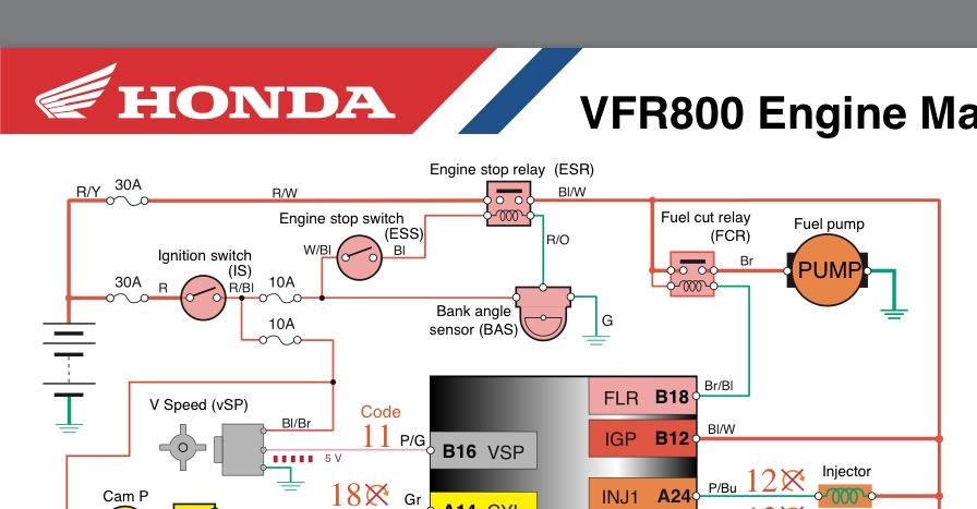

If you've bypassed the Fuel Cut Relay, then it will run continuously. The ECM controls the relay coil switching Ground so if you were not hearing the 2 second prime at switch on (Kill Switch to RUN) with the relay installed then the relay, ECM or wiring could be at fault.
The Service Manual shows how to check the Fuel Pump for flow. I wouldn't assume you have a Fuel Pump issue without checking it's flow first.
Once you're happy with the Fuel Pump and the switch ON prime function is working, but it still doesn't start, then perhaps the Ignition Enable logic for the ECM may need checking, this relies on Neutral and Sidestand switch logic.
With the Fuel Cut Relay installed and listening closely at the relay, Ignition to ON, Kill Switch to RUN, do you hear it click on then off after two seconds? This should happen irrespective of your Fuel Pump status.
This drawing might be easier to see how the Fuel Pump is powered.
Thank you.  I was just so used to the pumps on my other bikes that actually do build pressure.    Not long after posting I thought about the return line and realized my error.
Thank you very much.  I will check some more items.  Sidestand and kill switch are operating normally and Bank Angle Sensor is new..  Don't think I have heard a click, but I will check closer.
