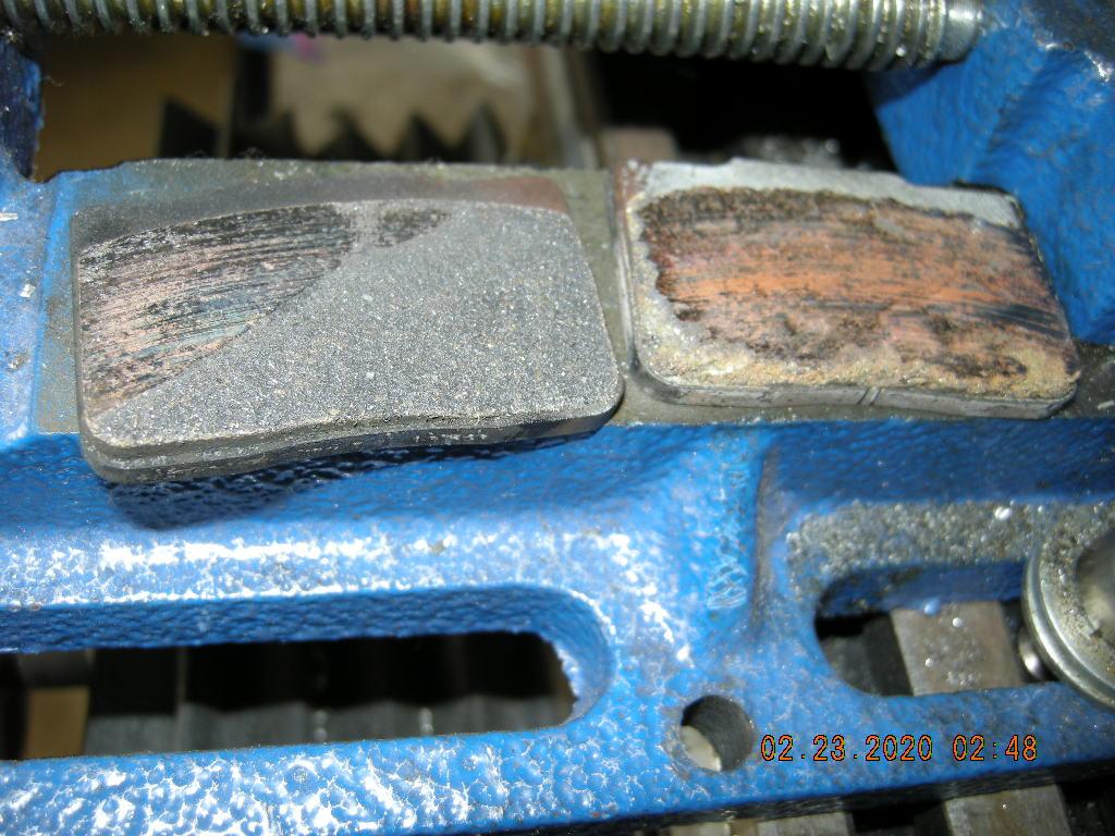

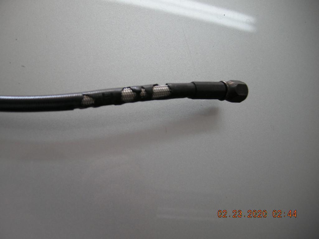

Member Contributer BusyLittleShop Posted May 5, 2020 Member Contributer Posted May 5, 2020 Rear caliper dragging may generate so much heat that it catches on fire... it happened to Marv's 4 pot Brembo on his ZX7R... Quote
