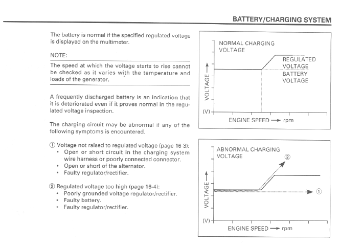

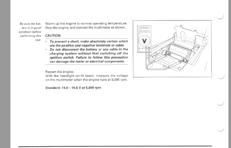

Excerpts from the manual are attached. The voltage should start at whatever the battery is putting out, and then rise up to the regulated voltage as the alternator puts out more and more energy as it spins to higher rpm. If the voltage is dropping back to the battery voltage then that might suggest a failing regulator/rectifier.

I can tell you with confidence that my two bikes with voltmeters fitted show a lower voltage (the battery voltage) at idle (low 13s) and then hit a steady higher voltage (usually around 14.2V) once the revs rise, and then don't change at all with any higher revs. Are you sure you're getting the right info and that the numbers have not been switched around?

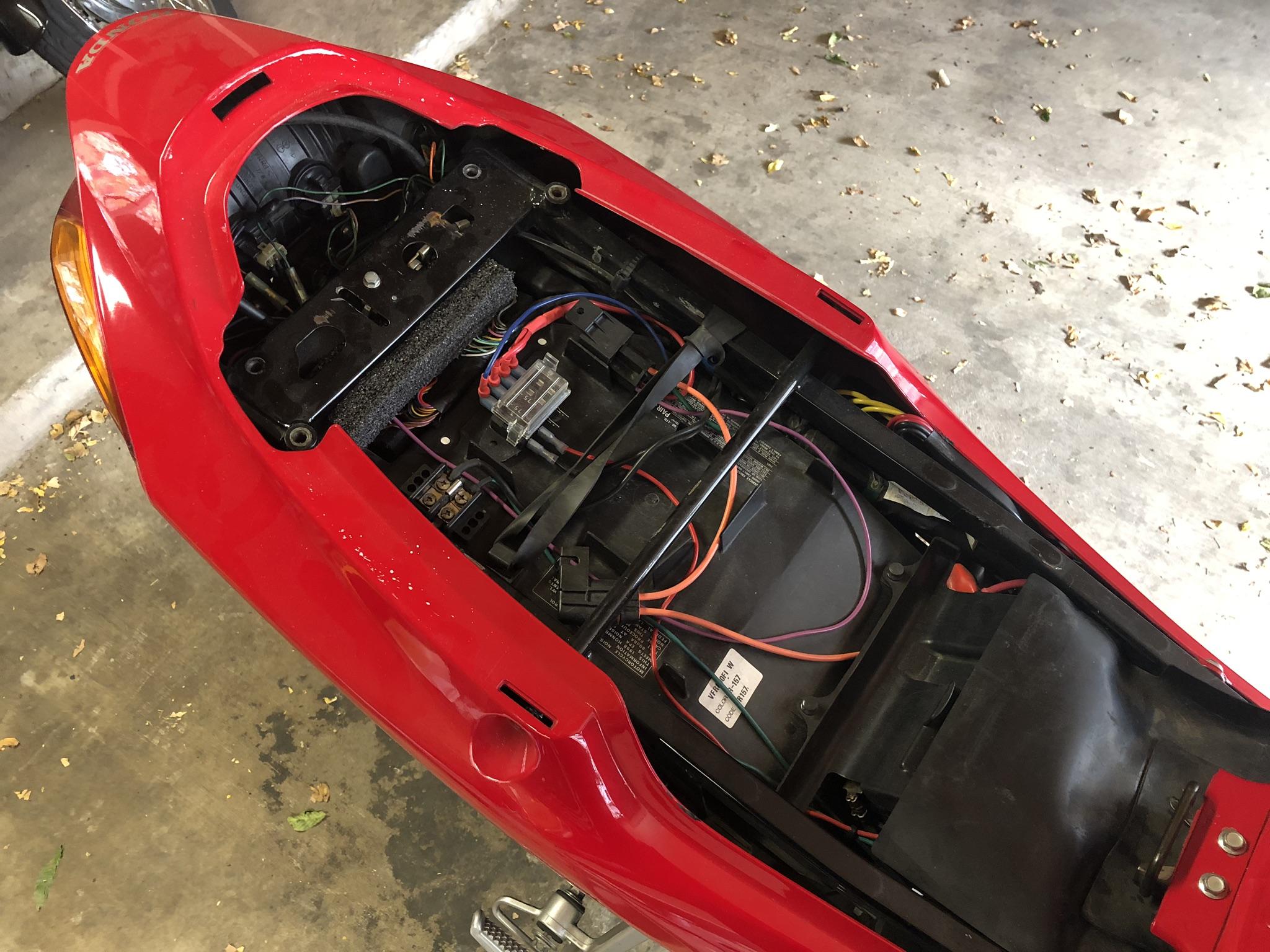

14.5V constant no matter what engine speed. 14.4V when the radiator fan kicks on and high beam. LED lights all around. Wire my bike vfrness, voltmeter, fuse block with grounding block, and Rick's electric reg/rec.IMG_0023.thumb.JPEG.936a849f5fdc5597938b56960098e537.JPEG

That's a very tidy job. Wish my plastic looked that good.
