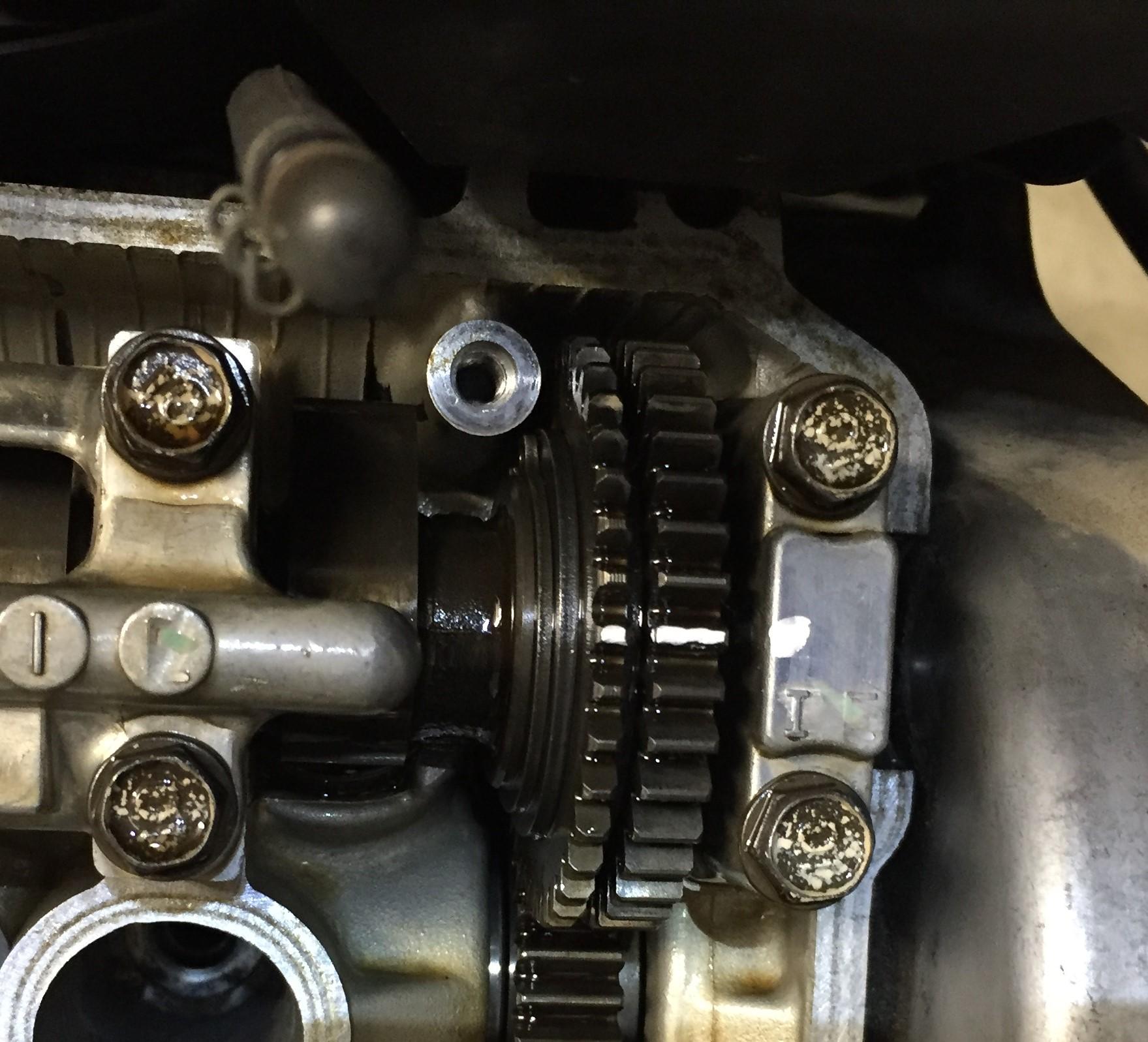

Member Contributer Terry Posted March 12, 2020 Member Contributer Posted March 12, 2020 I just used whiteout on the gears; I also put a matching mark on the cam. The photo is of my ST1100 but the prinicple is the same. You will find on reassembly that the marks will look a little off until you tighten down the cam holder saddles which moves the tension spring within the gear. 1 Quote

Member Contributer Cogswell Posted March 12, 2020 Member Contributer Posted March 12, 2020 29 minutes ago, Terry said: I just used whiteout on the gears; I also put a matching mark on the cam. The photo is of my ST1100 but the prinicple is the same. You will find on reassembly that the marks will look a little off until you tighten down the cam holder saddles which moves the tension spring within the gear. I'm curious if anyone knows (no mention in the FSM I can find) if one loses the reference points on the gears how to find them again. When removed the gears seem virtually impossible to move relative to each other by hand. The gears lining back up as described when tightening things down seems to make it somewhat foolproof - could they "go the wrong direction" and actually loosen the spring tension vs being correct (it doesn't seem so . . . ). I too marked the gears prior to removal but after reassembly I began doubting myself - "did I get that back together correctly??" so just wondering if there is any way of definitively doing it the way Honda did from scratch. Quote
Member Contributer RC36B Posted March 12, 2020 Author Member Contributer Posted March 12, 2020 7 hours ago, Cogswell said: I'm curious if anyone knows (no mention in the FSM I can find) if one loses the reference points on the gears how to find them again The gears are stamped so no problem. Even if you removed all cams and got lost on position, the shop manual have an easy to follow procedure (shop manual 61MZ700 from page 8-21 (Camshaft installation) onwards). Cams have both "marks" (line) and "arrows" - Honda use the "marks" for the rear cylinders and arrows for the front cylinders. 2 Quote

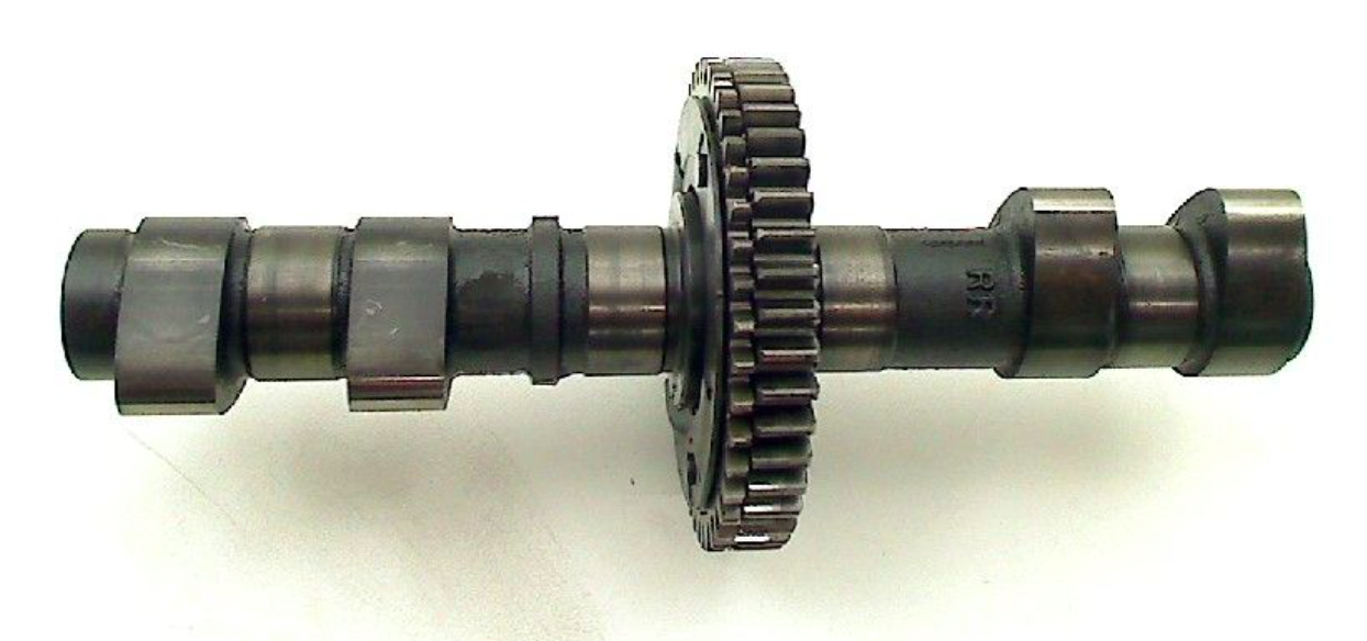

Member Contributer Cogswell Posted March 13, 2020 Member Contributer Posted March 13, 2020 12 hours ago, RC36B said: The gears are stamped so no problem. Even if you removed all cams and got lost on position, the shop manual have an easy to follow procedure (shop manual 61MZ700 from page 8-21 (Camshaft installation) onwards). Cams have both "marks" (line) and "arrows" - Honda use the "marks" for the rear cylinders and arrows for the front cylinders. I wasn't referring to the timing marks - I'm referring to how the narrow and wide gears (photo above) move relative to each other after removal and Honda specs matching the gears back up upon re-installing - nothing to do with timing. I believe it's the smaller gear that is spring tensioned and that needs to be correct relative to the drive gear to eliminate backlash. That's why there are 3 white lines on the photo rather than just 2 . . . AFAIK it's possible to having the timing marks lined up with the heads and crank correctly but not have the two gears lined up correctly relative to each other. It's only briefly mentioned in the FSM, but I can find no detail. Quote
Member Contributer RC36B Posted March 13, 2020 Author Member Contributer Posted March 13, 2020 6 hours ago, Cogswell said: I'm referring to how the narrow and wide gears (photo above) The gears - once removed - will relax in a “neutral” un-tensioned position, which is about half a tooth off. So the answer is “no” - you are imagining a problem which does not exist 😉 So when torqued down Newton's third law takes care of the gears final position. You need to check timing marks AFTER torqued (especially for front cams). If you look at below photo you can see the geometry only will allow for aligning gears in one direction... the gear from the cassette only fits the wide slot. 1 Quote
