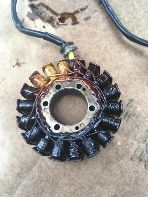

I'm feeling lucky.    Cageless and I must have got the last factory 2002 spec stators left in the world.   I'm not sure I would go through all this to upgrade to a physically larger stator and flywheel if it were me.  I would just rewind the OEM and ride on.   I got 55,000 miles out of mine and it only gave up the ghost on a desperately hot ride across the wastelands of Nebraska.
Cageless' stator (L), my stator (R)

Lee2002 has the one of the most-photographed toasty stators in existence:
Great picture that. Just for info, notice the burnt poles are matched, and the three or four poles that look good are matched, the good poles are at the lowest point and seem to get a good oil flow over them displacing the heat. It's interesting Honda have addressed this problem on the 8gen by installing an oil sprayer for the stator.
It is hard not to when you have a crowd like this watching your every move.....  You would have thought I birthed a baby the way the crowd gathered when that thing was extracted.
Great observations on Grum's part.   There was a reason I clocked those stators the way I did.   There is a lot of information about the 6th gen stator situation in that photo... and every 6th gen roasted stator photo I've ever seen.
