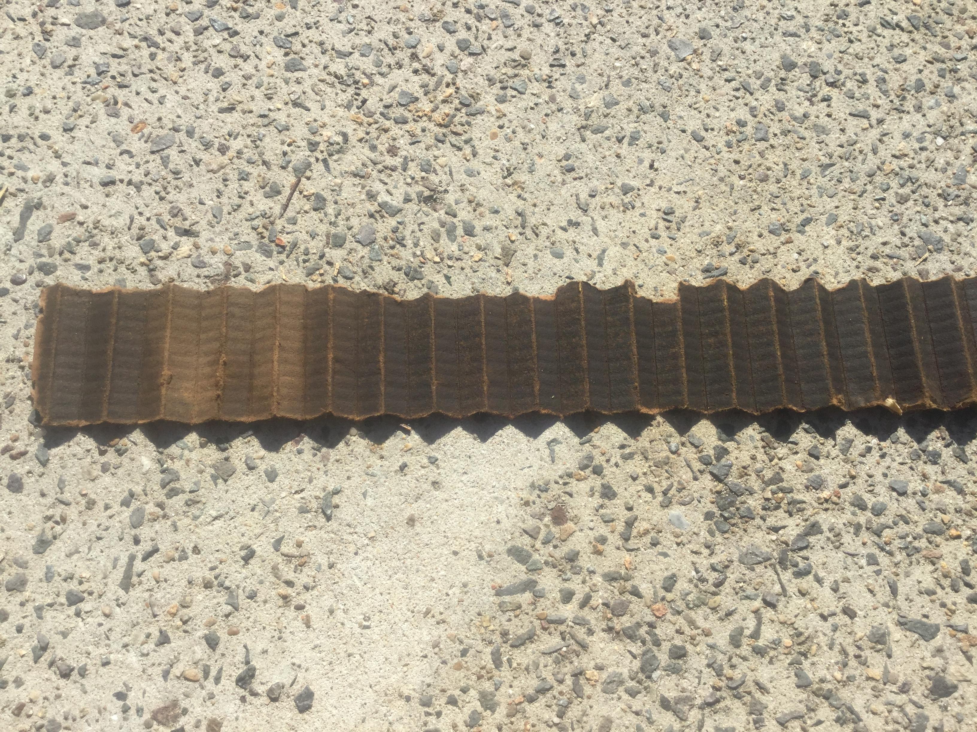

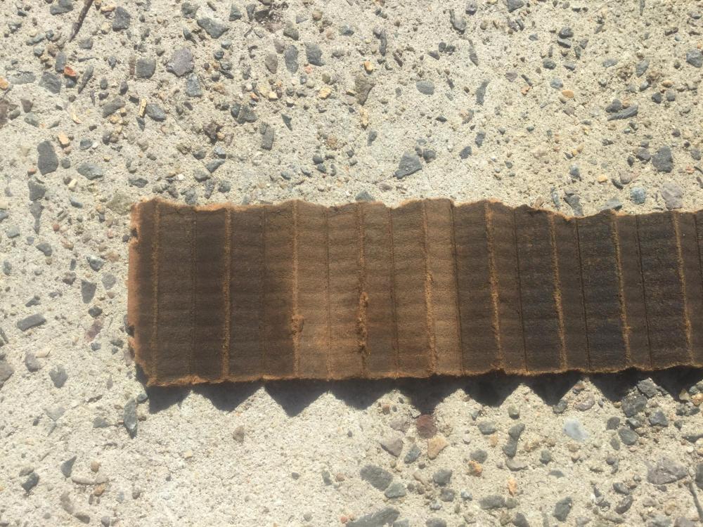

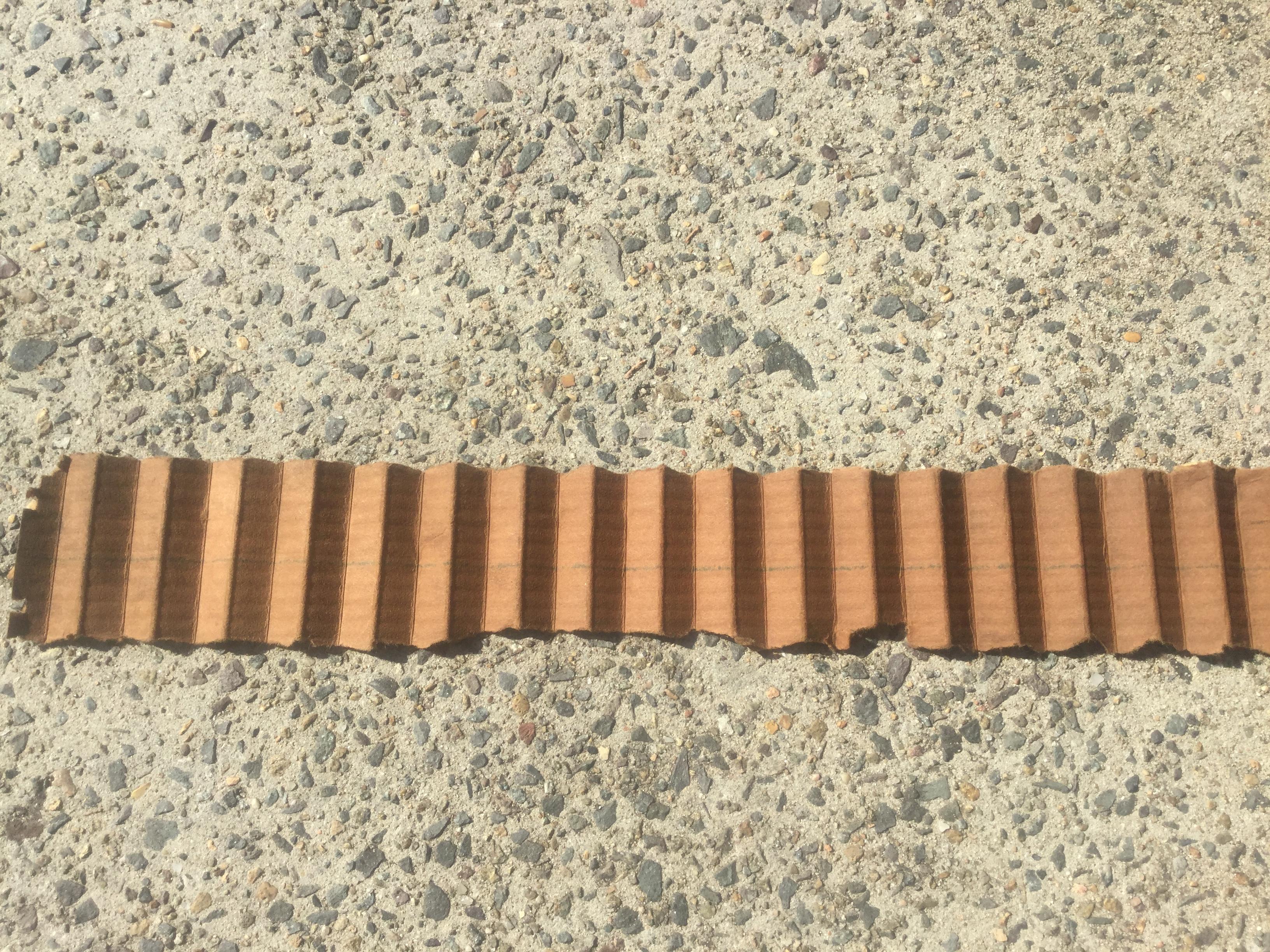

Member Contributer Marooncobra Posted April 21, 2019 Author Member Contributer Posted April 21, 2019 Hi Well I thought I would give you an update to my issue. So I tested the fuel pressure of the fuel pump and that was in spec. I replaced the fuel regulator but got no improvement to the issue. I was then going to go and get the bike dyno tested to see if there was an issue with map or even a fault with my PC 3 USB as it is subject to vibration under the seat but decided to first replace the fuel filter in the tank. On replacing this item my woes have gone including an annoying vibration that used to come in around 4500 rpm. After coming back off the ride with a big smile on my face I decided to get the filter out of the bin and rip it open to look at the filter. Now you have to understand that my VFR is a 2002 model with only 61,000 km (38,125 miles) on it and I have put the last 6,000 km (3,750 miles) on it since I purchased it in 2016 meaning on average the bike has annually only covered 3,500 km (2,187 miles) a year. I don’t think this filter has ever been changed in 17 years. On ripping the filter can open I didn’t find any debris but once I opened up the pleated paper I could see the issue. The filter paper, dirty side, was covered in brown lacquer. The clean side had no lacquer build up at all. I actually got an airline to blow through from the clean side to the dirty side and it Hardly made any difference. Dirty side of filter. You see the area I used an airline on to try and see how dirty it was clean side Close up of area where I tried to clean with the airline. If anyone conducts this filter change don’t bother buying the pre filter as it is just an aluminium scouring pad that I could have bought from Woolworths for $0.99 cents. Not Honda’s cost of $15.00!!!!! 3 Quote
