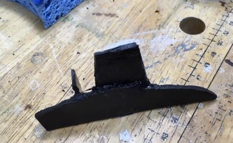

Man! I thought this thing was ugly on the outside! Every single piece of plastic on it is damaged in some way. No foolin. This job has been taking me waaaay longer than I'd anticipated. Rats. I am missing some good riding weather this weekend.
I've been proceeding with the ABS weld process rather than Leon's superglue or Snowman's Plastex. But I have both those in my head as backup. My ABS plumber's goo seems to be doing the job. One difficulty I'm having is that a previous owner used bondo in places. It's crumbling and detaching. Important tip: bondo is not the repair of choice for ABS. What a pain. I have to clean it out as best I can and rebuild around it.

If you knew the answer as d, then you have some idea what I'm doing this weekend. The piece took me easily an hour to make. It's actually cut more or less to size. Custom made for this gap here, on the right mid fairing:
I made a reinforcing tab on the back to try to stabilize it. The thing won't be anywhere near invisible, but I'm hoping to make it presentable once sanded and painted. In any case, it'll beat a big hole in the fairing.
This is the kind of thing I'm doing that's slowing me down. And don't even get me started on the front blinker surrounds. 😒

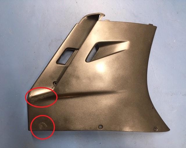

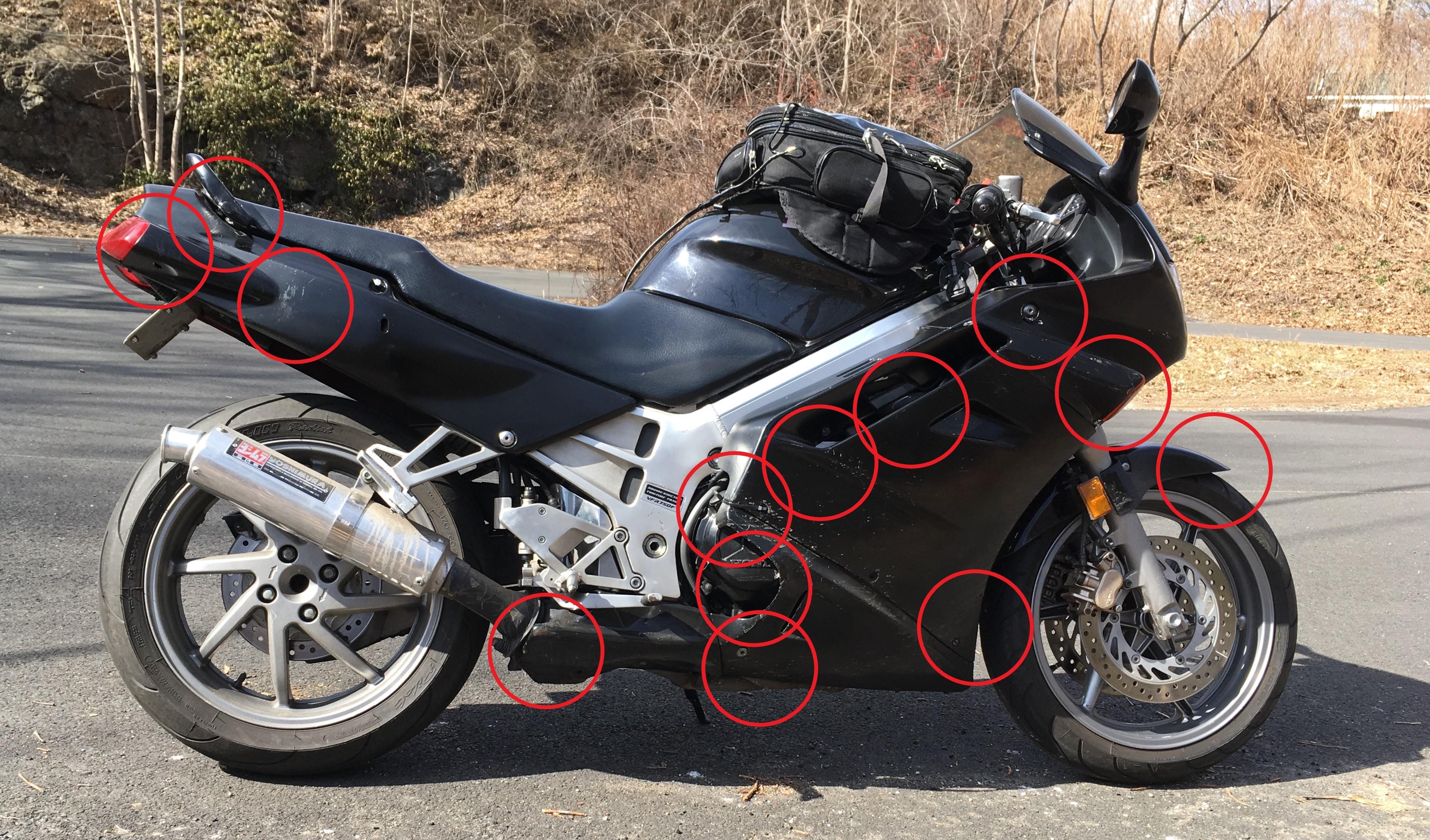

I'll go through a couple problem areas for anybody interested.
Problem areas.
Here’s the partial list. It’s a pretty long list.
Mid fairing

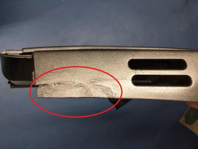

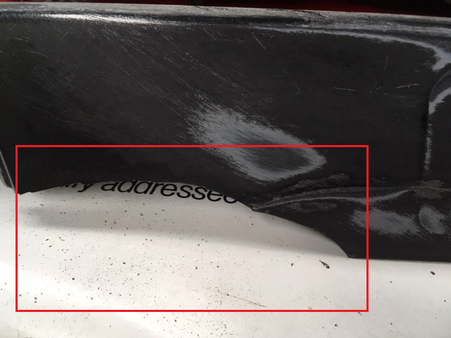

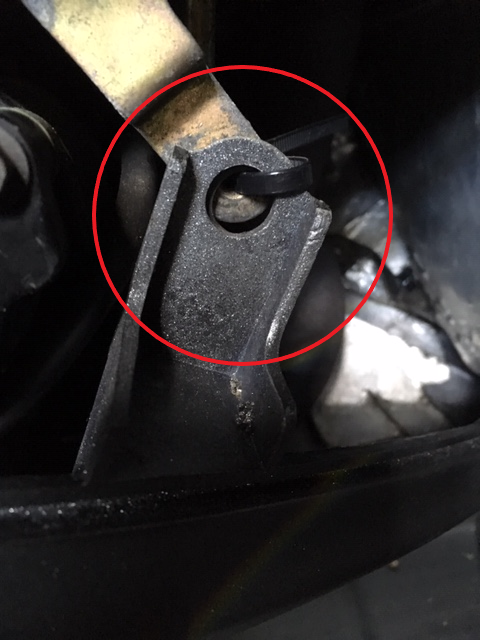

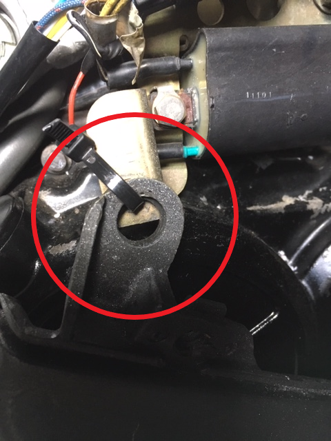

That right mid-fairing is still in rough shape. Besides the poor outer appearance, the structure had been reinforced in back with bondo. It won't even fit right.  I actually had problems slotting it back into place between the upper and lower fairings. I took a slightly...well let's say relaxed approach to that. I removed the upper bolts from the lower fairing and replaced those with zip ties. That allowed me some leeway in fitting in the mid fairing between the upper and lower ones.
IMG_2331a.png.c110a121eb3c475af85c6f1af9454175.pngIMG_2332a.png.a6d7b28ced9af2afaa4c8c0578a934b6.png
(These are pictures of the upper connections on the right side of the lower fairing. They're covered by the mid fairing when it is installed.)
You can see how the fairing can now hang just a little lower than it would with the bolt installed. I could've also bent the bracket down I think. That extra half centimeter gives me enough space. But why is that space even necessary? Dunno...
And are zip ties good enough? Nobody will see them under there, but I don’t know if they’ll work long term. My worry of course, is going out for a ride one of these days and coming home with several fairing pieces missing. Left behind somewhere on the road. So I’ll be monitoring everything carefully. Previous owners had also used more than a few zip ties in place of lost dzus bolts. (The front lower fairing is currently held in place only by zip ties. I really have to get a supply of those bolts soon. They're not the kind of thing you can find at Lowe's)
My take is that the ties should work okay so long as they are not pulled too tightly. None of the factory fairing bolts directly contact any plastic panels. They all have a fat head buffered by fat rubber washers. The body panels must need a little room to flex and absorb shock or else they'd crack. In places where a zip tie had been cinched tight on this bike, a crack always developed. Of course, the ties also look sloppy. That’s a different matter.

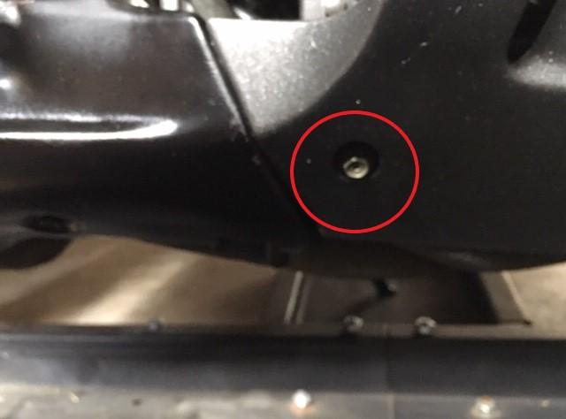

Still another right mid-fairing problem is that dodgy aft dzus bolt.
That was one great big hole that I simply glommed ABS glue into. There is no other reinforcement there at all. My guess is that somebody tried to remove the panel once, and forgot to remove that aft bolt, then ripped it right through the fairing. Nice. It then became one of the zip tie repairs. I let the glom of glue dry, smoothed it ...not enough... and drilled a hole through it. I’ll be keeping a close eye on that one too. You can see it's not recessed like it should be.

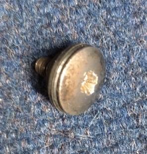

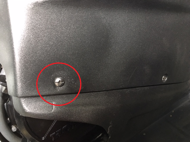

The lower fairings had these rusty Phillips head screws.
JZH characterizes them as evil. Boy…and how! I barely managed to get them out and I’m not taking any chances putting them back. I replaced them with regular bolts along with a fat rubber washer. Yet another thing to watch. A little trick I picked up somewhere along the line is to put a tiny drop of rubber cement onto a bolt thread at installation, to essentially make a lock bolt. The cement isn’t anywhere near strong enough to hold against a wrench when you want to remove it, but it keeps the bolt from backing out on its own. The rubber cement always stays rubbery.
(Lower fairing with a leftover bolt. I think that bolt belongs in the tail fairing. Oh, I hope not.)

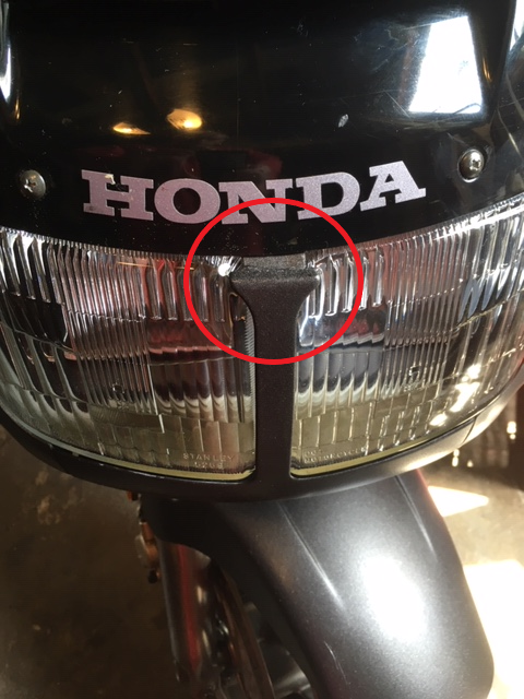

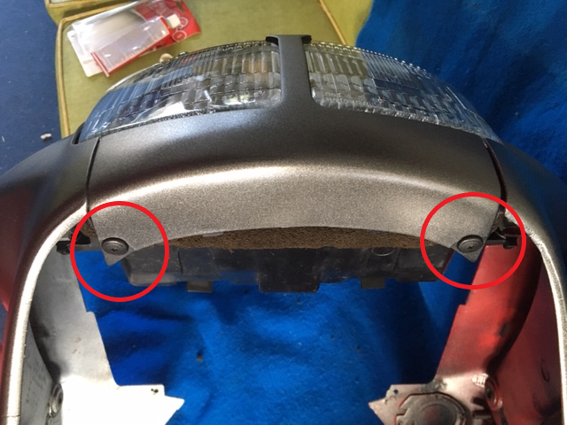

The headlight fairing valence thing is missing some kind of support structure. There are only two side screws, left and right, hidden underneath there. There were also two screw-in nylon rivets that were attached to nothing but air...
...These nylon rivet things, attached to nothing at all...
So I removed those and ran thin zip ties up around the headlight fitting inside. You can't see the ties. They’re just acting as safety lanyards so I don’t lose the whole thing over a bump. I’m thinking I should make a simple ABS plastic support for inside there. It shouldn’t be hard to do. It doesn't have to be pretty because nobody will ever see it. But I’ll have to remove the whole assembly again. Maybe on a rainy day.
The upper tab is not great either. The whole thing is out of position because that lower support is missing...
Annnnnd the tail fairing is a little jiggly too. I didn’t weld it. Just more zip ties. They worked before okay. Need I add, I'll keep an eye on it as well.

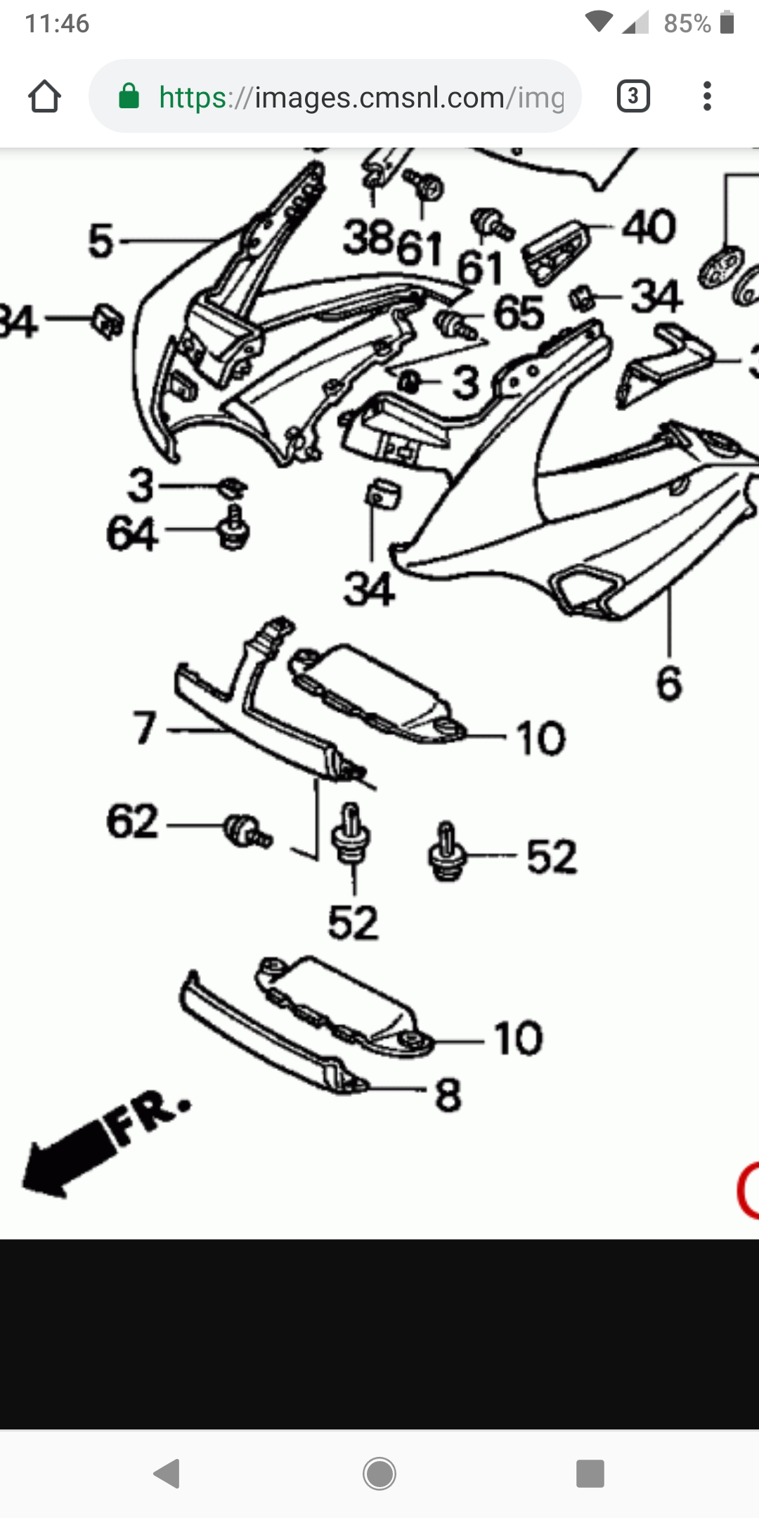

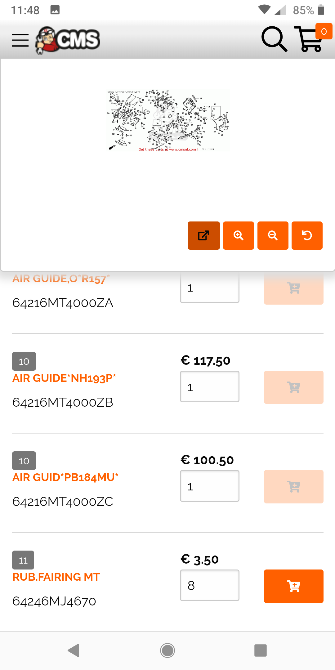

JIS, not Philips....   And therein lies a root cause of mangled bolts....

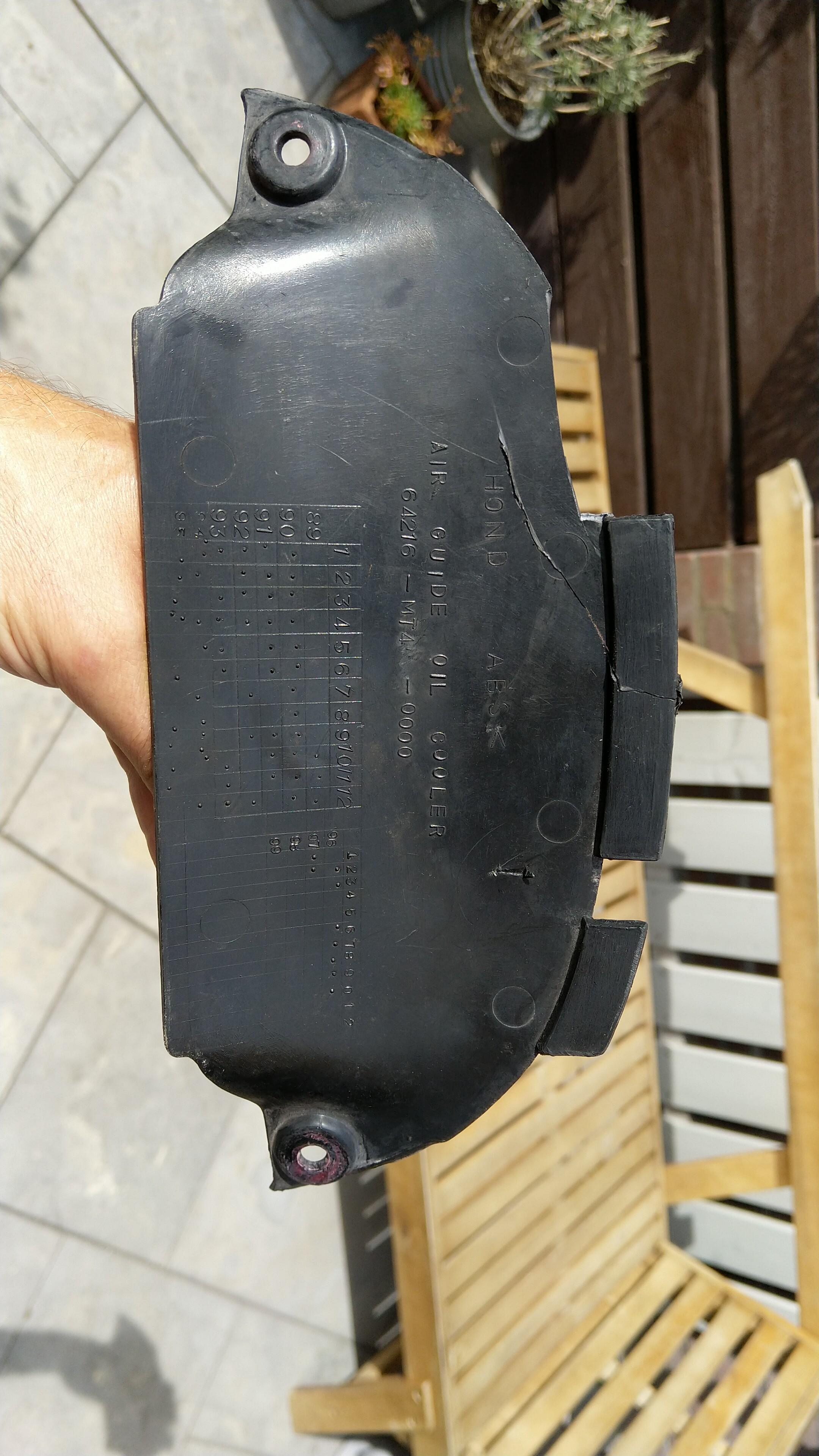

Do you have part #10?
JIS? I never heard of it. This is good stuff Leon!
I also just discovered that Phillips heads are designed to "cam-out". Near as I can tell, that's engineering talk for strip... They're designed to strip?!
Phillips screws by design were created to cam-out; a process in which the driver is meant to jump out of the screw when a certain torque was reached. There are many theories to why, such as dangers of over tightening on airplanes, or tool longevity, but nevertheless at one time or another everyone will experience a Phillips round-out as a function of its cam-out design.
http://rtstools.com/jis-vs-phillips-screwdrivers-and-where-to-buy-a-jis-screwdriver/
 .......annnnnd yes, I have no part number 10. For that matter, I don't see a part number 8 laying around. And it's not obvious to me how #8 even fits in there unless it's a substitute for #7?
I'm also wondering if bolts number 52 are the ones I used for the lower fairing...replacing the JIS(!) screws. If they're the same thread, then that could be the case...
So thank you again. I'll try to scrounge a part #10 from somewhere, although I also think I could make something up pretty easily from scraps of my tv/vcr casing. 🙂
Next time you are in the Netherlands:
4th gen, might fit yours
In some markets, rules require headlights hi and normal beam lenses to appear "separate". In Italy for instance it is not required, hence #8 is fitted as standard
Oh boy! According to partzilla, it’s the same piece...although I’m afraid to ask how you may have come by a spare...

One of redslut's last remaining pieces....

Yes, 8 is for Italy, 7 is for everywhere else.  The Italian headlight unit was a single-bulb design, actually.  (I have a #8 for my FP because I like the look of the dual bulbs without the #7 divider.)
The Air Guide is actually a more common part than you might expect.  Not only will RedSlut's part fit your bike, but you already have one!  Bizarrely, Honda used the same VFR part on the CBR1000FP...
Ouch. I was afraid of that. On the positive side, isn’t it reassuring that bits live on in new incarnations…and on new continents. We’ll have to dedicate the air guide to your old bike. Maybe etch the name in there, hidden from the world.
