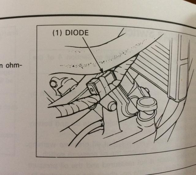

When I got the bike, the neutral light kept coming on between shifts. At first I thought it might be false neutrals because I’d read about some of you guys installing a shift kit. It didn’t take me long to figure out that I wasn’t actually hitting false neutrals, it was only the neutral light coming on when I pulled in the clutch.
I found reference to the problem and decided I just needed a clutch diode, (also called the silicon rectifier).
This thing I had to get from the Honda dealer. No choice, OEM. It set me back another $16. Or you can make your own if you are especially handy with electronics. I stumbled onto the internal circuit diagram at more than one other website. Sorry I don't have the links for you. It didn't look all that complicated. A couple leads and a twenty-five cent diode. The genuine Honda black box is tiny. Maybe 1 cm2. And so far I haven’t even been able to find it in my wiring harness. I know more or less where to look, but not exactly what I’m looking at. I’ve poked around behind the right middle fairing and under the fuse box. I’ll look again when I take off the upper fairing one of these days. For now, I’m just riding with a neutral light between shifts.
On my particular bike, I think it’s also entirely possible that one of the previous owners just removed the diode and I’m looking for something that just ain’t there. Why would somebody take it out? Beats me. I already mentioned there are a number of bits missing and I’m not all that comfortable with the quality of some of the previous work. I’ll deal with it one of these days.
(Ed. I did eventually find the diode and replace it. See entry this thread August 2019)

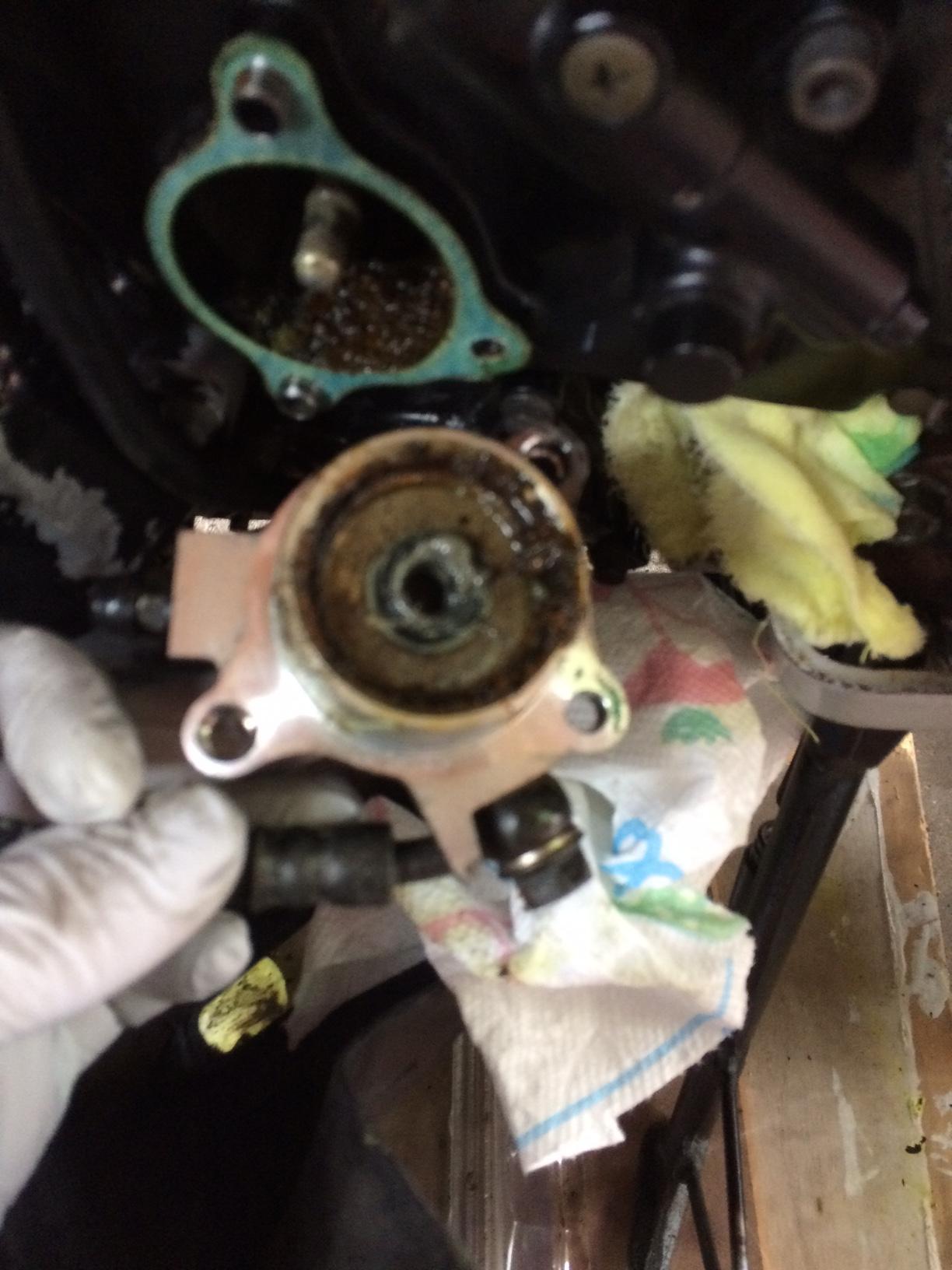

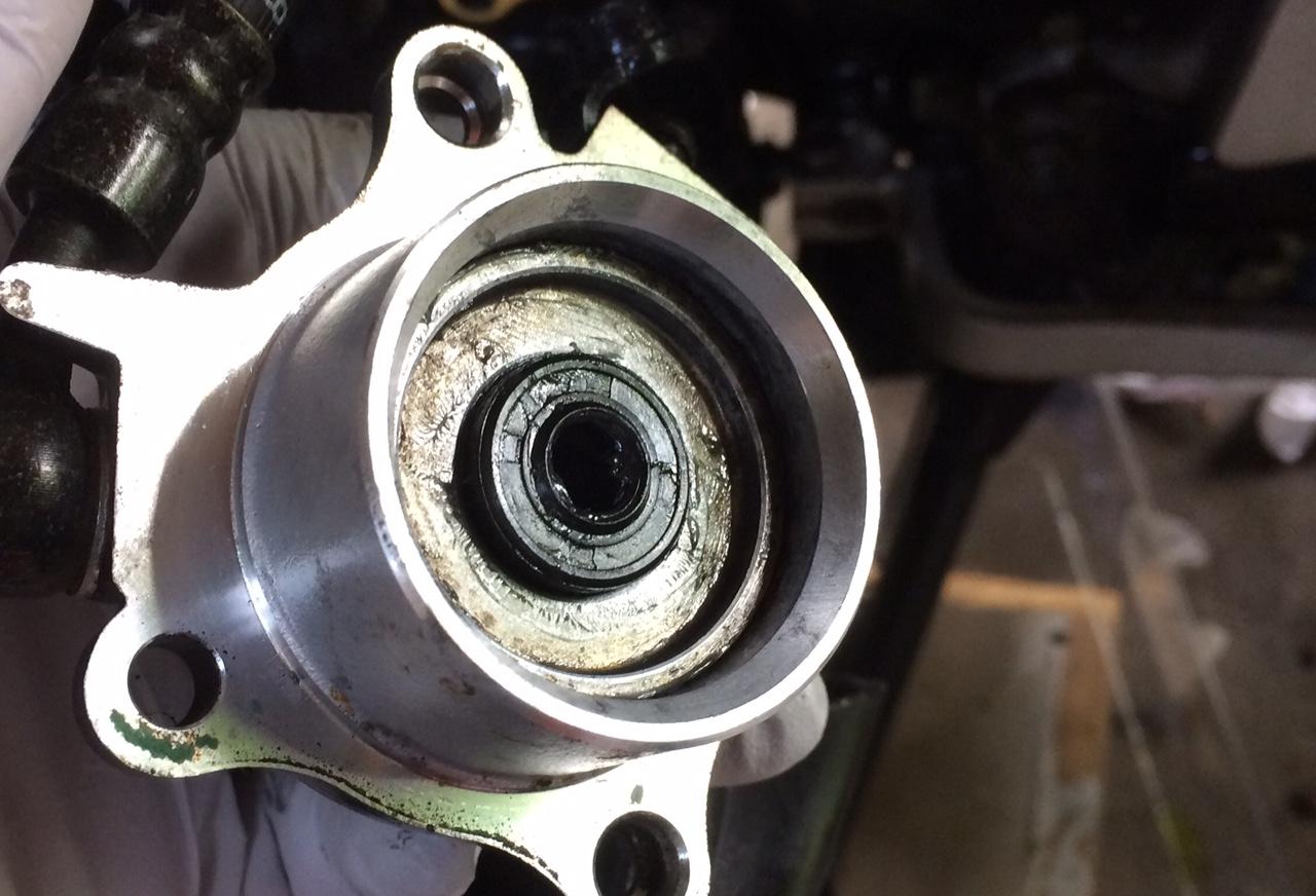

Clutch Slave Leak
Next up, there was a little leak when I got the bike. The previous owner pointed it out, a drip down the side stand. We decided it was clutch fluid. It wasn’t a huge leak but then the clutch reservoir isn’t all that big either.
The clutch slave apparently develops leaks on lots of Honda models maybe because lots of Hondas seem to use the exact same components. I’m not much of a mechanic so I was a little intimidated by the job. In the end it wasn’t all that difficult to fix.
First off, you need a replacement seal. Honda no longer sells only the seal. You have to get an entire clutch slave unit. Actually, this isn’t such a bad idea. My guess is that replacing only the seal is not always fixing the problem. At least part of the leak can be due to corrosion of the wall of the piston. So, if you only replace the worn seal, you also have to polish the wall as best you can, which may not be good enough. I found this out after I bought an aftermarket seal kit.
(Ed. The bit about what is available from Honda might not be entirely correct. Not sure. I may have been misled by the local Honda shop. You may be able to buy just the seal from Honda. You should check with them when you need to do the job).
But I got the kit because it was around 20 bucks. You only get four items in the kit: a piston seal, a spring, a dust cap and a second rubber washer for the rod that actually gets pushed into the engine to engage the clutch. If you go to Honda, you get the whole unit for a reasonable $70. With the unit, you just have to undo the banjo bolt to the line, the three mounting bolts, and swap in the new unit. My job was a little more involved.
This is what it looked like on removal...
You can see, the thing sits down next to the chain where it attracts lots and lots of goo. Yuck. What the hell? Honda couldn’t close up the backside of the slave? I know it’s been on there 25 years but still, is that the best design? Anyway, three bolts hold it on. To get the piston out of the cylinder, you only need to squeeze the clutch a couple times. Every time you squeeze, the piston advances a little more until it gently pops out, along with all the clutch fluid. It’s pretty dirty in there too.
This was the engine side...
The replacement bits go in easily enough. For the life of me I can’t figure out why the spring is necessary. Shouldn’t the fluid pressure keep the piston against the actuating rod? Whatever.
Replace the bits and clean out the corrosion from the piston and cylinder. How to do that? Well I used a scotchbrite pad. Yeah yeah. It’s not ideal, but it didn’t scratch the metal any, and it seemed to do the trick. Time will tell if the repair is going to hold or if the leak reappears. The piston goes back into the cylinder easily enough. Bolt the unit to the bike and let the real fun begin.

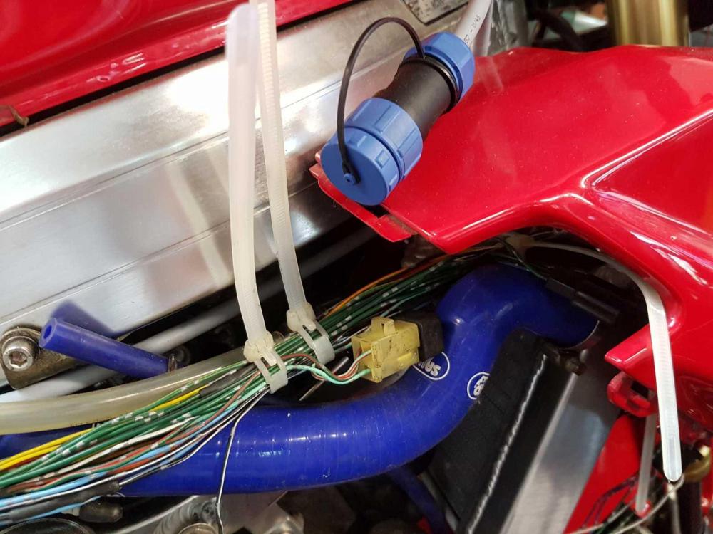

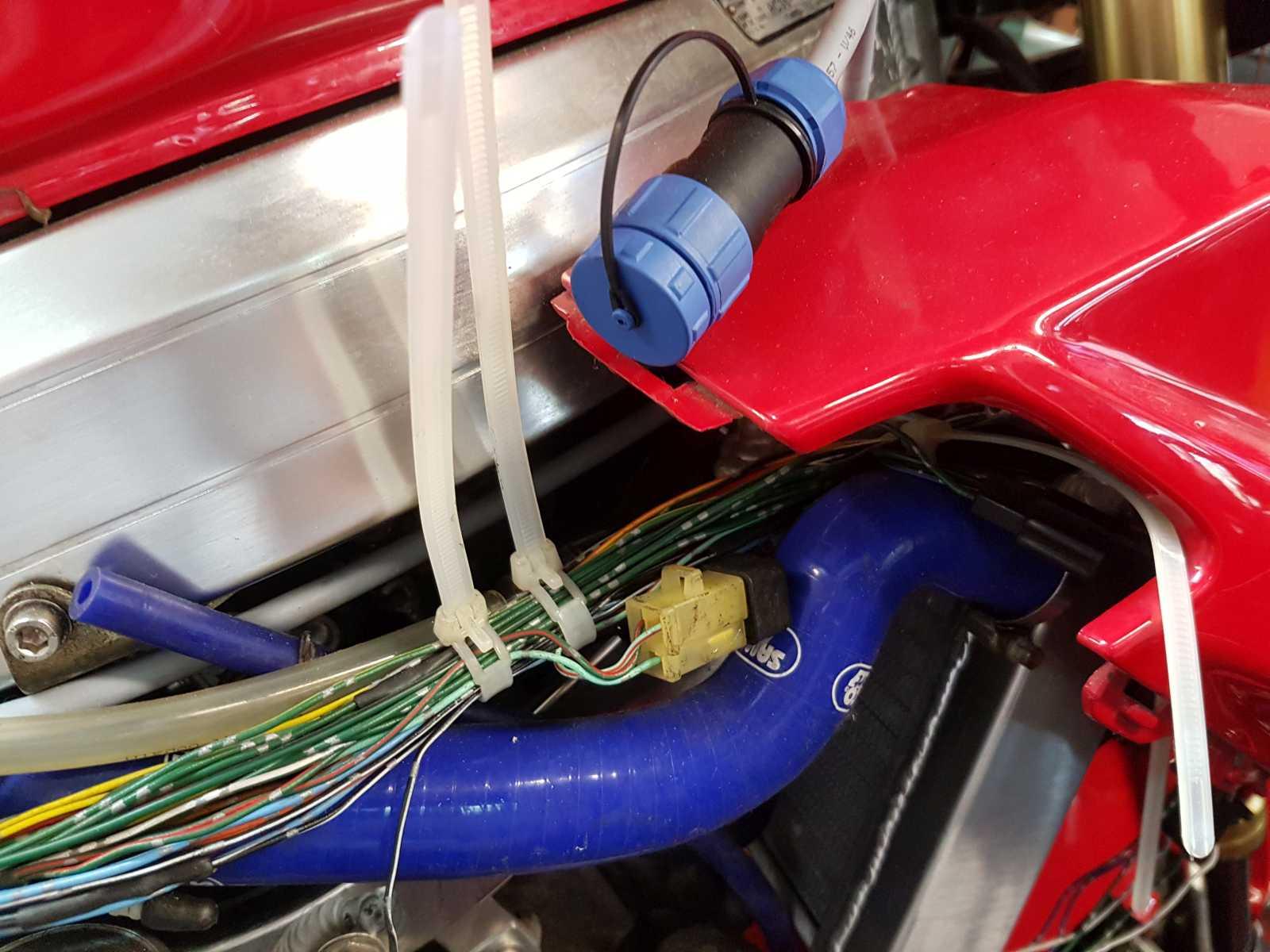

Electrical: you mentioned updated rec/reg but another weak point are all the connectors in the charging system. The 3-conductor between the alternator (stator) and the rec/reg, and everything on the starter relay (adjacent to the battery)

On 9/10/2018 at 11:24 AM, LID said:

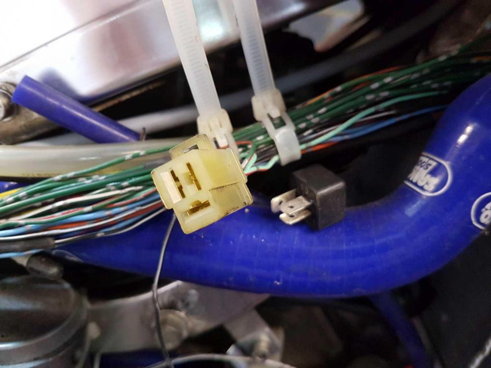

Clutch diode. Silicon Rectifier
The thing is very small. Maybe 1 cm2. And so far I haven’t even been able to find it in my wiring harness. I know more or less where to look, but not exactly what I’m looking at. I’ve poked around behind the right middle fairing and under the fuse box. I’ll look again when I take off the upper fairing one of these days. For now, I’m just riding with a neutral light between shifts.
The wiring harness on my FP is currently un-wrapped, as I'm modifying it in several ways, but I think the clutch diode is located in approximately this location (but it could be a little further forward).  It is wrapped in electrical tape, but the bulge makes it pretty obvious where that is.
Ciao,
JZH
John, it looks like yours is further to the rear of the bike than I'd been looking. Not under the fuse cover but on top of the expansion tank. Is that right? Have you moved your harness around since unwrapping it? Mine doesn't seem to be there. But I'll look harder. The book shows yours is in the right spot.
Are you using silicon grease on every fitting? Would you use it on the diode here?
Thanks 🙂

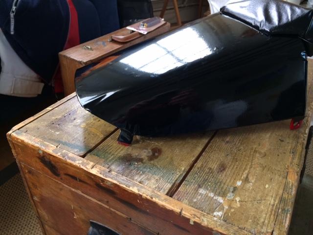

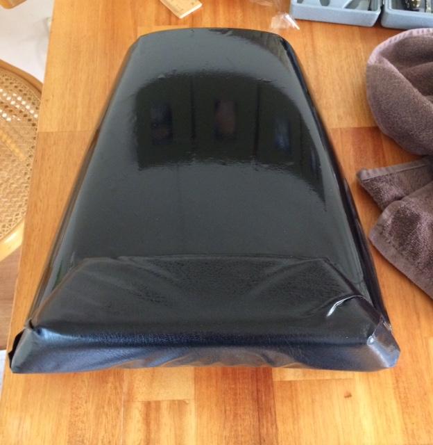

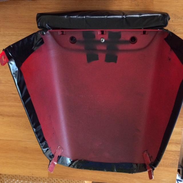

Recovering the Saddle
In spite of all its dodgy history, the bike does run terrific. I've come across most all the quirks built into generation 3 models by now and no surprises. Yet. That doesn't mean everything is sorted, only that I am getting to know how things work. I'm told that the suspension definitely needs a rebuild. No way a 25 year old VFR has a decent suspension. Well, maybe so, but it's possible it has been worked on and in any case it's good enough for now, so next thing for me is to make things look better.
The seat could use a new cover and probably some extra padding under me. There’s a fine site on home grown seat modifications here: http://diymotorcycleseat.com/ There’s even a page on the guy’s VFR seat. It's all encouraging.
(Ed. Rats. As of 10/2019 this is a dead link. Maybe it'll pop up again under similar search terms)
(2nd Ed. DannoXYZ found the link in the archive. 9/2020. Thank you Danno!
...here’s DIY Motorcycle Seat mods
back again thanks to internet time-machine:
http://web.archive.org/web/20120115195023/http://www.diymotorcycleseat.com/index.php )
Aftermarket seat covers are on Ebay for not very much money, but I’m thinking I’d like to try it myself first. When, or rather if, if that doesn’t pan out, then I’ll spring for a precut cover...
Vinyl material is easy enough to get. The fabric stores have it. Or even the junk yard. You can even use an old couch panel of real leather. They say the important thing is to make sure your fabric is waterproof or else you have to use a plastic liner under it. That makes sense. You don't want the open cell sponge padding soaking up the rain. My CBR came with a beautiful custom Saddle Craft seat with a grippy cover called, appropriately, Griptex.  https://www.saddlecraft.co.uk/
I’d been thinking about finding something similar for the VFR when I stumbled on this thing at Aldi. It’s a trunk liner. It cost 4 euros.
I won't be sure if it's suitable until I try it out. It feels a little stretchy to me and that might mean it also tears easily. Up close, it looks almost the same as the griptex. I think the liner sheet might big enough for two VFR seats. Or yeah, more likely two attempts at one seat...
For extra padding, I have a closed cell camping pad to cut up. Wish me luck. I’ll try to take some pictures as I attempt the job and then report back.

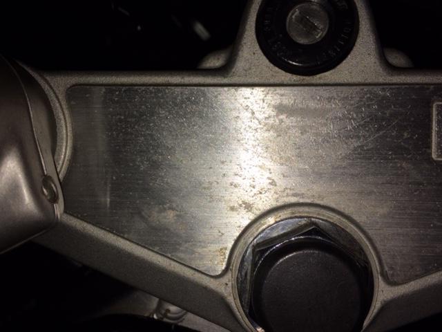

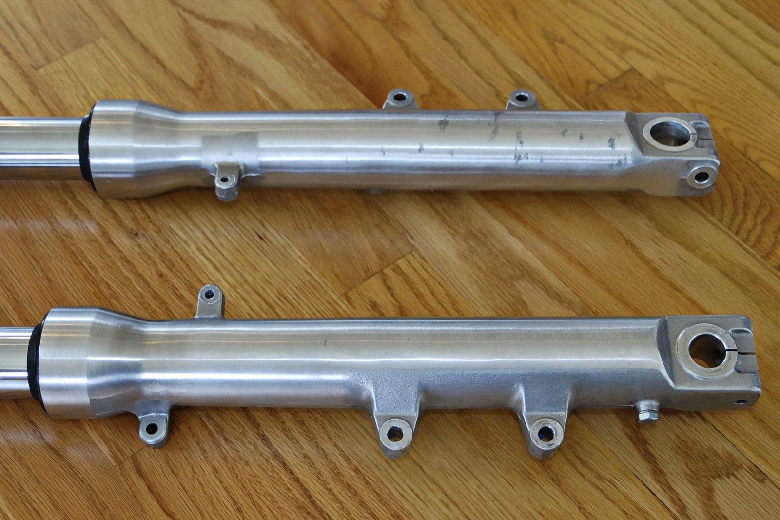

Polishing Aluminum

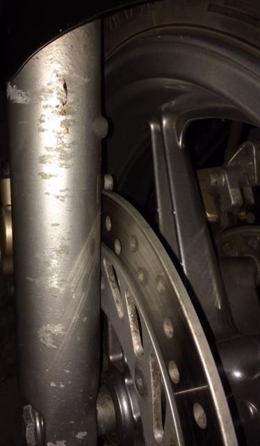

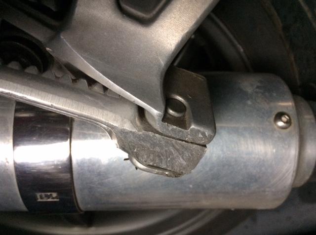

The aluminum all over this bike could use some cleaning. I don't think it's terminal. One reason I decided this bike might be good enough for me is that there really isn't much serious rust anywhere. It's apparently been kept mostly indoors throughout its neglected life.
Like most everything else, I'm not sure how to do the cleaning job and I'm concerned about doing some damage that has to be undone in the end.
Here's a picture...
Yup. The other fork is the same. Fortunately the fork tubes are fine. It's really only a cosmetic thing on the sliders. And before you mention it, I know...the brake disc isn't all that clean either... I should use a better picture. The slider isn't quite as bad as it appears. That nasty blotch of rust near the top of the picture is just a stain. And those diagonal 'scratches' are reflections off the brake disc. But yeah, it's bad enough...
The exhaust can is in better shape but still needs polish. Lots of tiny scratches.
Same story around the whole bike. On the triple clamp...

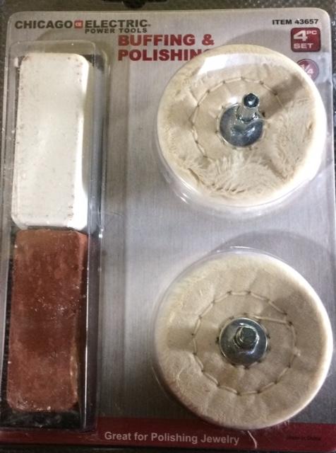

Anyway, I picked up this little polishing kit at Harbor Freight. It doesn't look like much. I don't know how effective it can be. You're supposed to use the white block for aluminum. I think it's like putty. I get the idea I need to wet sand everything first, using the putty last. And then rattle can clear coat? Dunno...

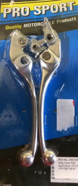

Levers
My brake and clutch levers are scarred. How many times has this bike been dropped? I spotted this generic set at Ebay for all of $6 (10 with shipping). Not sexy but they're better than the ones I have on there. They too could use a little polish I think before installation.
If you guys have any encouraging ideas, please let me know. Like so much information online, there are plenty of anecdotal reports and conflicting procedures, most of which aren't very helpful.

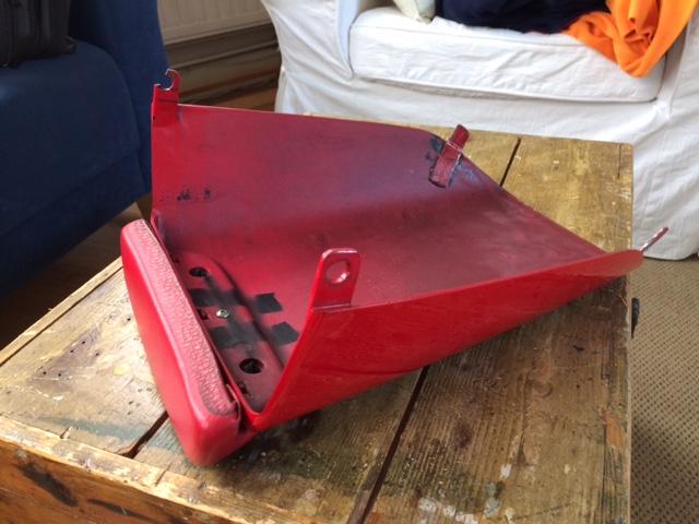

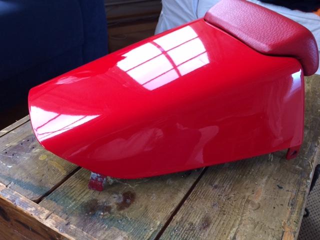

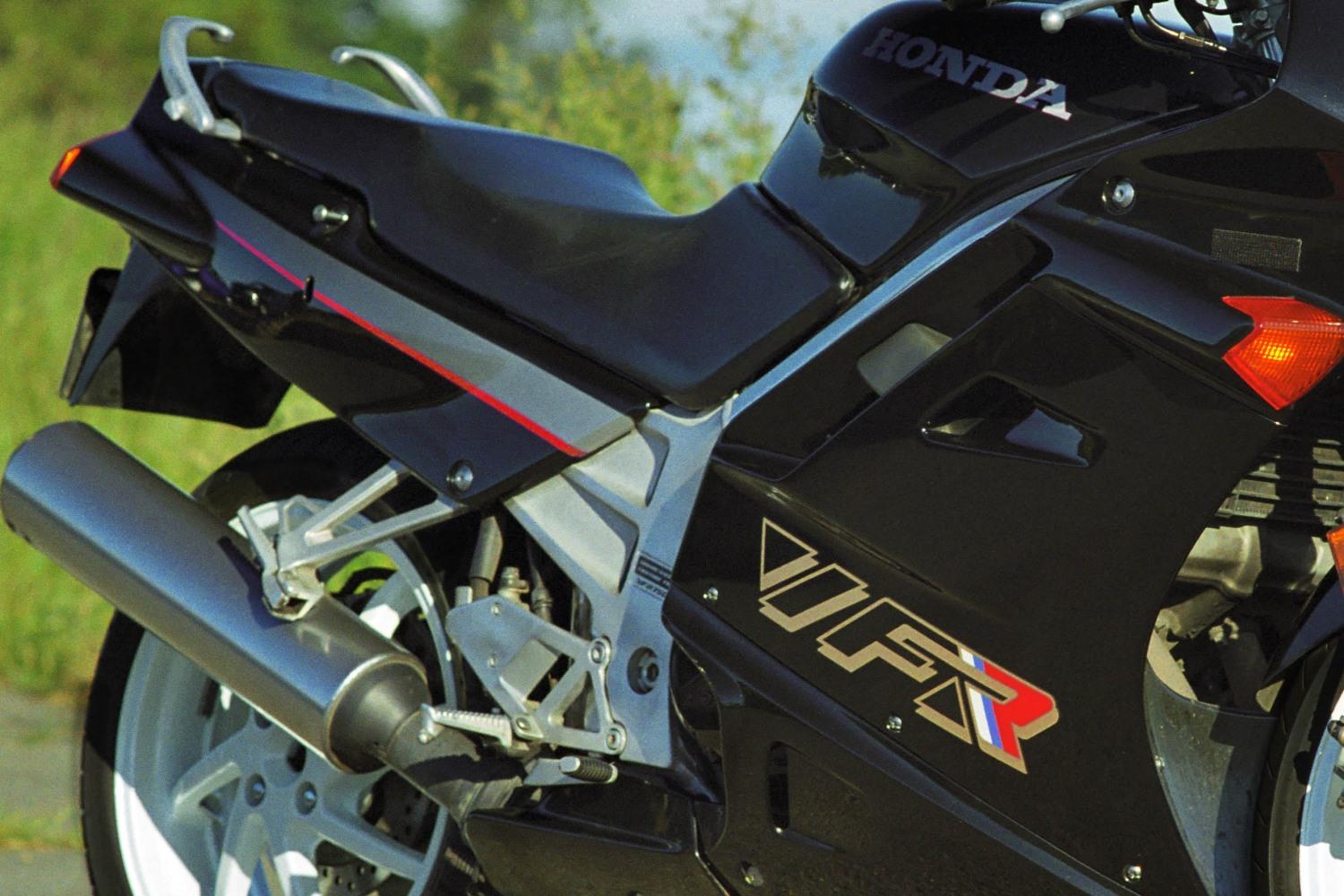

Rear Cowling
I found a rear cowling in Holland and brought it home to Connecticut. It wasn't a high priority for me but these things are hard to come by in the States and the price was right. You can see the rear tabs have been rebuilt and one front tab is cracked, but in general the thing is good enough by my standards.

So, an experiment in vinyl wrap. I got a small roll of gloss black made in Germany at the DIY store. It's not specifically made for outdoor use. I'm just giving it a shot. And I had a scrap of black cloth vinyl to cover over the red bump pad. Anybody translate instructions from German?
OK. Um, okay. I'll be the first to admit the result wasn't...optimal? I pulled and stretched the wrap as best I could around the corners. The stuff is easiest to apply on flat surfaces and well, as you know the cowling has curves. You can use a hair dryer to make the vinyl more elastic but you can't reshrink it once it's been stretched. And then there are all those air bubbles trapped underneath. Whew. After an hour or two this is what I had.
IMG_2858.jpg.2b681d88e2bde6a20c8217f2723fa414.jpgIMG_2859.jpg.1c9171b2b2b4edd600628893459f8247.jpg
Yeesh. The wrap was semi smooth I guess but really there's not much positive to say about it. And the bump pad vinyl didn't work at all. Wrinkles everywhere. Naah. Just a mess.
I have enough wrap to try other bigger, flatter panels, like the midpanels, but now I’m discouraged. I’ll think about it. And think harder about paints and clear coats.
Well, at least there's no rush on that translation...  (Besides, German is pretty much like Nederlaans, innit?  Should be no problem for you!)

I suppose silicone grease should be used on the clutch diode terminals, but I hadn't really thought about it.  With terminals exposed to the elements it's probably a good practice to use dielectric grease, but these are generally wrapped and covered by the 'leccy tape.

9 hours ago, LID said:

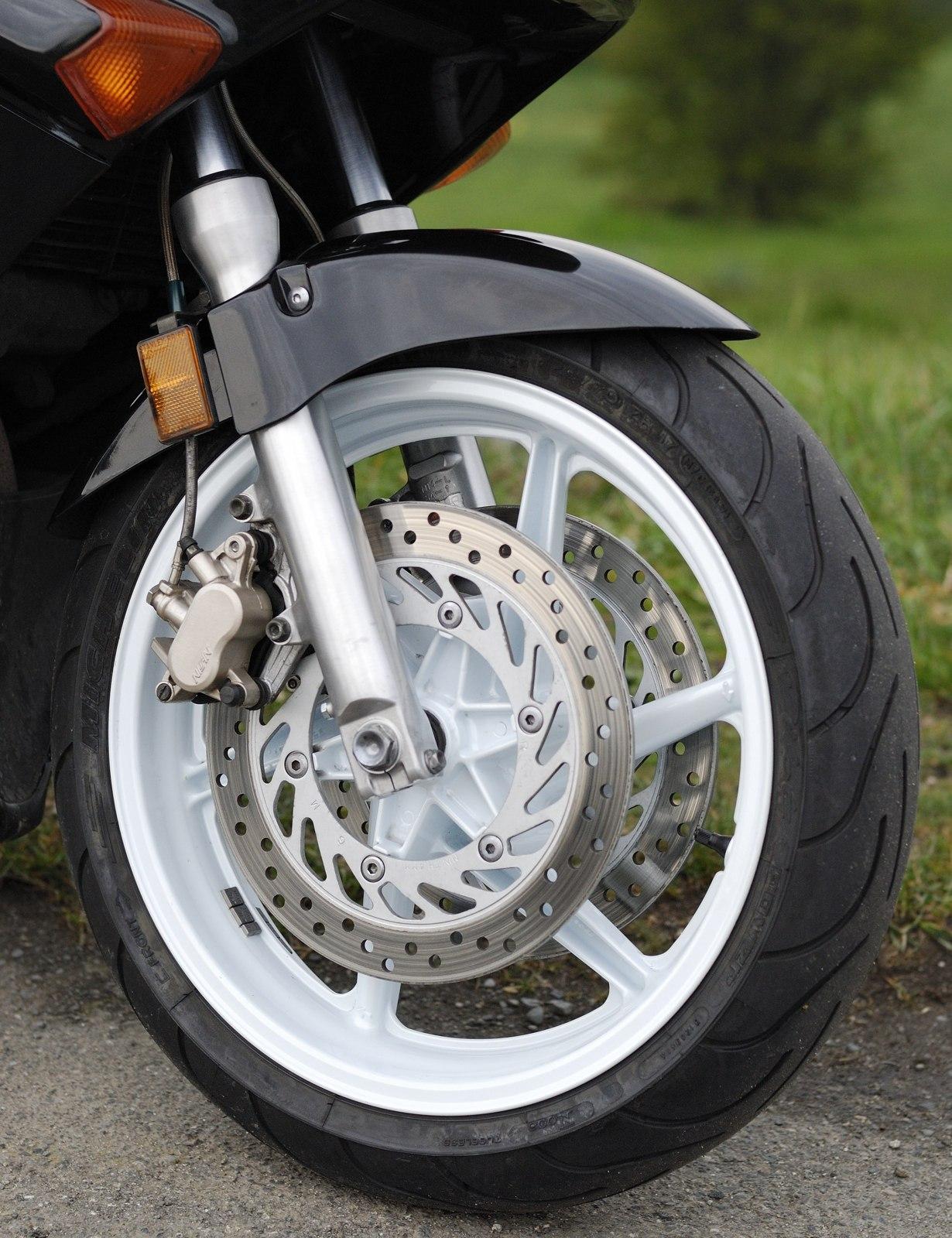

Yup. The other fork is the same. Fortunately the sliders are fine. It's only a cosmetic thing. And before you mention it, I know, the brake disc isn't great either...
Ten years ago the forks on my '92 looked pretty scruffy, though not quite as rough as yours. I had the forks off to get emulators installed and decided to try cleaning them up. Some good paint stripper, #0000 steel wool, heavy gloves, safety glasses and a bit of elbow grease had them looking much improved. Next some Solvol Autosol and more #0000 had them looking really good. I pondered reapplying clear coat but opted not to. Two years later they still looked fantastic.
By the way, Honda didn't polish the fork legs evenly overall.
In this pic the top leg is just stripped of the clear coat and the lower one has been polished.
And they look great back on the bike, and stayed this way till I sold it 2 years / 20,000 km later.
Edited by Lorne
Added more detail
Have you considered painting the bike red to match the cowl?  It's probably worth more than the bike, after all...
John, I thought the silicone grease was supposed to help conduct electricity as well as protect the connection from corrosion. Um, I'm not sure how exactly it could do both since it might be a conductor or an insulator but probably not a conductor and  an insulator 😛

On the other hand, I will take a whack at the fork tubes. Thank you Lorne! See John, pay attention, this is how you get me to do something. Tell me the job's easy and gets good results, then show me pictures. I've got some steel wool and paint stripper laying around here someplace. I'll check for autosol too. I noticed that some VFRs have black fork tubes. So I could always just spray them if I completely screw it up.

oxgard, better idea than s/g, found in elec dept of local "home depot" type store, or even in the mom n pop style hdwre  if ya have such a thing
Oxgard. Here it is. Ox-gard. Lowes has it. It's on my list. Thanks Airwalk...

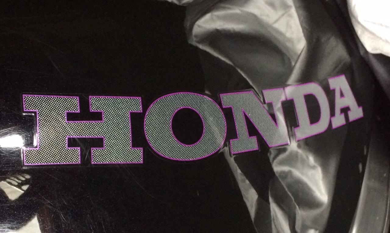

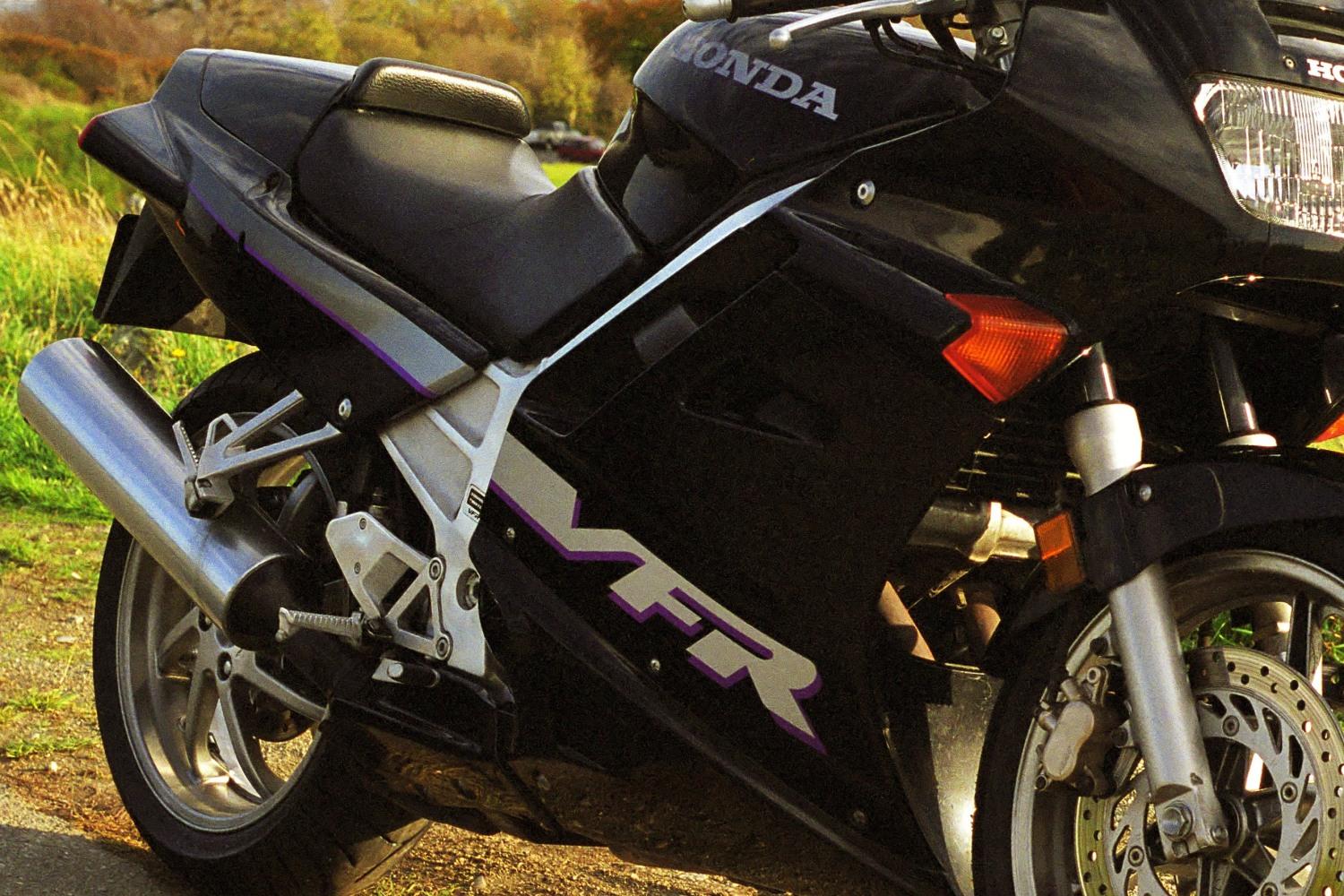

Everybody has his own taste of course. I ordered an inexpensive set. I'm pretty sure you can get them made anywhere. I don't know any more about decals than I do about anything else around here. 😛
The only decals on the bike now are on the gas tank. They're in good enough shape for this bike. But they have that 90s bling with the purple edging. Yuck. Fortunately, it's subtle. (btw the tank isn't bashed, it's just a reflection in the picture. I don't plan to respray it. It's the only original paint on the entire bike. But I'll try to polish out the scratches. A tank cover would work for me too.)
Original design decals weren't an option for me, which is fine. Is the design trademarked? I found this set in gray, but any color is available... My rims aren't white, so I didn't go with white decals. Not sure how these'll look on a black bike.
All I really wanted was the big VFR for the mid fairing. If I decide to remove the tank decal, I might use the honda wings there and maybe the large HONDA down on the belly. I have no plan at all for any of the other bits. Little VFR on the quarters? Oh, a little HONDA decal goes above the headlight and tail light.
All that's in the distant future of this project.
54 minutes ago, LID said:
The only decals on the bike now are on the gas tank. They're in good enough shape for this bike. But they have that 90s bling with the purple edging. Yuck. Fortunately, it's subtle. (btw the tank isn't bashed, it's just a reflection in the picture. I don't plan to respray it. The only original paint on the entire bike. But I'll try to polish out the scratches. A tank cover would work for me too.)
Fwiw, the Honda decals on the tank are clear-coated and so much more durable, but impossible to remove.
Honda made a different graphic for each body colour, also the pattern changed during 1990-1993 model run. These oe decals have 5 colours, black, gold, red, white, blue, and clear. Not too easy to duplicate I think. The backing paper has notches and holes to help line it up correctly on the side panel, and it says Scotchcal 3M Film. The p/n are: Left:   64480-MT4-300ZC Right: 64440-MT4-300ZC
I have an unused spare set if you can't find them anywhere.
For reference, the first pic shows the stock decals on my '92 VFR. In the 2nd pic I'd applied red tape over the purple and replaced the VFR decal with the UK version.

On the other hand, I will take a whack at the fork tubes. Thanks Lorne! See John, pay attention, this is how you get me to do something. Tell me it's easy and gets good results, then show me pictures. I've got some steel wool and paint stripper laying around here someplace. On site, there's also a thread about using oven cleaner(?). I'll check for autosol too. I see that some VFRs have black fork tubes. So I could just spray them if I completely screw it up.

The silicone grease doesn't conduct electricity.  The idea is that its application inhibits the corrosion of the contacts, which are thus able to maintain the clean mechanical connection they were designed to have.  I have some Ox-Gard in the garage, but I haven't really used it in anger at this point.
I powder coated my FL's fork tubes black before I shipped that bike to Europe (the first time!), I still have them and they're still black.  You're welcome to them, but I can't guarantee they don't have any nicks or chips, as I really haven't looked at them in years.  I'm headed to California for my postponed summer holiday at the end of next month...
