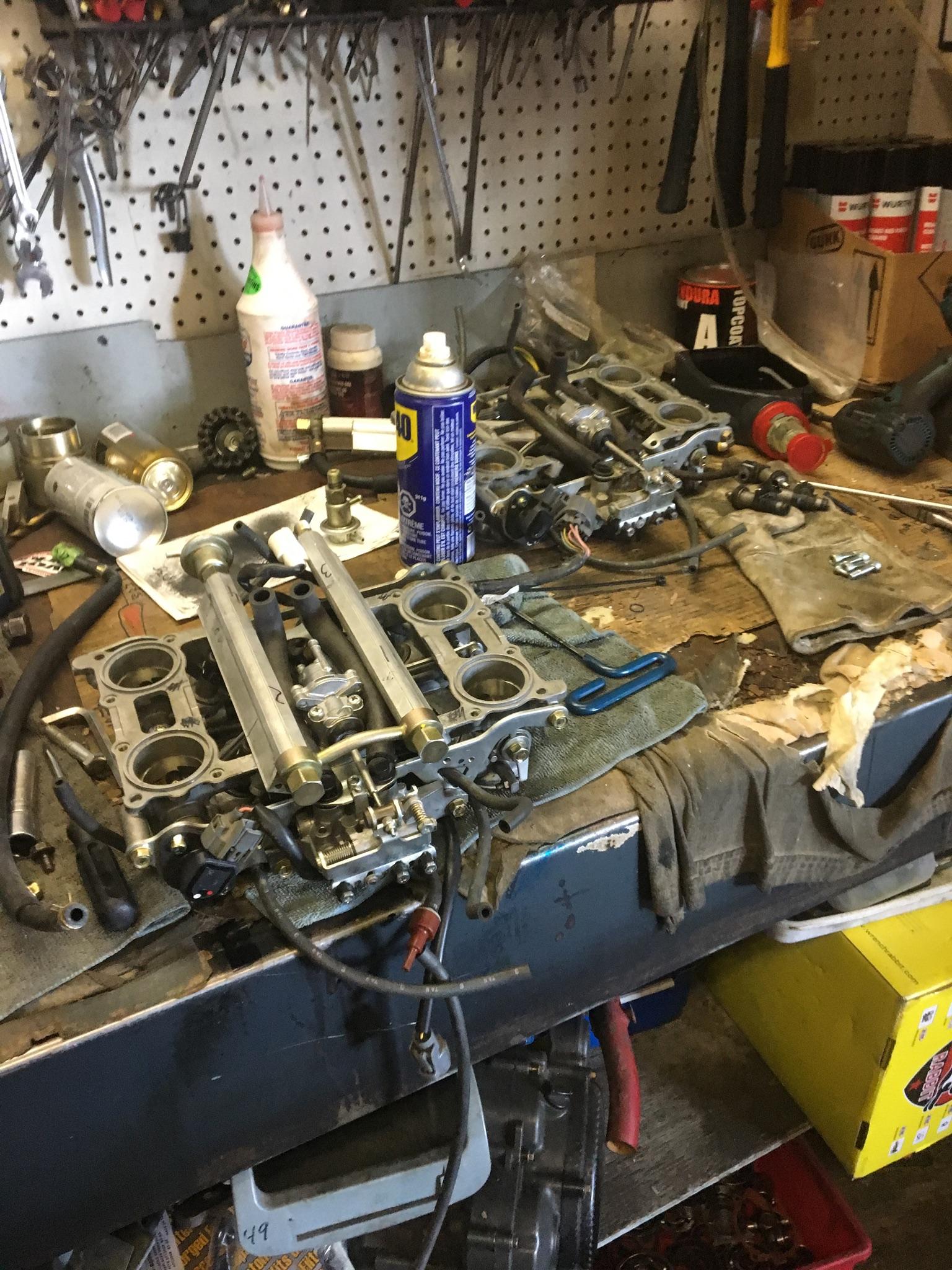

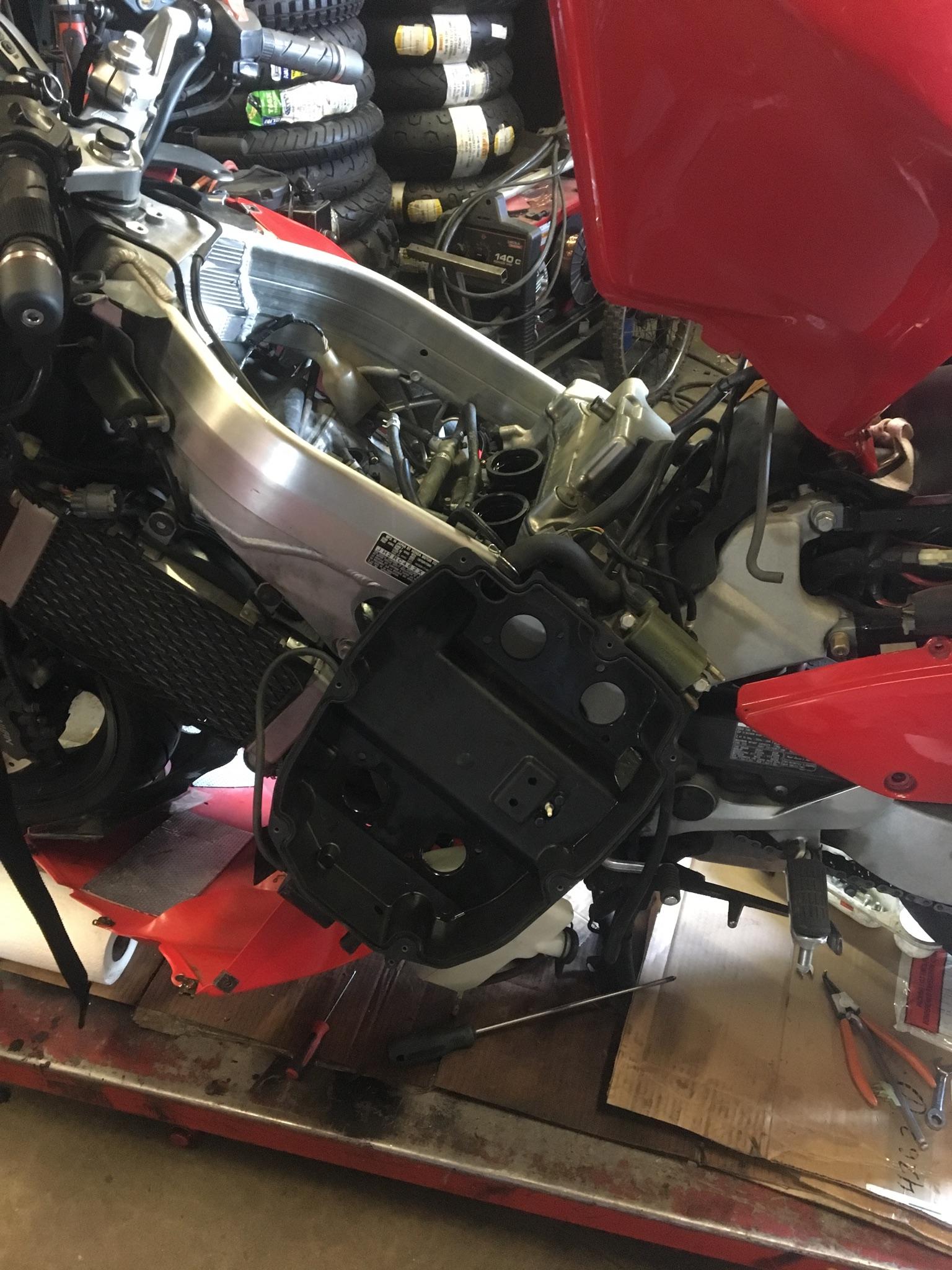

You were correct about the throttle bodies being different. I ended up purchasing on eBay throttle bodies for my 01 ($120) and then a set from a 98 ($100) model because it had the interchangeable fuel rails and injectors included. We cleaned the throttle bodies and serviced the best 4 injectors then re-installed only to discover there was no power to the fuel pump. Out it came again, repair and test the connection mentioned plus the 4 to the injectors then re-install. Pleased to say the bike is running much better, especially when cold.
Thanks for the help, now on to a more compact muffler. My previous 5th gen had a Two Bros unit which growled like a small block V8 but they are pricey.
Edited by DennisA
Photos show the pain of doing twice.
