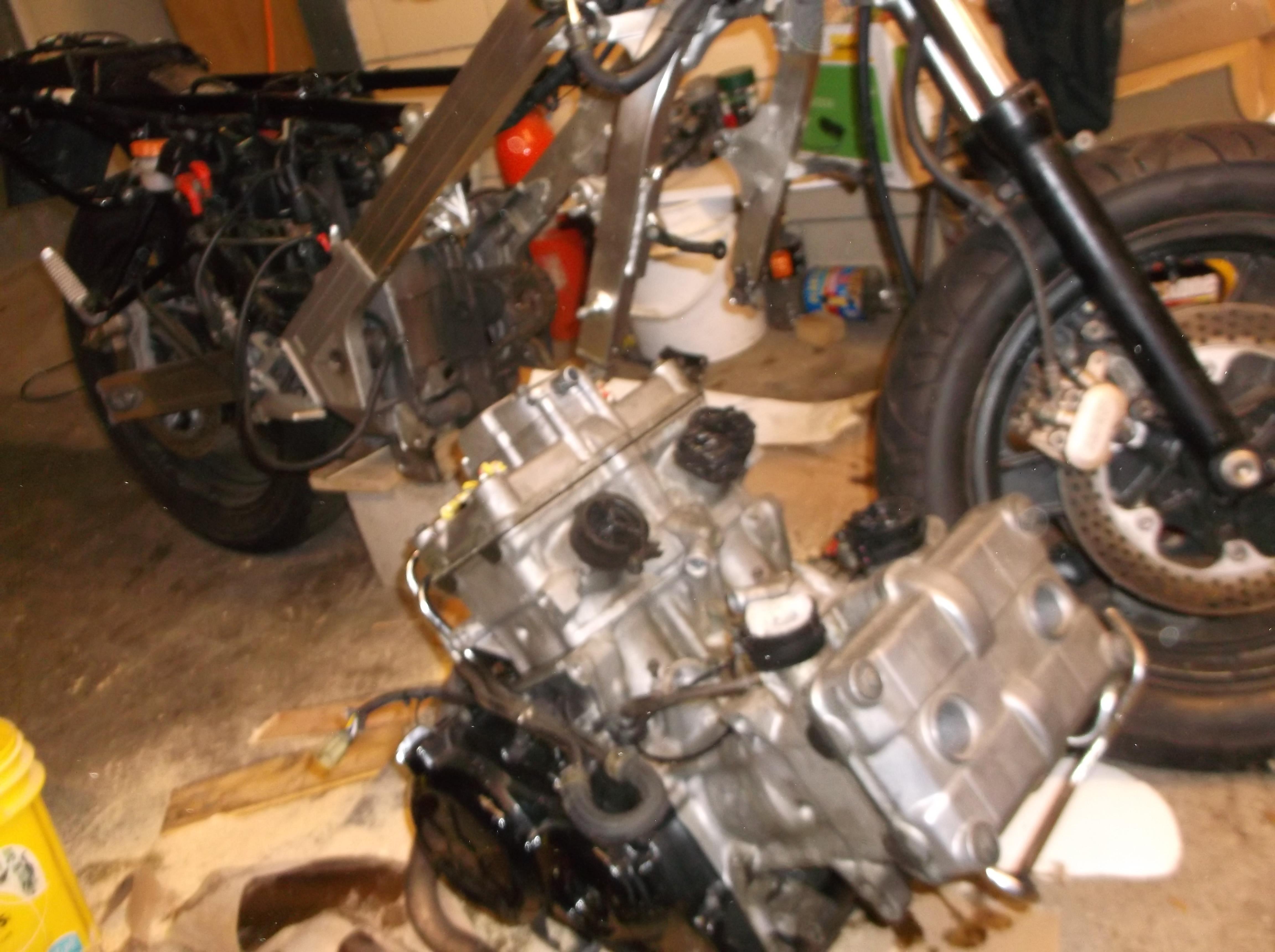

jeeez, mate, i have a good, ready-to-go gen3 engine sitting on my shop floor here in NY that i'd be pleased to sell you---the result of a failed attempt to place a gen3 into a gen2 frame---but getting to France is a big challenge. But since you live in the Riviera, maybe your yacht could pick up the moteur from NYC next trip over ?
good compression, valves checked, very clean and i want just $350 for it !

i can positively say YES THEY WILL!!.
how ever .......you do need the carbs and airbox also.
 i have swapped a 3rd gen into a 4th and vice versa..
I have the gen3 carbs  for sale too, just $340 for a freshly cleaned and adjusted set.
