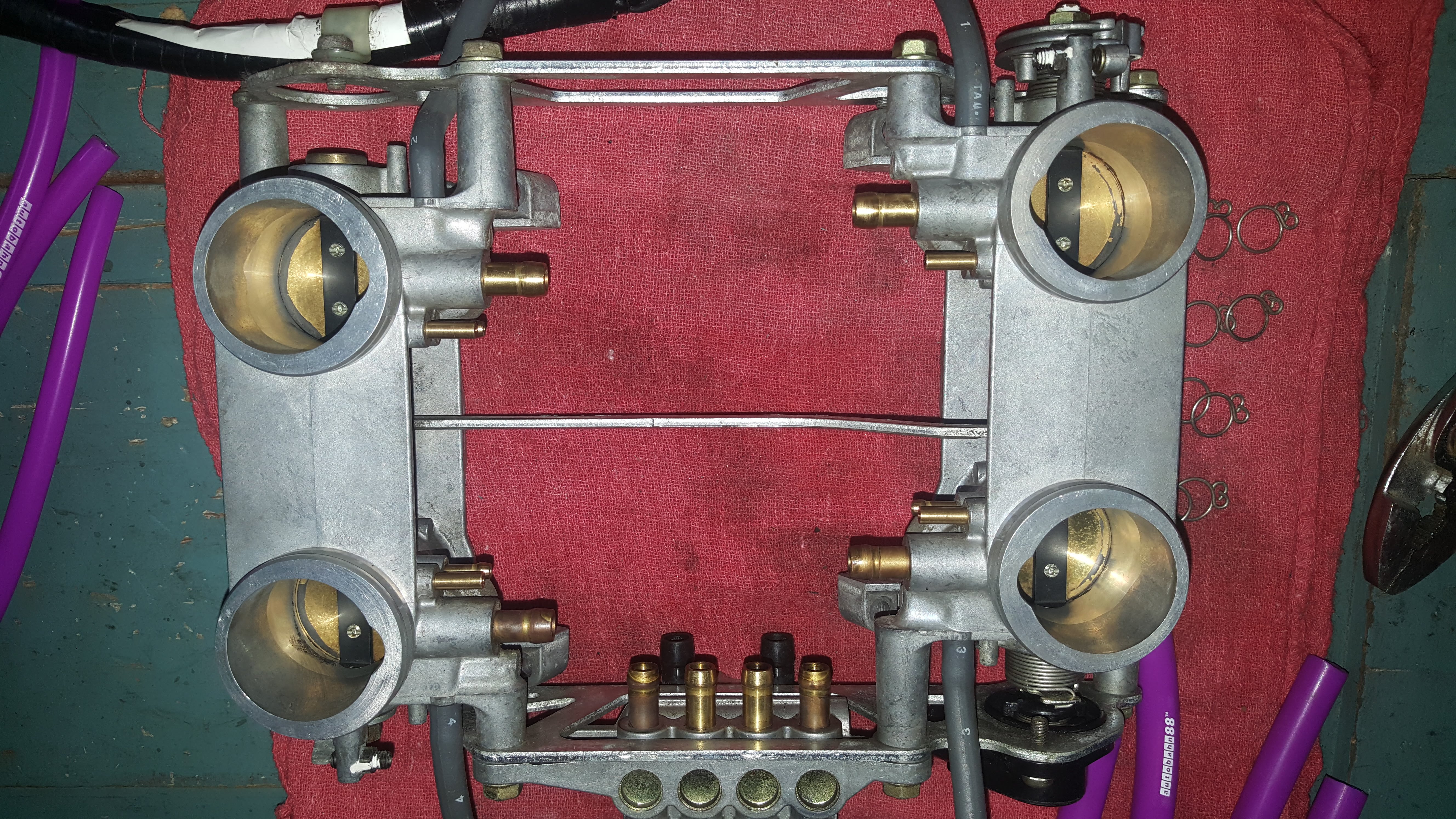

Next up was digging into the throttle bodies. This started with a few good rounds of carb cleaner and toothbrushing inside the throttle bodies and more foaming degreaser on the rack/hoses/etc. Despite looking a bit intimidating, hose replacement was pretty simple once I got into it. There are really only three runs of 3.5mm hose, the 4 8mm hoses that run through the center of the rack, and the two that connect next to the IAT sensor in the airbox. I pulled each of the smaller 3.5mm runs out assembled, then replaced the hoses one length at a time. It made the process quite easy. I would not recommend pulling all the hoses and all the junctions apart and then trying to reassemble it all. If you get confused or need a little help, Partzilla has the factory diagram for the throttle body tubing: https://www.partzilla.com/catalog/honda/motorcycle/1998/vfr800fi-a-interceptor/throttle-body-tubing
After tear down:
20180531_202006.jpg?dl=0
