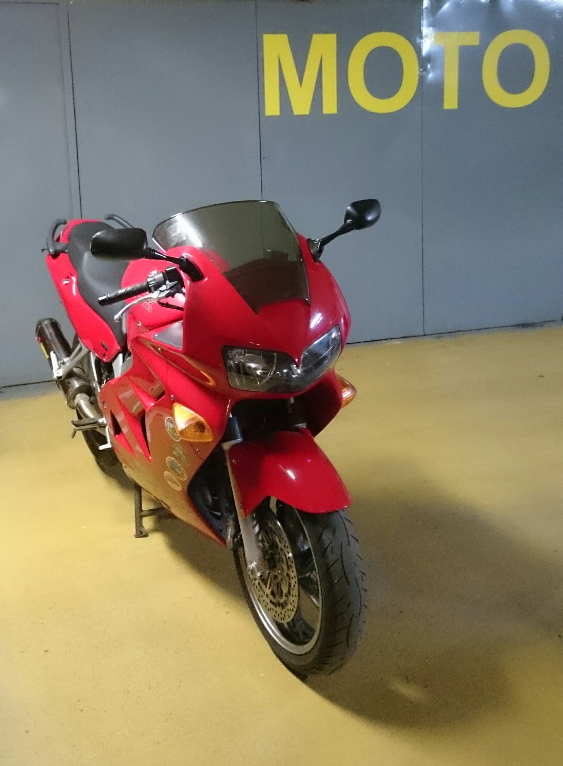

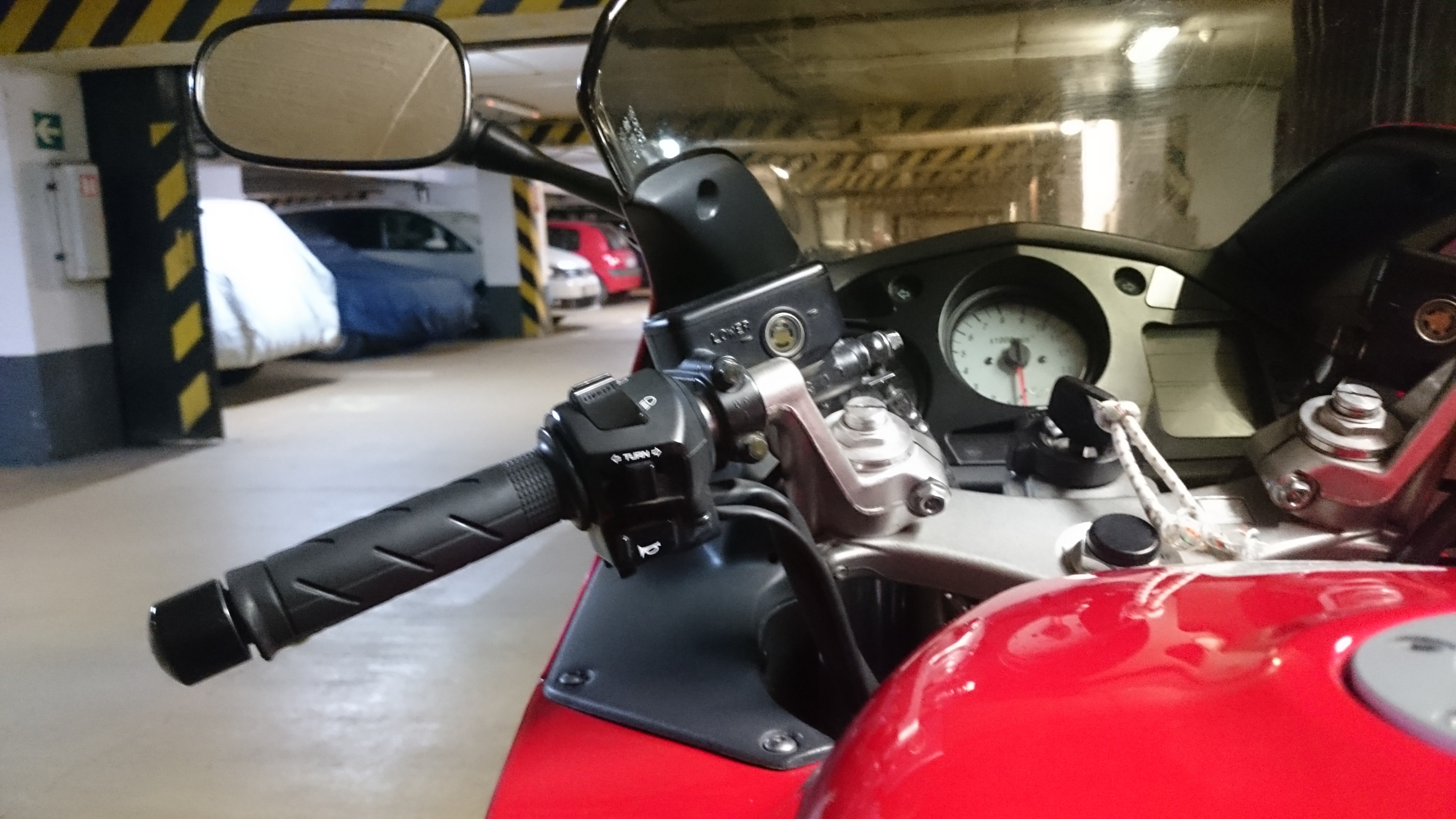

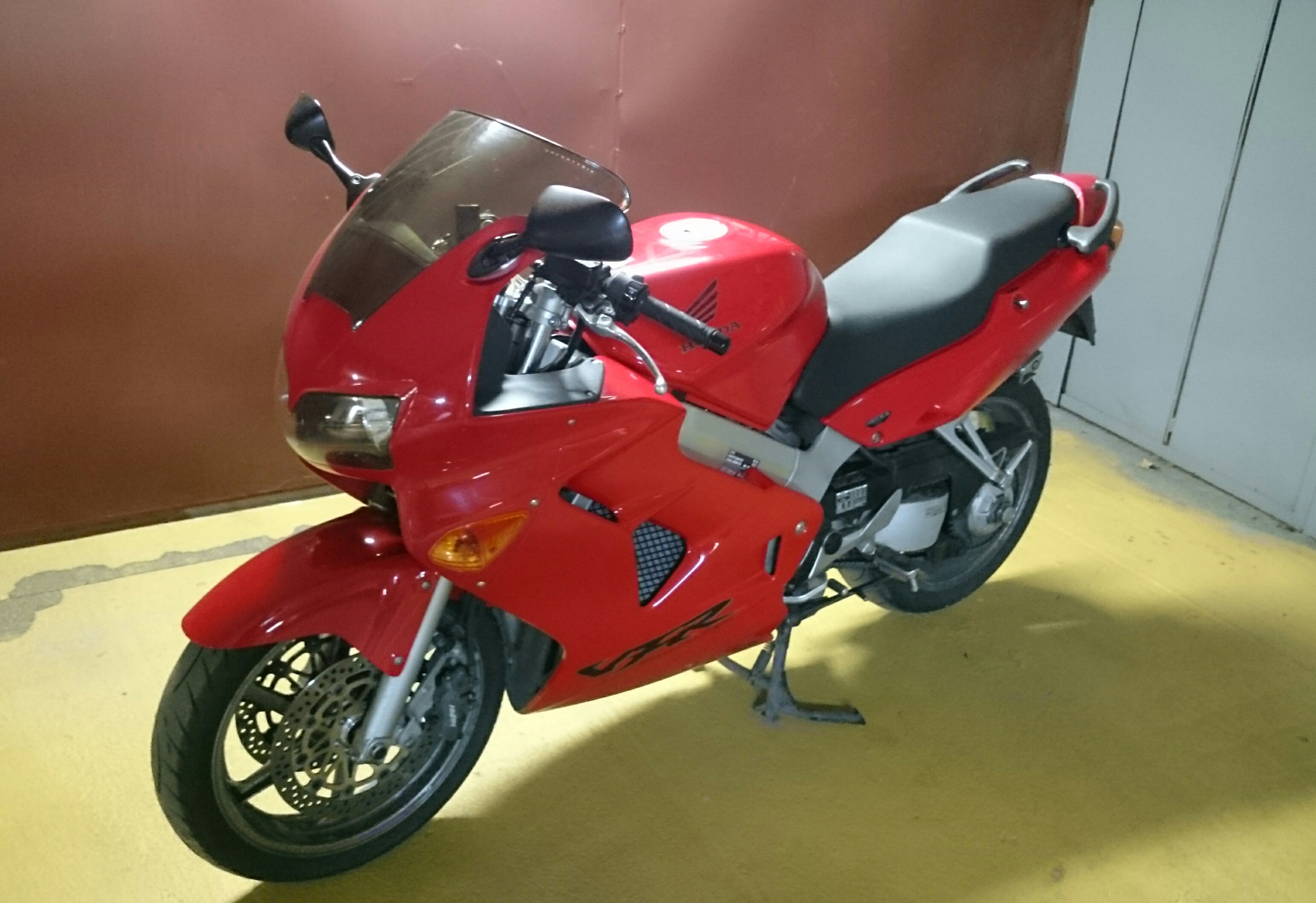

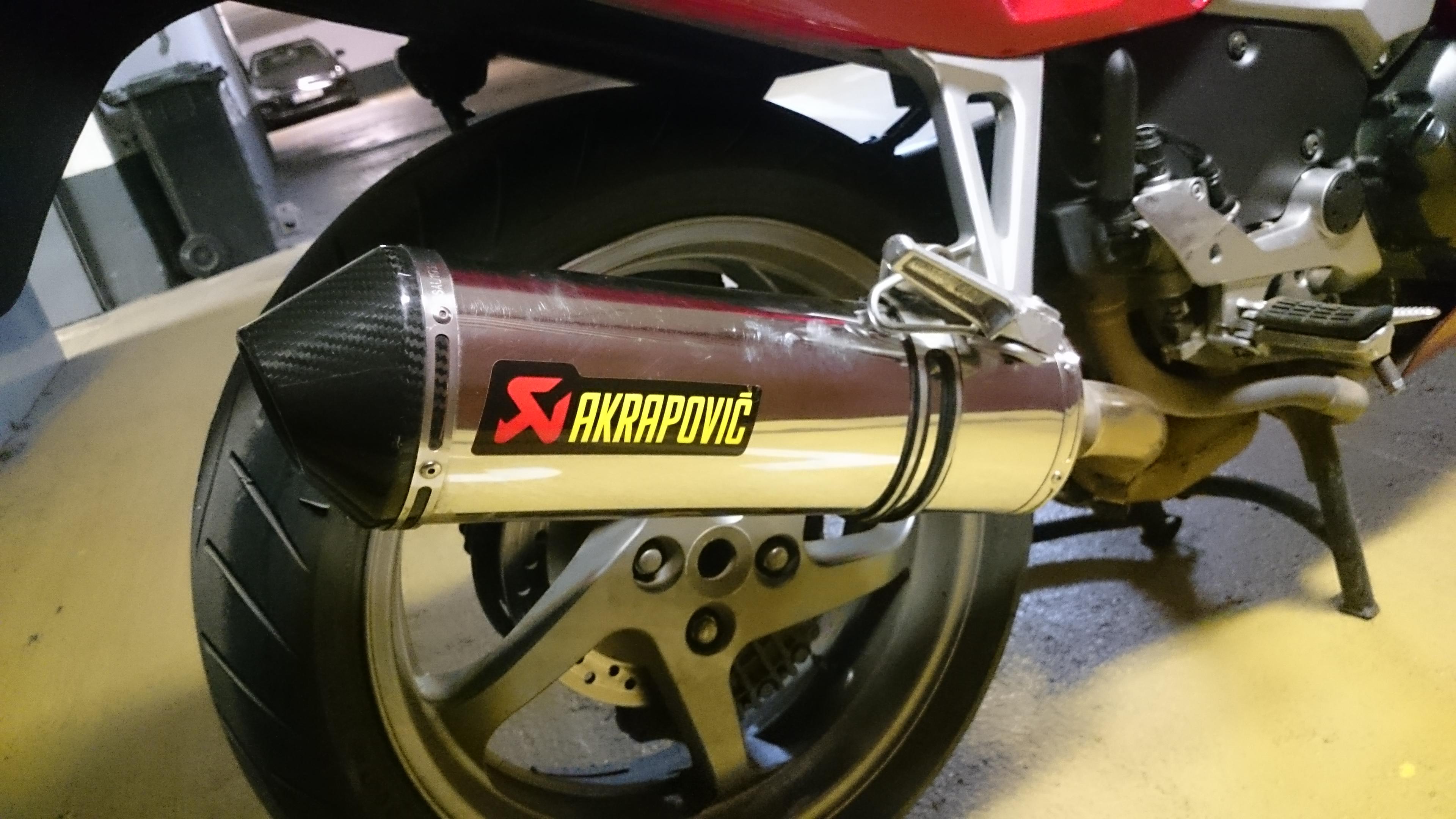

SportTouringCZ Posted February 8, 2018 Author Posted February 8, 2018 I have promised some photos so here they are. btw: I know that is NOT an Akrapovic can. It is Viper (UK version) and the sticker had been put there by previous owner (and it looks kinda cool so I´ll keep it that way ) . The original exhaust tip is safely stored in my wardrobe for MOTs

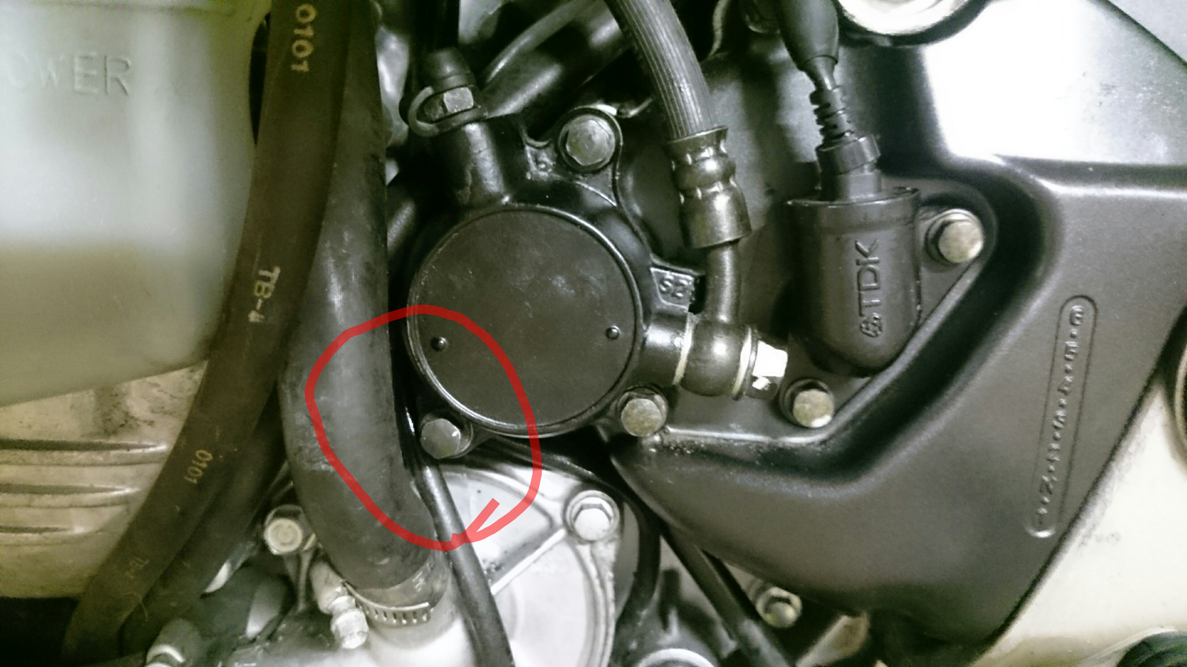

SportTouringCZ Posted February 10, 2018 Author Posted February 10, 2018 Hi again, I started working on the bike today. So far I have taken down the fairaings, finished " the drill" (all good except the idle volts are higher than mentioned in "the drill". Is it going to be ok?). I have spent the rest of my time with VFR cleaning the chain ( you cannot imagine how bad it was) ... I discovered three problems during the cleanup 1) missing plastic clips on some fairings (no problem, will buy them soon) 2) when i was putting the rear sprocket back on the bike, I noticed one of the bolts was stripped ( I will replace all the bolts and nuts during the chain and sprocket change) 3) the bolt I have circled on the photo has been turning freely... I can pull it out but it doesn't fall out. Question is what happened? Stripped thread or broken bolt? What can I do in both cases?
Member Contributer MaxSwell Posted February 10, 2018 Member Contributer Posted February 10, 2018 Possibility: the bolts are different lengths. It is possible you have them in the wrong holes. Suggest you take all three out, compare lengths and try them all to see if you can get all three to fit. https://www.partzilla.com/catalog/honda/motorcycle/2001/vfr800fi-a-interceptor/left-crankcase-cover look at part numbers 28, 29, 30, 31 and 32 in this diagram. (I'm going from my infamous memory.) Good luck.
JoelF Posted February 11, 2018 Posted February 11, 2018 If it's stripped you may be able to glue in a stud pretty easily. This could be heated and removed for a different type of repair later if desired. Loctite red or cyanoacrylate.
SportTouringCZ Posted February 11, 2018 Author Posted February 11, 2018 Fortunately it was the first case. MaxSwell should get a medal. There are two long bolts and one short. I didn't even suspect that one of the bolts would be longer by a few threads. Well it is... VFR now has fresh oil, filter and coolant so thank you for your help!!!!
