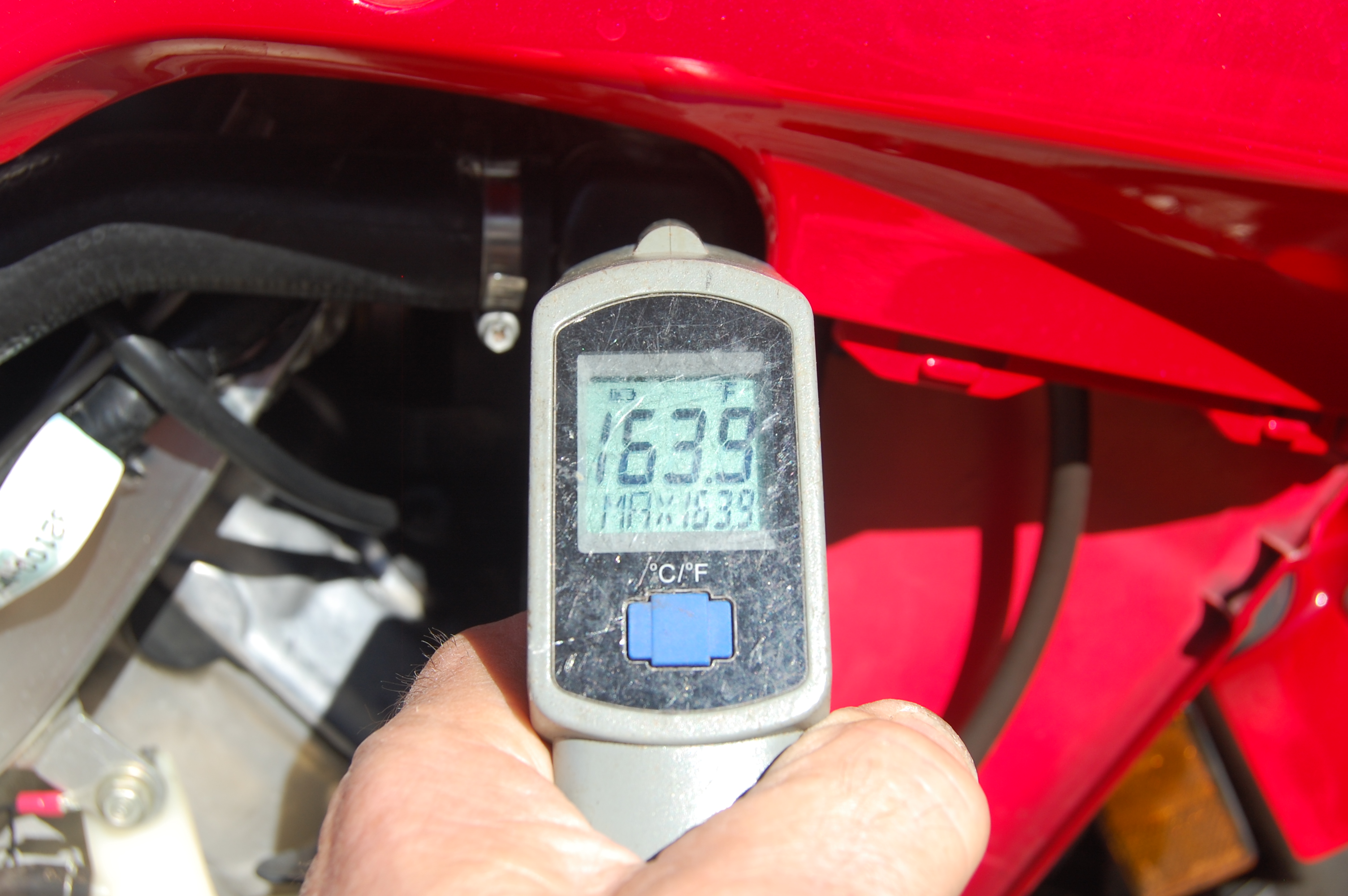

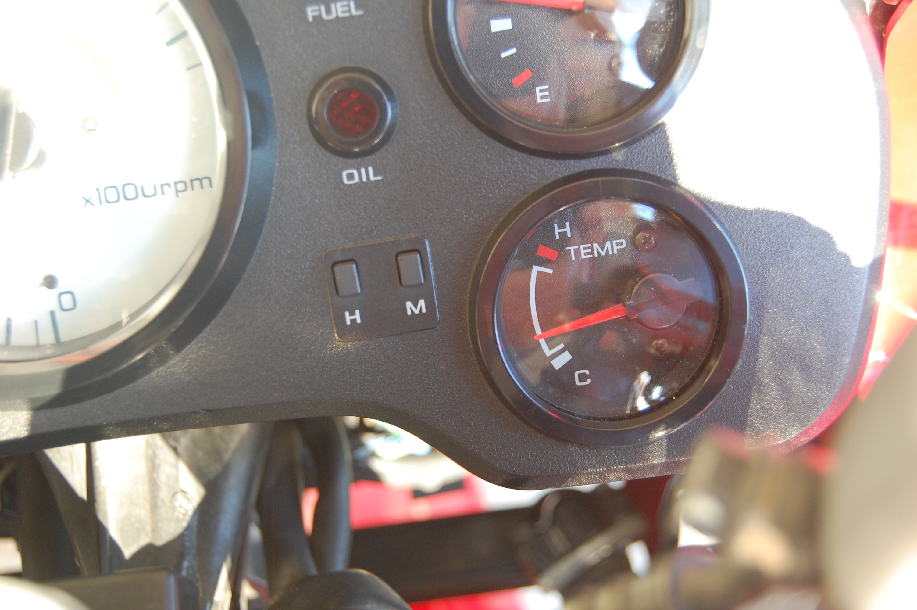

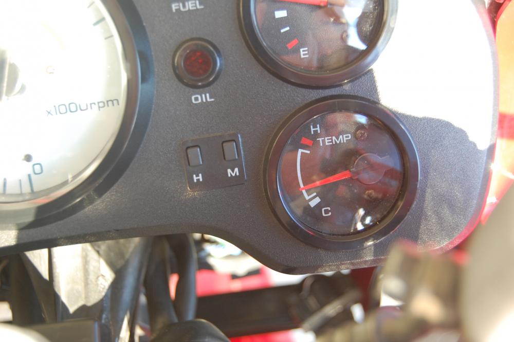

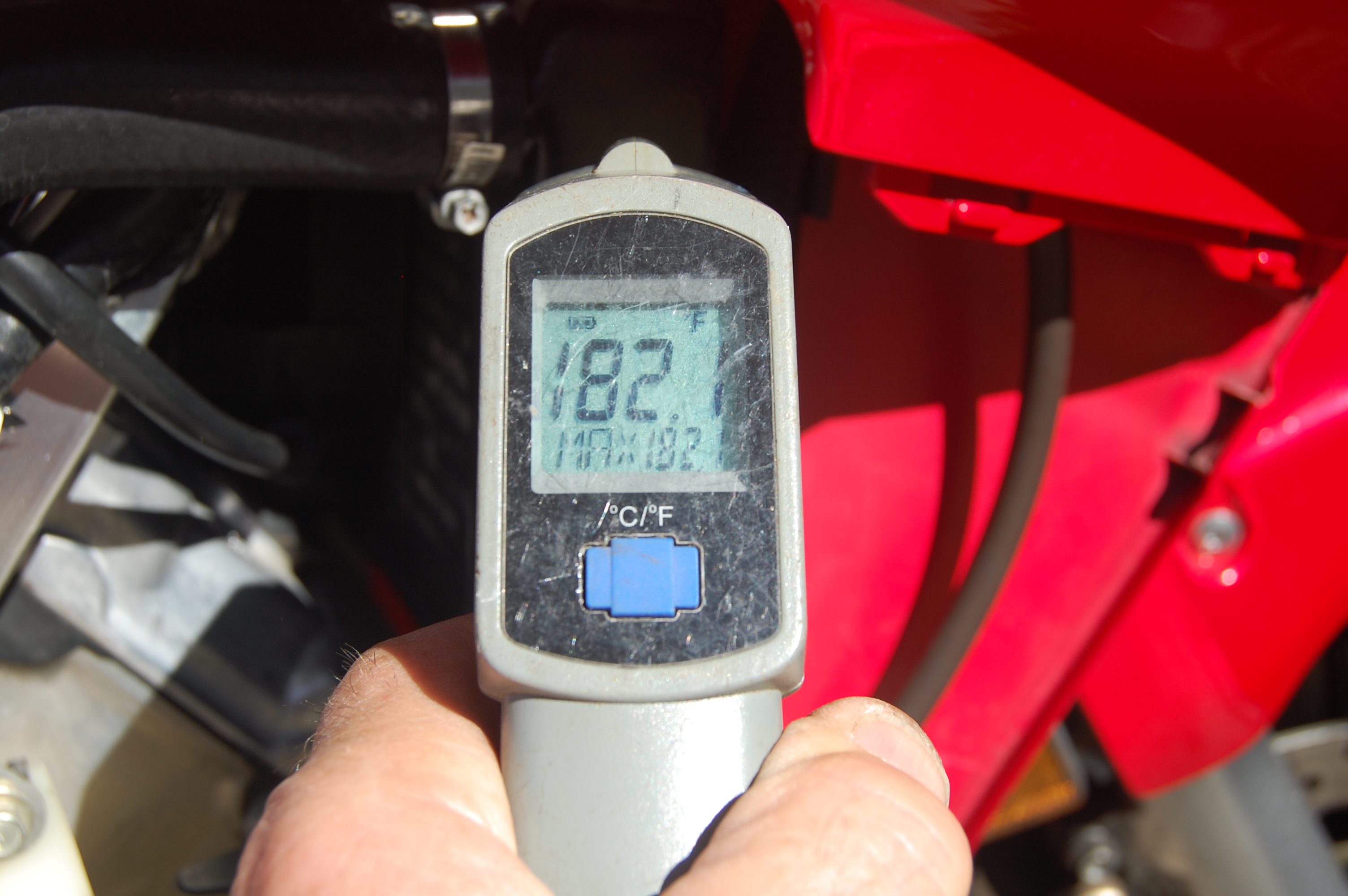

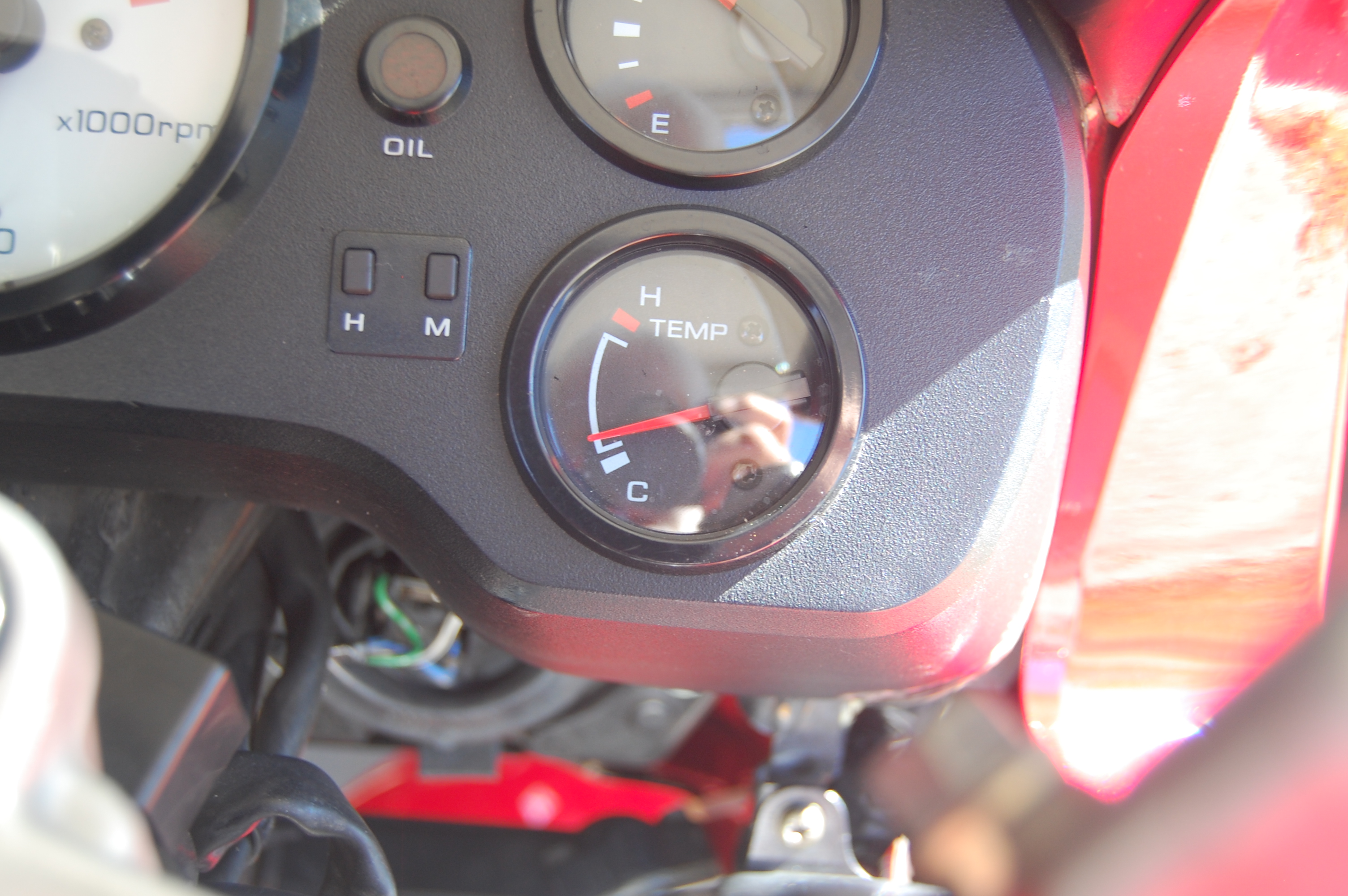

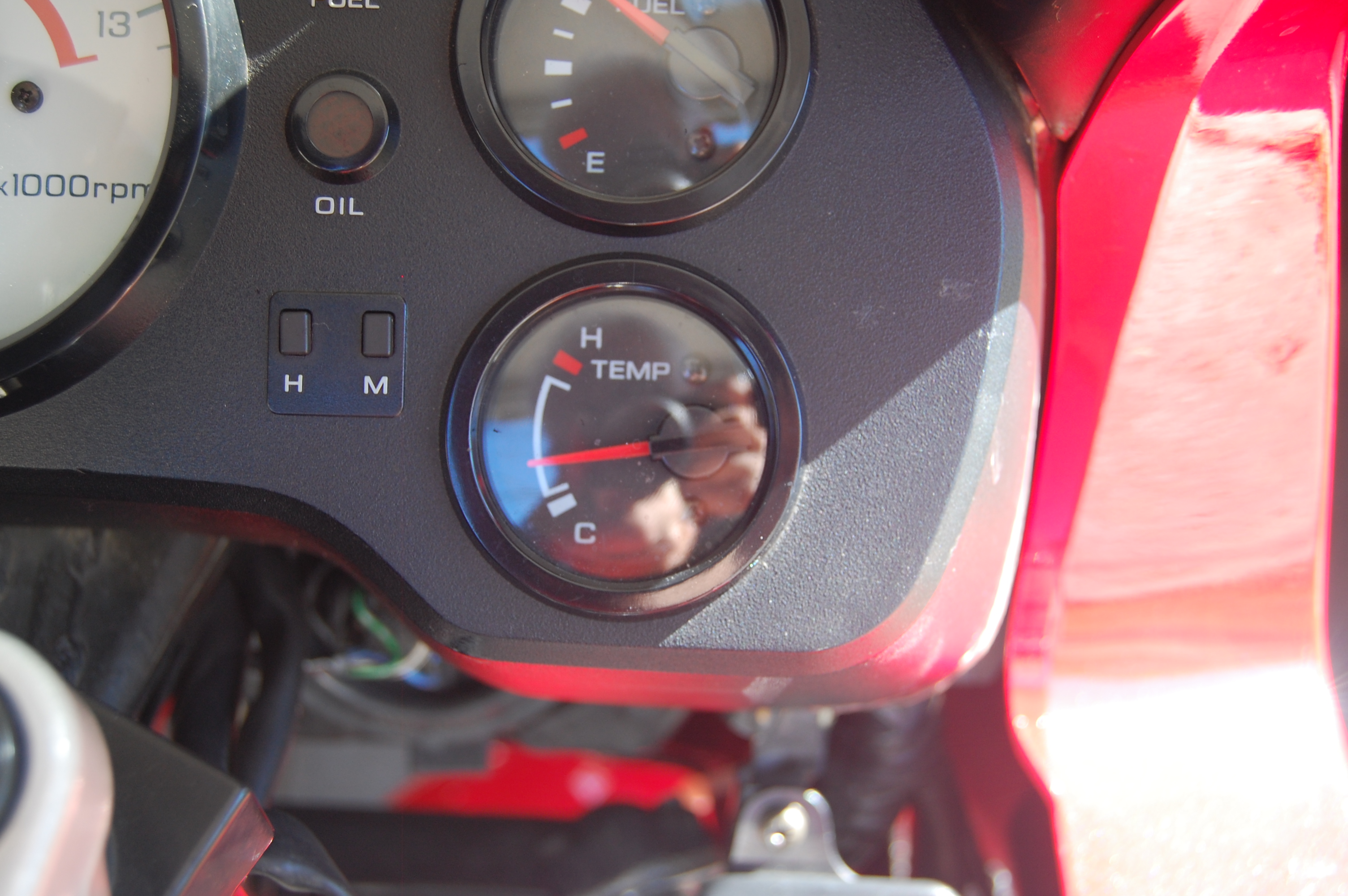

Member Contributer bykemike Posted November 30, 2017 Author Member Contributer Posted November 30, 2017 well, very interesting, I am going to conclude I have an inoperative thermostat. Sitting in my shop I ran it up until the fan came on at 199 deg F. That took more than 15 min. The radiator moved up from 80 deg F to 114 deg F a minute or so after starting, I have a few images here of the degrees and the gauge position. When I am driving I never see the gauge this high, in fact I seldom see it into the scale at all, except in traffic and the gauge tracks , to some extent, outside air temp. Fan comes on at just over 1/2 way up on the gauge. I would think this engine would run at least 170 degrees to be happy which would mean I would need to see a just under 1/2 gauge while running no matter what the outside temp is, I mean, that is the job of a tStat, to deny cooling unless it is called for, right? Quote
Rogue_Biker Posted November 30, 2017 Posted November 30, 2017 That last picture of the temp gauge...is that at 199 deg F? You're measuring radiator temp? Or Coolant Temp? The Thermostat will not open until coolant temp reaches about 172 degrees F. Then it will open up and is fully open around 185-190 deg F. I would wager that the red zone on your gauge is 230 deg F. Most liquid cooled, piston engines make the most power at 170-175 deg F. It produces the lowest emissions at 220 deg F. My VFR has a digital Coolant Temp reading and on cool days, running normal speeds, the bike maintains 172 deg F. But on warmer days, lower speeds in 2nd gear, the CT can get as high as 220 before the fan kicks in to bring it down to around 210-215 deg. Unfortunately, on a carburated bike, you don't have any other way to verify thermostat operation without just taking out the 'stat and testing it. ON FI bikes, if the 'stat is always open we would notice a much higher fuel consumption because the ECM will be pouring too much fuel in the engine thinking the engine is still cold....because it is. Quote

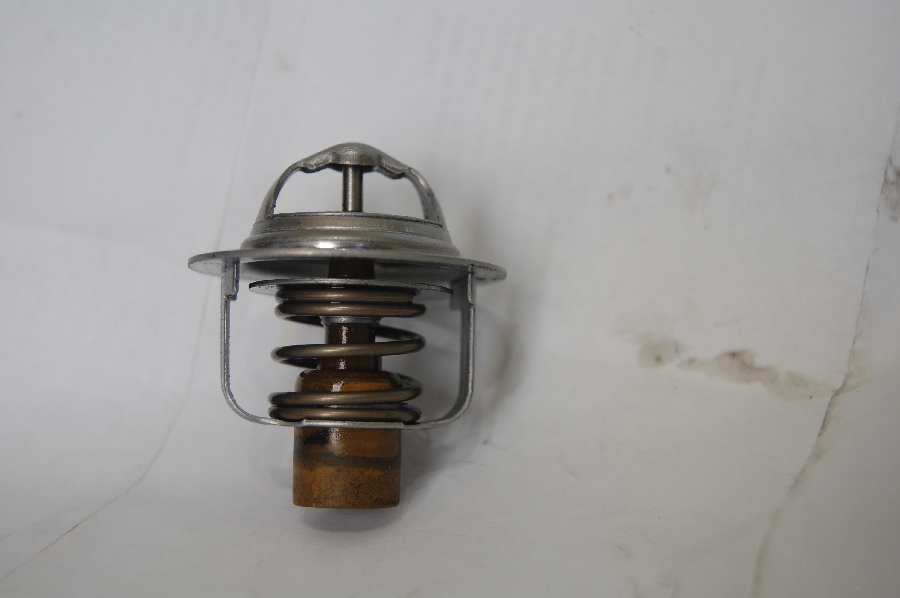

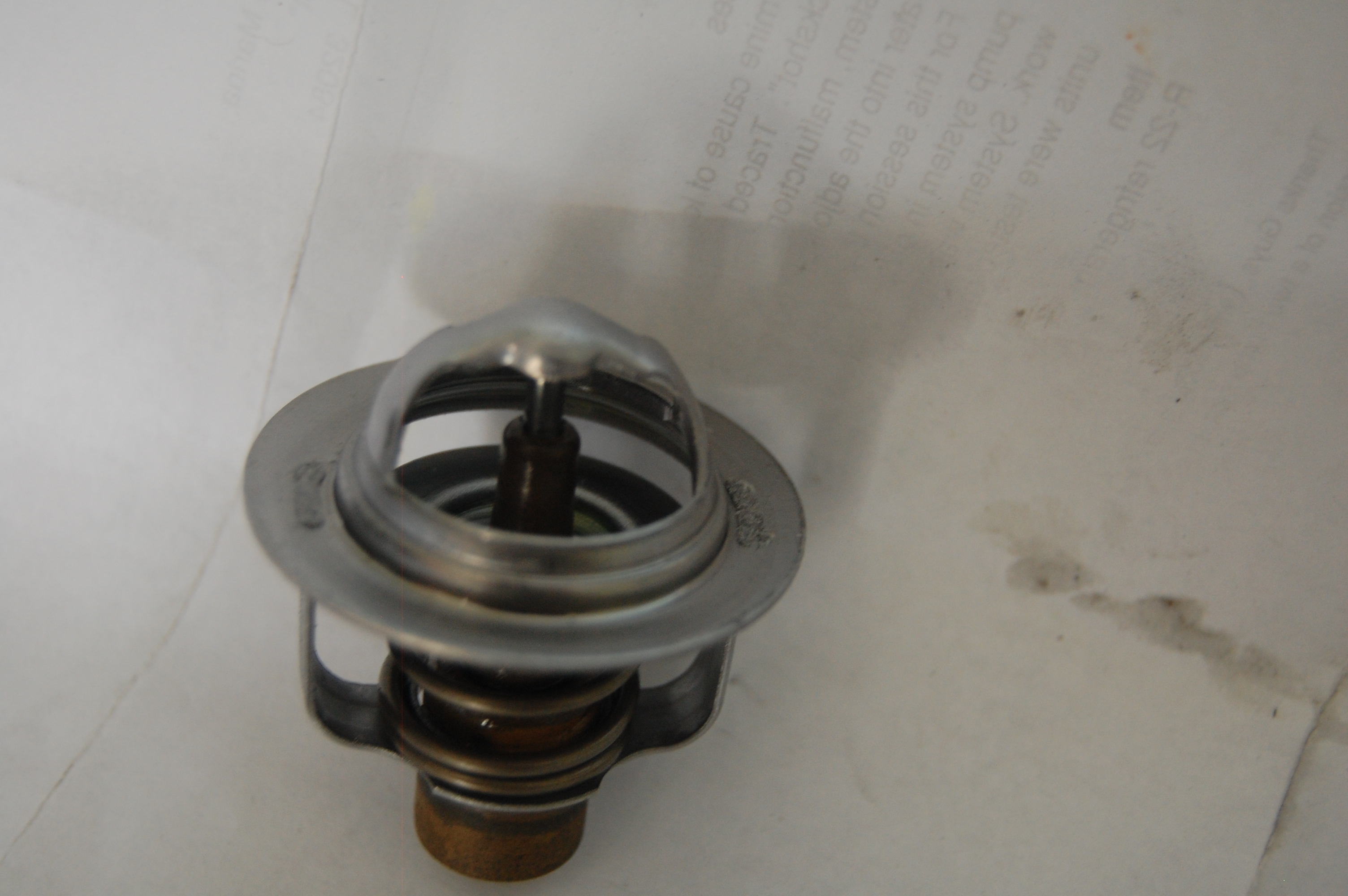

Member Contributer bykemike Posted November 30, 2017 Author Member Contributer Posted November 30, 2017 I went with method #2. Pulled the t-stat (30 minutes on a Gen 4) put it in the freezer for an hour and ta-daa, still wide open. Got one coming from Partszilla. My bike has been running too cold for maybe 4 years of its life except for the occasional traffic jam. PO told me "I have never seen the needle come up more than a needle width" BTW, I was reading top of radiator tank temp for ease and continuity but I checked the rear cylinder water jacket and it matched pretty close. Last picture was 183 F, fan came on at 199F, the gauge was just over 1/2, fan shut back off at 190 in just a couple min. Quote
