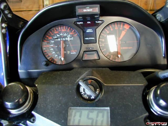

Member Contributer BusyLittleShop Posted March 18, 2017 Member Contributer Posted March 18, 2017 I racked up 98K trouble free miles when I sold it to Tod... Custom dash... Quote
