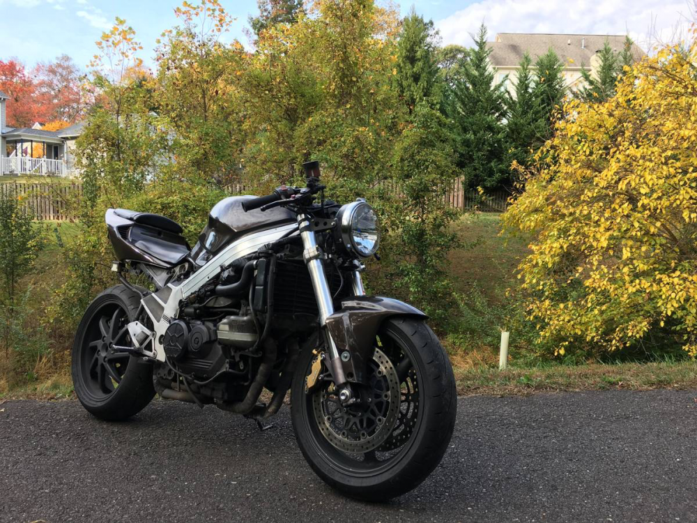

The VFR was done up as a streetfigher with some CBR parts (subframe, 929rr front-end) and overall ran pretty well, but needed some work. It was involved in slow low-side and it was suffering from the results of that lay down. It would have some trouble starting every now and then (starter clutch) and had a really loud knocking sound (heres a Youtube video of the sound), so those would have to be addressed. In addition to that, I wasn't a huge of the styling, color choice and especially the exhaust sound - way too ratty for my taste. After viewing some Youtube videos of what these bikes can really sound like, I knew immediately I wanted a deeper tone, but more on that later.
Here is how she sat when I bought her:

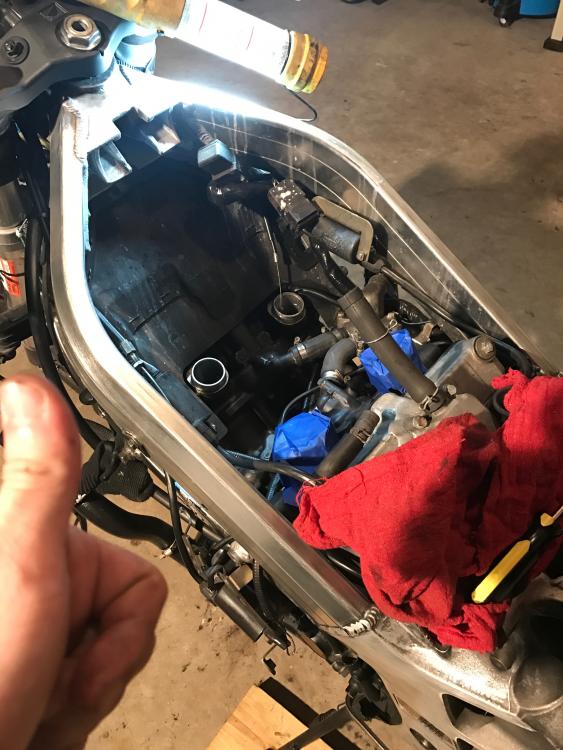

Bye bye CBR subframe

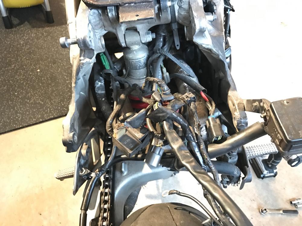

Poor frame was hacked up to bits :unsure: :ohmy:

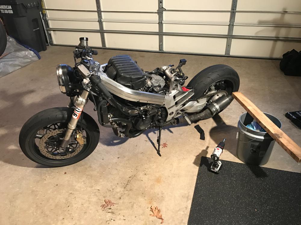

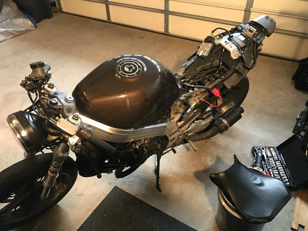

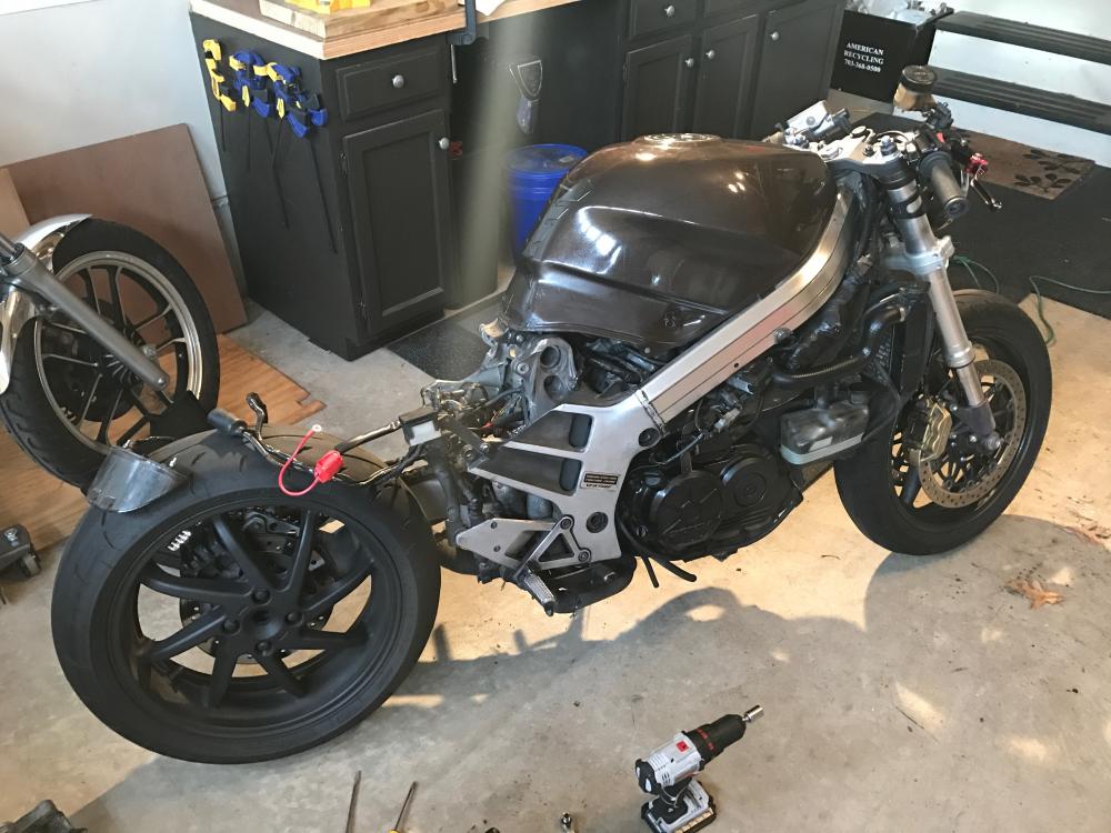

Feeling naked now!

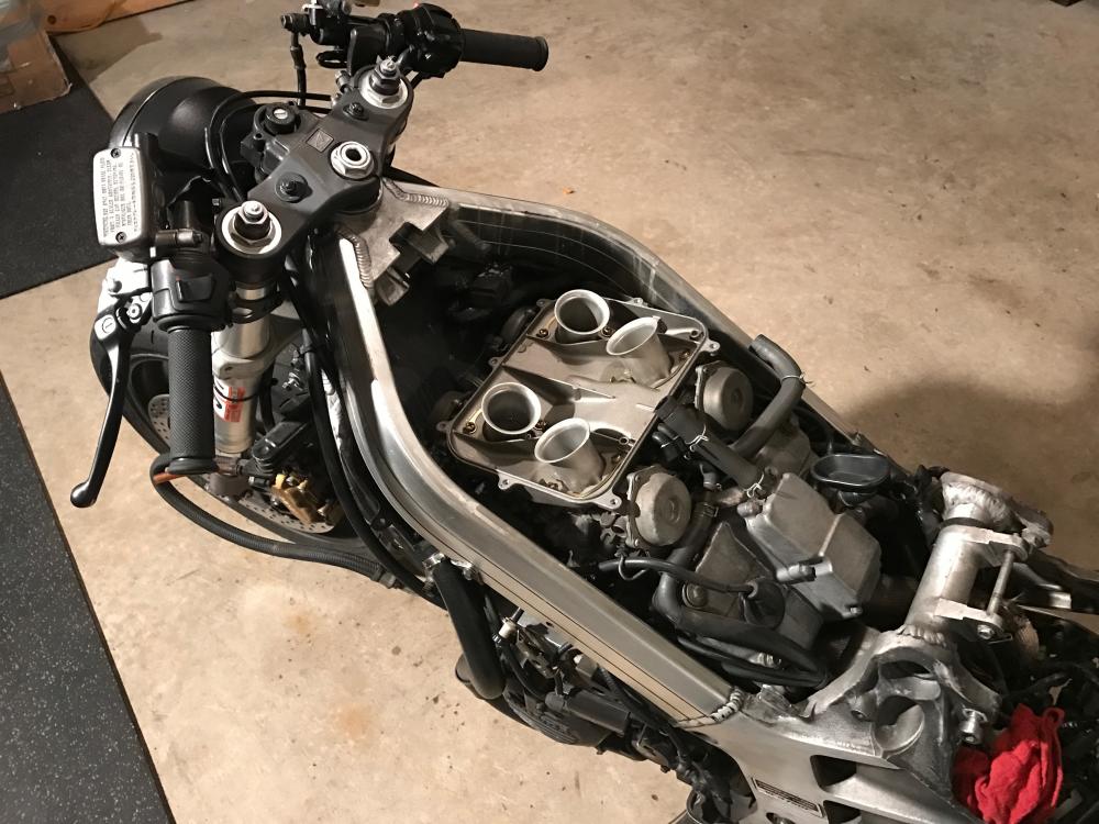

Mmmmm...Carbs
Carbs removed

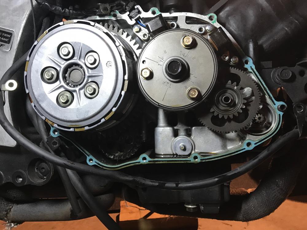

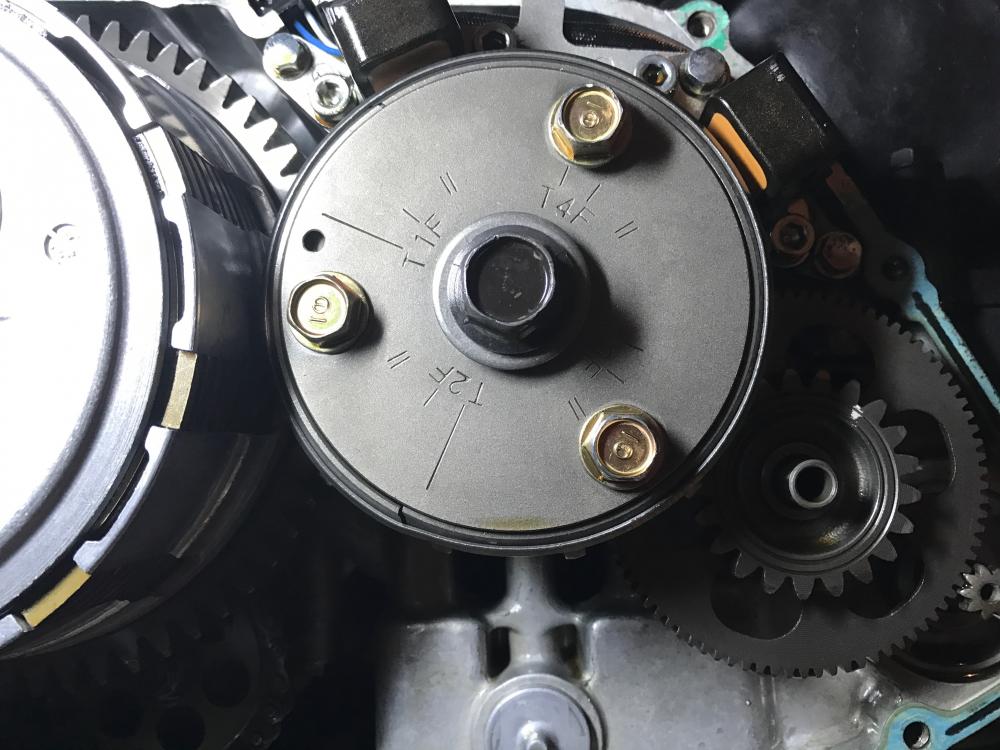

Crankcase cover removed...hmmm whats that?
Upon closer inspection, you can see the cracks on the outer rim of the starter clutch. Additionally, those gold bolts were so loose when I took the cover off that they were about ready to fall out. Glad I caught this before something really bad happened.

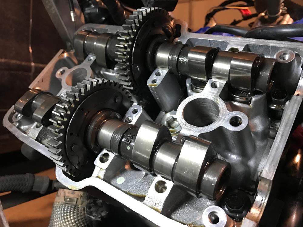

Houston we have a problem. Remember that "clackity-clack-clack" noise? Yeah, I found it. Blowing out lighters all day long. Also, check out that other bolt...WTF!? Hahaha

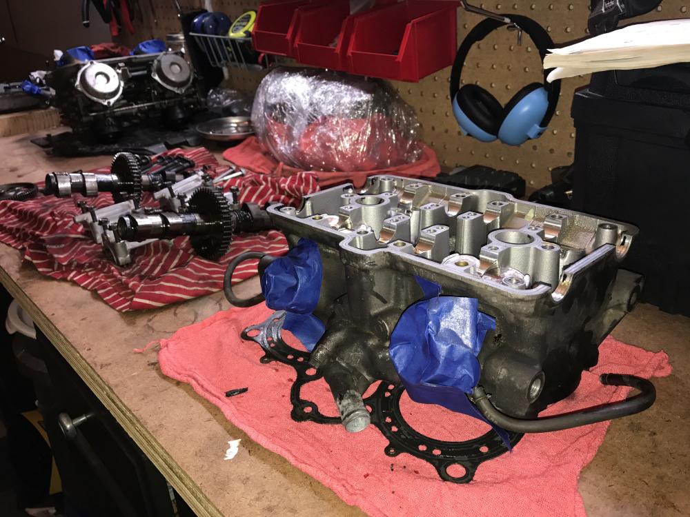

Front cylinder head removed. Gonna need a bigger bench!

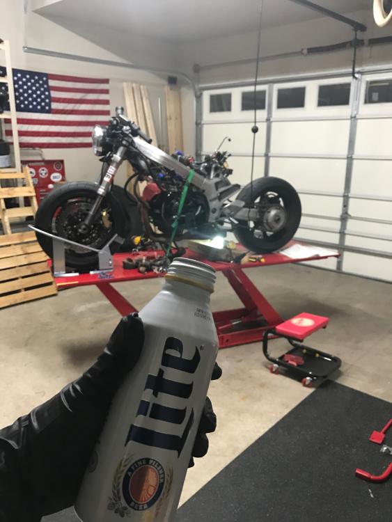

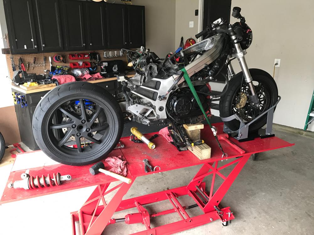

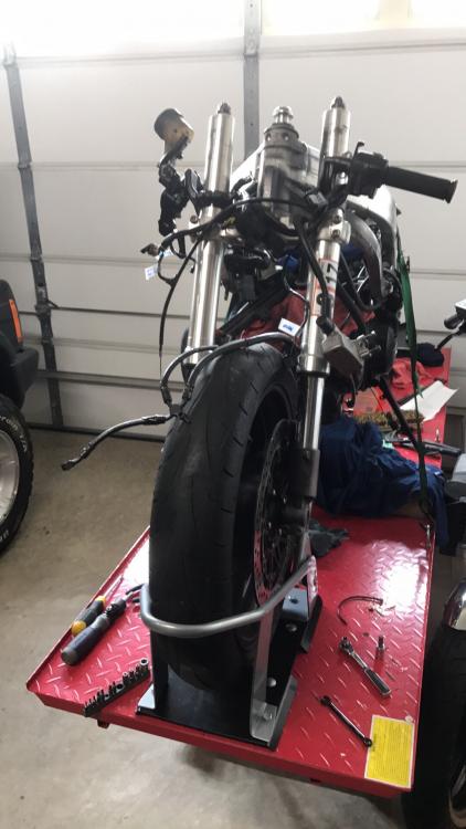

Score! Picked up a Harbor Freight lift for super cheap and threw on a beefier wheel chock. Much easier to work on the bike this way.

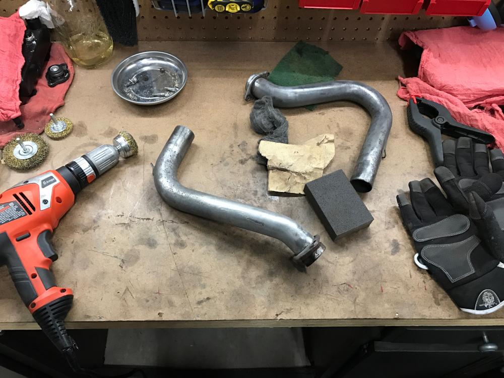

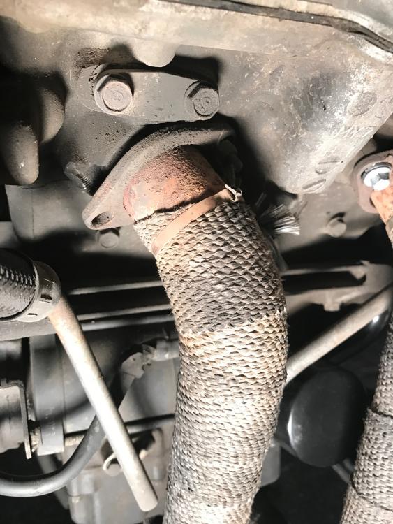

Removing the shock and Two Bros left-exit exhaust system.

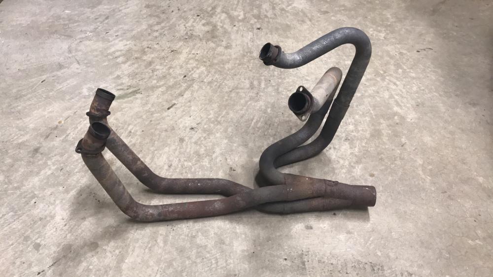

These pipes have seen better days.

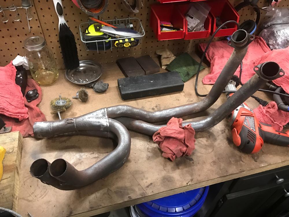

Trying to clean them up a bit. Its no sand or vapor blaster, but its helping.
Hey, not too bad!
