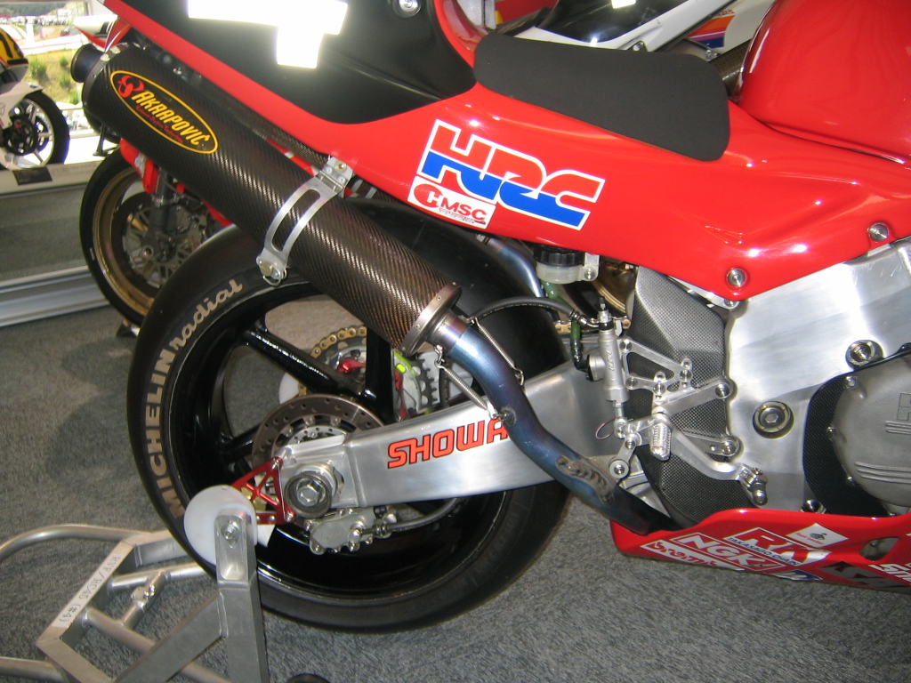

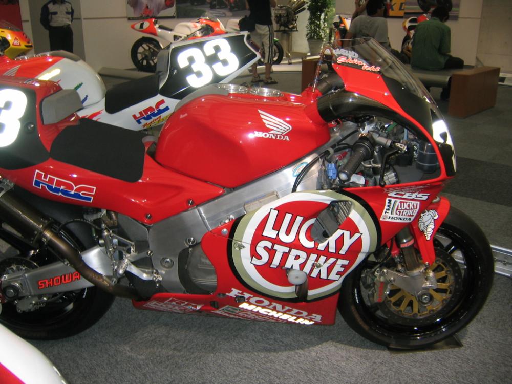

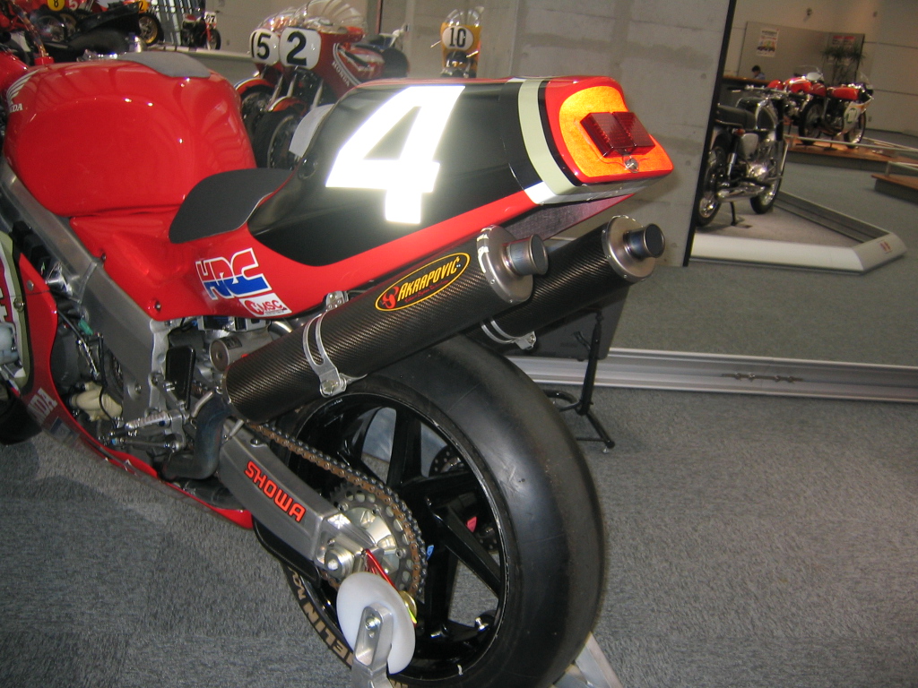

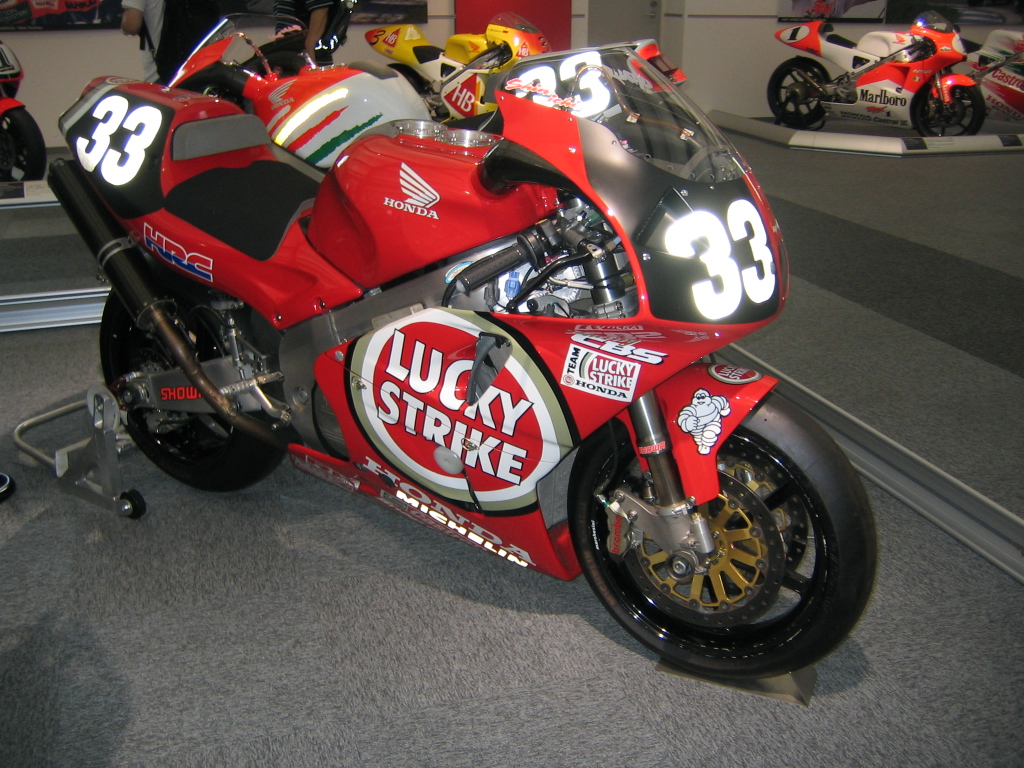

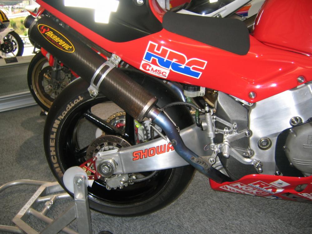

Member Contributer BusyLittleShop Posted February 6, 2017 Member Contributer Posted February 6, 2017 8 hours ago, monstar said: My intention is to make it a RC45 race replica... more specifically the lucky strike endurance bike. All Reeeeeeeeeeeeeet... Endurance Race RC45s are my favorite... I'll ante my Lucky Strike pics... I actually have one of these HRC double sided exhaust systems hanging in the shop... 1 Quote
Member Contributer sfdownhill Posted February 6, 2017 Member Contributer Posted February 6, 2017 Now that is pure endurance sex. How does someone come to have two Lucky Strike endurance RC45s? Quote

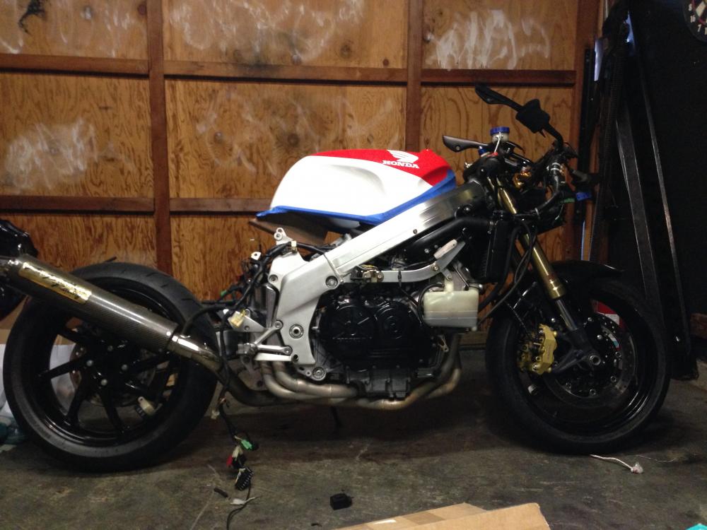

monstar Posted February 6, 2017 Author Posted February 6, 2017 Thanks for those pics. That's what I'm going for or at least mimic. I've seen the rvf project youtube videos but that website is down. Really sucks, I wanted to see the progress. I don't think I would be capable or want to mod the frame like he did... there's gotta be a dual sided swingarm that would work without changing the rear pipes and just shimming the frame. Anyway, here's a pic a the bike with the tank cover sitting on top. I still need the tail to get the tank/tail/subframe relationship worked out. Anyone know what's up with tyga-performance.com? I ordered from them a long time ago, wanted to place another order but forgot my password. The site says they sent an email to recover my password but I haven't got it. Plus, there's no contact info... seems sketchy now. Anyway I need some TYGA parts! Anyone? Quote
