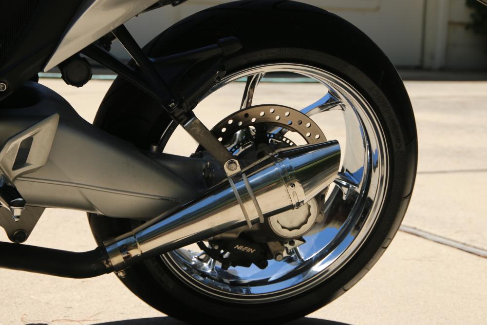

BLIGHT Posted June 30, 2016 Posted June 30, 2016 Hi Guys, I bought a set of used rims for my VFR1200 on ebay and had them chromed. I like the look, and think they make the porky VFR look a lot lighter and a bit 'sportier'. Here's a link to some more pics: https://photos.google.com/album/AF1QipOA-Kns44H9K-5_rvWlNM-ofCDvUTB07zoBE9an Major chicken strips, just put the new Conti-Attacks on, and rode around the block before the photos. BLIGHT
Member Contributer rhoderage Posted June 30, 2016 Member Contributer Posted June 30, 2016 Nice! I think this is the first time I've seen chrome wheels on a 7g, and I like it!
BLIGHT Posted June 30, 2016 Author Posted June 30, 2016 Thanks! It's not for everybody, but it looks nice with the silver bodywork IMO I had polished wheels on my 91 VFR750F years ago, and it was a beauty! I still miss that little 750! BLIGHT PS: Photo doesn't really show the shiny wheels... I'll look for another!
Member Contributer Switchblade Posted June 30, 2016 Member Contributer Posted June 30, 2016 Big girl looks good with shiny shoe's.
CandyRedRC46 Posted June 30, 2016 Posted June 30, 2016 More important than the chrome bling, Left exit exhausts! Moar pics pls! Time for a fender eliminator. The link to more pics doesn't seem to be working for me.
BLIGHT Posted June 30, 2016 Author Posted June 30, 2016 9 hours ago, CandyRedRC46 said: More important than the chrome bling, Left exit exhausts! Moar pics pls! Time for a fender eliminator. The link to more pics doesn't seem to be working for me. Hmmm, try this link to mo pics: https://plus.google.com/photos/107171422769758768095/albums/6299980649163107665 Also, here are some left exit pics (different muff): https://photos.google.com/album/AF1QipNzKgbbGsGfxM3SgjKngDJtOwbq89mtxpYZDOn5 I had to lower the muffler on the left to clear my OEM hard bags... I had it on there at a more jaunty angle before I got the panniers. There is no muffler 'clearance' pocket on the left bag so I had to make a heat shield and drop the muffler a couple of inches. I can't bob the fender (as much as I'd like) because those rectangular holes are where the bags hook on. I did unbolt the unsightly OEM license plate bracket and made my own... just compare the pics to a stocker and you'll see what I did. BLIGHT

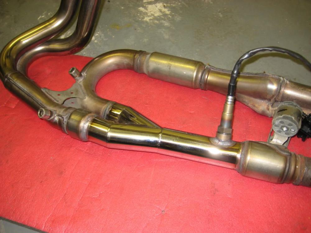

BLIGHT Posted July 17, 2016 Author Posted July 17, 2016 On 7/15/2016 at 9:49 AM, CandyRedRC46 said: Yes decatted and guhl tuned 1200's make stupid amounts of power. +160whp This is how I would de-cat (below) with adding a third 2 into 1 collector.... not just gut the cat chamber like some have done. .
CandyRedRC46 Posted July 18, 2016 Posted July 18, 2016 Man that is beautiful work. Who's header is that, is there a build thread for it? Are those race cats or resonators??
veeefour Posted July 18, 2016 Posted July 18, 2016 That is K5Dave's exhaust pic. I took slightly different route and removed a lot of rusty stuff form mine and I kept the stock cat can in place. Also fabricated some new parts so the system is now 100% stainless. Some pics:
BLIGHT Posted July 20, 2016 Author Posted July 20, 2016 On 7/18/2016 at 11:07 AM, veeefour said: That is K5Dave's exhaust pic. I took slightly different route and removed a lot of rusty stuff form mine and I kept the stock cat can in place. Also fabricated some new parts so the system is now 100% stainless. Some pics: Very nice work!!! But why keep the catalytic box, unless you want to stay "green"? Even if you gutted it, it's still not the best for power production ...no scavenging in the box. Just one more two-into-one would give that final bit of efficiency I would think...that's what the aftermarket NC30 and RC30 pipes had IIRC One more question... isn't the whole system stainless steel already?
BLIGHT Posted July 20, 2016 Author Posted July 20, 2016 On 7/18/2016 at 6:38 AM, CandyRedRC46 said: Man that is beautiful work. Who's header is that, is there a build thread for it? Are those race cats or resonators?? Those little chambers are on the OEM VFR1200 headers. I think they are resonators since they have a perforated inner tube. They can be eliminated or left in place with little or no effect on performance. Honda uses them on many of their motorcycle header systems. Not sure who built these pipes, but they are stockers simply with the cat chamber removed, and a 2 into 1 S.S. collector welded into it's place. They also welded in a single O2 sensor after that final collector. Nice! BLIGHT
veeefour Posted July 20, 2016 Posted July 20, 2016 53 minutes ago, BLIGHT said: Very nice work!!! But why keep the catalytic box, unless you want to stay "green"? Even if you gutted it, it's still not the best for power production ...no scavenging in the box. Just one more two-into-one would give that final bit of efficiency I would think...that's what the aftermarket NC30 and RC30 pipes had IIRC One more question... isn't the whole system stainless steel already? The can was left if place to stay "green" as noted - just to stay "civil" with authorities It's faux in this moment - the outer shell only. The real "straight" pipes are inside. Pic no.4 shows it's 2>1 collector. It's mostly stainless. Rear pipes, flanges, stop rings and those little "chamber" mufflers are mild steel. Mine stop rings already started to rust. Pic. no. 3 shows mild steel parts. Also, I changed the outer pipe dia. to 2" to match my Akrapovic. Akrapovic actually has 2" inlet but it was reduced with 5mm thick gasket to mach the OEM cat outlet pipe. Stock outlet pipe is like 43 mm(50,8 mm now).
CandyRedRC46 Posted July 20, 2016 Posted July 20, 2016 6 hours ago, BLIGHT said: Those little chambers are on the OEM VFR1200 headers. I think they are resonators since they have a perforated inner tube. They can be eliminated or left in place with little or no effect on performance. Honda uses them on many of their motorcycle header systems. Not sure who built these pipes, but they are stockers simply with the cat chamber removed, and a 2 into 1 S.S. collector welded into it's place. They also welded in a single O2 sensor after that final collector. Nice! BLIGHT Okay that makes sense. I know that the 3rd gen had a resonator box, I think the 98/99 non catted headers were resonated and even the aftermarket Motad headers have the inner diameter of the collector wrapped in a steel chicken wire like mesh. My Two Brothers Racing headers have no sound deadening material and man can you tell, they have much more resonance and rasp to them than any other VFR. I can imagine that the resonators and catalytic converter on the 1200 probably cancels out some resonance and rasp as well. I would like to hear one with a modified header.
BLIGHT Posted July 20, 2016 Author Posted July 20, 2016 10 hours ago, veeefour said: The can was left if place to stay "green" as noted - just to stay "civil" with authorities It's faux in this moment - the outer shell only. The real "straight" pipes are inside. Pic no.4 shows it's 2>1 collector. It's mostly stainless. Rear pipes, flanges, stop rings and those little "chamber" mufflers are mild steel. Mine stop rings already started to rust. Pic. no. 3 shows mild steel parts. Also, I changed the outer pipe dia. to 2" to match my Akrapovic. Akrapovic actually has 2" inlet but it was reduced with 5mm thick gasket to mach the OEM cat outlet pipe. Stock outlet pipe is like 43 mm(50,8 mm now). Thanks for the info... I can see clearly now the rear header tubes are carbon steel up to the joints. I forgot they had the 2 clamps there.... I was trying to see how Honda had welded carbon and stainless successfully. I've never tried it, but I hear it's possible using a compatible filler like 309L SS between 304L and carbon steel. Clever to put your 3rd 2 into 1 collector inside the lunch-box! Nice work! BLIGHT
