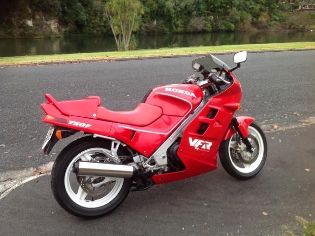

I have just bought a RC24 with a build date 5/89. It has 41,000 miles on it. It runs nicely and is not massively overshadowed by either of my two more modern bikes, in fact sits nicely in between them in terms of riding experience.
I had always wanted a RC24 and one with the 17 inch wheels thinking they were otherwise the same. However there appears to be quite a few differences. Is there a good reference site that outlines the differences anyone has found?
So far, other than the wheels, I can determine the fairing is different (3 piece + adjustable screen), speedo has a fuel gauge, pillon peg hangers, and front suspension (no antidive and 41mm over 37mm) and it grew in weight by 4 kilos.

Your front indicators are different than the North American 86-87s, and you have a different bump pad on the solo cowl.
Also, the grab rail at the back. My '86 did not have that.
Good find, it looks new. Wish we had gotten those here.

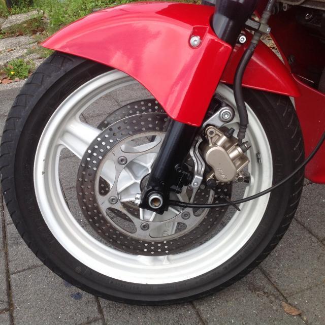

Thanks VFRBert a very comprehensive list. There is no TRAC markings on the larger suspension, was the anti-dive removed or is that those workings are on the fork behind the axle?

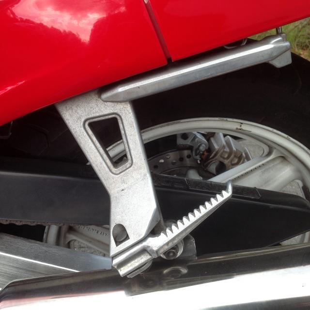

From looking at photos on the net, also seems the rear pillon peg holder was changed. There is also a fold out bungee cord hook behind each one.post-23773-0-87769100-1402110041.jpg

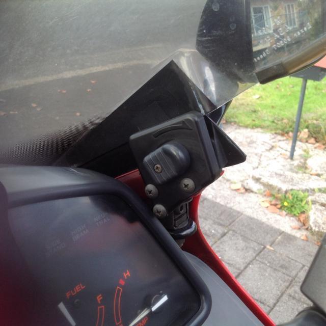

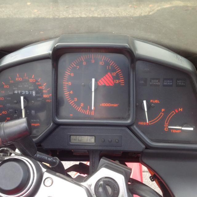

New Zealand got both the round and the square dials. Personally I like the round ones and probably easier to read, these square ones are not easy to read on the fly. The numbers are very small. The fuel gauge is pretty accurate, when it reads empty you go onto reserve. The clock would be handy too, if I set it properly.

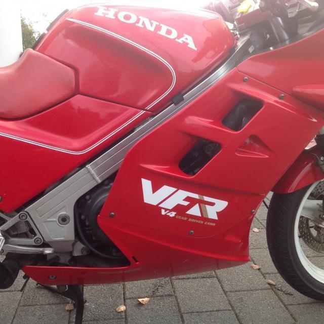

The three piece fairing is longer and little of the engine is apparent.
The right middle fairing is fibreglass so must be a replacement after a crash. They have done quite a good job from the outside but you can see the matting when looking in.

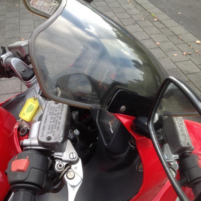

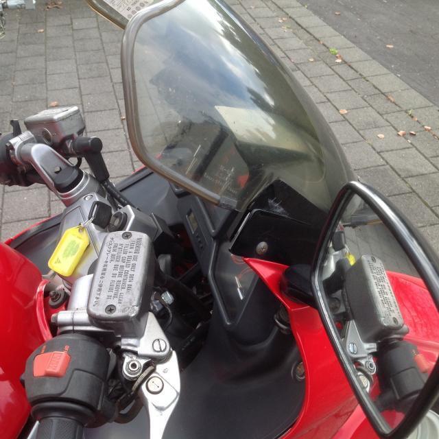

Somewhere in that motor must be some bigger valves fed by bigger carbs. A feature I like is the adjustable screen. Though when I park it, I drop the screen as it looks better lower.

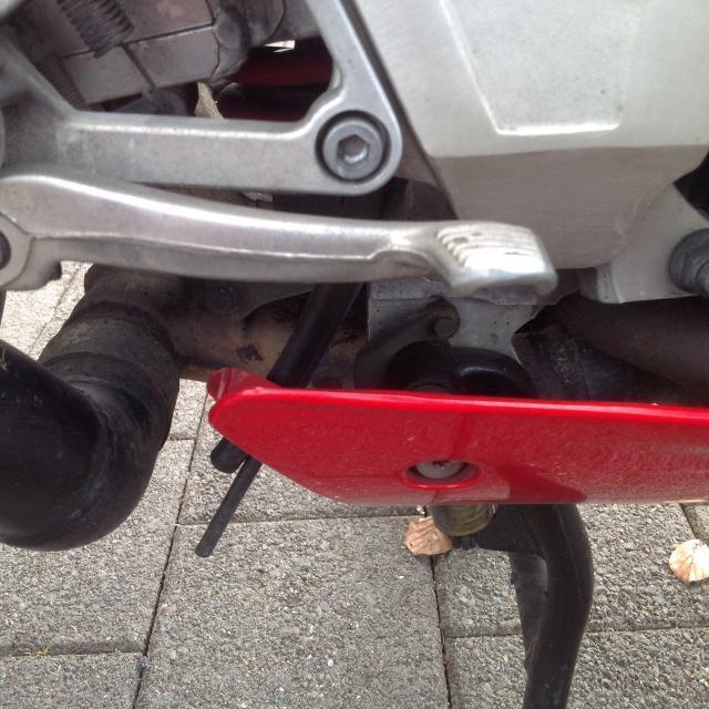

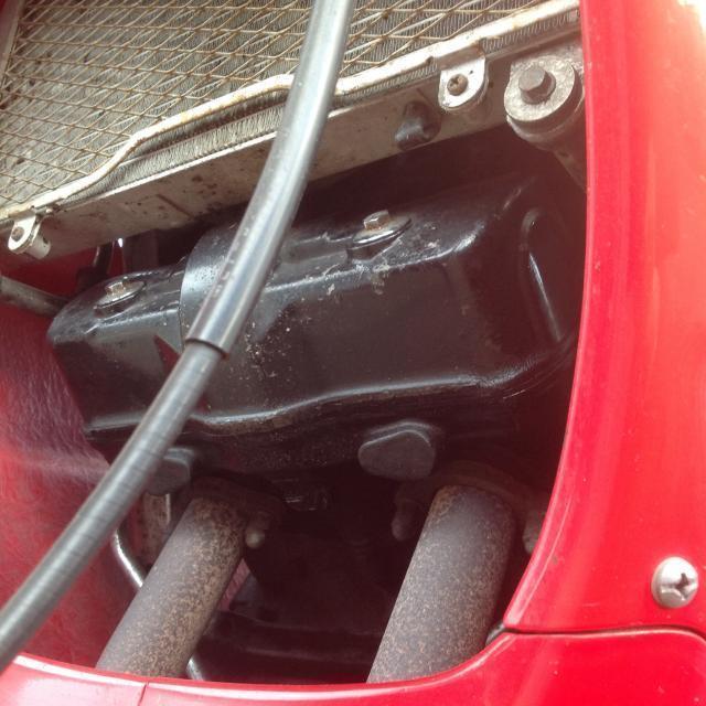

I could not see a collector box but maybe that has been replaced, just a whole lot of pipes in there.

The track system is still on the 89 model, you can see it on the left fork, witch is differen tfrom the right one.
If there is no collector, big chanche they replaced it with the pipes from the '86 model, wich i prefer. Most collectors are rusted away. The '86 pipe system stay's intact. The bigger valve's and carbs are for improved midrange power, giving better drivabillity on the road. There was no improvement in horsepower.

The 88-89 RC24 also had a taller screen as stock. The rear subframe is different (like someone noticed passenger pegs that where removable) as indicators. The engine had also different heads so scruw valve adjuster where replaced whit shims. Fuel light of the older where also replaced by a fuel gauge, so tank might be different also. Ignition system was also diffrent
