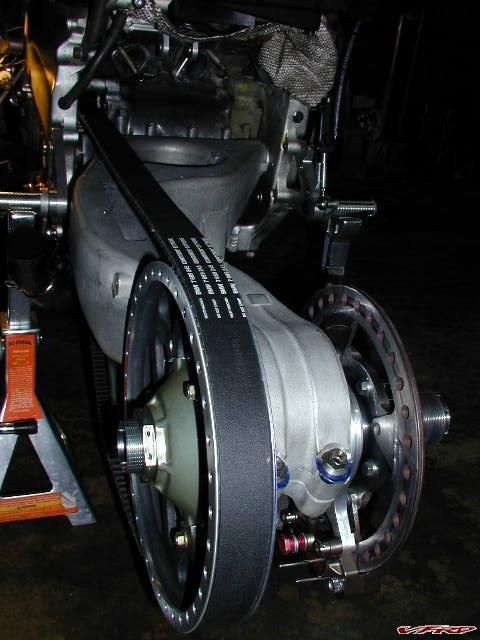

Member Contributer BusyLittleShop Posted December 5, 2011 Member Contributer Posted December 5, 2011 Pit Bull stand work great in getting the wheel off but if you wish to adjust the chain or remove the swingarm... you need a pair of hard stands under the foot pegs... Quote
