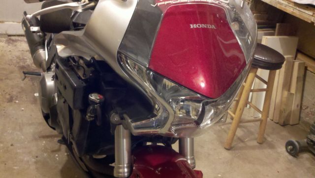

I began with a strip down of the basic plastic removal around 3am in the morning, I work nights anyway and well it is a quiet time for me with no interruptions from nosy family members! That took no time at all I am getting pretty good at removing the plastic.

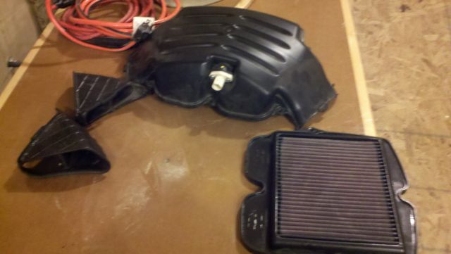

Top cover and air filter removed

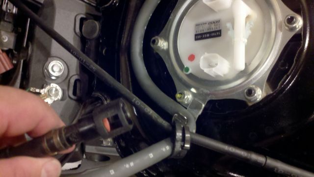

Fuel tank Quick Disconnect

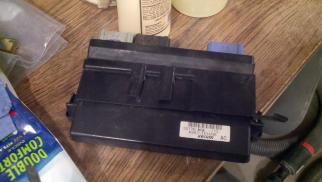

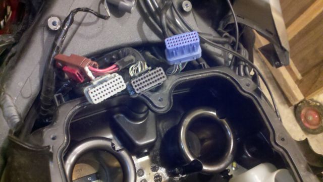

vfr1200f ECM
Top cover and K and N filter
You can see the ecm connectors here

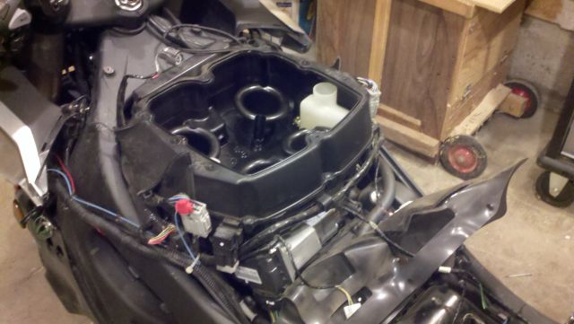

removed the rest of the air box

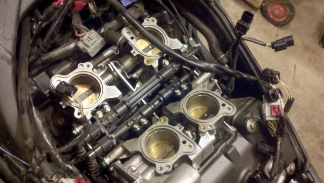

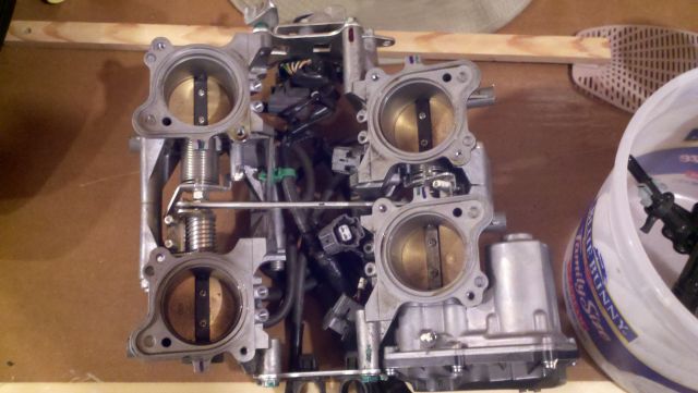

Removed the throttle body

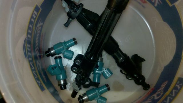

Fuel rails and fuel injectors

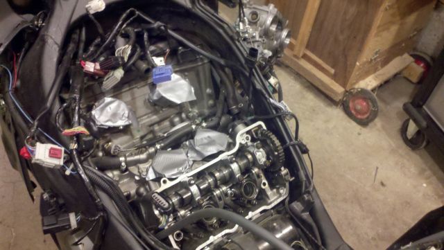

Covered the intakes with tape to avoid anything getting into the engine

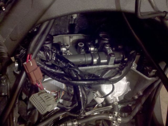

Removed the front cylinder head plastic heat shield
Yes you have to remove all that just to get to the front spark plugs, lucky they use high mileage iridium spark plugs with a 30k lifetime so you are going to have to inspect the valves before hand before you have to replace them - I did that and they all looked fine. I had all of my exhaust valves just out of spec those are the rocker roller set, and one of the bucket under shim intakes was loose but still in spec. Just as I figured the roller rocker design would be more apt to be out of spec then the bucket under shims would be, just like the CRX dirt bikes! Its a simple elegant design, less rolling mass with only one cam shaft and the cam chain does not need a huge bend in it for a powerful cam chain tensioner this design uses a spring loaded bow tensioner instead of a massive punch design like the vtecs use.

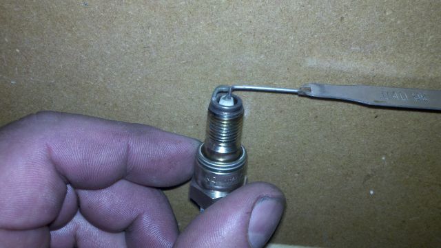

Gapping the iridium spark plugs
The front cylinder has very cramped working space

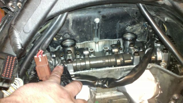

There are two marks on the timing cover I suppose its easier then the 4 I had on the old girl, you watch the cam shaft on the rear set for direction ques as you turn it to make sure the engine is in top dead center for the cylinder your inspecting all marked out in the manual but the manual has very small pictures for the cam shaft positions so its hard to read. I managed it though. They have 3 measurements for the Valve Clearance
Exhaust Valves have a roller rocker design with a roller on one end and a screw driver and lock nut on the other with a square head for the driver. They were all out of spec all of them!
The manual has two sets of measurements for the exhaust side
Valve side with the lock nut 0.03 + or - 0,02 mm or (0.012 + or - 0.001 inches)
Roller side 0.21 + or - 0.02 mm or (0.008 + or - 0.001 inches) my gap strips were in listed in both but came stepped up in inch sizes so I use the inch listings

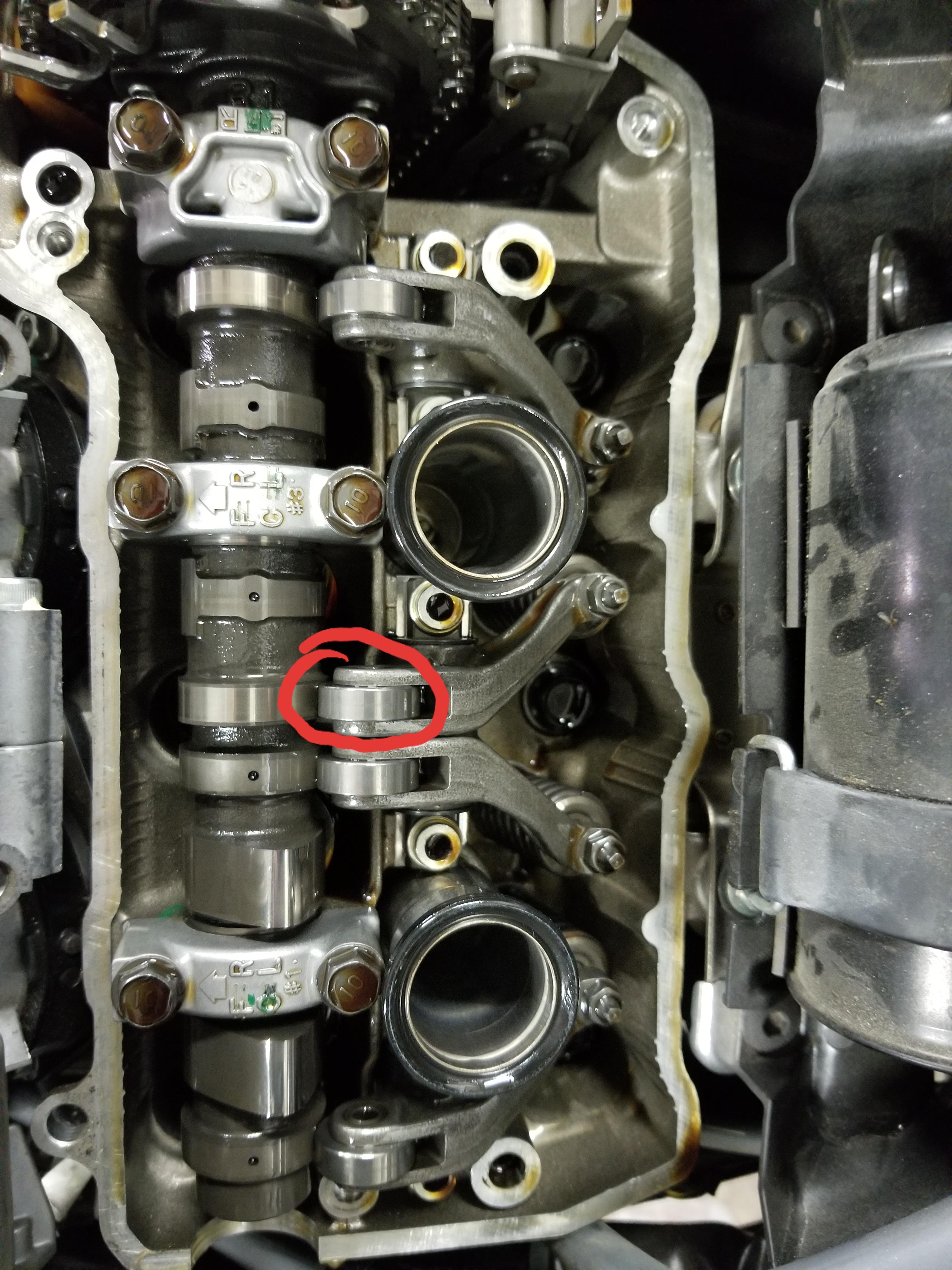

How do you adjust the rollers?
Like any other roller, gap gauge between the cam and rocker adjust the set screw till the gap is correct and tighten
Got my vfr all apart......
 I know how todo the shims, and I know how to ajust the tappets...... I know how to check the rollers and they have to big of a gap.... but it doesn't look like they have an ajustment??????

There is a set screw and lock nut on the other side of the exhaust roller arm that adjusts the exhaust valve roller/cam gap.

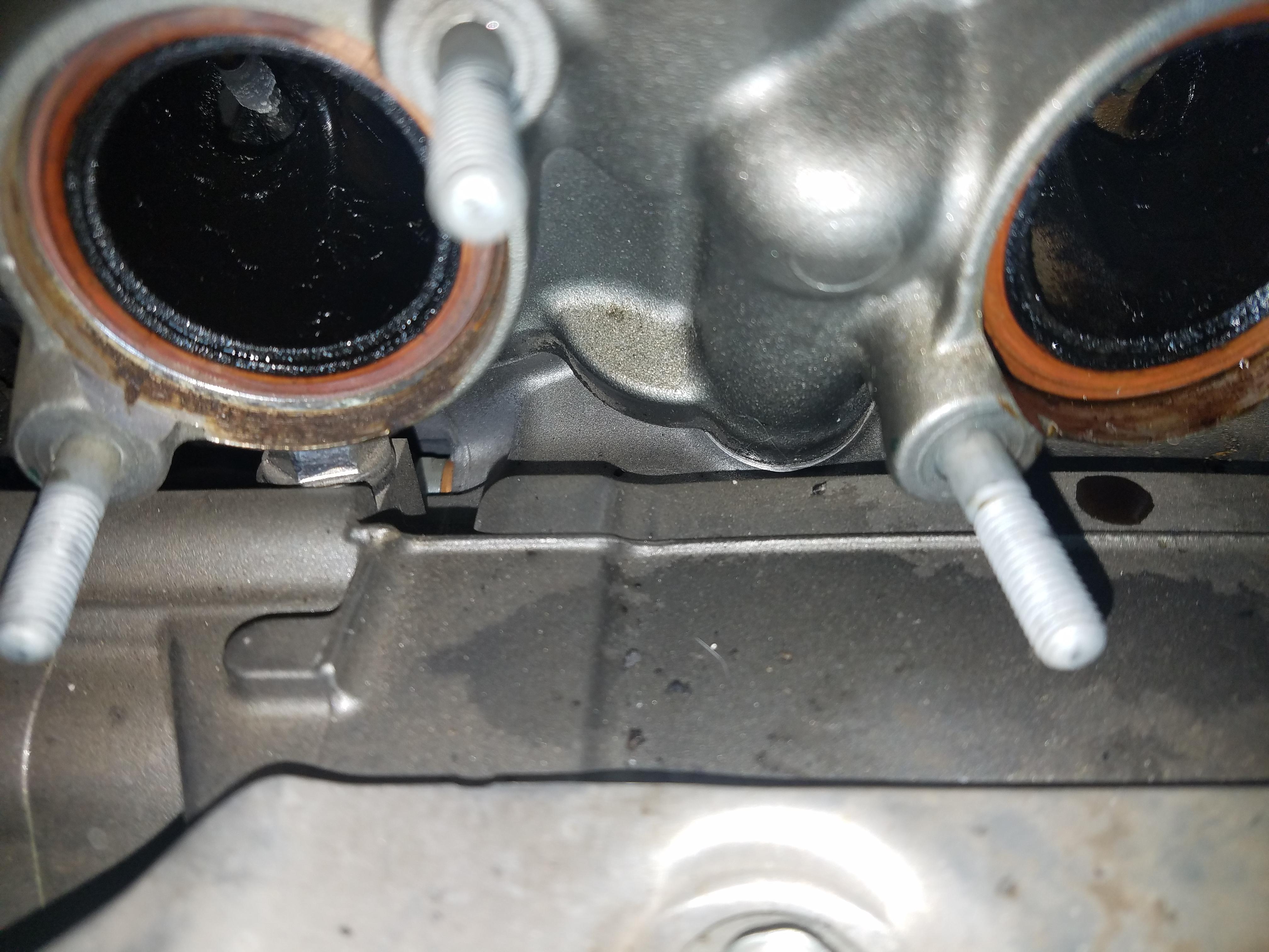

Be sure to replace the PAIR o-rings and use grease to hold them in place during install, or you'll end up with this:

So you take the rocker arm off, and the adjustment screw is underneath?
9 hours ago, JoeVFR said:
Rocker arm is not removed.  Start at the red circle and follow the rocker arm to the other end.  There is a locknut and adjuster screw there...clearly visible in the photo. Use them to adjust the gap between the cam lobe and roller.  Just like a see-saw...right side up, left side down.  So, if you have too large a gap at the cam/roller, just loosen locknut and screw the adjuster CW.  Did I mention the PAIR o-rings...
The manual clearly shows three gaps that need to be checked... shim under cam, tappet and roller. I know how to do the first two.
