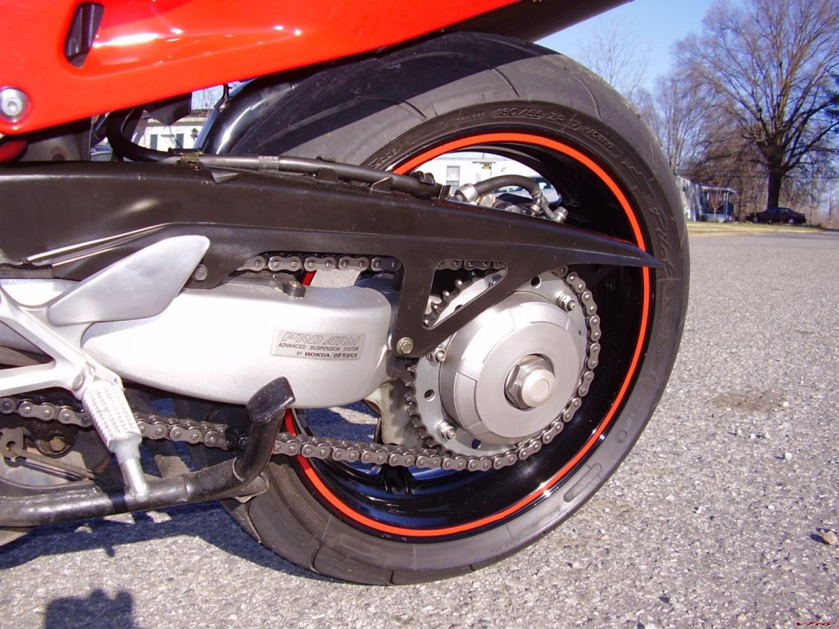

Guest itwrx Posted May 16, 2009 Posted May 16, 2009 (edited) Well got sick of the normal look so did some cutting. I had just installed a new chain and sprocket and wanted to be able to show them off more. Also went up two teeth on the rear sprocket. I love it!!!! What do yo think of my mod? Like it or hate it? :fing02: here is one close up. and one more just because I love my bike :fing02: Edited May 16, 2009 by itwrx Quote

Guest itwrx Posted May 17, 2009 Posted May 17, 2009 (edited) Thanks for the great feedback! I know the Corona stickers aren't everyone's flavor :fing02: but I had removed every badge on it except the Honda logo on the tank. I felt it needed some thing. Here is a photo of what the mod looks like when you look down at it parked. I like being able to see more of the chain. On a side note I removed the air glide (I think that's what it is called) does anyone know why it was on there to begin with? In case your wondering it is that ugly piece on the underside of the swing arm right before the rear sprocket. I think It cleans it up with it off. Also the nice thing about my mod is my size 14 foot can still rest on the chain guard allowing it to do it's job. I didn't remove any plastic where I need it. I still need to do a little finishing sanding but so far I like it. Edited May 17, 2009 by itwrx Quote

Guest itwrx Posted May 17, 2009 Posted May 17, 2009 (edited) Again,what did you use to cut the gaurd? Sorry I didn't see that. I used a drill for the corners and a aircraft air saw my brother had at his hanger... I don't know the name of it but Ill find it out. The blade went a LOT faster than a jigsaw. but a jigsaw may work? Ive tried jigsaws in the past and they haven't gone fast enough and seem to rip more than make smooth cuts in plastic. It was a lot more work than I thought it would be. My original design was a lot more complex looking but soon found out it would be way too hard. I may order a new one a try it again. But as you can see the cuts are rather close. You want to make sure it is a tool that you use you have good control over. Otherwise you may end up with one big cutout lol! Edited May 17, 2009 by itwrx Quote

enzed_viffer Posted May 17, 2009 Posted May 17, 2009 (edited) Again does any one know what the "air glide" was for? Other thank looking bad I can't figure out it's need. Is it the appendix of the vfr? :laugh: :laugh: The air guide presumably guides air somewhere. Why? Dunno. To make the bike go a poofteenth of a mph faster? Maybe it's bad Engrish, and it's supposed to be a "hair guide" to stop hair going into the rear sprocket (like when you have Rapunzel on the pillion seat). Oh - and "those ugly stickers" DougFromIndy was referring to are the ones for tire pressure, chain wear, etc. You don't need those; the chain wear one is useless (you should be able to tell when your chain is worn, and in any case, it won't work now you have a bigger sprocket on), and the tire pressures you should know. In fact, many owners use different pressures anyway. For a Clean Look, the only stickers/decals you need are the Honda logo, and maybe the VFR one. All warning stickers are teh ghey, and tire pressures etc belong in the owners manual. Huh. Just realised I don't have one of those. Anyway, your New! IMPROVED! lightweight chain guard is a definite hit. I removed the air guide years ago, but didn't think of cutting into the chain guard. Now I will. Edited May 17, 2009 by enzed_viffer Quote

Guest itwrx Posted May 18, 2009 Posted May 18, 2009 Here is a photo of it in better light. That's a good idea to remove the stickers. the one thing they do is make it look like a cool factory bike. :fing02: The guard Honda should have made LOL. But I do like the fact I could mod it while retaining the function of it. I think I'm going to order a new one and try my original design. Quote

Member Contributer XBMWRDR Posted May 18, 2009 Member Contributer Posted May 18, 2009 The Air Guide as you call it is also called a shark fin or chain fin; it is there to keep things like your foot from getting caught up in between the chain and sprocket. A friend of mine had a get off at a track day and his foot ended up being mangled because he didn't have such a fin; he recovered after several surgery's and a lot of rehab but he now has a fin on his track bike now Quote
