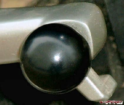

?art West-VL. Posted March 14, 2006 Posted March 14, 2006 Hi all, My first post here and instead of firing a load of questions, I'll start with some pics of how I'm trying to protect my bike if it would fall ... again! <_< I just put two round shaped black ball's in the hole's of the frame that supports the foot peg's of the passenger. (Sorry for the strange way I talk, I'm from Belgium and can't always explain the way I want to) Very simple, cost's almost nothing, these ball's are knobs from a standing drill handle. I put a little glue on the thread, so they would not get loose. With this I hope to protect the exhausts somewhat. I made some pics, but it was dark, so I'll have to redo that in daylight, sorry for the waiting, so much for starting with pics huh? :pissed: ?art Quote

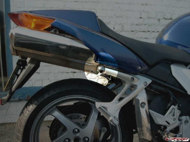

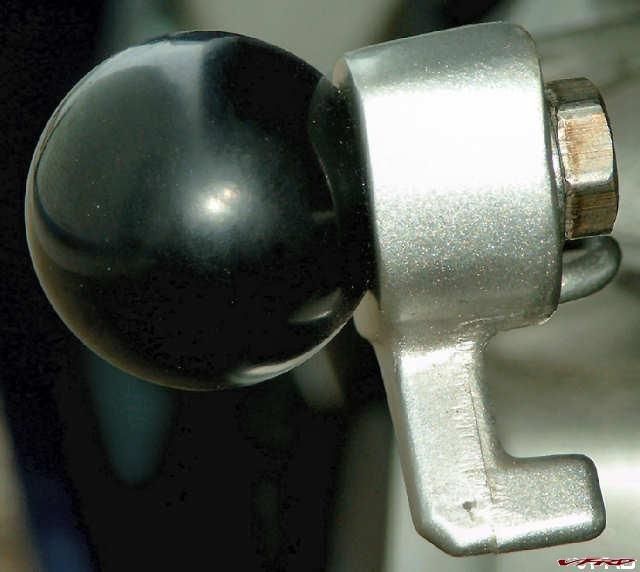

?art West-VL. Posted March 16, 2006 Posted March 16, 2006 Finally took pictures: border='0' alt='user posted image' /> border='0' alt='user posted image' /> The bolt was something that I had laying around, will change it to a nice round headed bolt. Diameter of the ball is 32mm (1?inch) 1 Quote

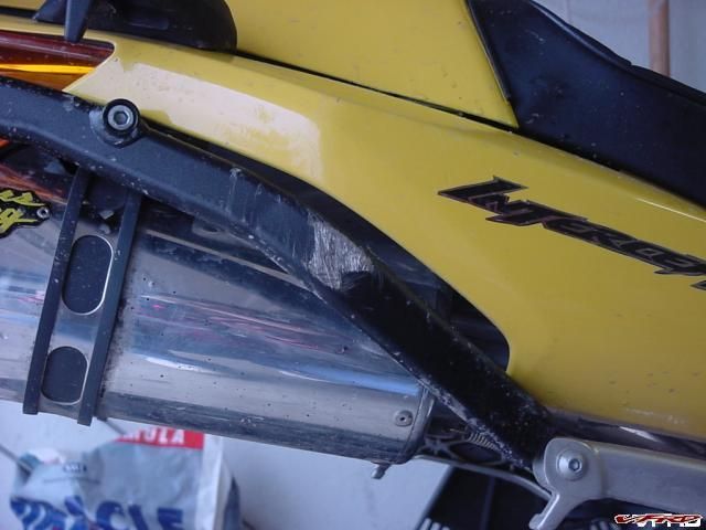

Member Contributer jeremy556 Posted March 17, 2006 Member Contributer Posted March 17, 2006 Finally took pictures: border='0' alt='user posted image' /> border='0' alt='user posted image' /> The bolt was something that I had laying around, will change it to a nice round headed bolt. Diameter of the ball is 32mm (1?inch) <{POST_SNAPBACK}> Did you highside or flip or something? My bike the lower part of the rear pegs toucheddown and a little on the rear fairing, didn't seem to come close to the exhaust. I am guessing you also got frame sliders for the front of the bike. Quote
?art West-VL. Posted March 18, 2006 Posted March 18, 2006 (edited) jeremy556, Sorry about the cropped picture, here's a wider angle picture. The way I figured it (theoretically): The 1?inch should be enough to protect the plastic fairing, just above that ball and the exhaust to (if the fairing would get ripped off in the slide), since the bike will balance towards the front, so the exhaust will tilt a bit upwards. This way I'm hoping that the bike will slide on the passenger foot peg + the small ball + the front slider (yet to be made) All this, of-course, on a flat surface. The front sliders are not yet made. Yes, I'm making them myself and no, there will be no drilling into the water tank, not even in the fairings! All for free and will post how I did it. This should be next weekend if all go's well. border='0' alt='user posted image' /> Sexy ball, ain't it? :unsure: Anyway, I figure it's better then that ugly hole in the flat end of that part. - Still working on getting that chicken trail wider... :D Edited March 18, 2006 by ?art West-VL. Quote

theoxmole Posted April 1, 2006 Posted April 1, 2006 I think they look good. As for the balls on the passenger brackets, they just might work. My bike slid on the rear pegs and my Givi rack up near the tail piece. The rack obviously saved the rear from touching the ground. border='0' alt='user posted image' /> DSC04621.JPG If nothing else the little balls will give you a good place to hook some bungee cords. Quote
