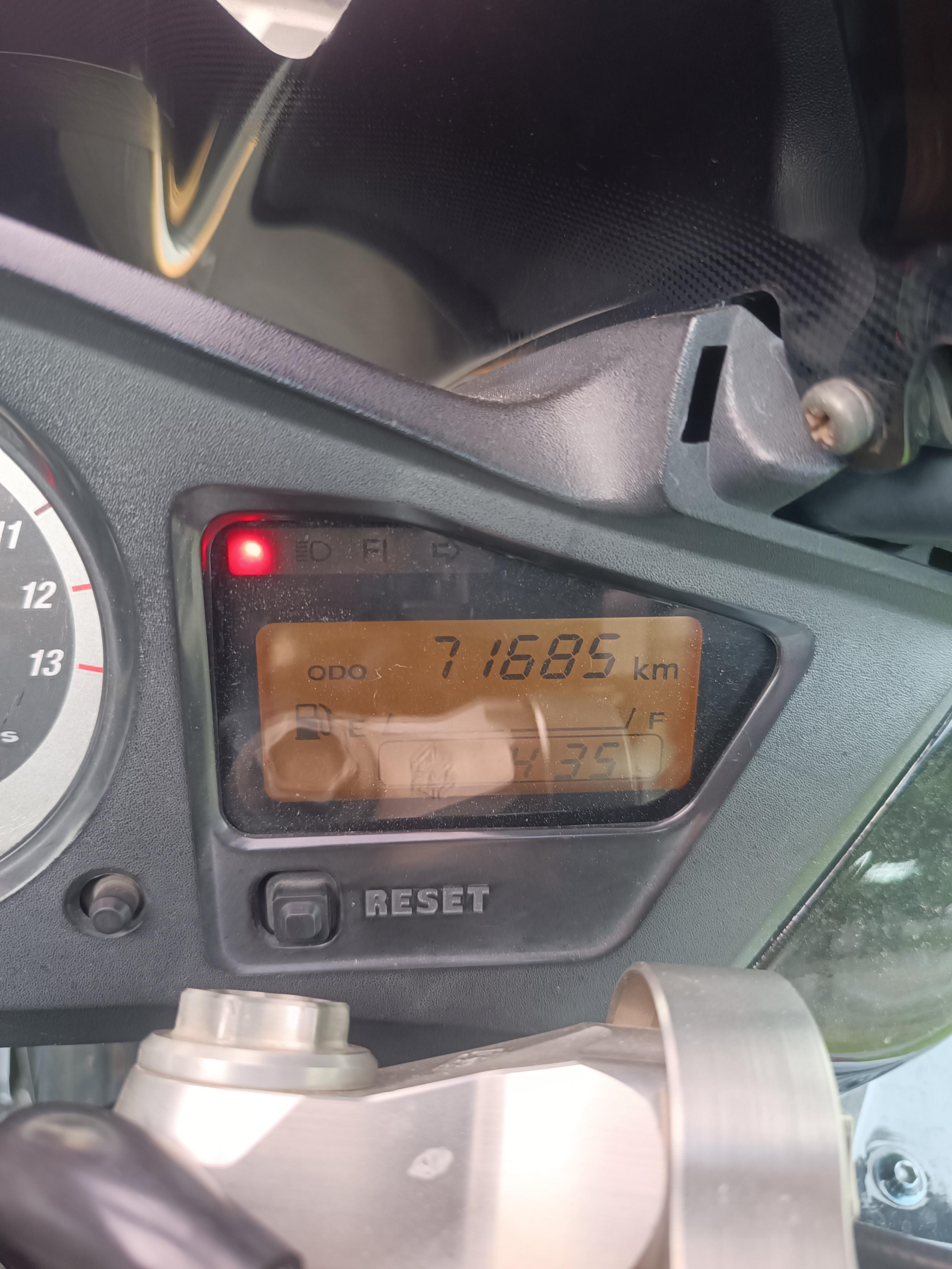

muzzammil Posted September 11, 2024 Posted September 11, 2024 Hi everyone! My 2007 suddenly couldn't start even though I was able to ride it to work this morning. It's completely stock though I've done the flapper and snorkel mod as well as disabling the pair system. Some things to note, before this, on cold starts, it did take like a second longer cranking before starting and it would idle very low at 600-800 rpm. When it got to 70-90°C (158-194F) it would stabilise at 1000 rpm. Also don't mind the fuel gauge, it's inaccurate and shows empty even though I have enough petrol. There's also a flashing red light on the right side of my dash, saw on some videos that would be for the ABS but mine doesn't have ABS and the light is unmarked. I should have listened for the fuel pump priming but I was in a rush and didn't pay attention, the voltage also seems fine. Please advise on what the problem could be! VID_20240911_163520.mp4 Quote

Member Contributer Grum Posted September 11, 2024 Member Contributer Posted September 11, 2024 1. You have a Red ABS Warning Light, but you say you Don't have ABS?! So does this light normally go out above 10kph OR does it just stay On all the time annoying you? Has the ABS lens/legend been removed from the front of the light? 2. The all important question - At Ignition switch ON - Does Both HISS Light And the Fi light come On, then go OFF after 2 -3 Secs AND do you hear the Fuel Pump Prime? 3. Why haven't you bothered to look into your Fuel Gauge problem? 4. Is your Instrument Panel original? I have doubts! 5. Assume you have two Ignition HISS Keys. Have you tried the other key? As a side issue warm engine idle should be set to 1200rpm. Quote
Member Contributer Cogswell Posted September 12, 2024 Member Contributer Posted September 12, 2024 Out of gas? How long has the fuel gauge been blinking? Just curious, every 6th gen I've seen (in the US) has a small, round block off to the left of the ODO trip reset button. Yours appears to have a plunger type of switch poking out. Pardon my ignorance - what is that - OEM or something added on? Quote
Member Contributer Grum Posted September 12, 2024 Member Contributer Posted September 12, 2024 12 hours ago, Cogswell said: Just curious, every 6th gen I've seen (in the US) has a small, round block off to the left of the ODO trip reset button. Yours appears to have a plunger type of switch poking out. Pardon my ignorance - what is that - OEM or something added on? Hi Cogswell. The switch you are referring to is the H.I.S.S "Useless Switch" ! By default the HISS Light (in the Tacho) will flash at a two second rate for 24hrs once the Ignition Key is removed, then turns the light off, a kind of security deterrent. The switch allows you to disable or enable this function. With the three previous 6 gens I've owned, all with HISS, I've never bothered touching the button, completely useless!. 1 Quote
