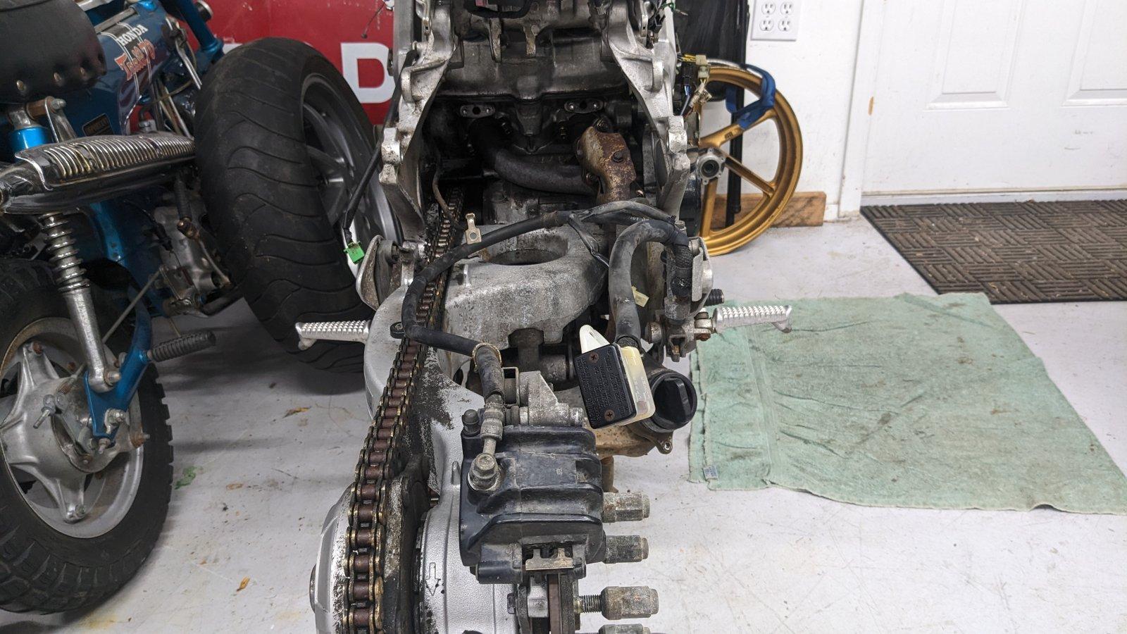

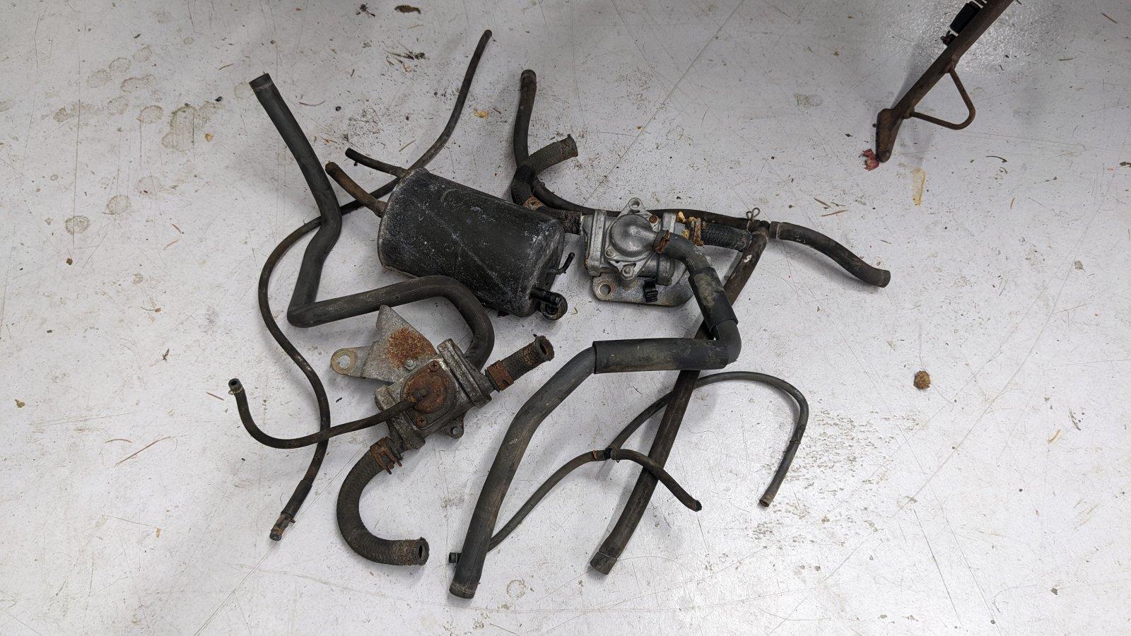

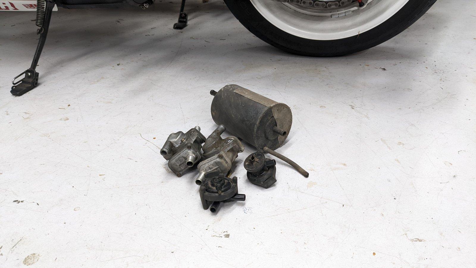

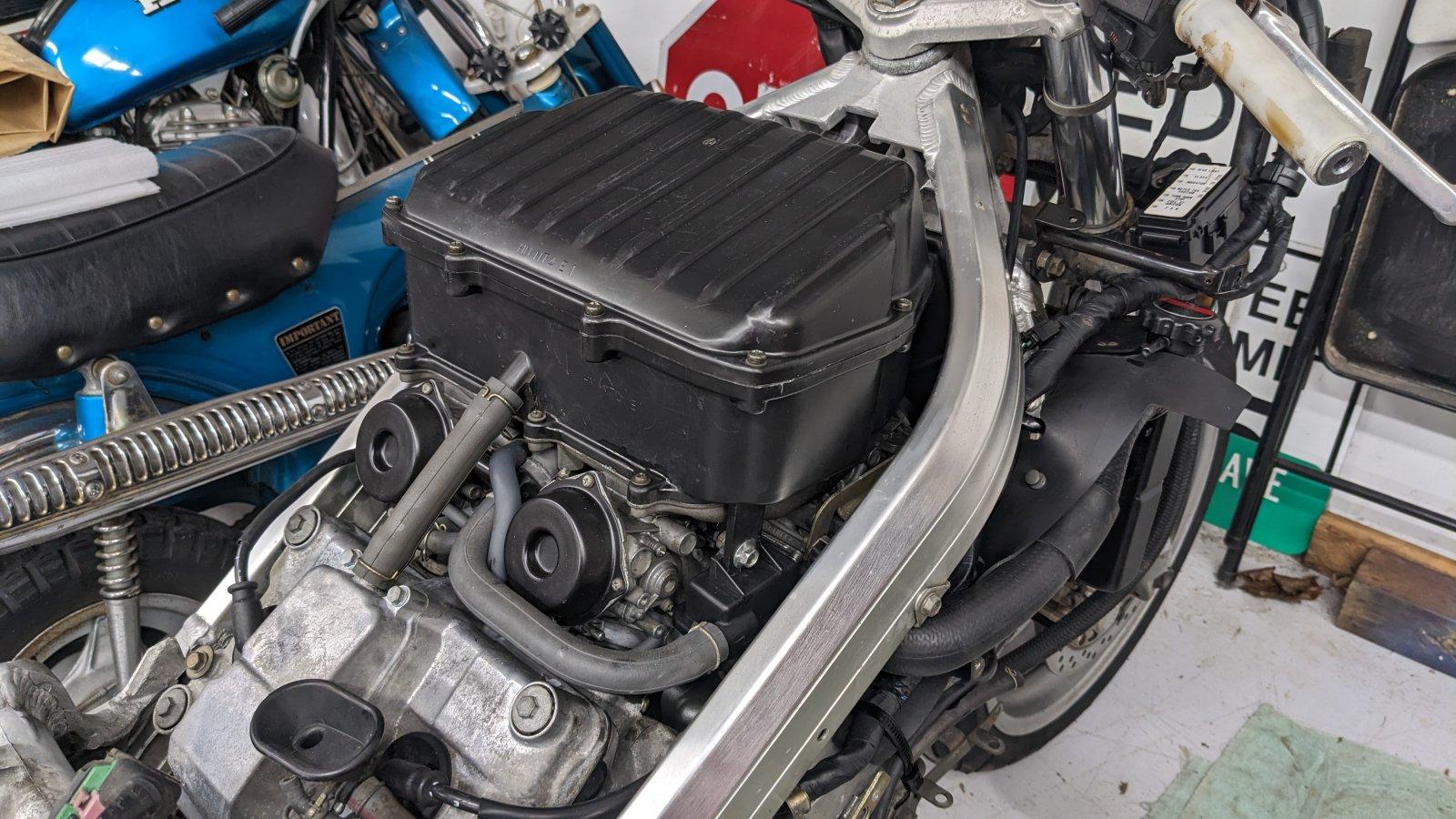

Remove EVERYTHING related EVAP or PAIR.  Every canister, valve body, hose, T fitting or vacuum valve.  There are vent hoses from the carbs in the rear that went to "something", the smaller one can now just vent to atmosphere, pointing down.  There might be a larger vent on your bike that might have gone to, or near, the air box.  Retain that, or point it down if it went to emissions. You can connect the bowl vents to each other, FR to FR, RR to RR, using all of your left over Vacuum rated hose.  There is usually one vacuum spigot on the carbs that needs to be properly capped.  Any vacuum lines that went to nipples on the head near the carb insulators, the nipples need to be capped or replace with a screw / sealing washer.
Here you can see the smaller vent line tucking under the large one pointing down, and the large hose going to a little breather box that just vents to atmosphere.

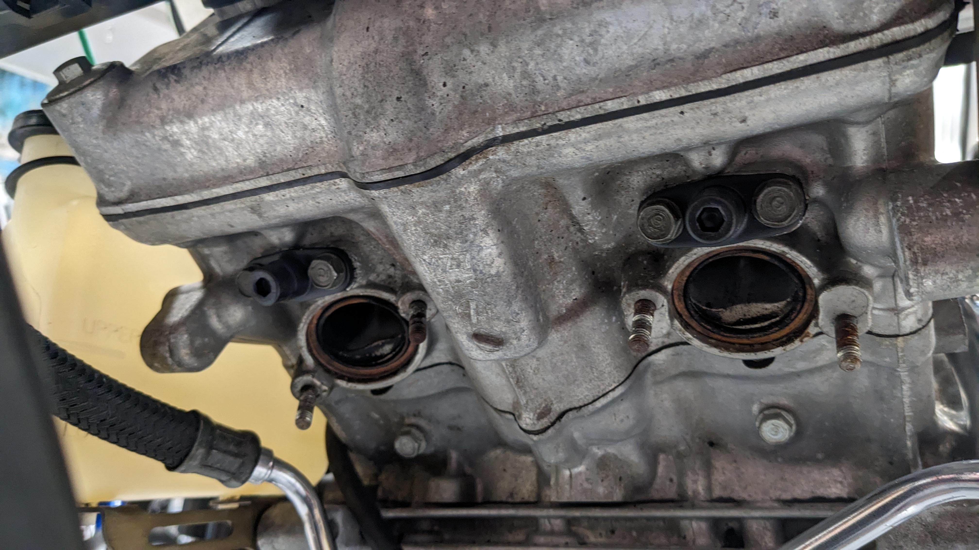

Anything that went to the air box, those fittings on the air box need to be plugged / capped (except the crankcase breather, seen in the above pic), usually any now unused ports are beneath the air filter.  If the engine heads had hard lines going to them from PAIR, they need to be cut off and sealed.  I even double rolled and crimped a friend's so he could take care of it later.  Never did.  No issues.  The fronts are easy, some bikes the rears require some fairly involved dis-assembly.

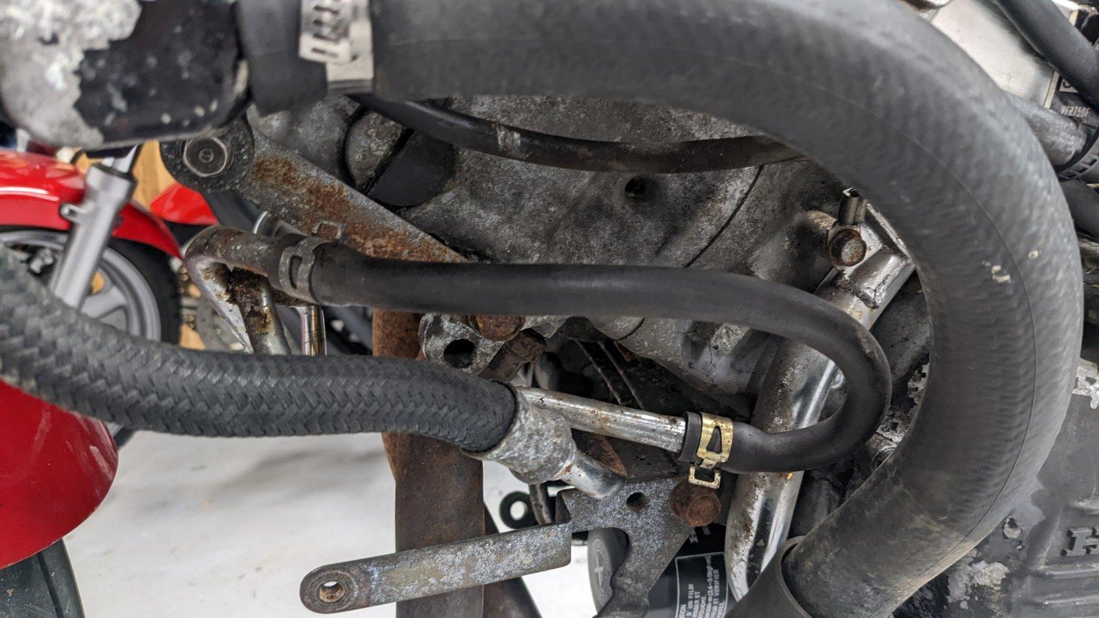

If you don't want to get totally into the rear, you can just use some of your tubing that was removed to connect the ends of the hard lines to each other after the PAIR valve has been deleted.

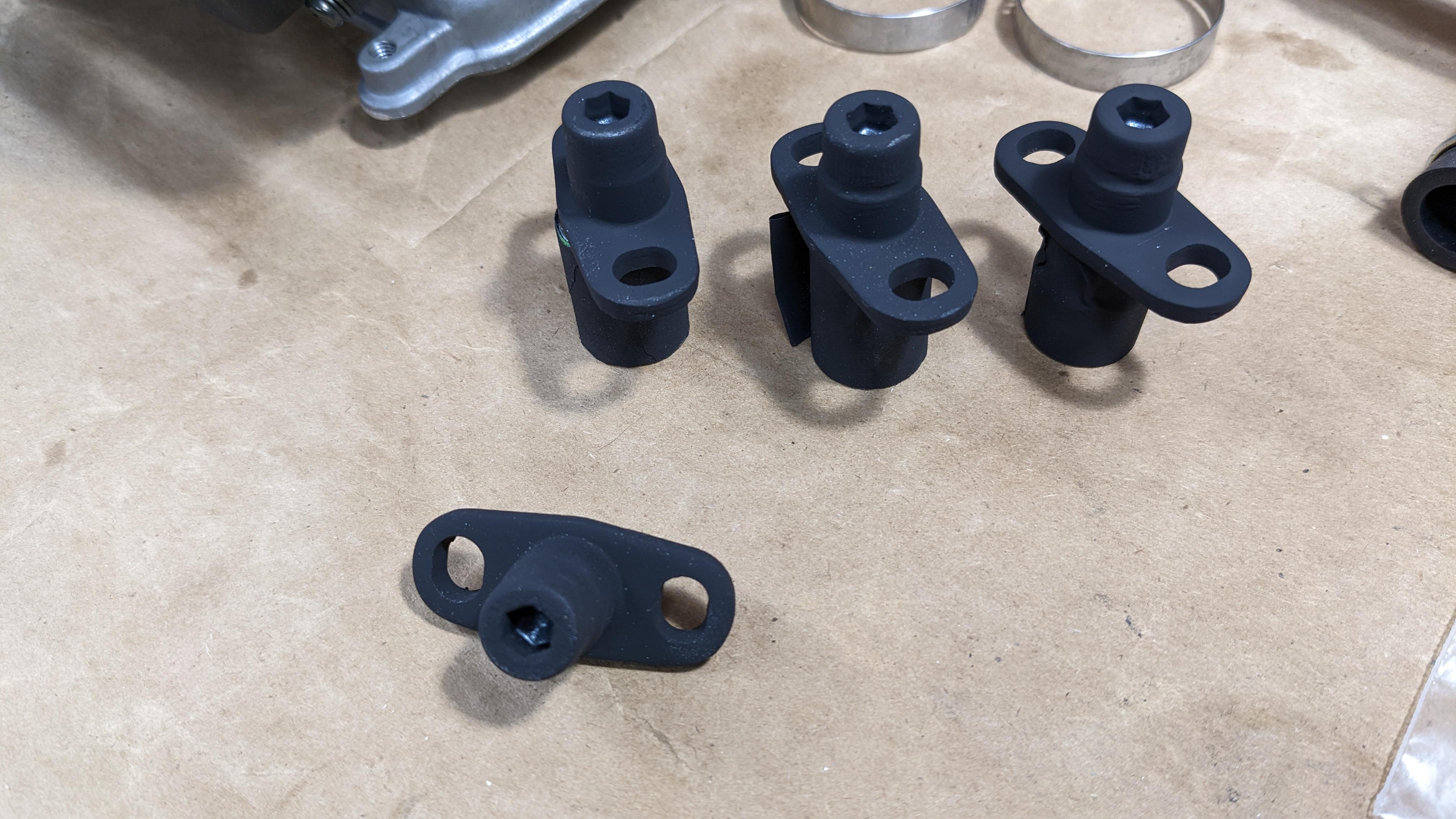

You can use the hard line fittings to make "block off plates"

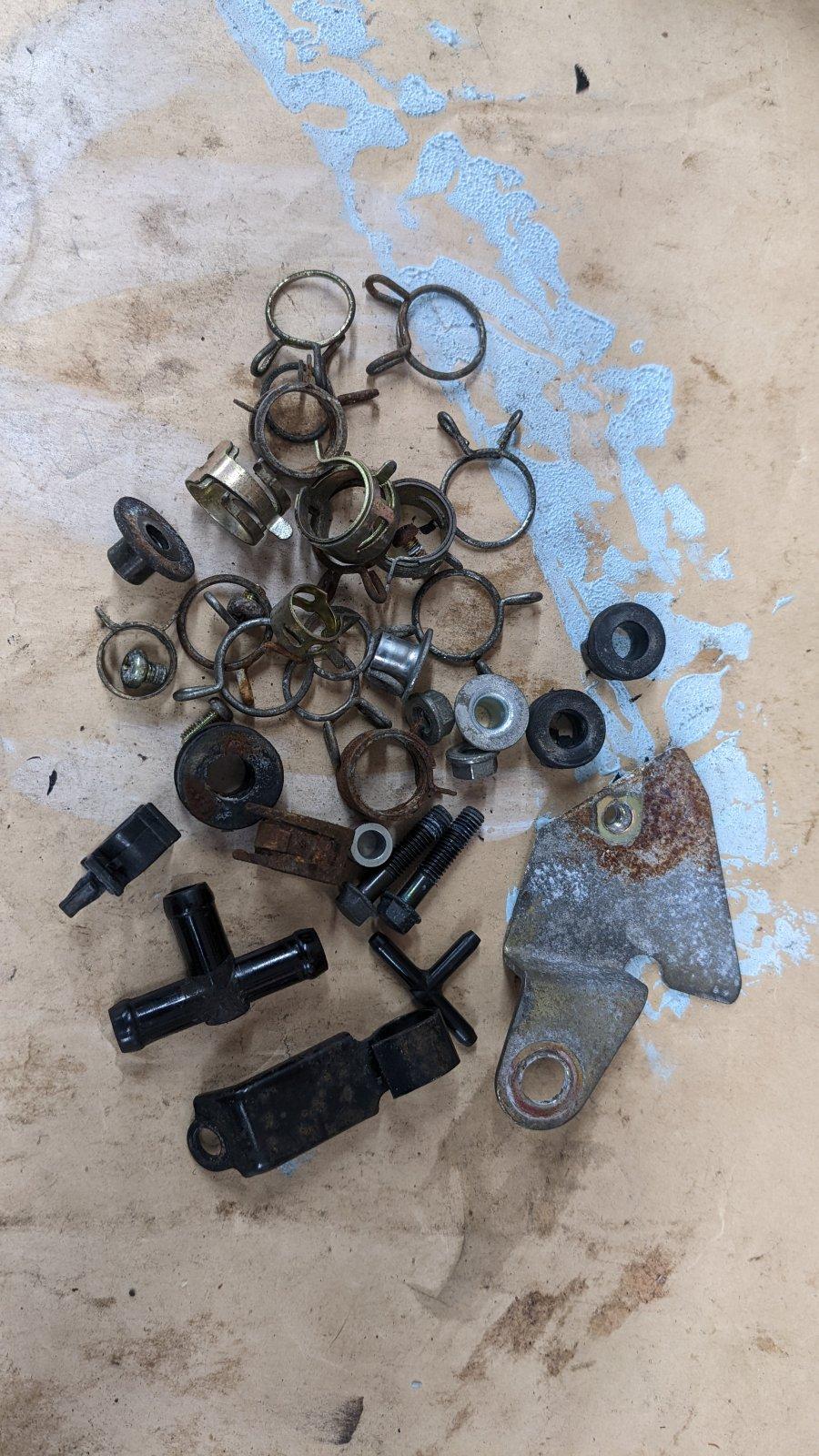

You also end up with some clamps, tees, collars and doo-dads.
