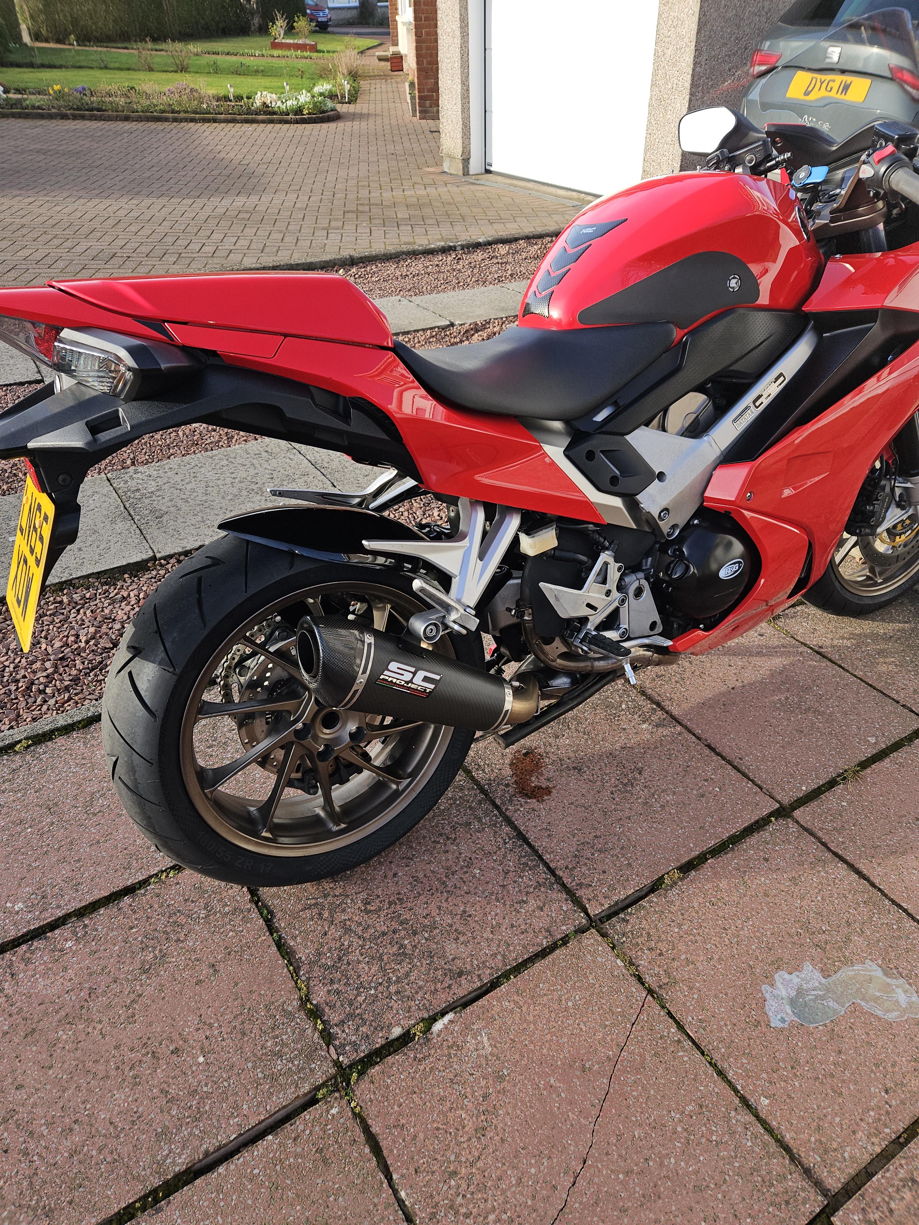

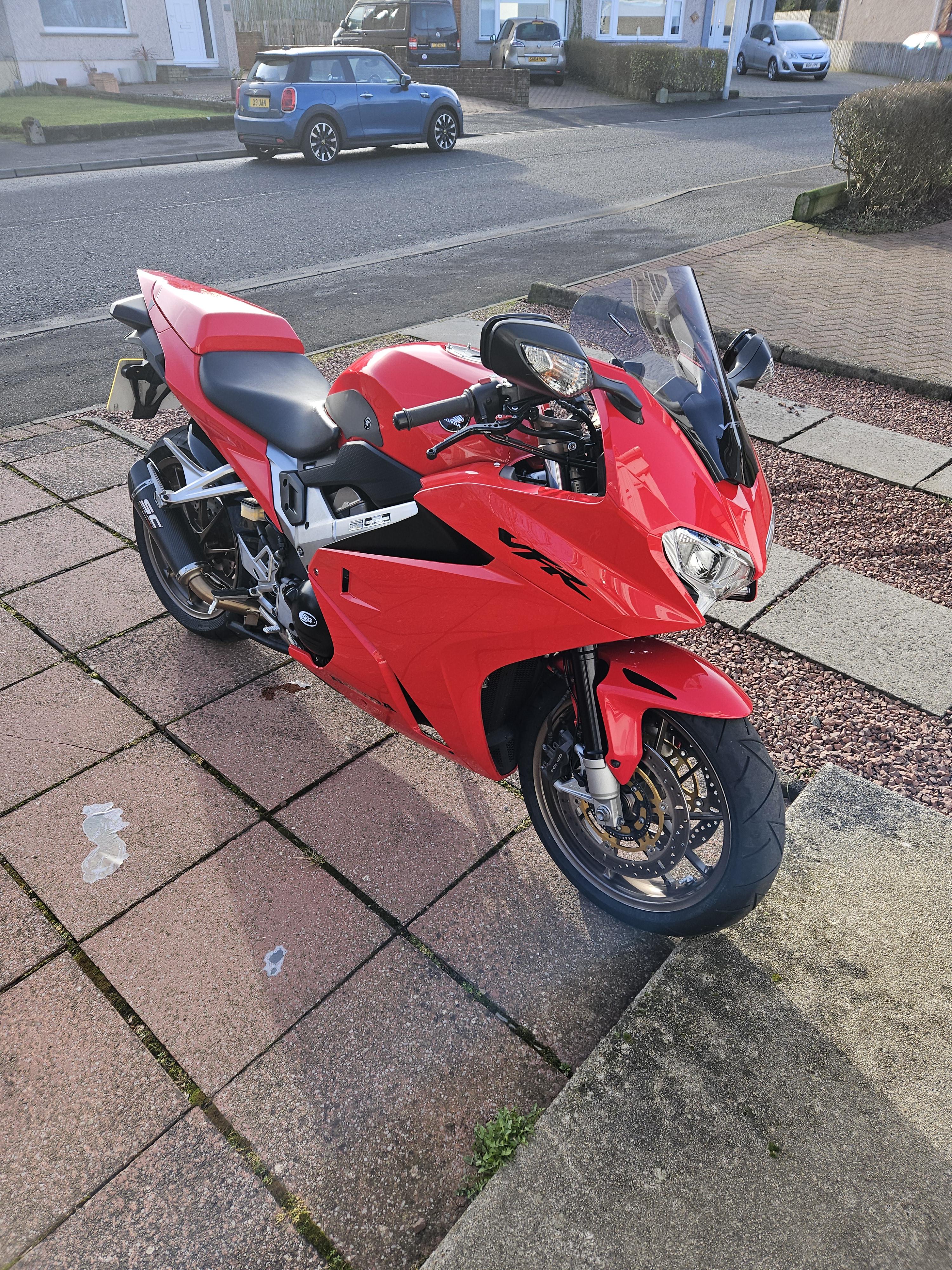

RockGod Posted February 7, 2024 Posted February 7, 2024 So i took delivery of the new bike yesterday and im over the moon. Such a lovely machine. I obviously had to go for a wee spin and since it was about 2 deg yesterday i was planning on sticking the heated grips on but to my suprise there were none! I thought the 8th gen came with these as standard? Not a major issue as i can fit some aftermarket ones. Anyway, couple of pics taken after delivery. 2 Quote

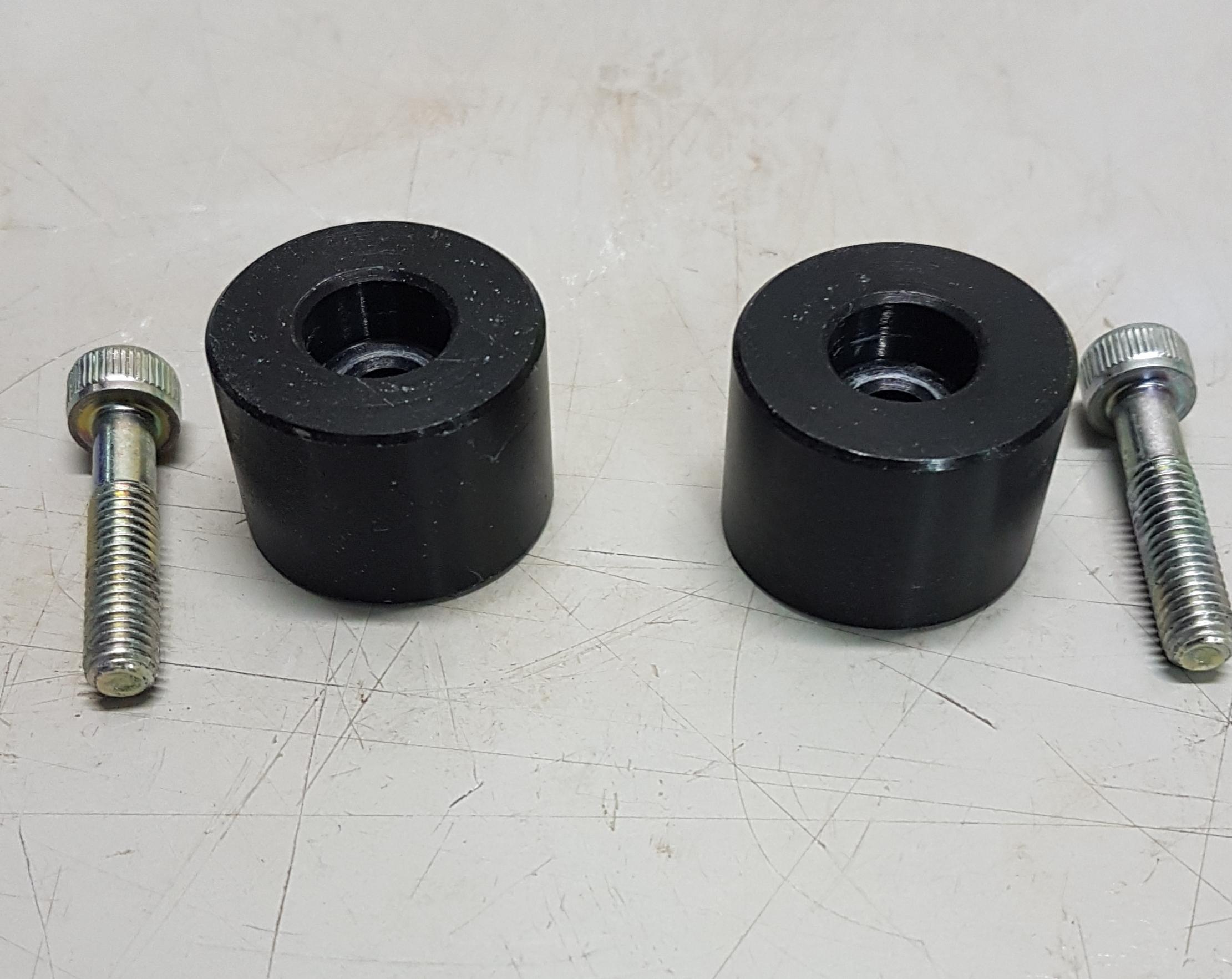

Member Contributer Grum Posted February 7, 2024 Member Contributer Posted February 7, 2024 Very strange that the Heated Grips which should be there are missing!! I've heard that running them at level 5 for long periods have caused the grip rubber to degrade in some instances. Noticed there's lots of aftermaket changes and additions. Curious as to why the front disc rotors are not OEM? - Did you get the separate pillion seat and handles? - Two keys? Especially if your bike has the H.I.S.S system. - Tool kit under the seat? - Owners manual? - Were you supplied with the OEM Screen and Exhaust? - Looks like the seat is set to the high position, check that the two seat height raising collars have been installed. Unless you have records that the Brake and Clutch fluid have been replaced recently then replace and flush the fluid, an easy job on an 8gen. Coolant, if no replacement record should be done as well. Enjoy the 8gen. Quote

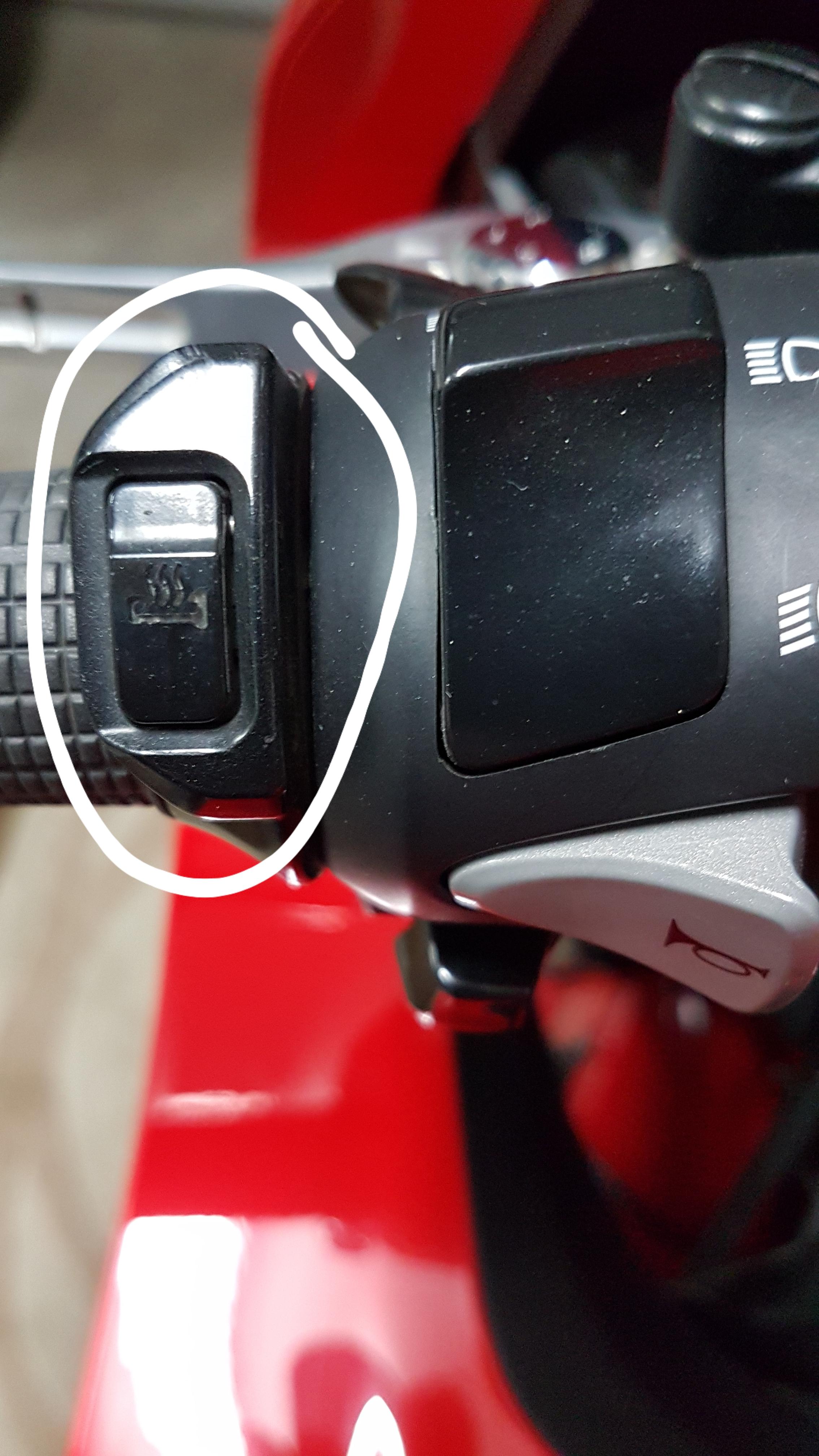

Member Contributer Thumbs Posted February 7, 2024 Member Contributer Posted February 7, 2024 The controller for the heated grips is on the left side next to the grip, your grips look OEM Quote
Member Contributer Grum Posted February 7, 2024 Member Contributer Posted February 7, 2024 Yep as Thumbs mentioned left side white circled switch. Quote
RockGod Posted February 7, 2024 Author Posted February 7, 2024 Thanks for the replys guys. I have 2 keys for the bike which is good but defo dont have that switch for heated grips Quote
RockGod Posted February 7, 2024 Author Posted February 7, 2024 Been out to the garage and had a good nosey about. As grum said the discs are indeed ebc. I have the tool kit under the seat and also found an oxford charger connection hooked up to the battery. My seat was set on the low brackets at the rear, but in the high position at the front. My grips are renthal so they heated grips have been removed so first job is going to be getting some of them fitted! Quote
VFR80025th Posted February 7, 2024 Posted February 7, 2024 Great points by GRUM. Too bad you do not have the OEM screen and exhaust. May I add that the VFR logo on the upper portion of the fairing is not OEM as well. Can't tell but DB killer on sc project slipon may have been removed. Enjoy the new bike. Quote
RockGod Posted February 7, 2024 Author Posted February 7, 2024 50 minutes ago, VFR80025th said: Can't tell but DB killer on sc project slipon may have been removed. Yeah, thats gone 😁 Quote
Member Contributer Grum Posted February 7, 2024 Member Contributer Posted February 7, 2024 6 hours ago, RockGod said: My seat was set on the low brackets at the rear, but in the high position at the front That's why I mentioned it. I've never used the high position but could see yours doesn't seem to look right. Refer to you Owners Booklet regarding the seat height and as mentioned make sure the height setting collars are fitted when using the High position. If the collars are not fitted and the front is located in the high stay you could be stressing the seat structure. Quote
Member Contributer Grum Posted February 8, 2024 Member Contributer Posted February 8, 2024 On 2/7/2024 at 10:18 PM, RockGod said: I had no idea the discs weren't OEM. I got the bike with the rear seat and rails, full service history, and all documents / books but not the stock exhaust, screen or levers. Will need to go check for the tool kit and seat height adjustment Another not so obvious change is the rear sprocket it's non OEM! 8gen standard sprockets are 16/43. You would also think with the mileage your bike has done it would probably still have the original chain, and therefore the original sprocket! I wonder if the previous owner wanted to change the final drive ratio. Check if the rear is a 43 tooth sprocket? AND it keeps getting weirder!! Your rear Brake Rotor is also non OEM. Why all the brake Rotor changes on such a low mileage bike? Still amazed that it appears all the heated grip hardware has been removed, one of the excellent additions to the 8gen. Bit of a shame, there is a piece of broken missing fairing just below the right side pillion grab handle cover! And is that paint missing, just aft of the grab handle cover? Check the rear cowl it doesn't seem to be sitting properly, sits high, and is mostly noticeable at the rear of the cowl.. Quote

Goldcrown44 Posted July 26, 2024 Posted July 26, 2024 Another late reply by myself in today's various discussions, but it's my understanding 8th gen VFR's are either Deluxe or non deluxe. Deluxe versions came with a centerstand, factory heated grips, and ABS. My 8th gen is a non-deluxe model. I had the dealer install a centerstand, but I have the option to buy the OEM Honda heated grips with that fancy integrated controller button in the aforementioned photo. Nor do i have ABS (but I love my new EBC HH pads! Sizzlin' bacon sound at every stop! Quote
