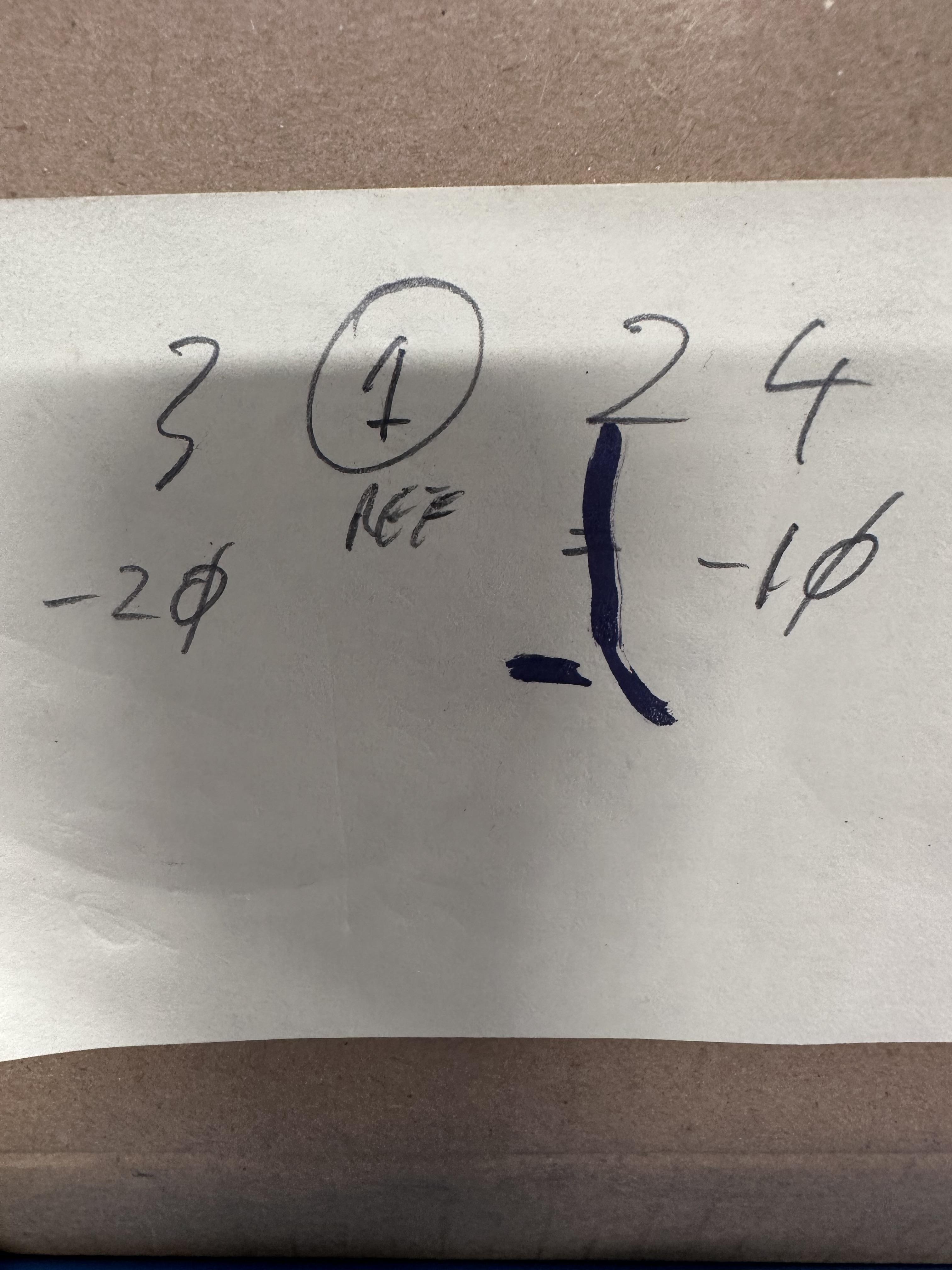

Member Contributer Mohawk Posted October 11, 2023 Member Contributer Posted October 11, 2023 I can't recall what the manual says. But this is my crib sheet kept on the inside of my gauge box. Cylinder-1 is reference & not adjustable. Cyl-2 should be equal to Cyl-1. Cyl-4 should be -10 from reference & Cyl-3 should be -20 from reference. All figures are MM of vacuum. When set like this on a stock or aftermarket 5th gen exhaust the engine is super smooth & revs very crisply. Make sure you have a 5th gen exhaust, as 6th gen will fit & rear headers are closer to same length so uses different vacuum settings. On 5th gen front pipes do NOT cross & #1 cylinder is the top/rear most pipe by right foot peg. 6th gen front pipes cross each other because #1 cylinder is inner/forward pipe by right foot peg, thus front pipes cross to keep the front rear cylinder pairings the same. Cylinders on all VFR's are 1+3 at rear & 2+4 at front, with #1 at rear left when sat on the bike. 1 Quote
Jonnyvt Posted October 11, 2023 Author Posted October 11, 2023 Hi Mohawk Are these the starter valve settings use have used? i set them as per the manual, but based upon what i have learned on this forum, i have got the MM on 3 & 4 the wrong way round!!! so im gonna redo these at the weekend, Many thanks Jon Quote

phoenix655 Posted October 17, 2023 Posted October 17, 2023 Mine was very lumpy and really didn't like being below 4000 until I did the starter valve sync like in the thread above and it made a huge difference. It's still not great below 3000 rpm but I think thats just too low for these bikes no matter what, maybe the carbureted bikes are better at really low RPM. It also made the throttle response a lot smoother, it was very twitchy before and was really difficult to smoothly apply throttle at low speed. I also removed the pair system and flapper but I'm not sure that did anything. Quote
