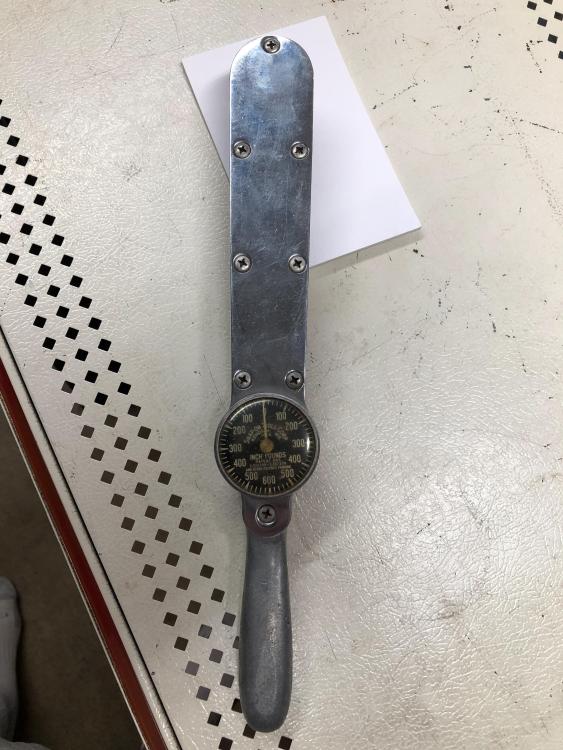

Member Contributer tsmitty Posted September 1, 2023 Member Contributer Posted September 1, 2023 56 minutes ago, mello dude said: My OCD self is getting more concerned about low torque specs.... Any recommendations for low range quality precision torque wrenches? Mbe 36 in-lbs to around 240 in-lbs.. Thanks in advance for your suggestions. 🙂 I feel your pain mello, all I have is this 3/8 gem. its older than dirt. 1 Quote
Member Contributer tsmitty Posted September 2, 2023 Member Contributer Posted September 2, 2023 mello, you can come borrow this one if you want, but I wonder if AutoZone has one to loan for your clips. Quote
