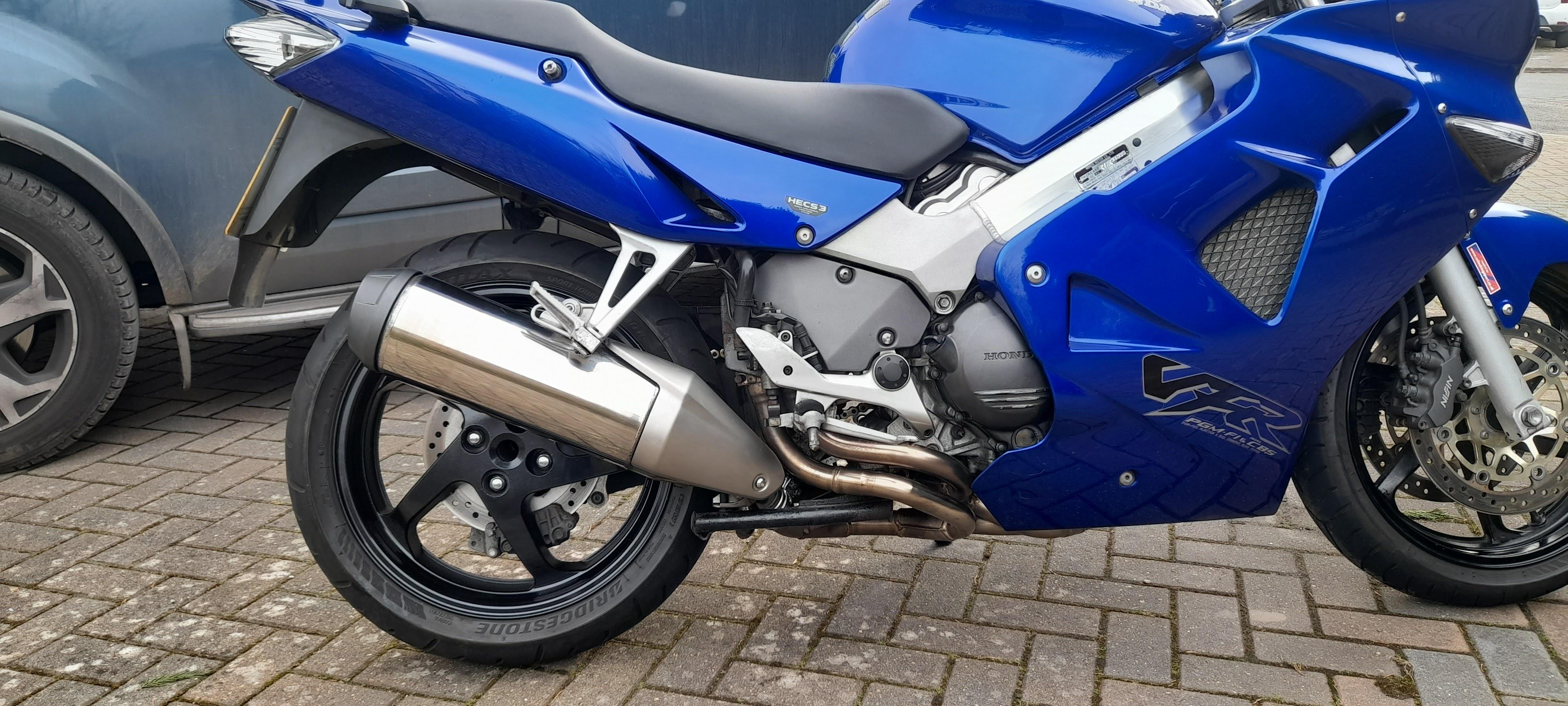

DaveC Posted March 17 Share Posted March 17 This opens up options for 5th gen owners, this 8th gen 2014 standard exhaust went straight on no problem. I had to fit a 10mm spacer on the footrest hanger where the exhaust bolts on for a perfect fit. 4 Quote Link to comment Share on other sites More sharing options...
VeeEffArah Posted March 17 Share Posted March 17 So center stand bumper and the stopper tab on the stock midpipe lines up perfectly ? And still jealous of the UK blue version, btw.... Quote Link to comment Share on other sites More sharing options...
DaveC Posted March 17 Author Share Posted March 17 Main stand rubber stop lines up. Forgot to mention, I do have Motad stainless steel headers not stock ones Quote Link to comment Share on other sites More sharing options...

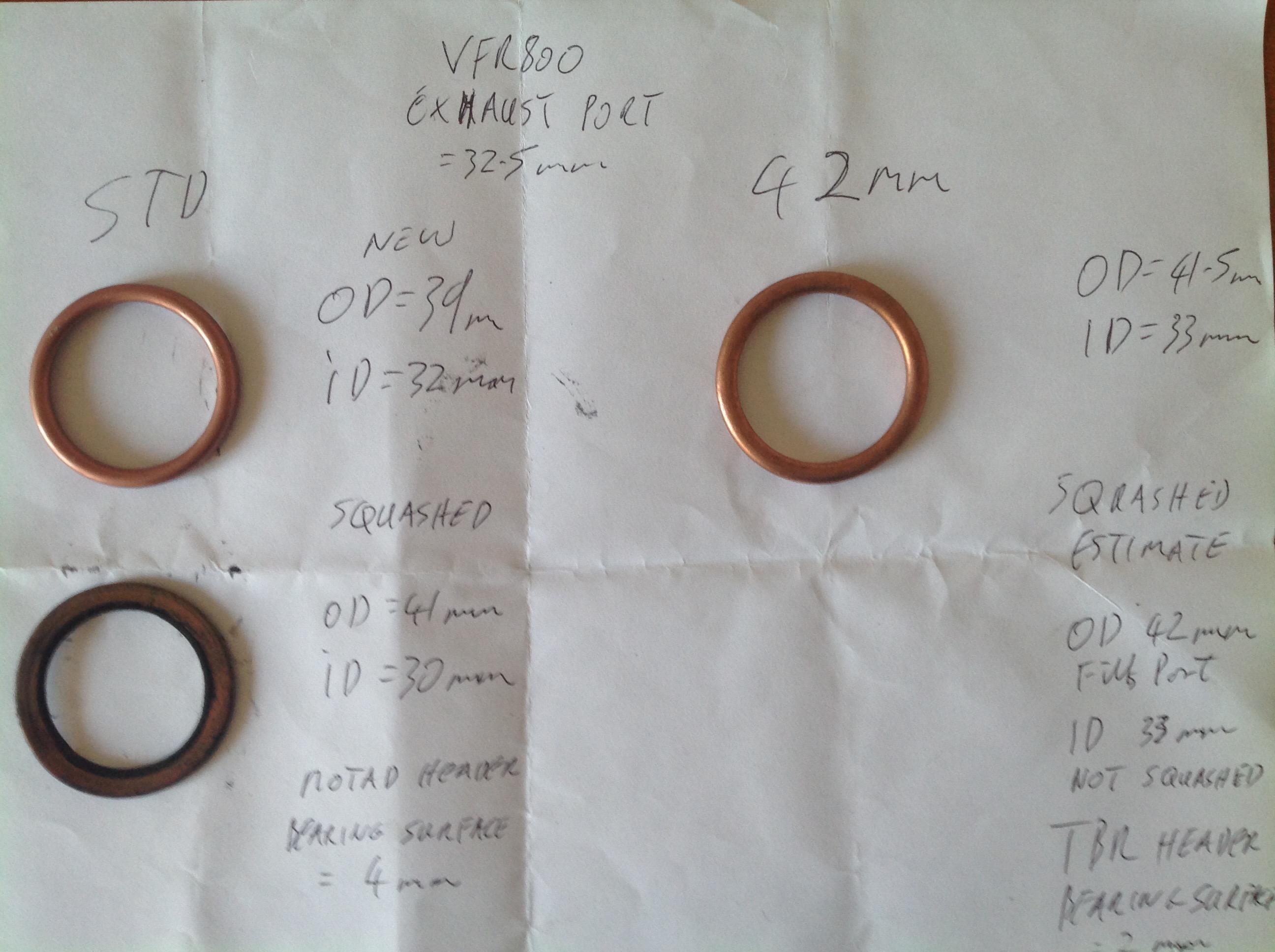

Member Contributer Mohawk Posted March 18 Member Contributer Share Posted March 18 Exhaust Gaskets 1 Quote Link to comment Share on other sites More sharing options...
