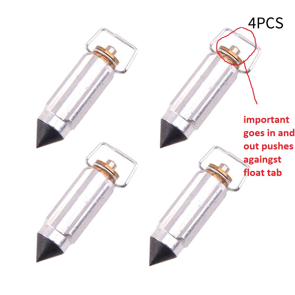

I concur in my 1986 VFR750F ram air though I am running 132 or 134 main jets 34mm Keihm.  VF1000R are 36mm so 130-135 . Which jets are you running? It sound like something is clogged or sticking  Did you install the spring and diaphragm correctly?  Torn diaphragm or incorrectly installed.  They need to be sealed correctly in the groove ie vacuum nipple. Clogged main jet float doubtful.  Check diaphragm the needle should go down quickly  in the bore when you push them up individually should be about the same for all 4.  When you installed needle are they locked in place ie clockwise  did you have to enlarge holes at the diaphragm? There are tiny little holes in the sides of the pilot jets check those.  Float be be smooth going up and down you can measure the height pain in the ass with a float height setting tool  not necessary if they go up and down. Check float valve needle most important if the top does not retract internally it is defective it control float opening and closing correctly and adding enough fuel.  DONOT BEAT ON THE BIKE IT IS RUNNING TOO LEAN.
s-l1600.jpg TINY HOLES PILOT JET
