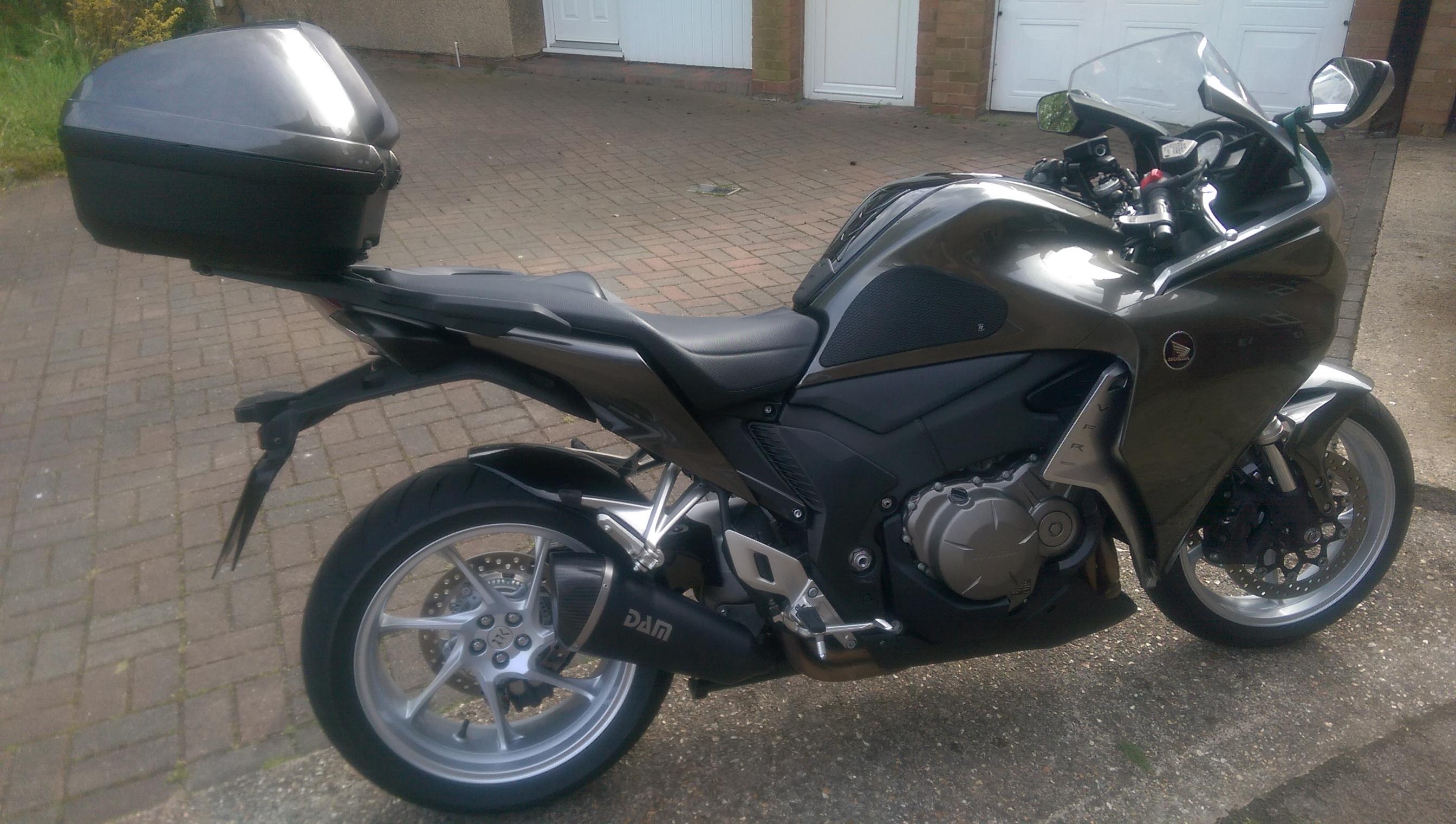

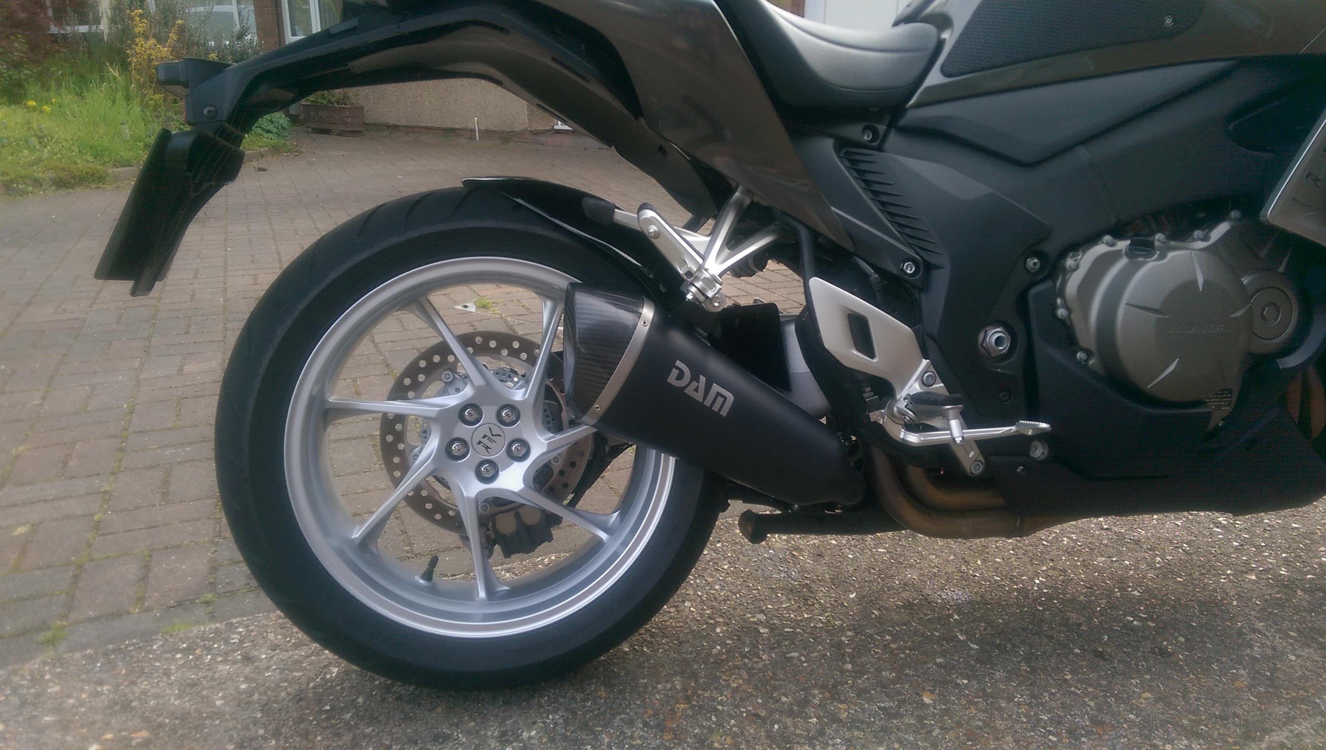

I have the Dam pipe and love it.  I also have the Akra high mount pipe and enjoy it also.  Both fix the looks and sound issues.
Thank you kindly for the help. I’m try to decide if I want Matte with polish tip or carbon. Bike has all the Honda carbon bits on it, but maybe it’s to much.
In Hawaii you must run the sound baffle, correct?  If so, you might want to order the sport db killer that Dam offers.  It produces a sound pretty close to the Dam exhaust with no baffle at all.  It would certainly pass the visual inspection test - you can't miss it.

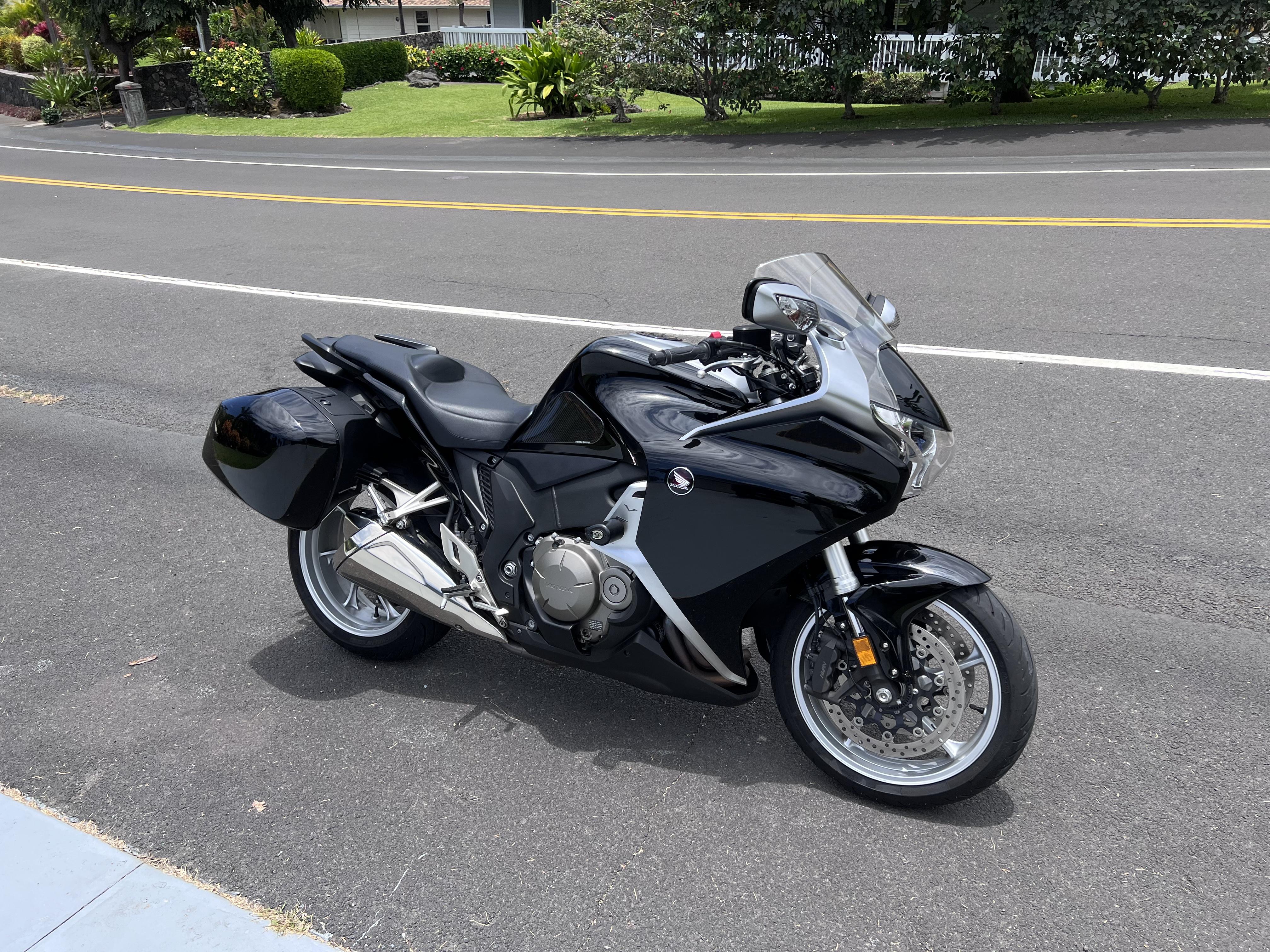

That’s a good looking bike! Wasn’t considering the full black but that looks really good on your bike. Is the fairings grey? I didn’t know they made that color, mine is black.

Here’s mine, day I bought her in Kona.
Very nice. I'd be trying to steal Skids beautiful Black DAM exhaust! :fing02:
Titanium I prefer to call it.

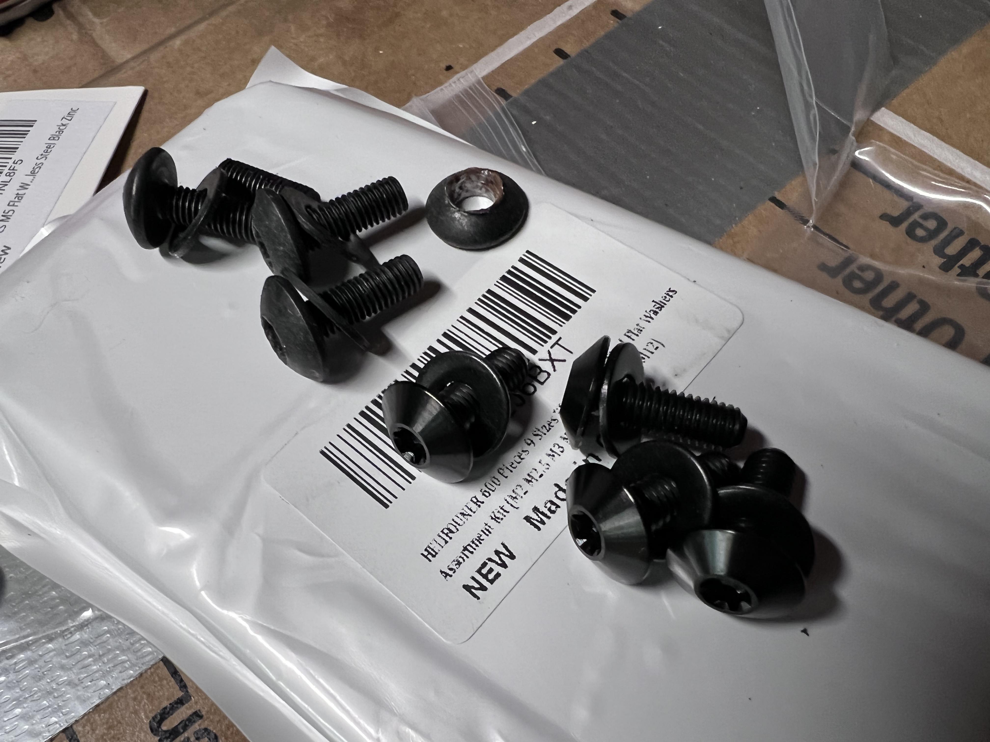

Did some of my first modifications. Unfortunately when I went to remove the bottom fairing for the oil change one of the Allen bolts was seized. Ended up drilling the head off and the threaded portion backed out by hand. The washer was missing on that bolt so maybe that’s what caused it to seize up, I hate Allen’s anyways and knew those cheap bolts would rust so I replaced them with some titanium bolts I found on Amazon, T25 star bit as god intended, don’t ask how much.
