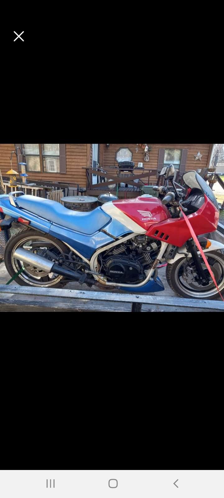

Pics?
Good pic of the bike, but a picture of the busted carb would be helpful too.

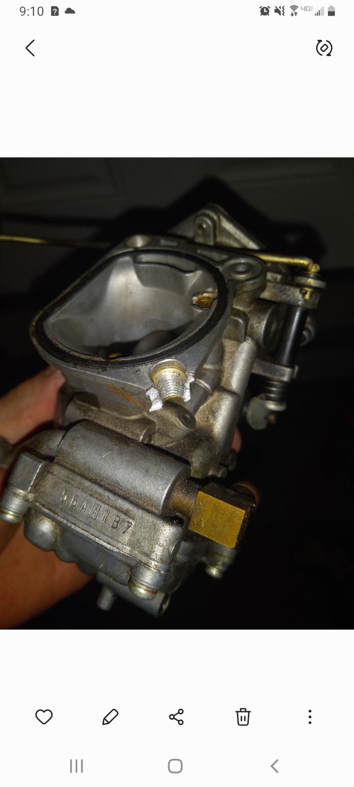

Do you have piece that broke off?
Perhaps you can cut piece to match from alloy tubiing.
Then braze together with https://www.alumiweld.com
Stuff is amazing! I've rejoined broken alternator ears with it for permanent repairs.
Yes I have the piece that broke off. I brought it to work to see if the welders could tig weld it back together, but they say it's not going to work.
Conventional welding isn’t possible with the die cast parts ….Lumiweld is a form of brazing, they’ll be able to do that
The Lumiweld material when it cools is much harder than alloy so if possible try not to have to drill it
