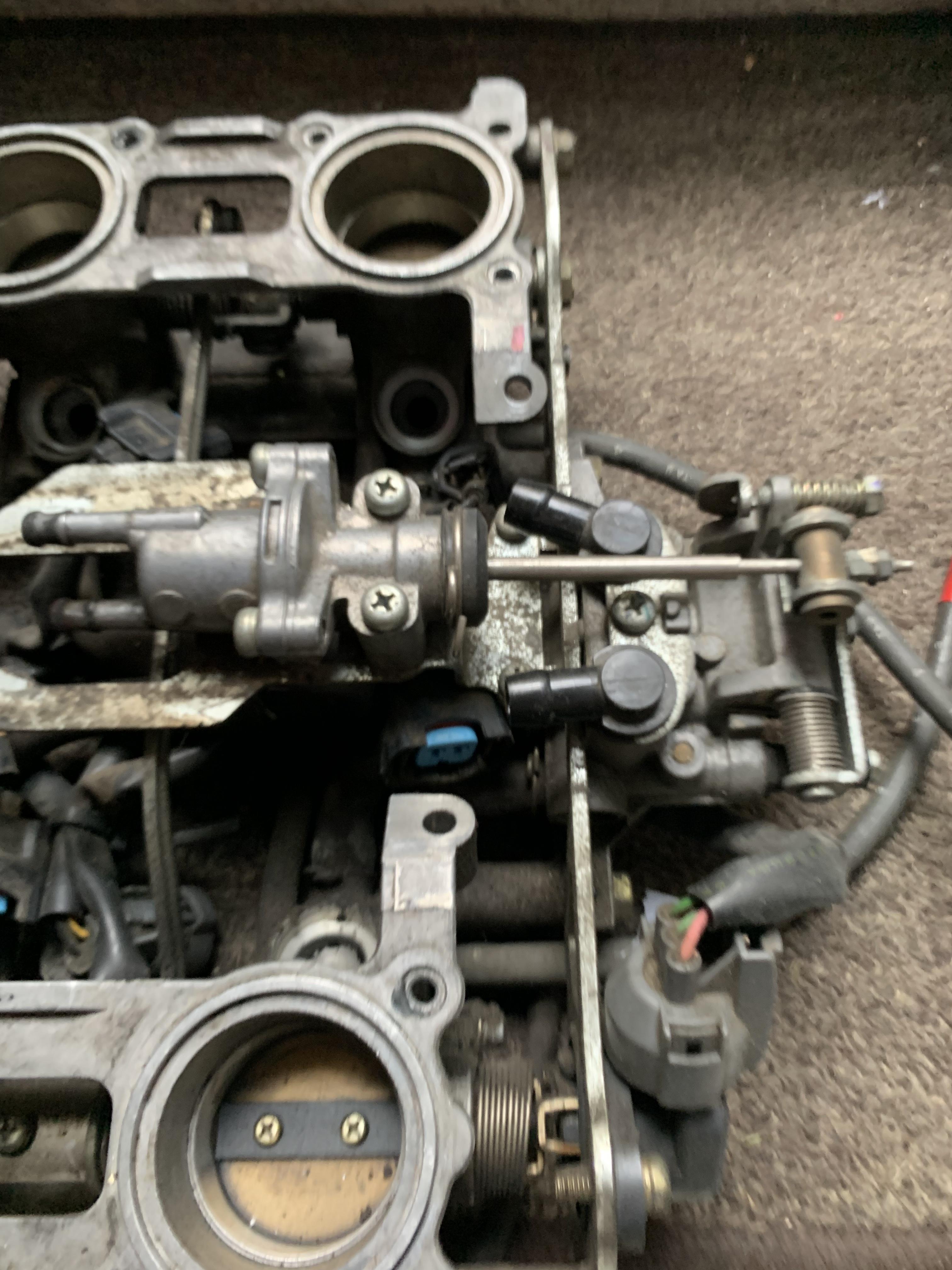

The later models have a blank plate on the left switch cluster, so you can either source a choke lever or just buy a secondhand left switch unit with the choke lever like I did. Then a piece of universal cable with a fixed end nipple to suit the lever end & a clamp nipple. Route & cut the outer to length to fit. Now insert inner attach to lever, pull through the slack & pass through the starter valve lever point where the wax unit was connected & use the clamp on nipple to allow the inner to pull the starter valve enrichment lever. Job done. Pic of wax unit below.
This is a pic of the cable stop and lever that actuates the valves. The yellow indicates the cable path.
