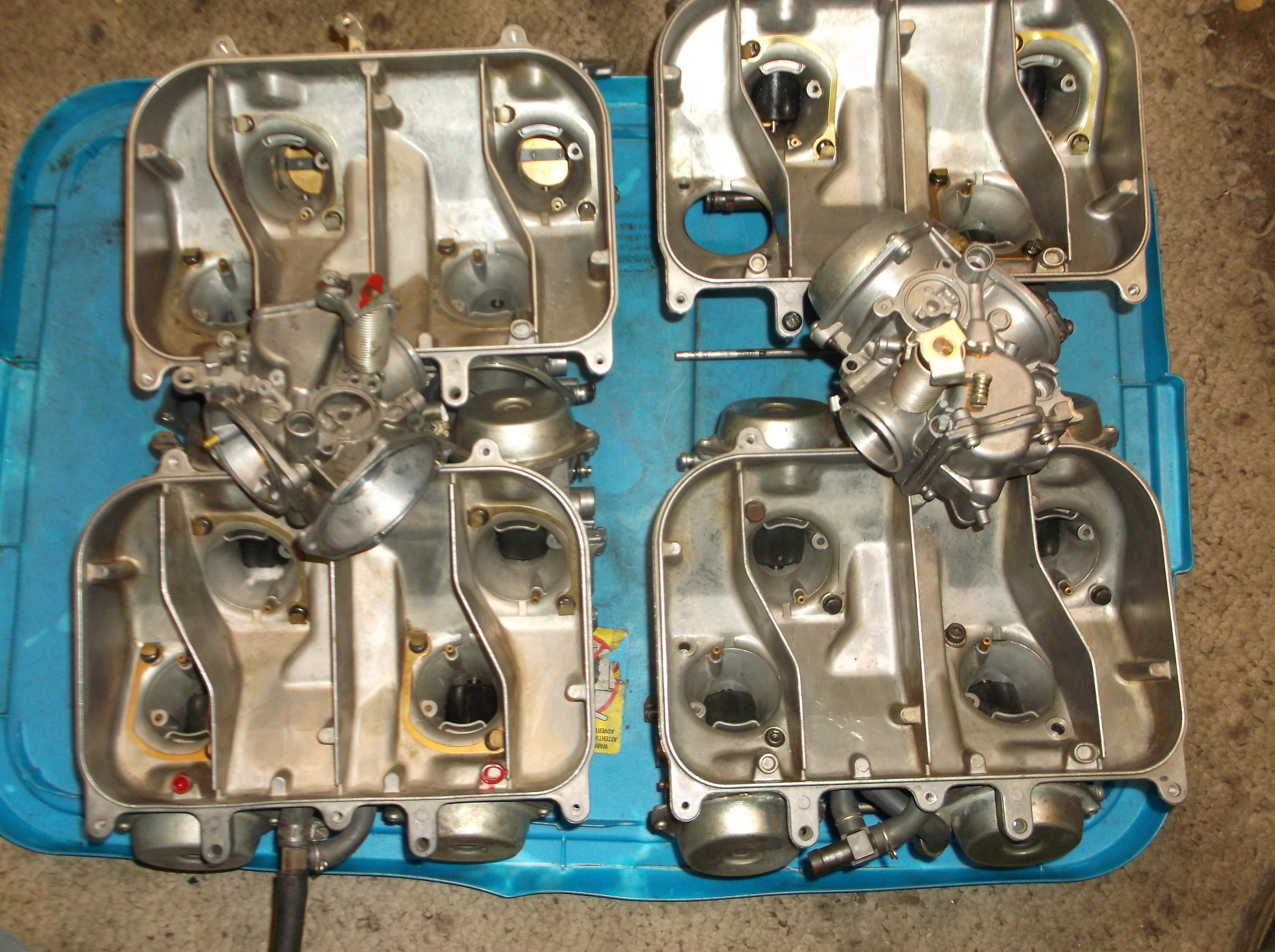

 i do carb cleaning/rebuilding too, charge less than that guy, and i just finished cleaning and fuel tube O-ring replacement on 2 gen 3 bikes................
12-1-17_176.JPG.855a0e6828772e377747193f47761e4d.thumb.JPG.0b45a0ba9ef46507bffc9b4e22ab9720.JPG
unless people are seriously OCD, they don't need their carbs totally stripped down to each nut and O-ring as very often only one or 2 small jets need cleaning and the bike will run fine.  i do alot of carb work, and most need very simple cleaning of idle jets and maybe new float needles, and that's all.
i could make more money if i insisted on a total a stripdown of every carb that came in, but i just do what's necessary (and a couple of preventative things) to get my riders going again as quickly and as economically as possible.
