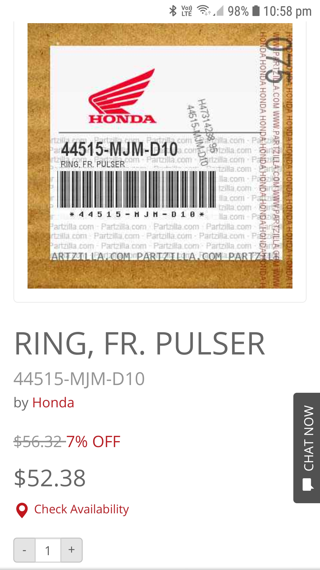

Magneto Posted March 13, 2021 Posted March 13, 2021 Looks like it is 30 dollar part. I would replace with new one. Quote
Member Contributer Grum Posted March 13, 2021 Member Contributer Posted March 13, 2021 Partzilla listing. Quote
Member Contributer Presson Posted March 13, 2021 Author Member Contributer Posted March 13, 2021 Thanks Guys for the input. Amazingly the main UK Honda supplier quotes £206 sterling for the rear ABS rotor! Import from the US would be around £60. And of course it's the rear one that's rusted. Prompted by Grum, just looked at the procedure to remove it - oh hell. Maybe this lockdown has just given me more time to peer at corrosion while the bike is sitting in the garage. I think I'm going to live with it until I need to disassemble the rear hub. After all I can't see the rust while I'm riding it - which hopefully won't be too long now 2 Quote
Magneto Posted March 13, 2021 Posted March 13, 2021 What a Rape, front for 1200 is 30 bucks at Motorsport 🙂 White vinegar and tooth brush then, rinse, dry and some non sticky, dielectric protectant. 1 Quote
