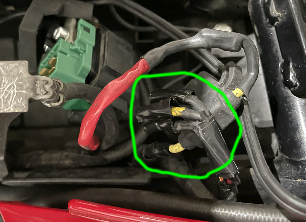

Member Contributer DannoXYZ Posted December 11, 2020 Member Contributer Posted December 11, 2020 nah, relay themselves can't cause shorts. Never heard of one self-latching until it welded itself together. Always needed external trigger. Clue to external short was when you were touching it in dark and it turned on starter by itself. One of those wires in that mess of electrical tape had gotten unshielded and shorted on to activation line of solenoid. You'll most likely find it when you start unraveling tape. Also, not likely your RR replacement cause this issue. At worse, it'll result in battery not charging. But never run away solenoid. Good job on RR BTW. 👋 Quote

Member Contributer DannoXYZ Posted December 11, 2020 Member Contributer Posted December 11, 2020 On 12/10/2020 at 6:59 PM, ShipFixer said: Still going to take everything apart and check of course. I think I will just replace the whole harness where he spliced in the 30A fuse connection on the R/W line from the RR vs. trying to re-repair it. Hey, that's good idea! For the effort, don't just re-do the factory configuration though. You'll end up with same flaws as stock system and have issues in 10-yrs due to: - brass fuse-holder terminals corroding over time and causing overheating - brass spade-connector to R/W wire corroding over time - crimped-on connectors not up to 30a load I always prefer to upgrade to "better than stock" and cure problems altogether. Issue with stock ATO/ATC fuse-B is that 30a is upper-limit of that design. Fuse-to-connector interface starts overheating even before 30a current flow. We'll want upgrade to MIDI fuses which start at 30a and goes up to 200a. So cut off old fuse-holder so you have just red and R/W wire-ends to harness: - 2x 1/4-hole solder-lugs, one sized for Red and one for R/W wire - MIDI fuse holder - 30a MIDI fuse This is what I use on my sailboat. Tin-plated contacts are way more corrosion-resistant than brass, so you won't have heating-up issues like factory design. Clamping pressure from bolt-on interface give better power-transmission and keeps water out. Once installed, you can be sure this is last time you have to deal with fuse-B... for 50-yrs at least! I prefer to use solder-lugs rather than ring-terminals for power applications. Much more robust, corrosion-resistant and handles much, much more power-transferred without heating up. All lugs are crimped, soldered and adhesive heatshrink-wrapped. For wires of fuse-B, we can probably use hand-held hex-crimper. Quote

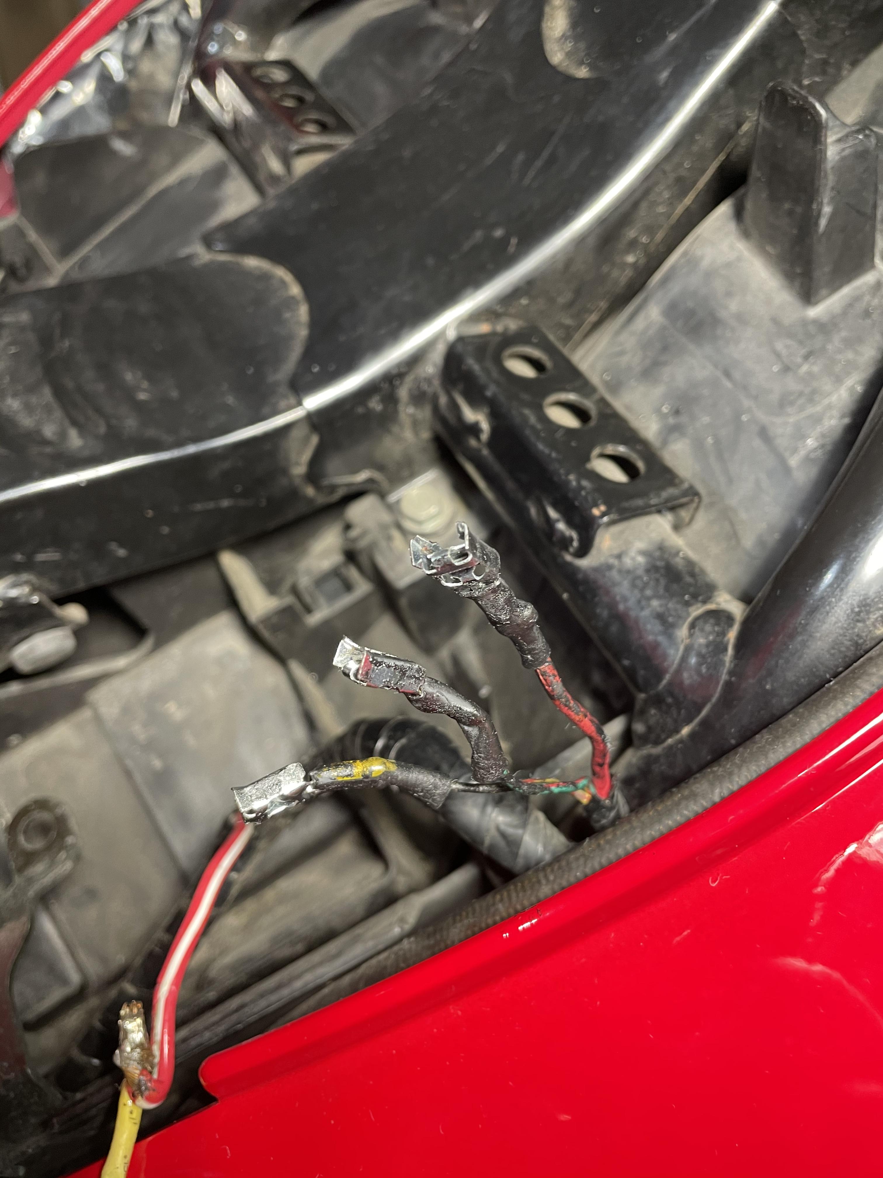

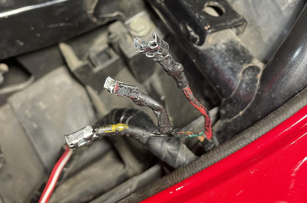

Member Contributer DannoXYZ Posted December 13, 2020 Member Contributer Posted December 13, 2020 This is good progress! These don't look like original female spade terminals bike came with. Cut away the wrap and let's see how the "repair" was done. Were these individually-wrapped when you unraveled the mess? When you're ready to repair harness with proper solenoid-connector, you'll want to trim these connectors off anyway. What happened to the yellow wires that were attached to those terminals? It appears he made short "extension" to reach solenoid? Quote

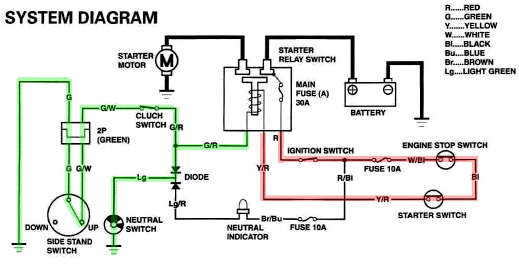

Member Contributer DannoXYZ Posted December 13, 2020 Member Contributer Posted December 13, 2020 Let's do some testing of power and ground sides of solenoid-control. Leave battery disconnected. Set meter to lowest resistance range (ohms). 1. measure resistance between R and Y/R wire terminals. Ohms = ??? 2. key ON, engine stop-switch to RUN, push START button. Ohms = ??? 3. release START button. Ohms = ??? 4. push & release START button couple more times. Behavior same? 5. measure resistance between G/R wire terminal and chassis-ground. Can use bolt on frame or battery negative terminal. Ohms = ??? 6. put trans into 1st-year. Ohms = ??? 7. put kickstand down, Ohms = ??? 8. put kickstand up, Ohms = ??? 9. squeeze clutch. Ohms = ??? We are building table/spreadsheet what's known as "finite state machine" in programming. It lists all possible states of important wire-junctions. Then we compare to the reference table of what it SHOULD be. Discrepancies will highlight areas for closer inspection. You have at least TWO issues. One is power-side of solenoid activating by itself. Second issue is ground side of solenoid activation not working properly with interlock safety switches. Suspect PO had rigged and bypassed interloc safety switches. Which is how your starter was able to run with kickstand down. Fixing either, ideally BOTH issues will solve this problem for good. Quote

Member Contributer ShipFixer Posted March 14, 2021 Author Member Contributer Posted March 14, 2021 On 12/9/2020 at 10:42 PM, DannoXYZ said: Original harness had connector for solenoid control. You'll want to restore your wiring back to factory spec by replacing those individual connectors with proper starter-solenoid connector: https://www.amazon.com/gp/product/B06XC7KY6S/ To install, cut back wiring from those individual spade connectors until you've removed all the bad splicing PO did; leaving only original 3 harness wires (G/R, Y/R and R). Then use proper in-line WesternUnion/lineman's splice to join new pigtail to harness. Combine the 2 red wires from pigtail together before connecting to harness's red wire. This will spread harness power-load across 2x spade-connectors instead of factory's 1 and prevent overheating. G -> G/R on harness B -> Y/R on harness R+R -> R on harness BTW - DO NOT EVER use butt-splice crimp connectors. They don't meet high-reliability criteria and will fail on you (I use 50-year time-frame). All wiring-splices should be tied, soldered and adhesive heatshrink-wrapped. It's done this way in pro-motorsports, military and aerospace applications for performance, reliability and durability.. Aaaahhhh I found your instructions here! Double up on R, that's what I thought. Thanks again, going to try to get to this tonight, got a load of shrink wrap and everything else I need 😎 Realized I can just put some foam and rubber around the solenoid till I get the new holder in. Good shot at optest in the next day or so... Quote
