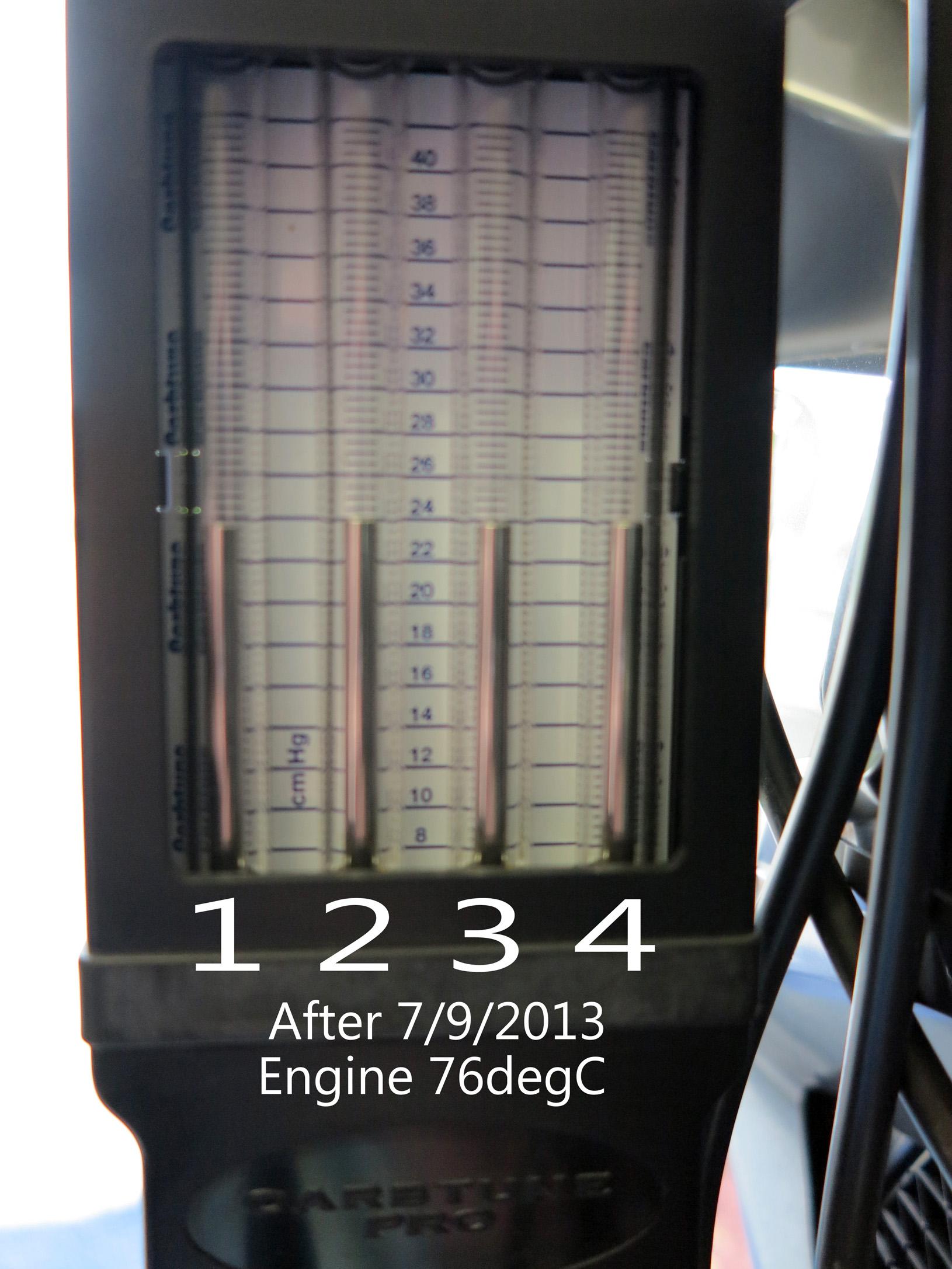

Member Contributer Grum Posted September 5, 2020 Member Contributer Posted September 5, 2020 Yep agree, Morgan Carbtune is an excellent bit of kit. Hang it on the bike do a bit of plumbing and away you go. (bottom picture 2009 6gen synch. After adjustments). Quote

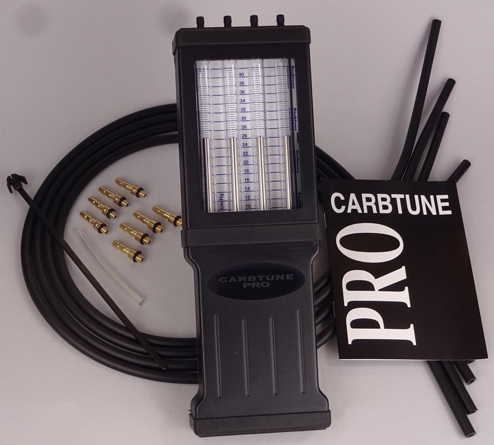

bog Posted September 5, 2020 Author Posted September 5, 2020 I havent received my service manual yet so i have a few questions, when syncing the starter valves, do you prop the tank up at the front? I have ordered a carbtune pro 4, should have it in a week. I used to sync carbs back in the 80s with a mercury column tool, worked pretty good. Do youknow if this carbtune pro 4 requires any additional equipment to sync a 2003 vfr 800, tubing adaptors etc... also i have read that the 6th generation interceptors have different vacume readings for the 4 cylinders to be synced correctly? Any info would be greatly appreciated. bog Quote
Member Contributer Grum Posted September 5, 2020 Member Contributer Posted September 5, 2020 You can download the Service Manual from this forum, download section. Yes it can be done by having the tank in the maintenance position. The carbtune comes with all you need to connect it to the Starter Valve vacuum hoses. It's the 5gen that has the offset vacuum, the 6gen is balanced and referenced to cylinder 4. Quote
