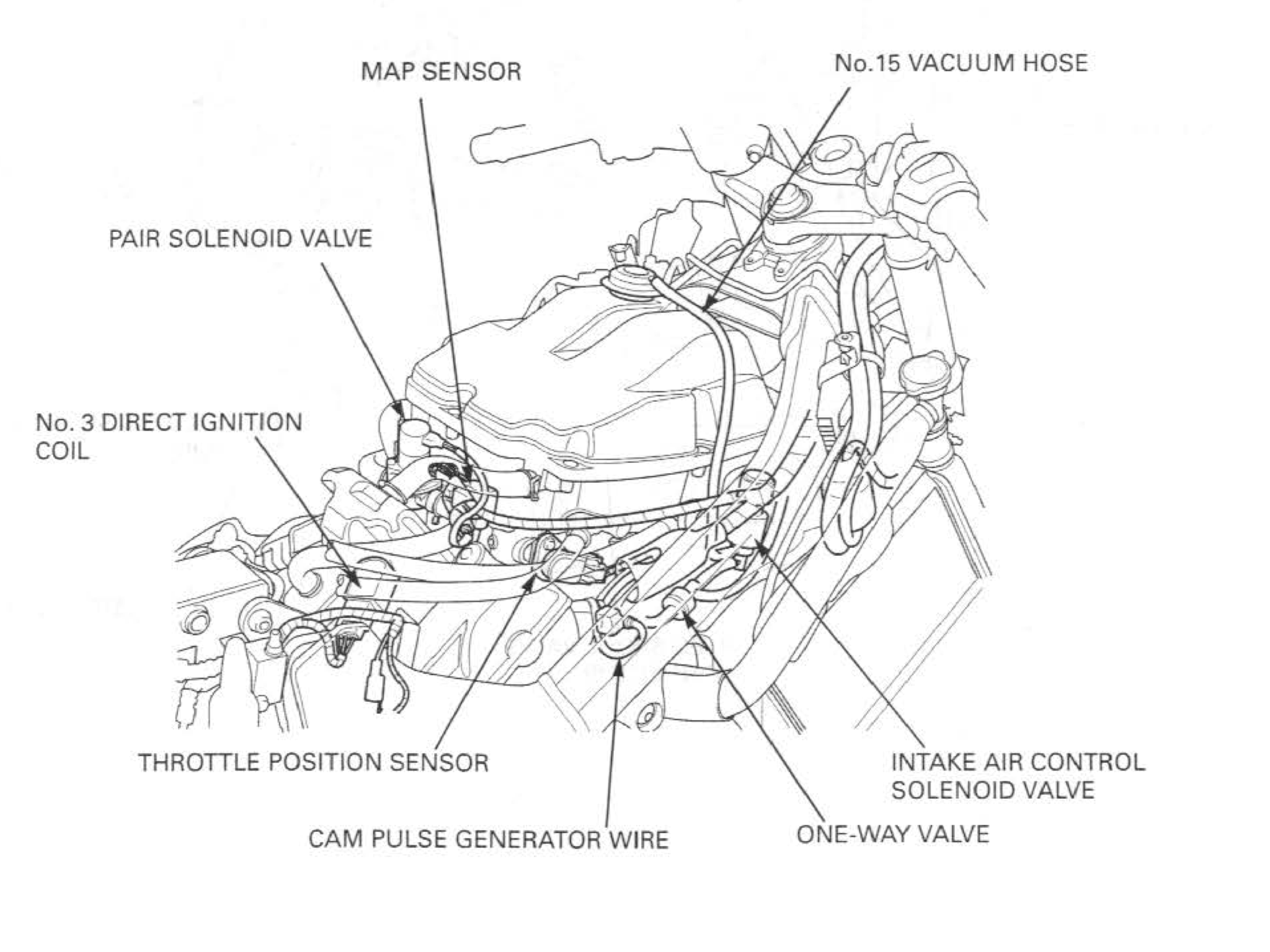

Member Contributer N2v Posted June 6, 2020 Author Member Contributer Posted June 6, 2020 Ok ive finally put in the cct when do I remove the key? And where does this hose go to? Quote
Member Contributer Grum Posted June 6, 2020 Member Contributer Posted June 6, 2020 If the CCT is fully mounted, then remove the key and install the end bolt and sealing washer. Think you are holding the Vaccum hose to the Air Intake Diaphragm on top of the air filter housing. You also have the control valve electrical connector removed from the valve. Also just to be sure did you transfer the steel cap to your new CCT? Or did you order a new cap as well? Do you have the Service Manual? You can download it from this site. 1 Quote
Member Contributer N2v Posted June 6, 2020 Author Member Contributer Posted June 6, 2020 I ordered a new cap, and slightly squeezed it. So it won’t come off. When installing it. fingers crossed 🤞🏼 I’ll pull the pin tomorrow so what ur saying is, the end of the hose goes ontop of the air box near the flapper? Quote
Member Contributer Grum Posted June 6, 2020 Member Contributer Posted June 6, 2020 9 hours ago, N2v said: so what ur saying is, the end of the hose goes ontop of the air box near the flapper? What's your aim? Do you want the "Flapper" system working or not working? The electrical connector to the control solenoid has recently been removed! And your now showing the hose taped to the airbox with it blocked off. The snorkel is removed, is this something you wanted or was there a previous owner of your bike that removed it? Quote

Member Contributer N2v Posted June 7, 2020 Author Member Contributer Posted June 7, 2020 4 hours ago, Grum said: What's your aim? Do you want the "Flapper" system working or not working? The electrical connector to the control solenoid has recently been removed! And your now showing the hose taped to the airbox with it blocked off. The snorkel is removed, is this something you wanted or was there a previous owner of your bike that removed it? That picture was for reference only ✌🏽 I know the connector is not connected. I just wanted to know where does the hose connected, dose it go to the airbox? Quote
Member Contributer Grum Posted June 7, 2020 Member Contributer Posted June 7, 2020 1 hour ago, N2v said: That picture was for reference only ✌🏽 I know the connector is not connected. I just wanted to know where does the hose connected, dose it go to the airbox? As previously mentioned - to the Air Intake Vacuum Diaphragm on top of the Air Box! I think a picture might be worth a thousand words. No.15 VACUUM HOSE. Quote
