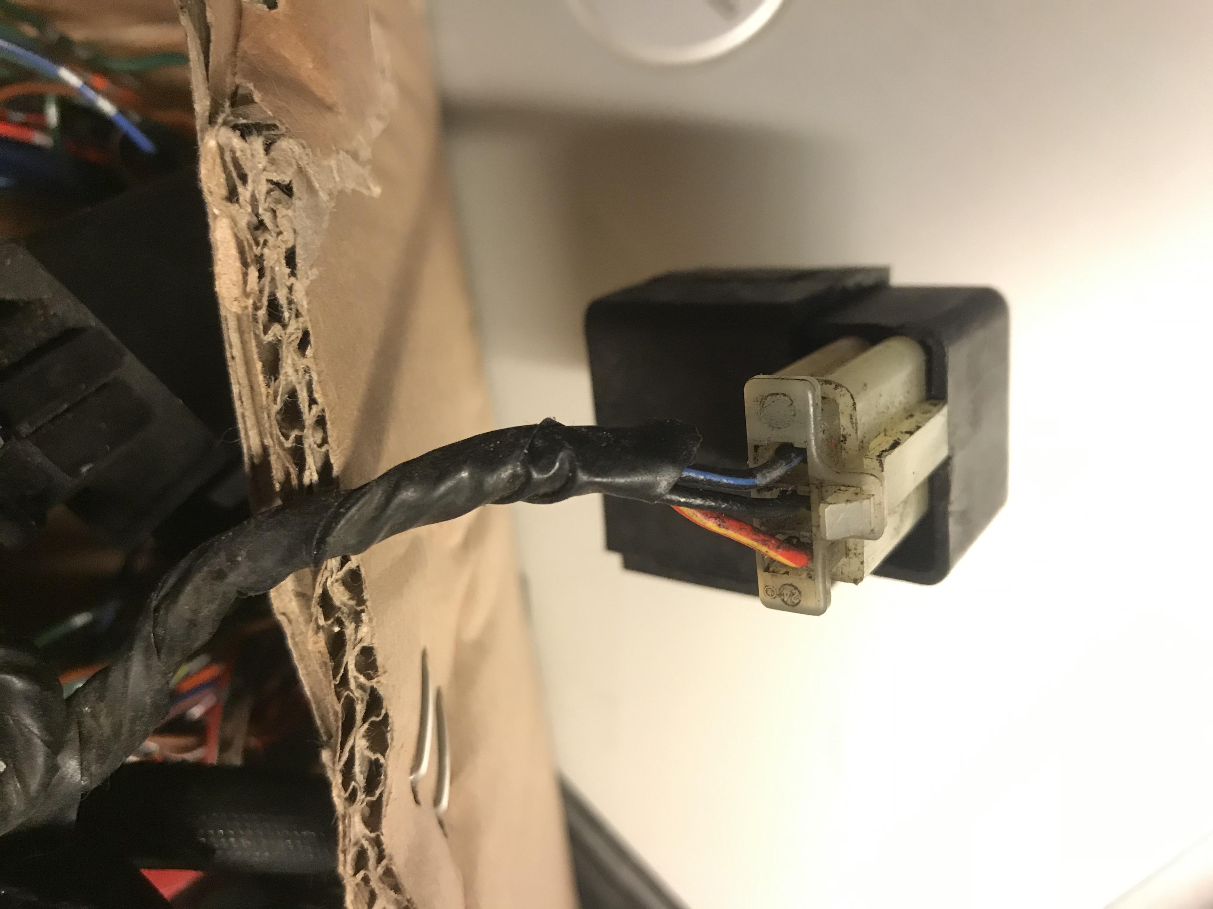

Hello!
I have a very special question - can anybody with an RC 24 or RC36 tell me, which colour is assigned to which pin on the fuel cut relay plug? I know, that the wires are black, red/orange, and blue/black. And actually I know, the place of the red/yellow wire, but the photo I have does not show the difference between black and black/blue enough - so I probably only need to know, which colour is the center wire, ....
Background:, The fuel cut relay on my VF (RC15) is broken, and I shortwired it. So, when I switch on the ignition, the fuel pump starts working. However, if the bike is standing a few months, the floats get stuck, the carbs overflow and I have to follow a certain procedure to be able to start it (switch on ignition, wait until the carbs overflow, wait 2 days, start the bike)). Plus I am suspecting, that some fuel starts leaking into the oil, as it starts overflowing the carbs. So, I want to have the fuel cut relay.
Now, the fuel cut relay for the RC 15 is VERY expensive and hard to find, as there are no aftermarket parts available. However, the parts for the RC24/RC36 are much cheaper and more common. After looking at the wiring diagrams of the RC15 and the RC24/RC36, I discovered, that the fuel cut relay have exactly the same working princible, and after checking a few parts diagrams, I discovered, that some early VFRs used the RC15 fuel cut relay with the RC24/RC36 fuel pumps. So, I deduct, that the RC15 and RC25/36 relays should be interchangeable, but the pin assignment would likely be different. If it was not different, the RC24/RC36 fuel cut relay would likely be marked as successor to the RC15 part. So, I want to replace the RC15 relay with the RC24/RC36 relay, but I need the pin assignment.

@Gebruiker: Thanks for the picture, but this I know already. I need a photo of the real conntector since the wiring diagram does not represent the actual situation in the connector (red/yellow is not in the center)

Fuel cut-off relay on wiring (4. gen. / RC36/2). From top (as to photo orientation):
  • black/blue (+ to fuel pump)
  • black (+ from fuse)
  • red/yellow (ignition pulse #4)
I agree with squirrelbrains - it takes a lot of cranking with the relay installed... I suggest a jump-wire to short the black and black/blue before cranking...
