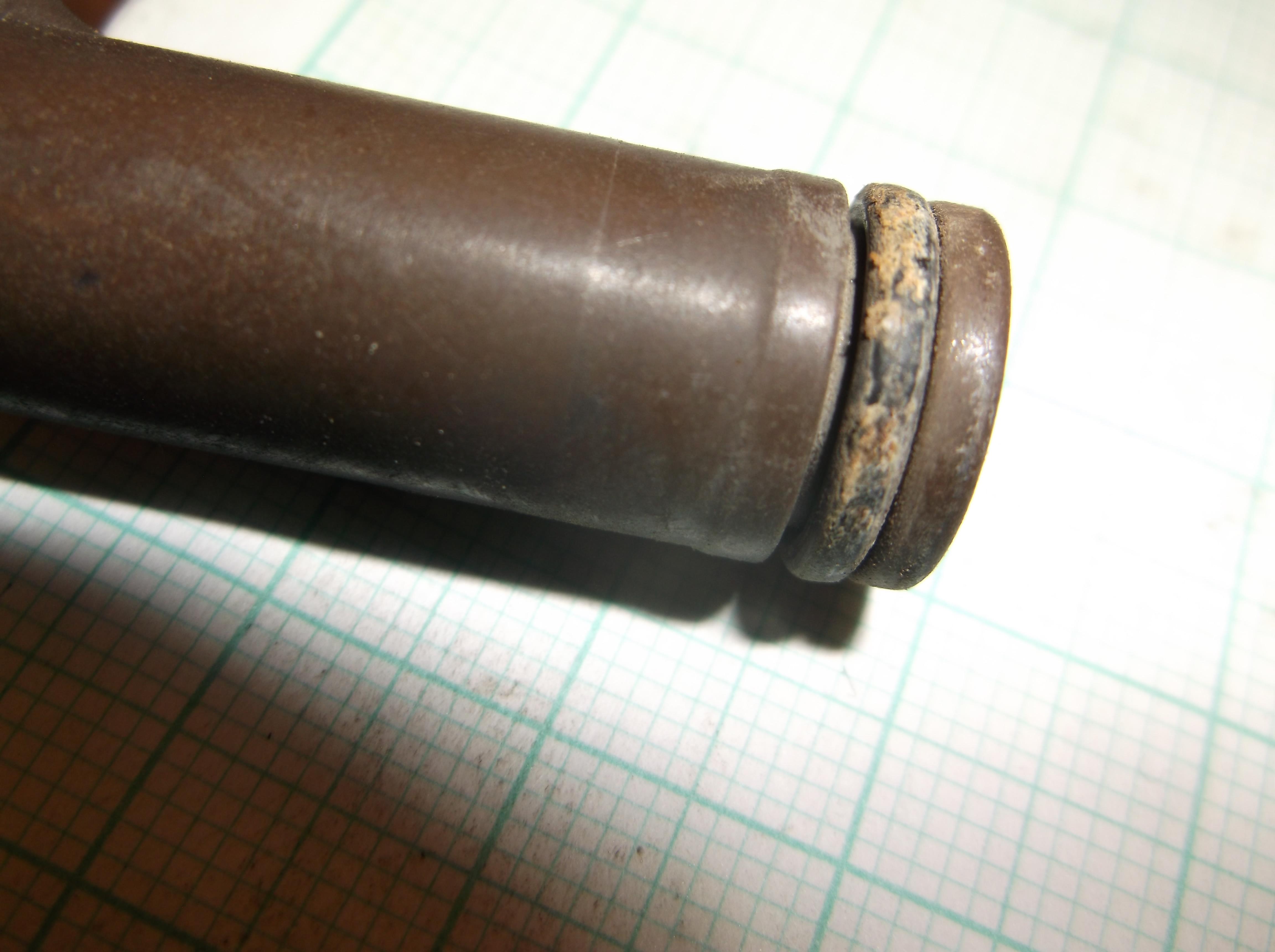

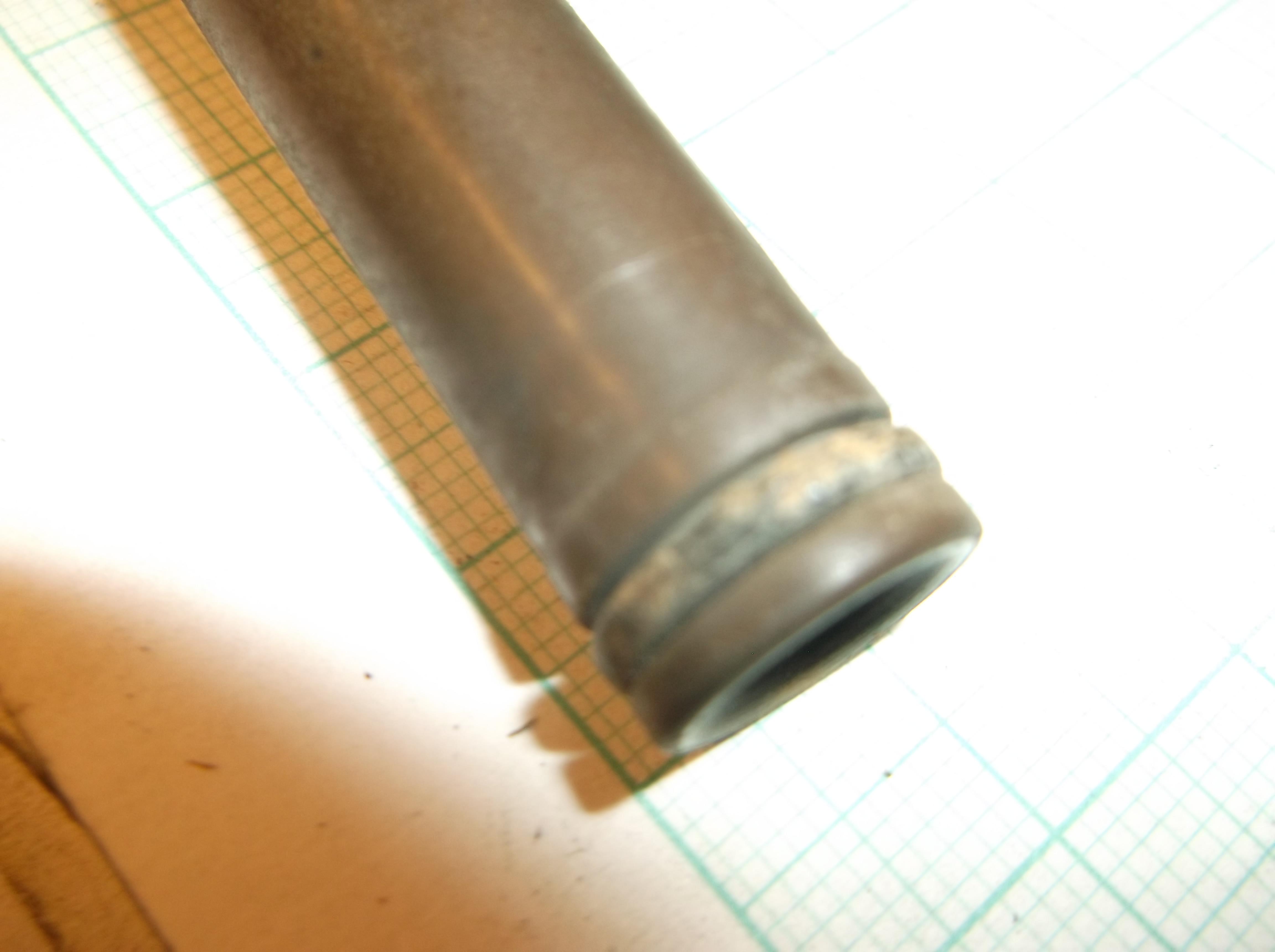

Member Contributer Captain 80s Posted October 5, 2019 Member Contributer Posted October 5, 2019 There's a ton of variables here. Assuming the obvious stuff (air cleaner, plugs, caps, etc), have you properly gone thru the carbs? And when you do, you should "split" them to replace the fuel crossover o-rings. They are a ticking time bomb at their age unless you are 100% sure they have been replaced. Every single set I've done in the last few years nearly crumbled in my hand and they all were cracked. Also perhaps some ether while idling to check for intake leaks. The rubber intake boots can be bad by now too. Quote
squirrelman Posted October 6, 2019 Posted October 6, 2019 12 hours ago, Captain 80s said: There's a ton of variables here. Assuming the obvious stuff (air cleaner, plugs, caps, etc), have you properly gone thru the carbs? And when you do, you should "split" them to replace the fuel crossover o-rings. They are a ticking time bomb at their age unless you are 100% sure they have been replaced. Every single set I've done in the last few years nearly crumbled in my hand and they all were cracked. Also perhaps some ether while idling to check for intake leaks. The rubber intake boots can be bad by now too. look at the O-rings with a 10X magnifier to see the real imperfections. seems like they always leak through the rusty crusty buildup. going through the manual's "idle drop" adjustments might be necessary.......after all and a plug color comparison. Quote
