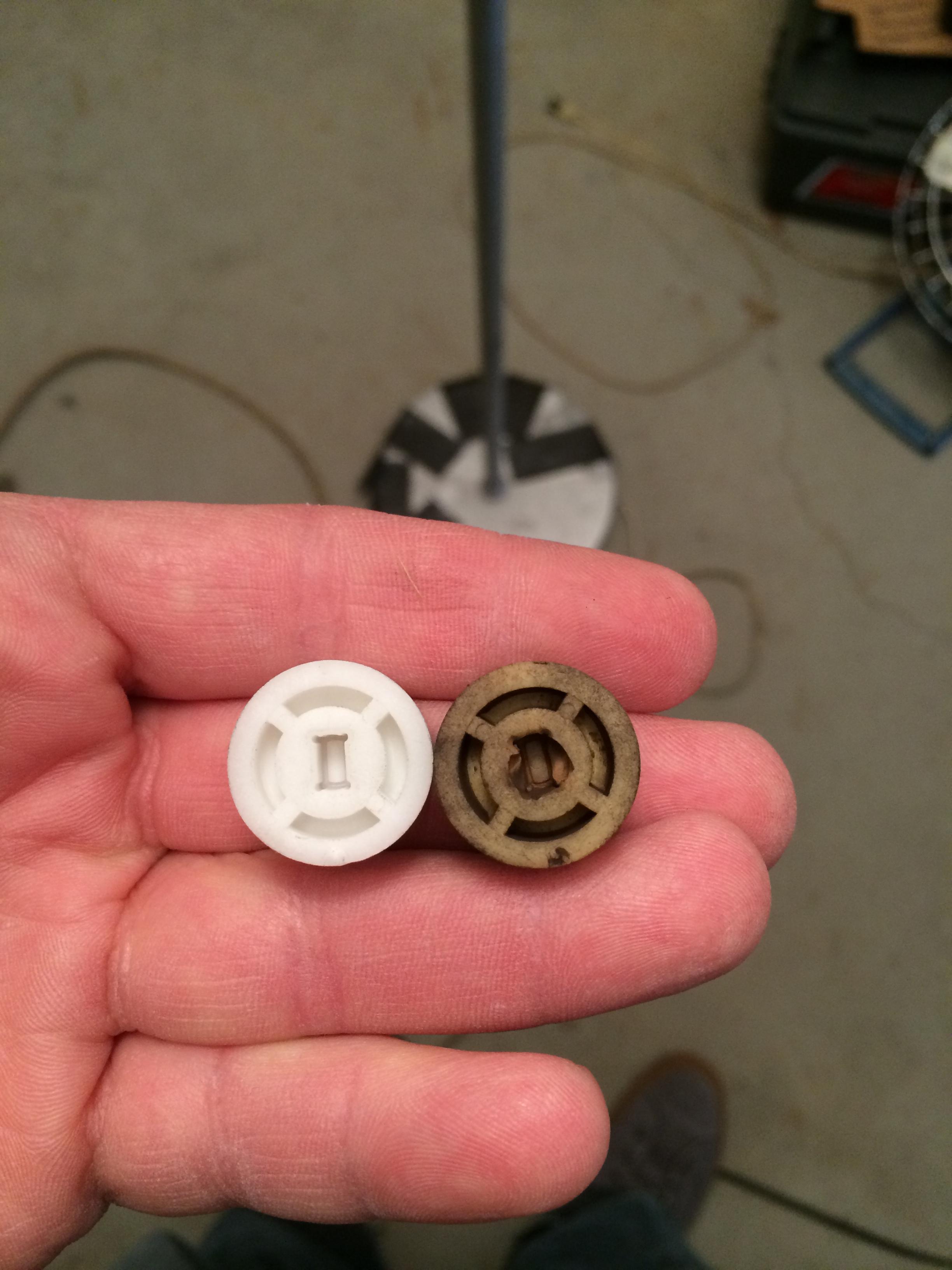

Member Contributer speedball73 Posted September 11, 2019 Member Contributer Posted September 11, 2019 Anybody had this happen before? Sent from my iPhone using Tapatalk Quote
Member Contributer speedball73 Posted September 11, 2019 Author Member Contributer Posted September 11, 2019 Ok so returned to the shop and somehow my speedo sensor was jammed onto the mount too hard, too far from the countershaft. Luckily they had a spare and got me on my way in 15 min!Sent from my iPhone using Tapatalk Quote
Member Contributer RDMcD Posted September 12, 2019 Member Contributer Posted September 12, 2019 Happens all the time with inexperienced mechanics. Did it myself once, not gonna lie.lol They didn't need a new part likely, the plastic nut will slide on the shaft. Hopefully the dealer wasn't giving you the shaft! Seems a little odd that they had such an obscure part for a 20 year old bike in stock... doesn't it? Quote
Member Contributer gll429 Posted September 12, 2019 Member Contributer Posted September 12, 2019 it was used on about 30 bikes... soooo.. Quote
Member Contributer speedball73 Posted September 12, 2019 Author Member Contributer Posted September 12, 2019 Happens all the time with inexperienced mechanics. Did it myself once, not gonna lie.lol They didn't need a new part likely, the plastic nut will slide on the shaft. Hopefully the dealer wasn't giving you the shaft! Seems a little odd that they had such an obscure part for a 20 year old bike in stock... doesn't it? When I went back I watched the guy take it off - in all fairness he wasn’t a noob - but he didn’t think it was fixable - I didn’t want to share this part of the story (because some might think it makes the shop look bad), but let’s just say a good customer of theirs with a VFR was willing to “lend” his to me. They didn’t have it at the parts counter so to speak (I watched them pull it off the donor bike and put it on mine).Sent from my iPhone using Tapatalk Quote
Member Contributer RDMcD Posted September 12, 2019 Member Contributer Posted September 12, 2019 Good to know they didn't charge you for the part. It was an error on the mechanics part though and totally preventable. Maybe he was having a bad day...it happens. If it worked when you went in it didn't go bad on its own though. If it ever happens again, a little pry with a screwdriver will slide the plastic nut back to its original position. Quote
Member Contributer speedball73 Posted September 12, 2019 Author Member Contributer Posted September 12, 2019 Good to know they didn't charge you for the part. It was an error on the mechanics part though and totally preventable. Maybe he was having a bad day...it happens. If it worked when you went in it didn't go bad on its own though. If it ever happens again, a little pry with a screwdriver will slide the plastic nut back to its original position. To be honest it was jumping around a little bit but in general reading the correct speed when I took it in - afterwards it would read 0 until I hit about 30 kph, and about 20% low in general - so something happened. But they stayed late after closing and made it right at no charge so hats off to them.For those reading this that don’t know I’m halfway through a 6000 mile trip and I’m pretty far from home, so I’m thankful to be running (chain was shot).Sent from my iPhone using Tapatalk Quote

Member Contributer KevCarver Posted September 12, 2019 Member Contributer Posted September 12, 2019 It doesn’t hurt to replace it. They do wear out. If you got another used one it may still be pretty worn. Quote
