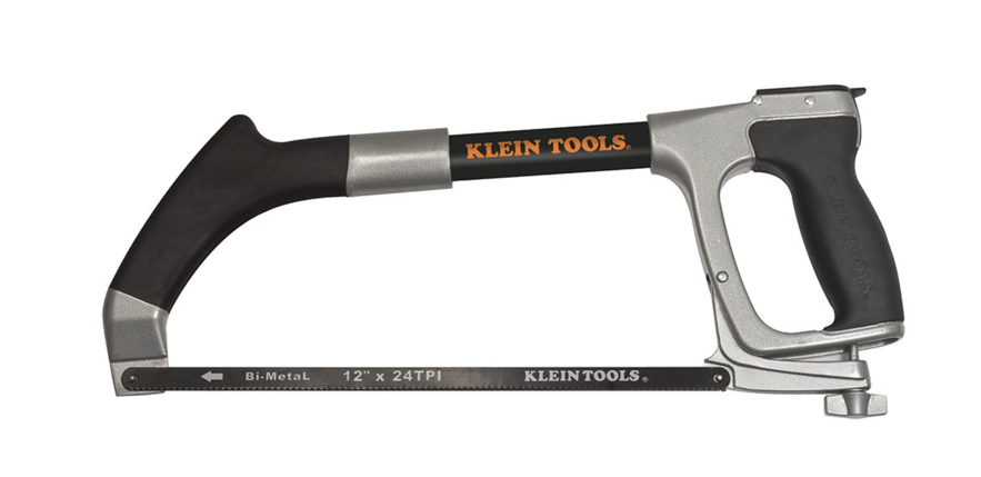

Here's the best all purpose fender eliminator cleanup kit.....
