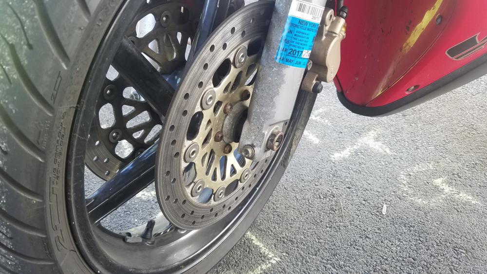

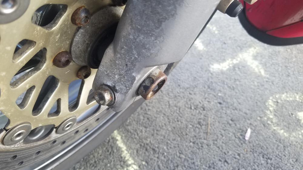

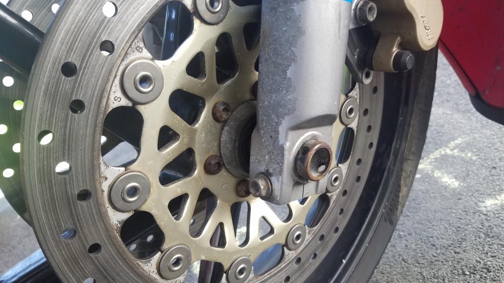

I have a 4th gen and the front wheel locking screw seems to be missing something.
The bolt that goes across the front wheel hub that holds the wheel, should it have some kind of pin, screw or nut on the other side?
It has a hole but I don't know if whatever that was there fell off.
I attached some pics.
thanks.
Nope.  The axle is held in place with the pinch bolt.  There's nothing missing.

Axle that's the word. 'Assembly' <== haha what a noob I am. just for my understanding the pinch bolt is the screw that's at the bottom of the fork? why is that hole there?
The rust was there when I bought it 6 years ago plus I park is outside all year, NYC apt living man.
AFAIK the hole in the axle is only used/useful for extracting the axle; I poke a screwdriver through and use that to twist and pull the axle out.
Pinch bolt is the bolt that pinches the axle mount together on the axle at the bottom of the fork leg.
