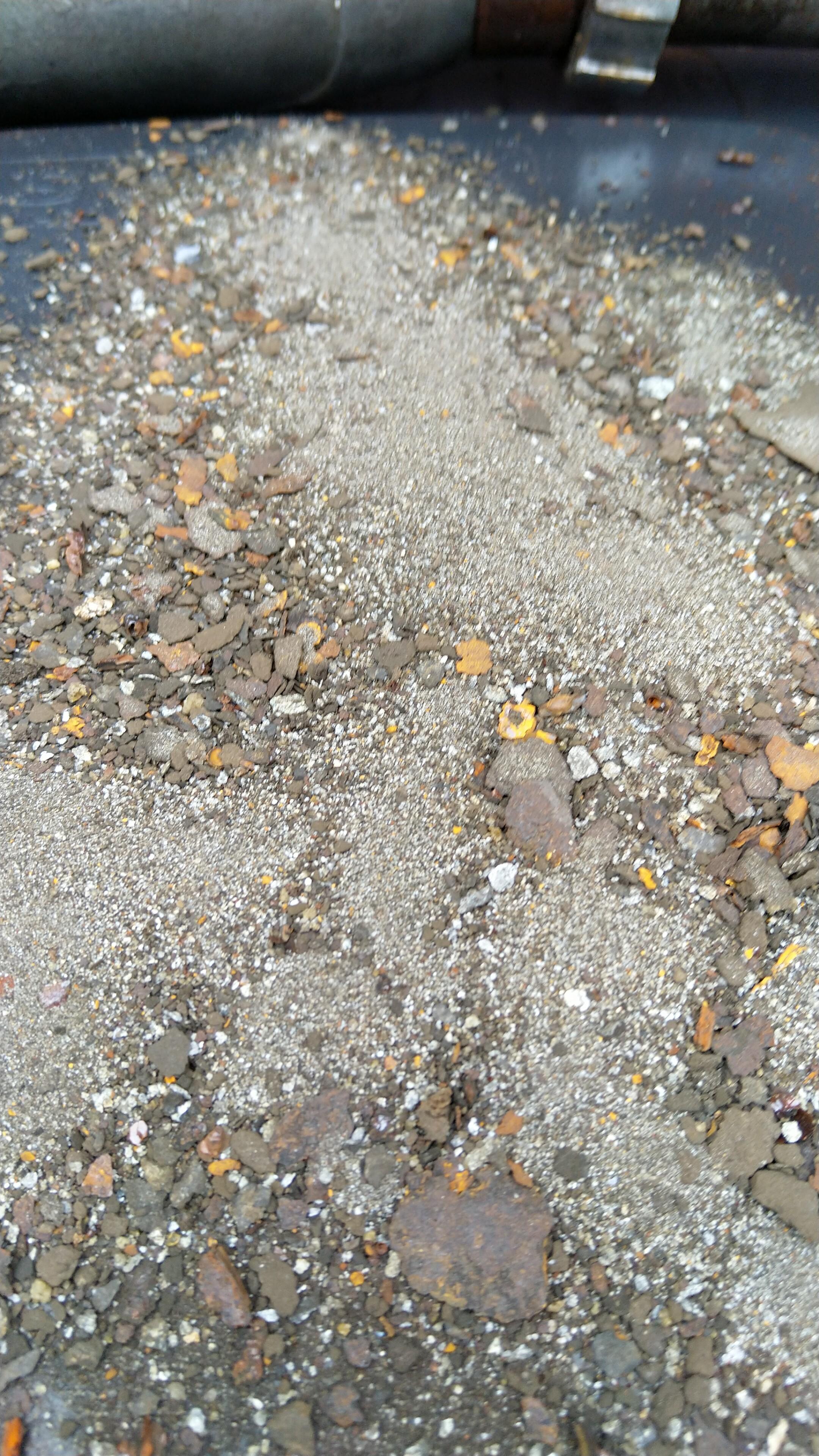

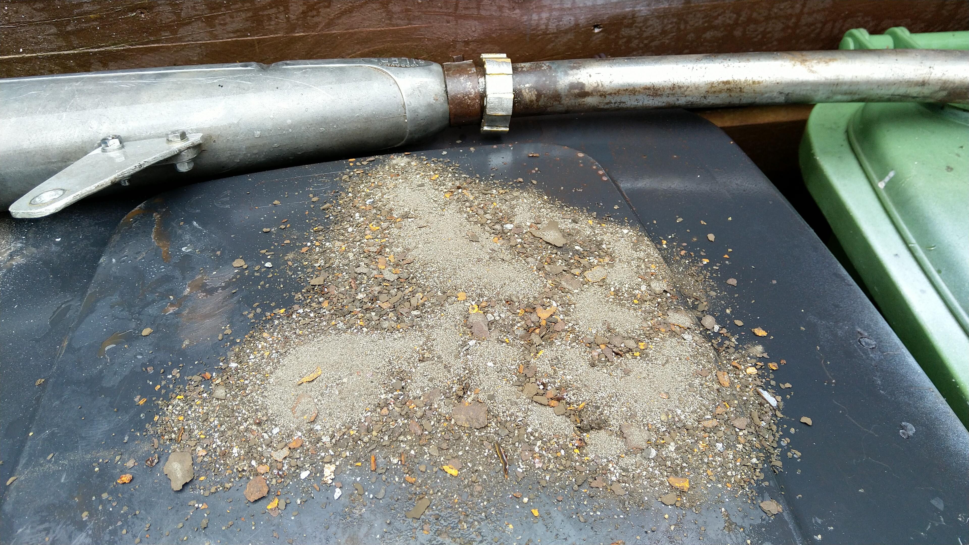

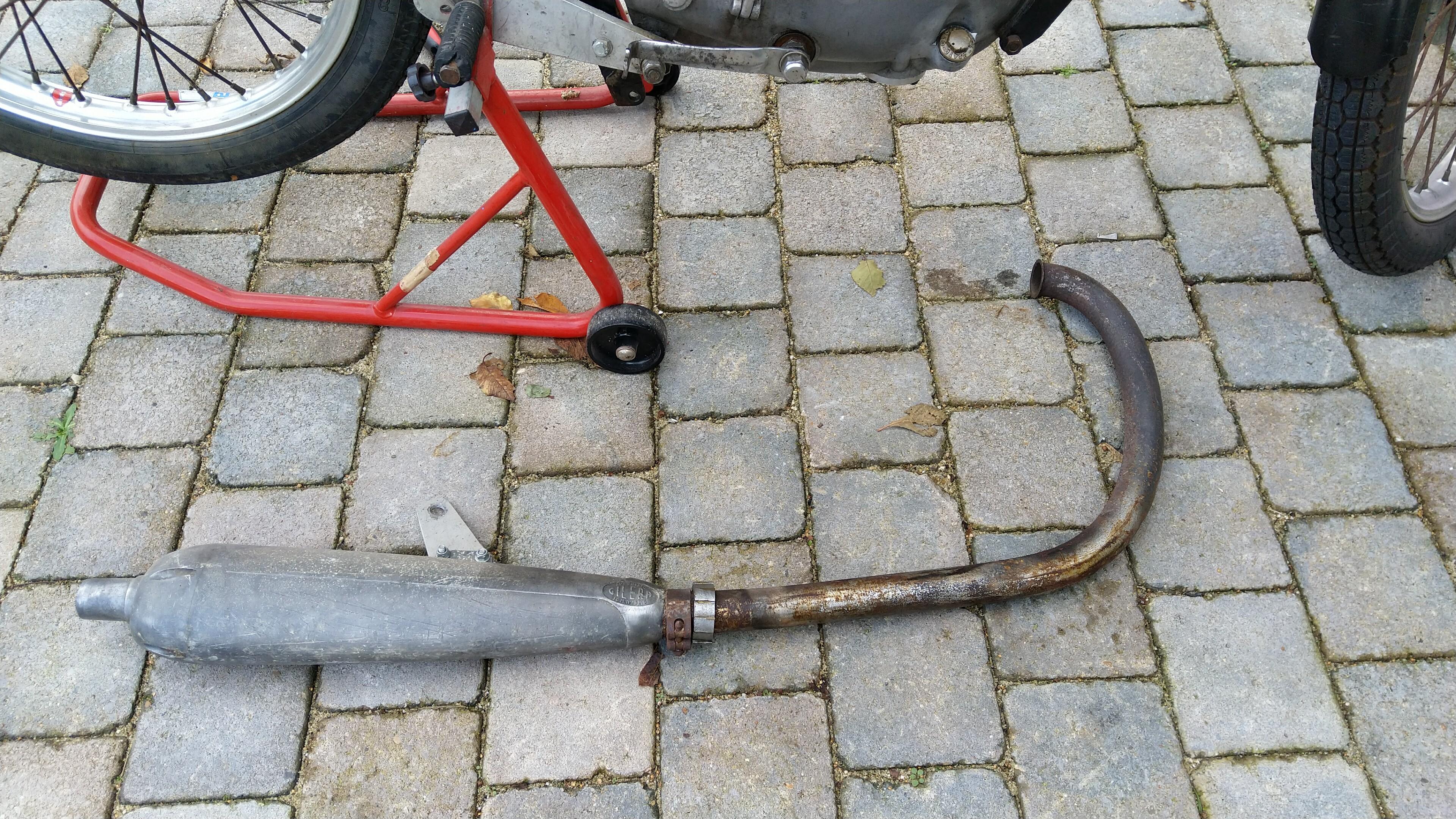

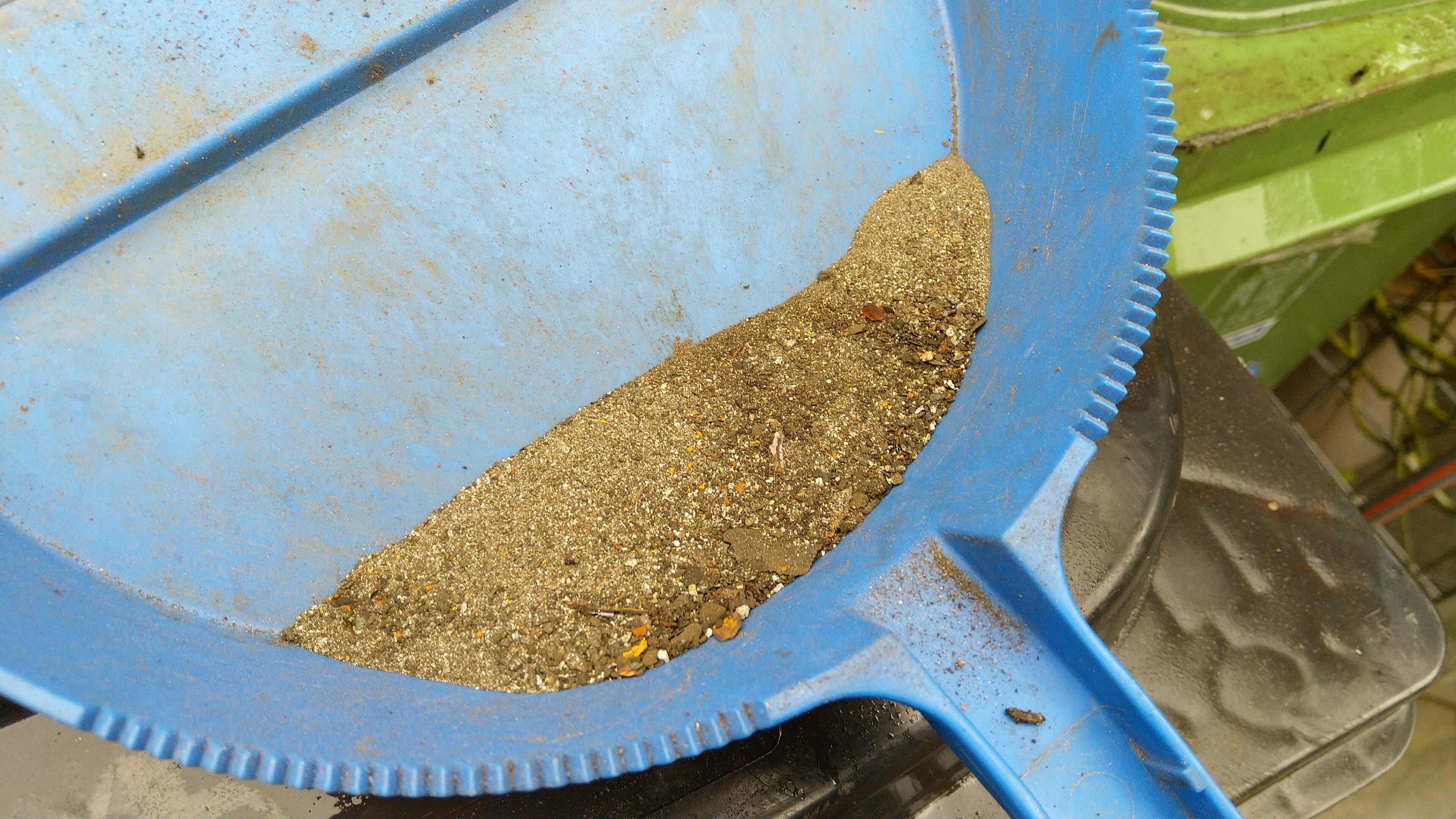

Member Contributer Dutchy Posted October 22, 2019 Author Member Contributer Posted October 22, 2019 Well, the Gilera dit not start "off the bat", so I will need to dig deeper. Carb was cleaned ultra-sonically, I have spark I have compression (I think...) I hove no kickstarter so pushing it is.... To no avail. so I gave up for the day, took the exhaust off and drove home Strarted cleaning which include putting a powerdrill+wire wheel on her... Then, when I helt it vertically, a shitload of primarily sand streamed out With rust flakes in for good measure. Ir was quite a volumen/weight So I'm (hoping) that this somehow blocked the exhaust flow so much that it hampered attempts to start her. Back on it maybe Thursday or Friday..... 🍀🍀🍀 Quote
jeremyr62 Posted October 22, 2019 Posted October 22, 2019 Take the spark plug out and put your finger down the hole (not that hole). Now push it down the road and test for compression. with your finger. And try not to get arrested at the same time. I take it you have plenty of petrol? Quote
jeremyr62 Posted October 22, 2019 Posted October 22, 2019 The density of iron corrosion products is a lot less than the iron itself so hopefully you still have some steel left. Quote
Member Contributer Dutchy Posted October 23, 2019 Author Member Contributer Posted October 23, 2019 9 hours ago, jeremyr62 said: Take the spark plug out and put your finger down the hole (not that hole). Now push it down the road and test for compression. with your finger. And try not to get arrested at the same time. I take it you have plenty of petrol? There is plenty compresseion methink. With the sparkplug revmoved and gearbox in 1st, rotatin the rear wheel is fairly easy. I can hear the piston puffing. with the spark plug is, it reauires siginificant effect. Och well, will try again in a couple of days. Quote
jeremyr62 Posted October 23, 2019 Posted October 23, 2019 And the timing is OK? If you have spark, petrol and compression it will fire eventually. Quote

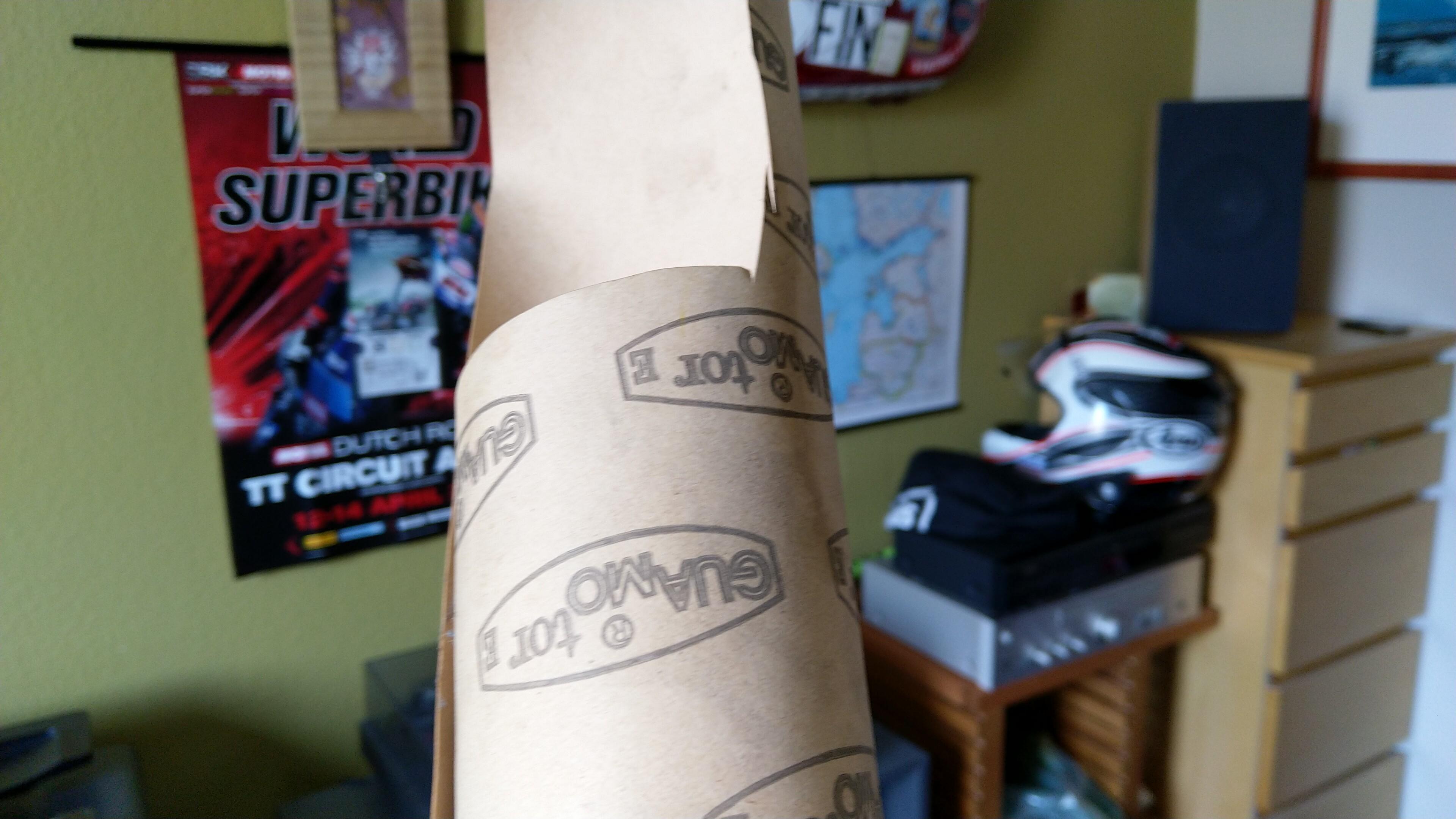

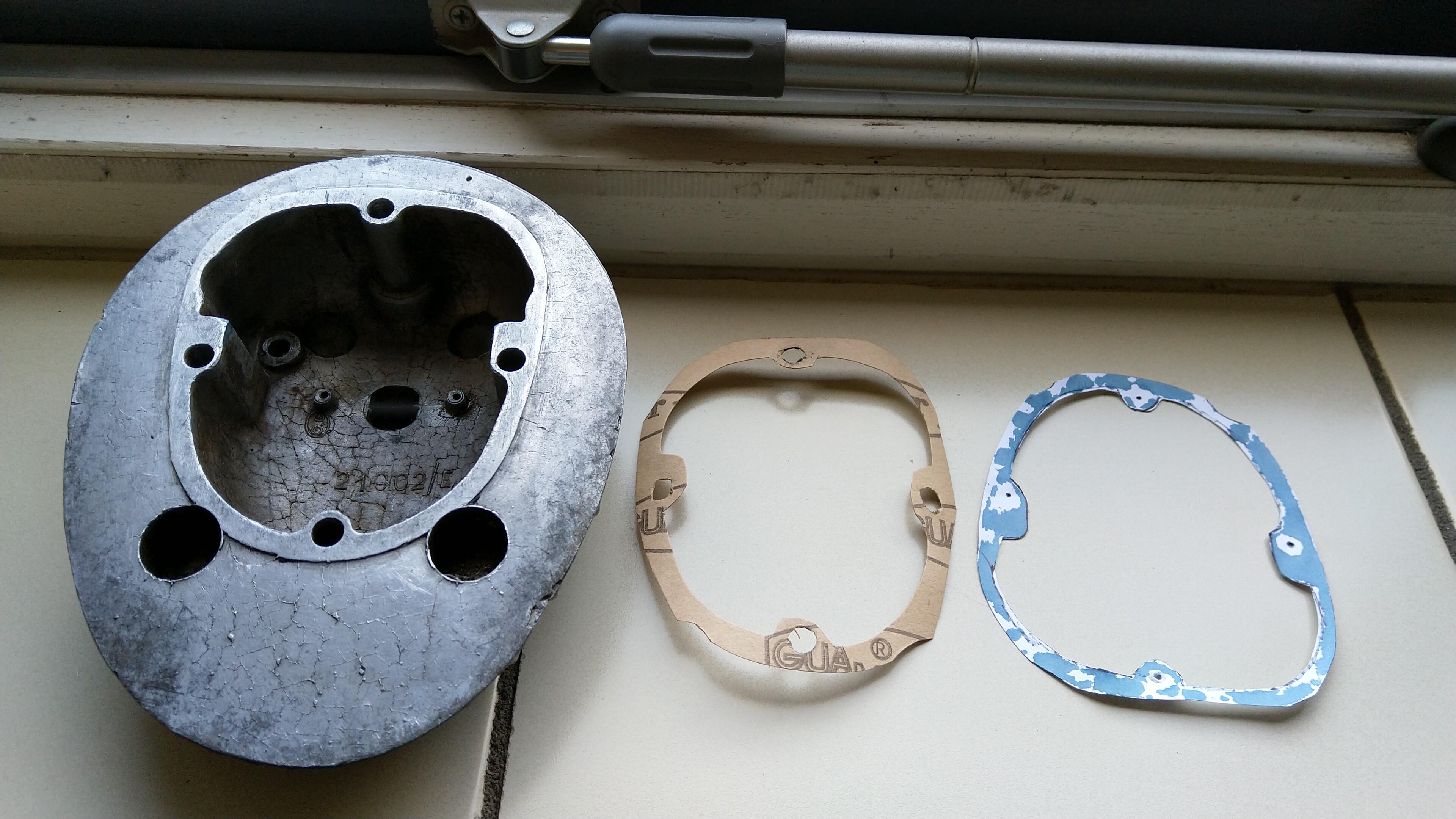

Member Contributer Dutchy Posted October 24, 2019 Author Member Contributer Posted October 24, 2019 Rocker cover gasket is iffy I reckon. Lifted the cover and found fresh oil on tge face and gasket. So I cut a new one.. will try tomorrow if this proves to be "it"... Never done one before, never too old to learn. Quote

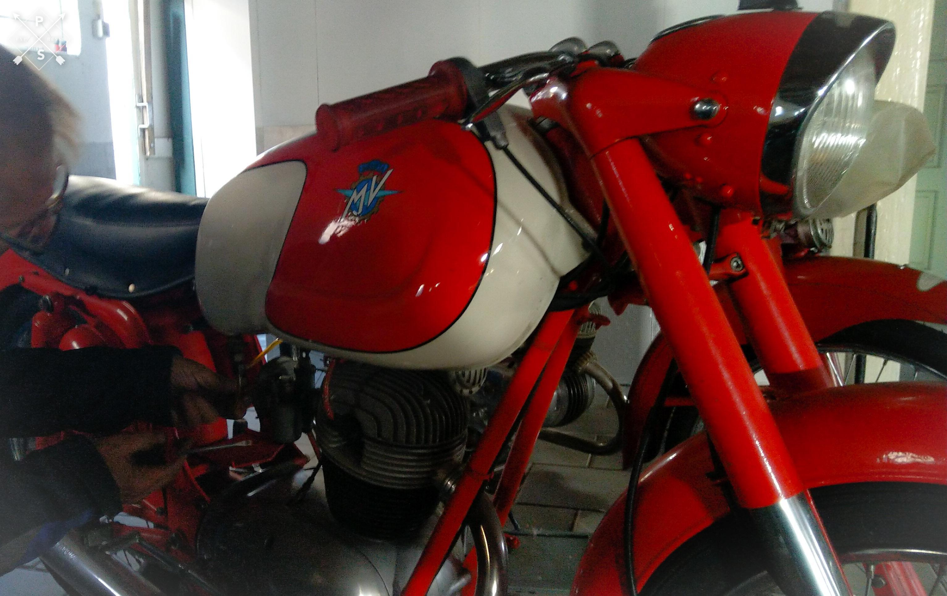

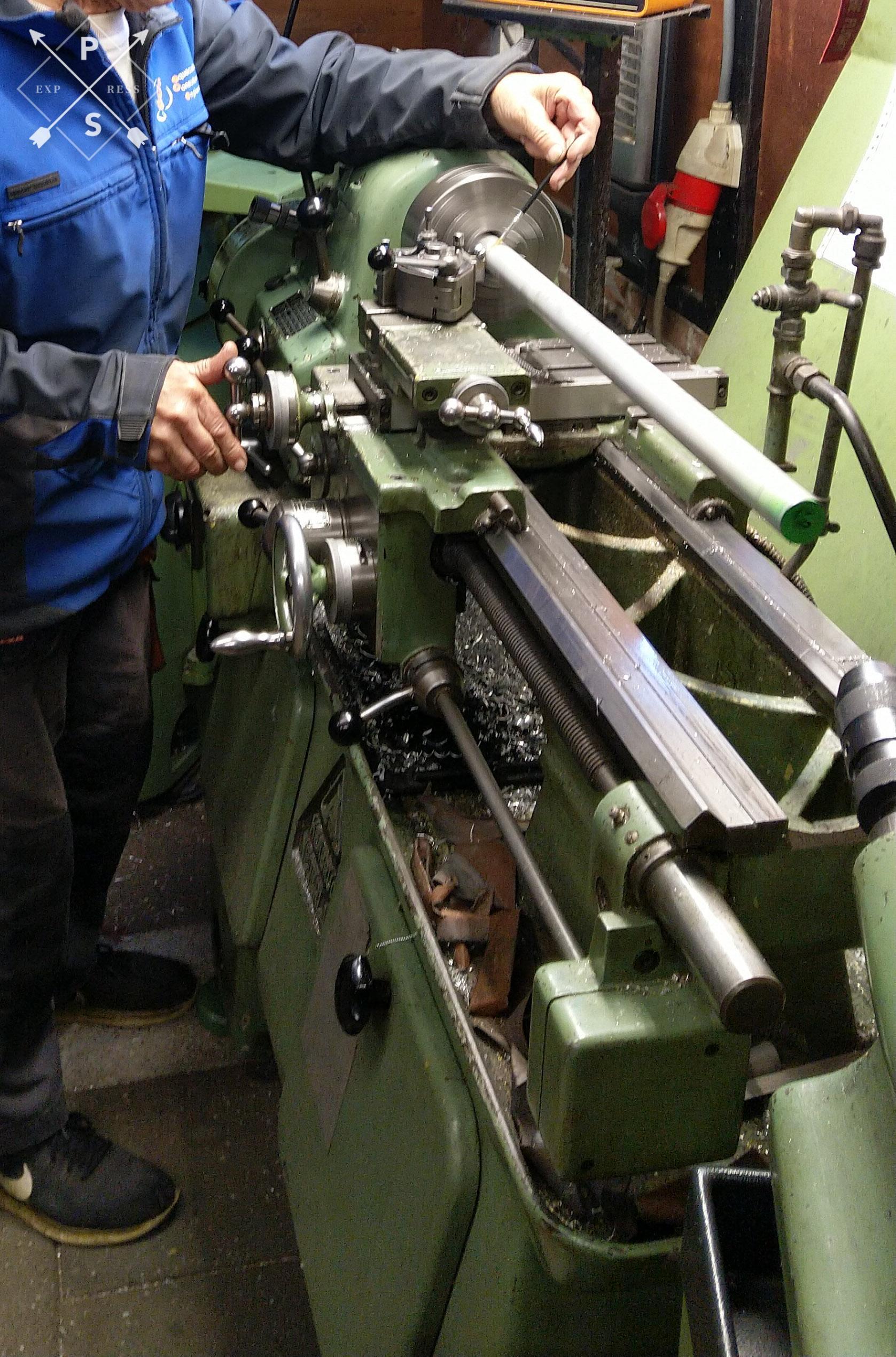

Member Contributer Dutchy Posted October 31, 2019 Author Member Contributer Posted October 31, 2019 The Gilera had (according to the Italian bike tech guru that made her run) a wrong sparkplug and a 2-stroke carb with incorrect jetting, connecting tube to a head a Walmart bit of cobbled together tubing. so he turned a new one. We tried salvaging as much parts from the incorrect carb to rebuild a proper one with a MA 18 B shell. But after fiddling with jets, needle height and shape, trying to ensure proper fuel level inside the bowl, he just said "who cares" and removed a perfect one from (one of) his MV Agusta's for me.... He owns a few yes, And knows how to turn from solid aluminium bar ... Han the THE MAN!!! 1 Quote

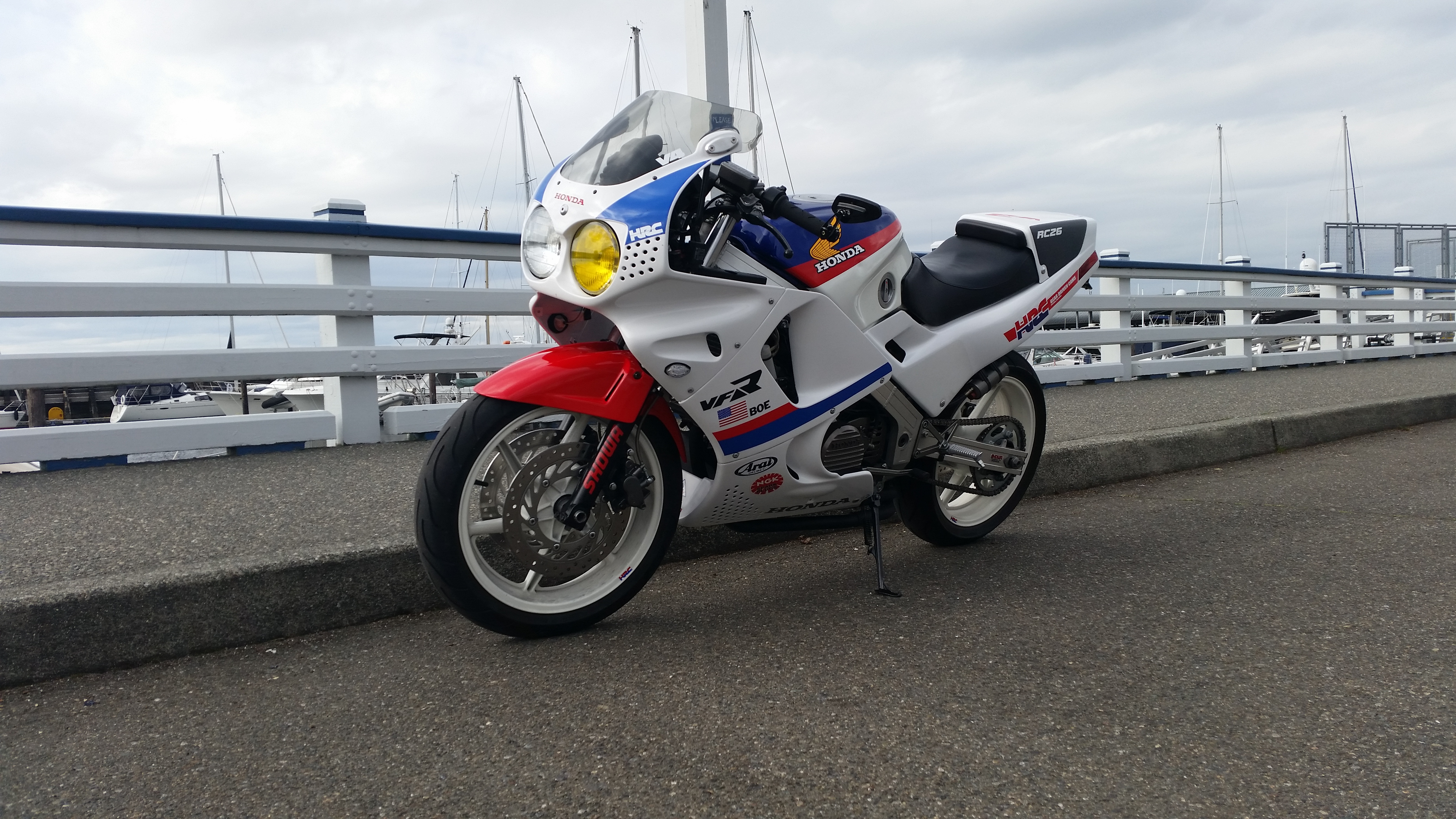

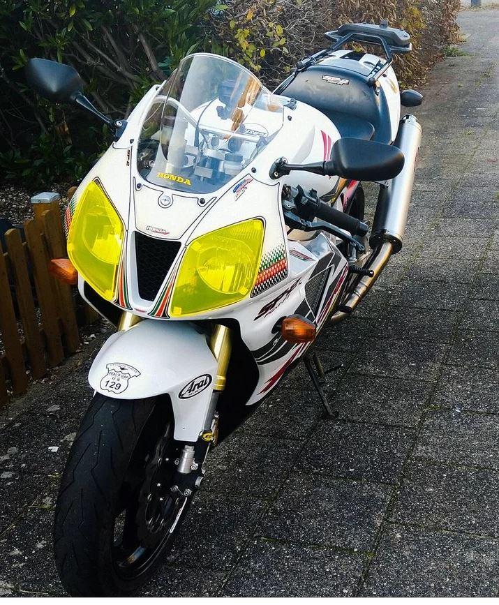

Member Contributer Captain 80s Posted October 31, 2019 Member Contributer Posted October 31, 2019 I did the left one with some headlight film as a nod to an endurance racer. Right now it is just the right that operates on low beam, 2 Quote
Member Contributer Dutchy Posted October 31, 2019 Author Member Contributer Posted October 31, 2019 I might go the yellow film route at some point..... Quote

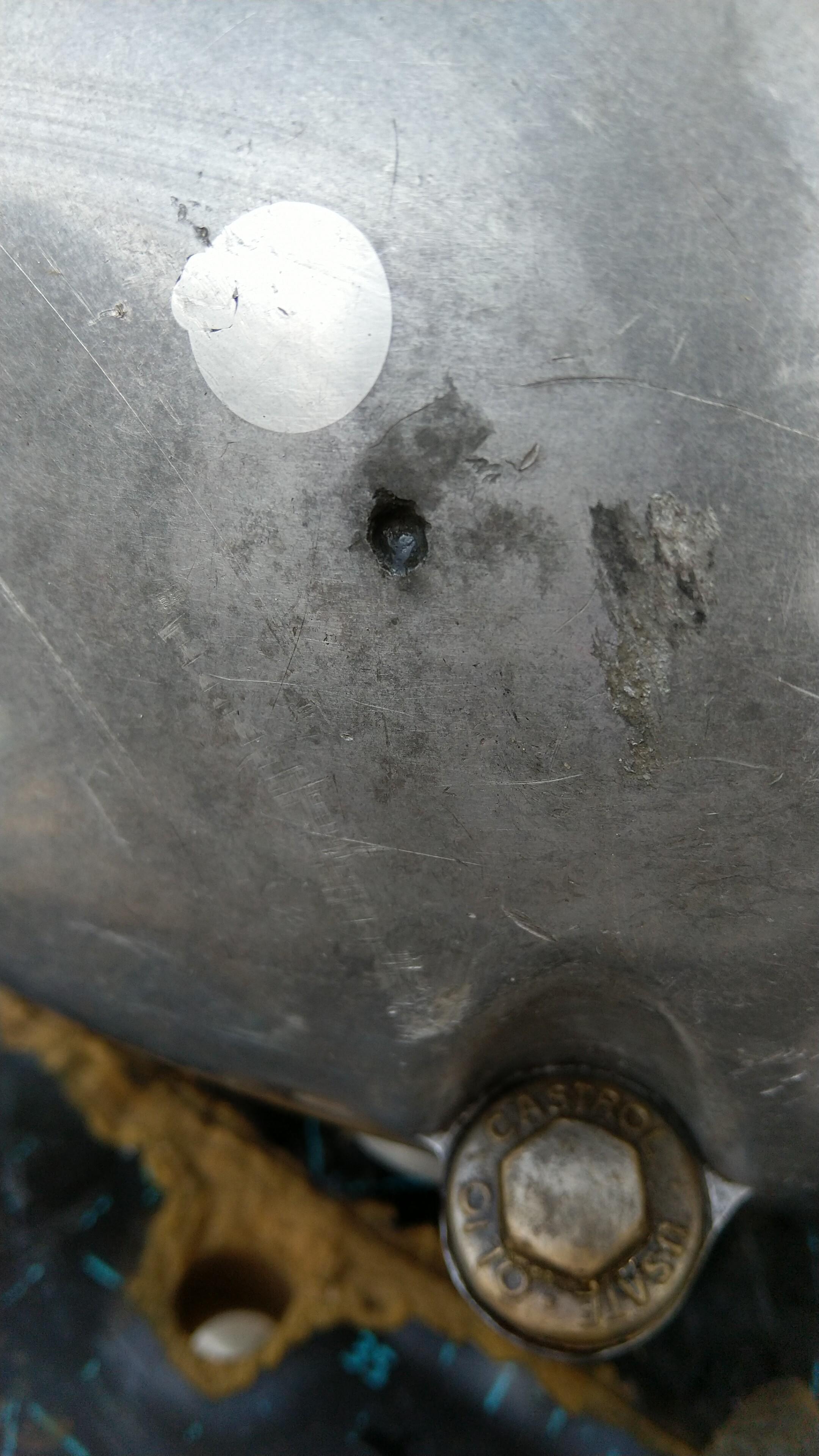

Member Contributer Dutchy Posted November 1, 2019 Author Member Contributer Posted November 1, 2019 The engine with the matching #'s to the frame has some "experience"... Quote

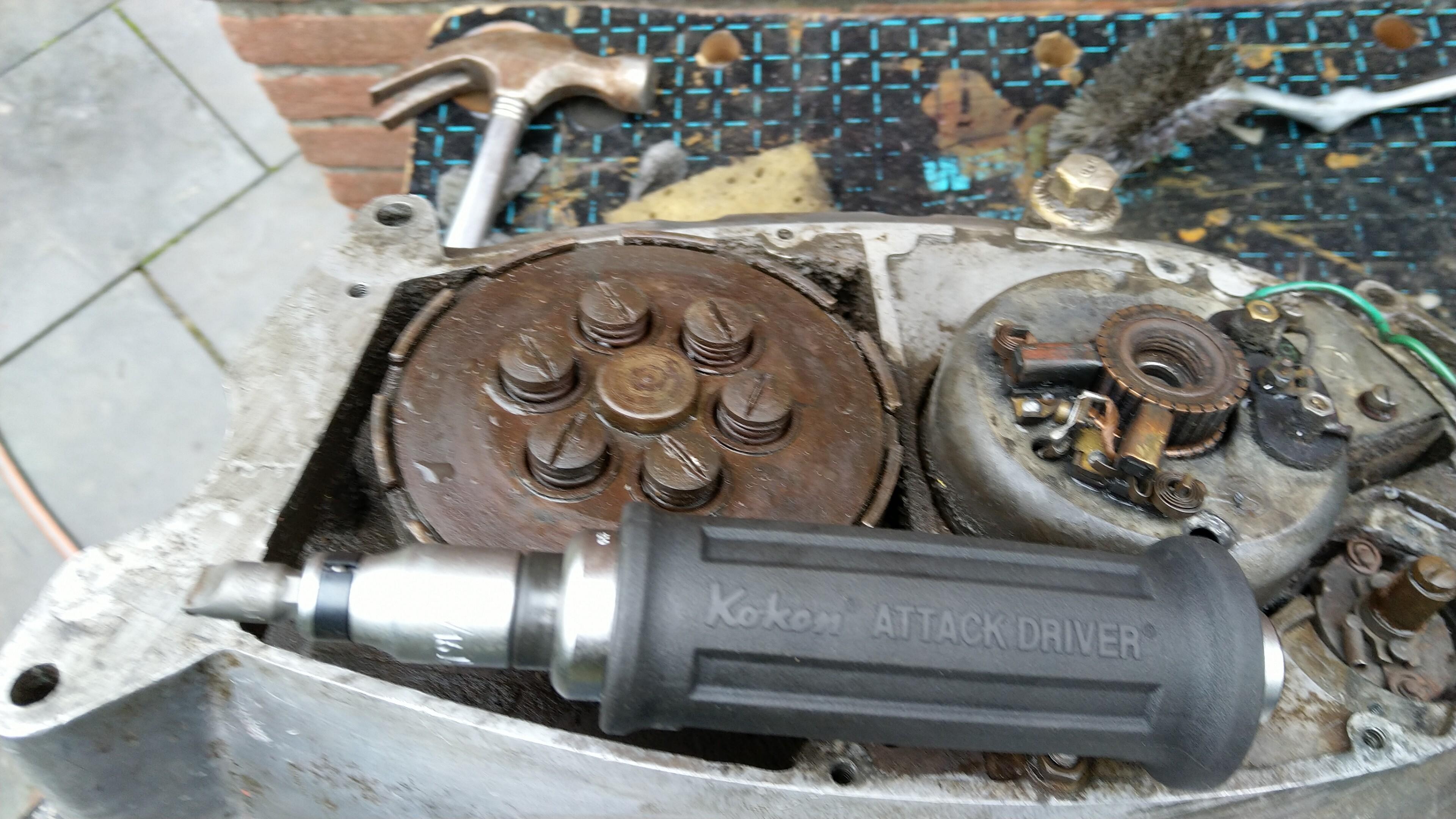

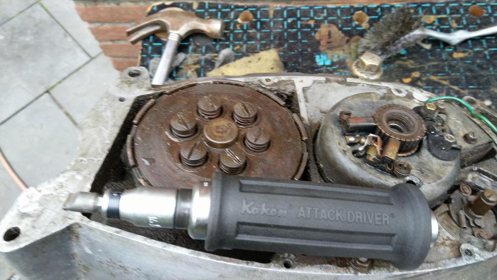

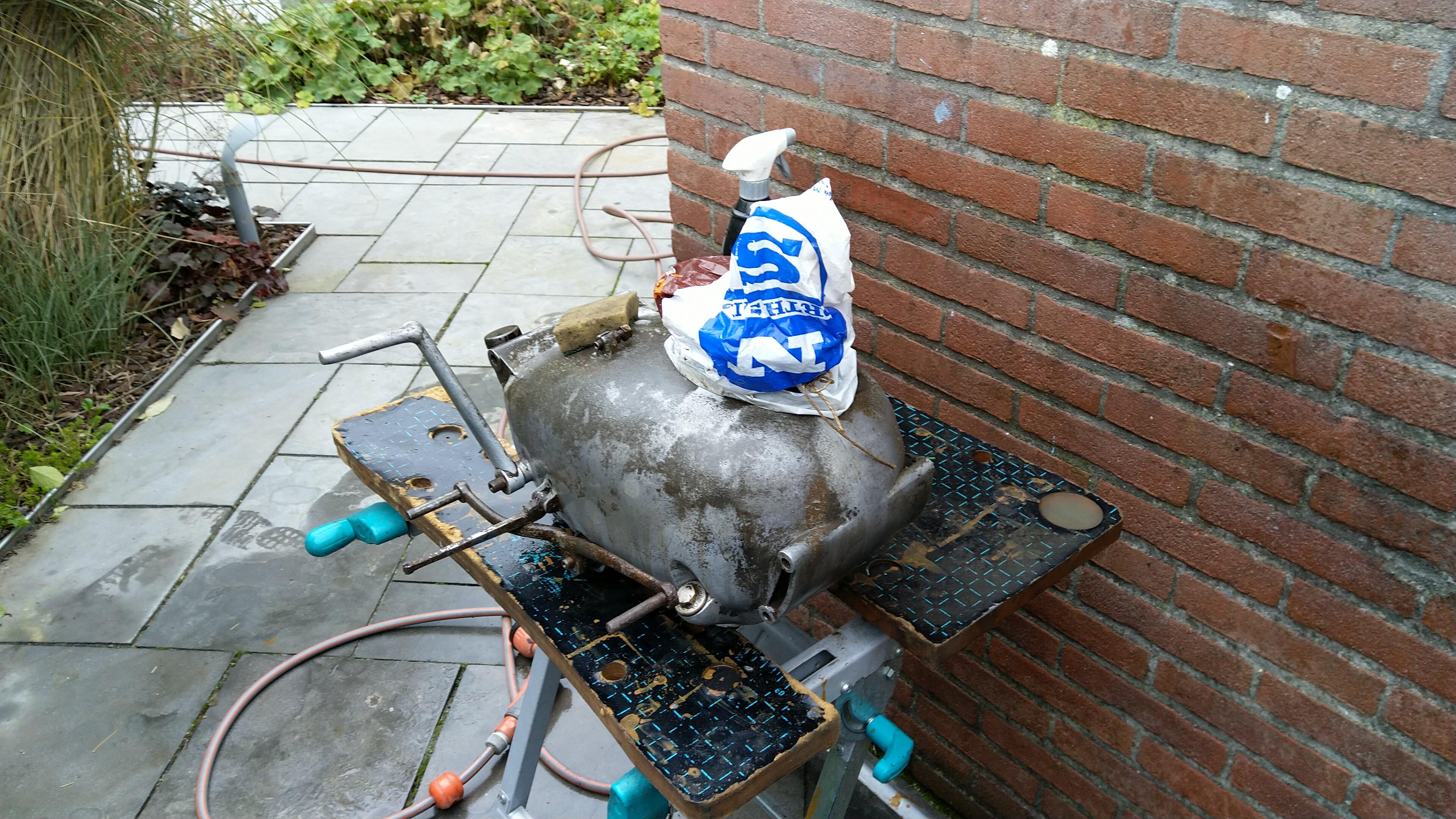

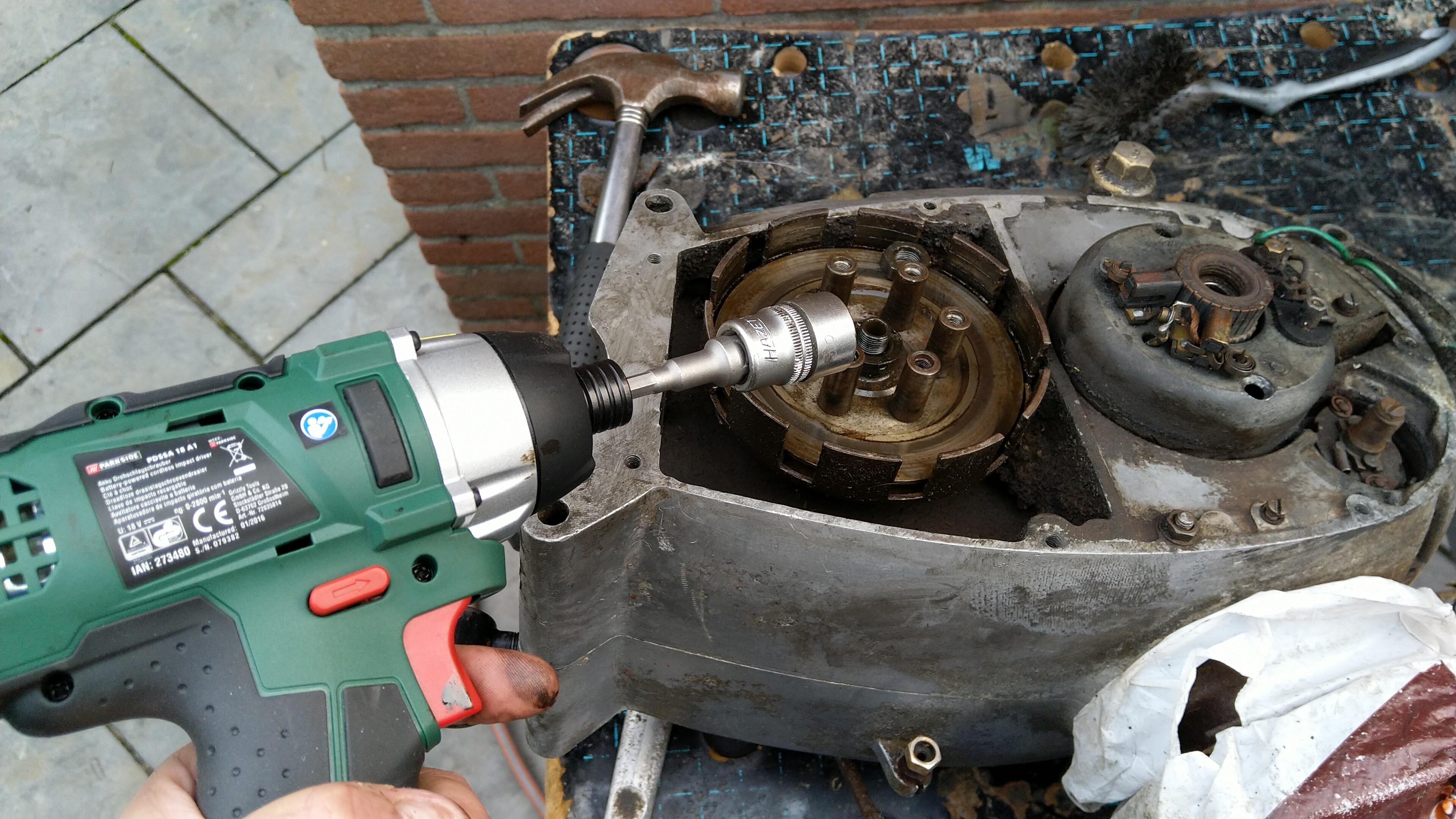

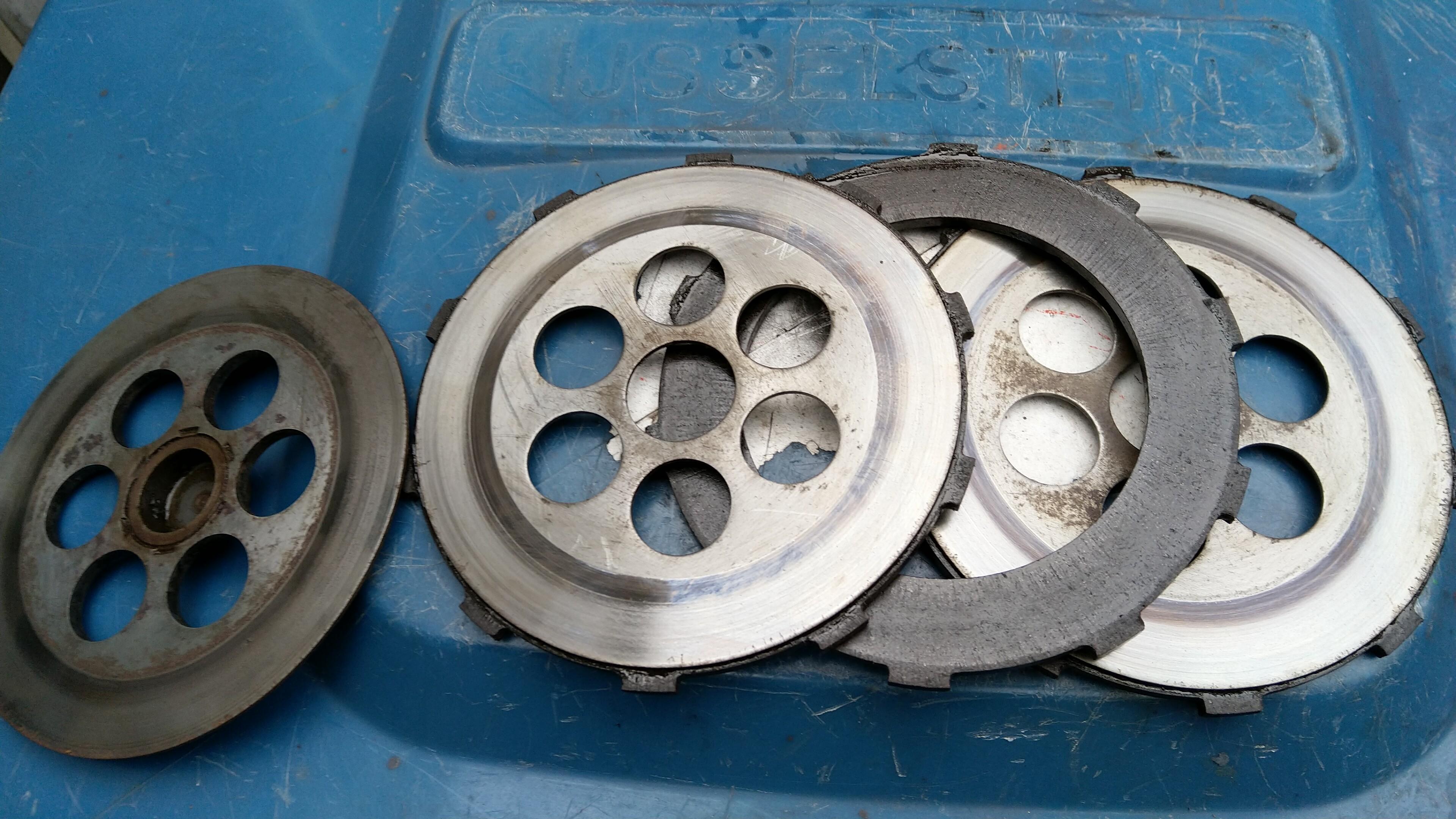

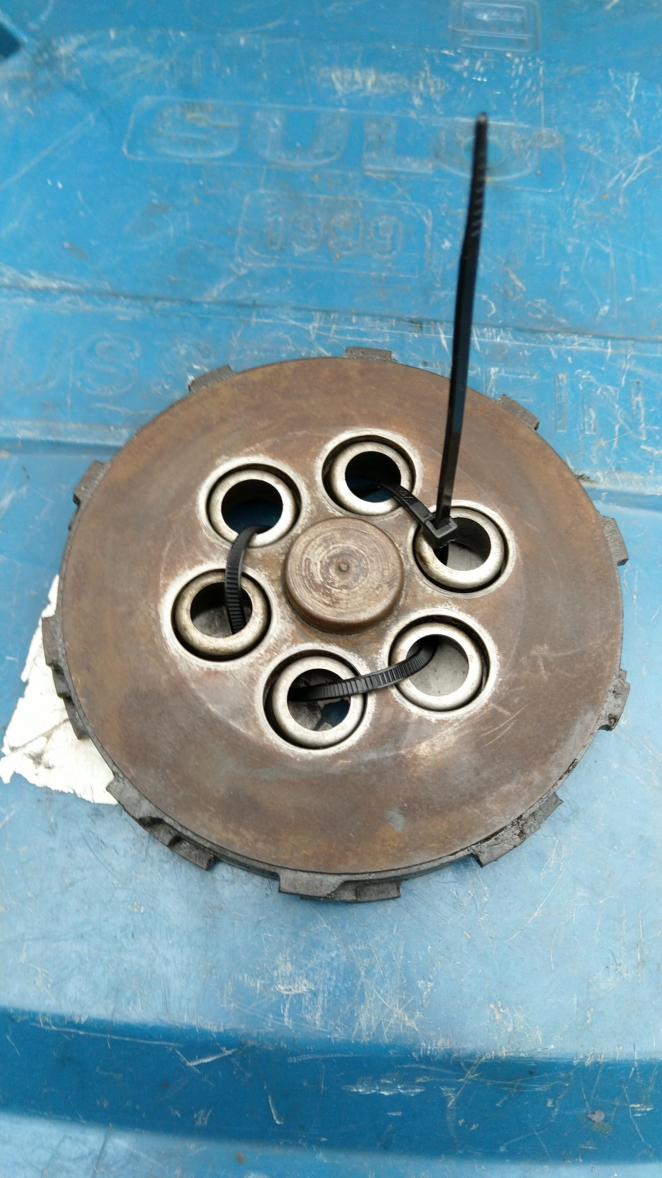

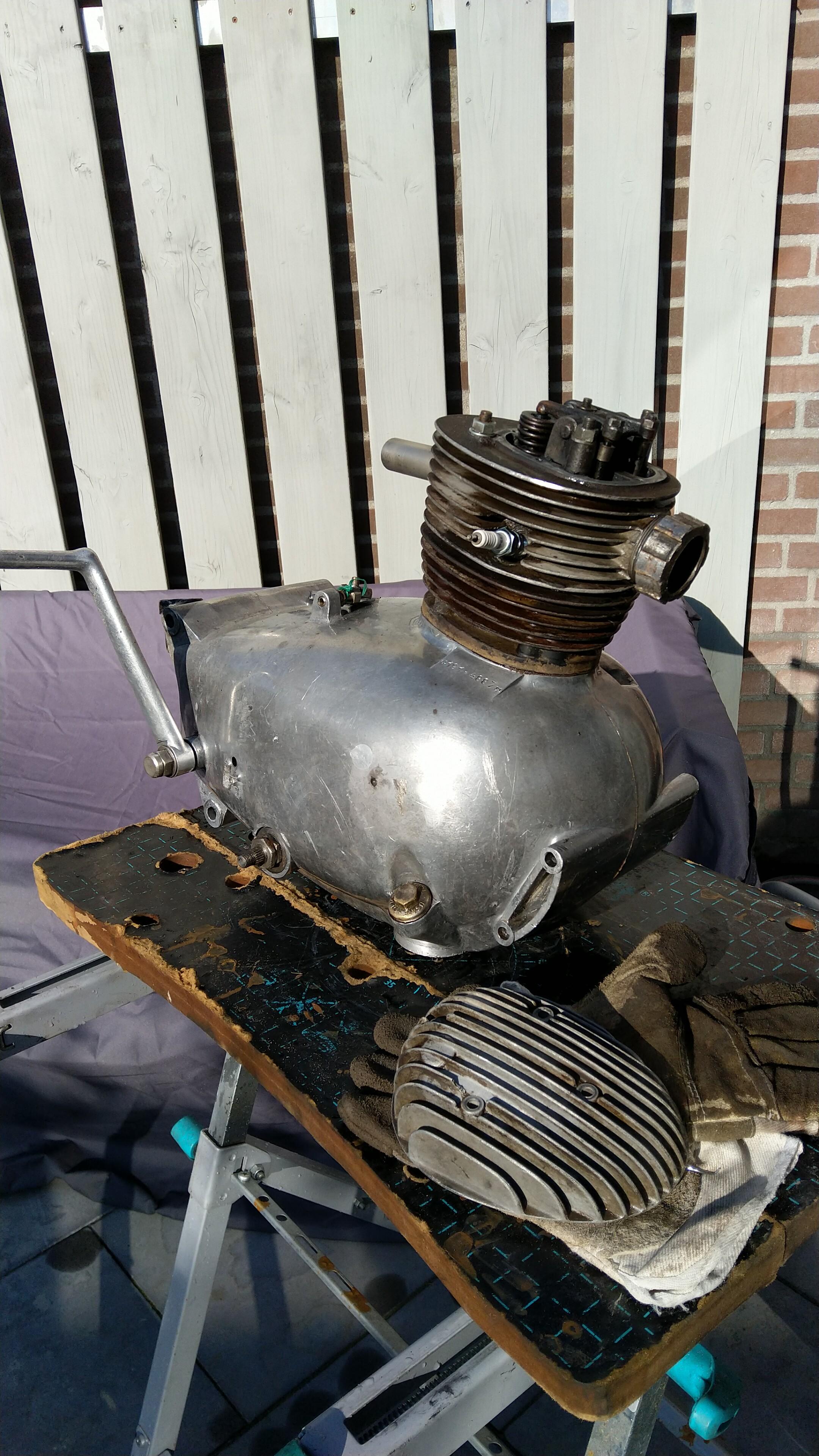

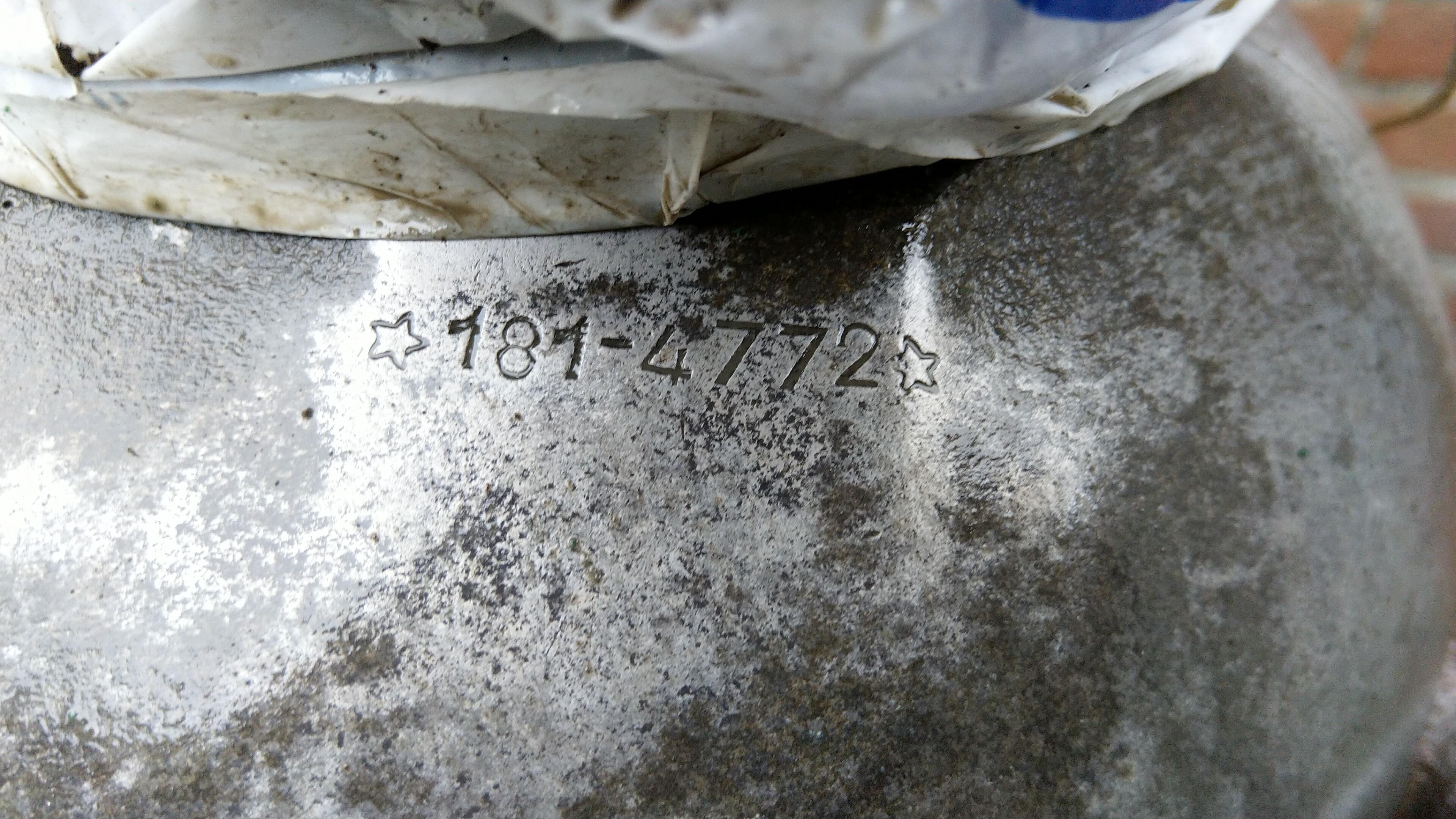

Member Contributer Dutchy Posted November 15, 2019 Author Member Contributer Posted November 15, 2019 Donor engine, really clarty... Time for some therapy (or penance? Fricking cold outside) Ah! There IS a # underneath 65 years of grime... That makes this a 150cc Sport 1st gen 😎 Easy with the right tool Store for later I give up for today, too bloody cold 😪 Quote

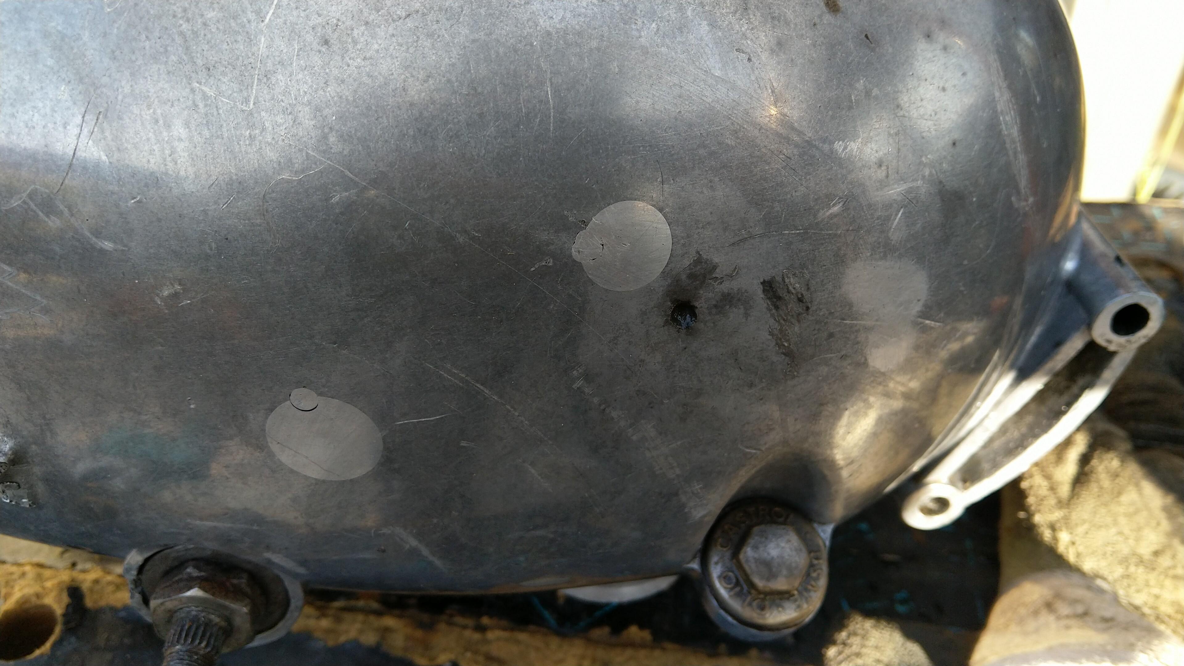

Member Contributer Dutchy Posted November 15, 2019 Author Member Contributer Posted November 15, 2019 Ok, one more... Quote
