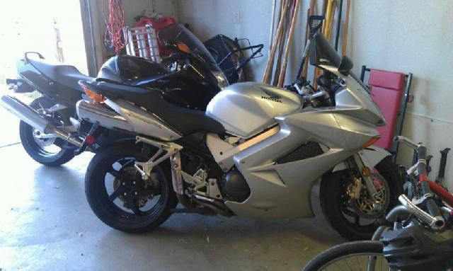

Member Contributer kebrider Posted August 21, 2012 Member Contributer Posted August 21, 2012 I will trade you my peg lowering blocks for the Blackbird in the picture (because I know where to get new ones). :) I go on record as the single best mod I ever did to my VFR is installing Busy Little Shop's peg lowering blocks. Makes the VFR all day comfy with my hateful knees. I compensated for the lost ground clearance by raising the rear and installing allen head bolts in place of the feelers. I had a 97 BB with a full erion kit. Most impressive motorcycle I have ever owned. I could touch a peg at 170 with zero drama. The bike defines high speed stability and it truly warps your sense of fast. KEB Quote
