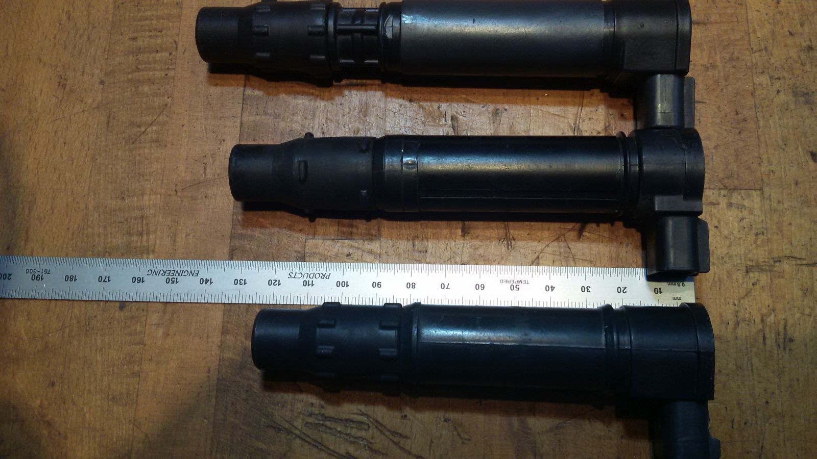

The Mitsu COPs (centre, below) are very similar to the Denso ones, but longer than the short Densos:

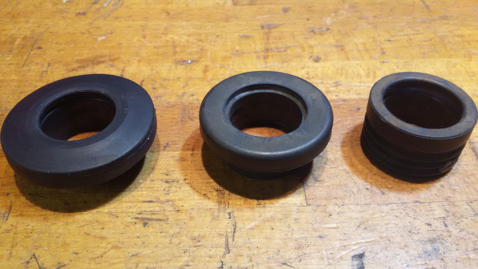

The Mitsu grommets (left, below) are larger than the big Denso grommets...
...but still don't really fit the RC36 valve cover holes properly:

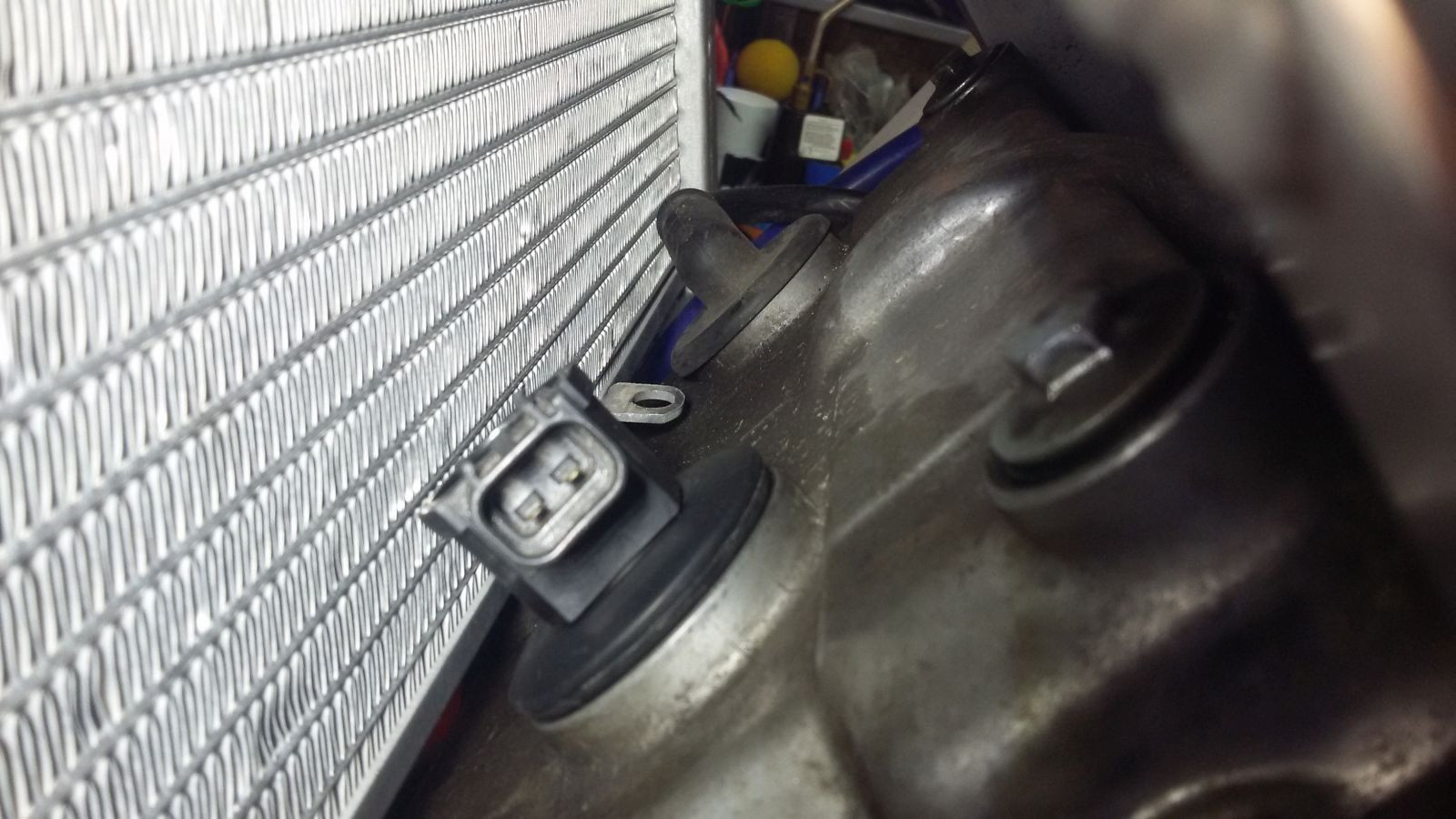

The photo above shows the Mitsu grommet crammed into the RC36 valve cover (on a short Denso COP), which sort of works, but without modification of the grommet the COP is actually not fully engaged with the threads on the top of the spark plug.  The grommet would need to be opened up to allow the COP to sit deeper within it.  Maybe the "new style" short Denso COP would fit better?  Hello, eBay...

...and goodbye, eBay.  The "new style" short Denso COPs are about the same length as the Mitsu COPs, so really aren't suitable for the RC36.  So, if I want to do this I'll need to buy three more short, old style Denso COPs and modify the Mitsu grommets or figure out some other way to seal the COPs.  Anyone want to buy a set of four, nice-condition, new style short Denso COPs?

As far as physical fitness goes, as mentioned in August, I did acquire a nice set of '08 CBR1000RR Denso 5150 COPs from eBay US (where they were "cheap, cheap, cheap", as Johnny, Mark, Denny and Peter might say), and these are just slightly shorter than the R6 Mitsus pictured above.  However, after some more fiddling around with them and the Mitsu grommets, I think I can use the 5150s after all.  They fit the spark plugs perfectly and appear to clear my radiator.
There are two obvious issues, however.  First, the Mitsu grommet ID is larger than the Denso COP OD, perhaps by 1-1.5mm, so the grommets don't really seal.  That could be addressed by wrapping the COPs with some sort of thin shim material, or even adhesive tape.  (Or maybe yet another use for large diameter polyolefin heat shrink tubing?  Yes, I like that idea.)  The other problem is that the grommet doesn't quite butt up against the head of the COP when crammed into the RC36 valve cover (as in the picture above), so in theory the grommet could work itself free of the valve cover unless it is somehow prevented from doing so.  To take up the space, I think I could just fit an appropriately sized o-ring.  Job done!

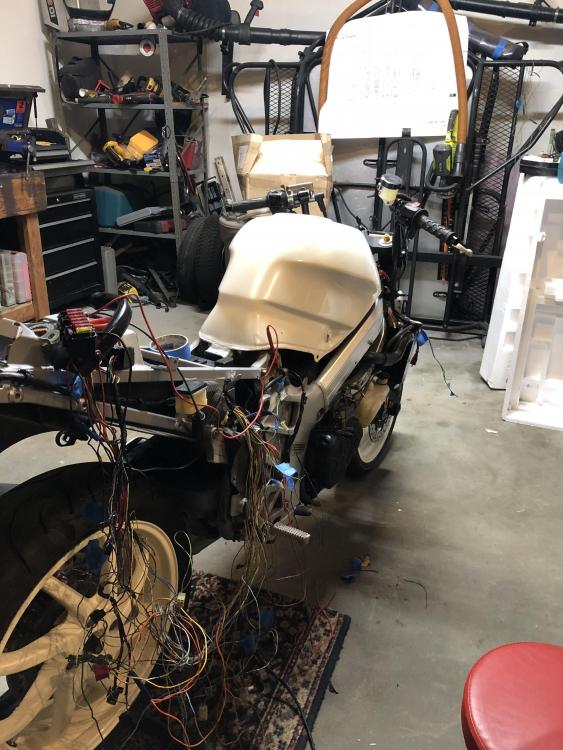

Will rewire the thing to relocate the fuse box and the headlight relay(s) under the seat, get it running, relocate the stock coils under the tank, get it running again, and than will get back to cops.
