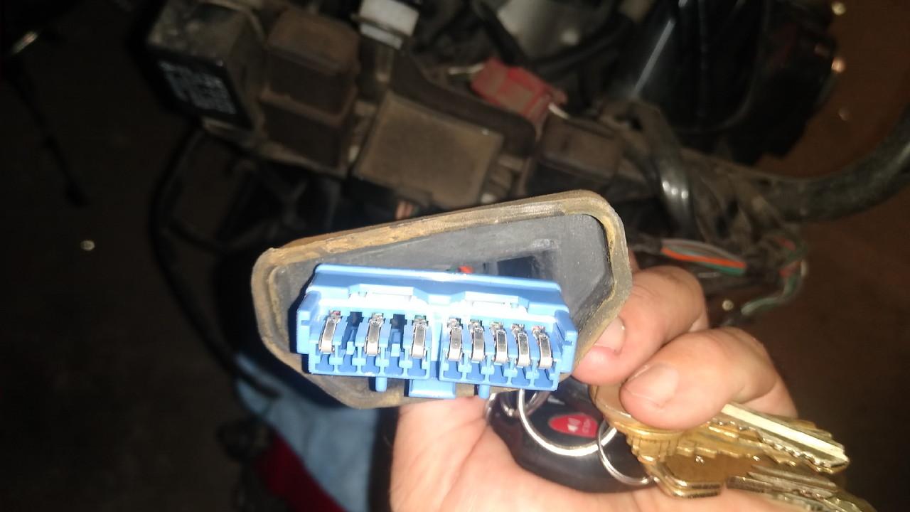

vfrgiving Posted September 17, 2023 Posted September 17, 2023 For oddball instrument cluster behavior my first try is pull the two connectors at the back and clean with contact cleaner. The plug interface Honda went with isn't the best. This requires removing the front cowl. 1 Quote

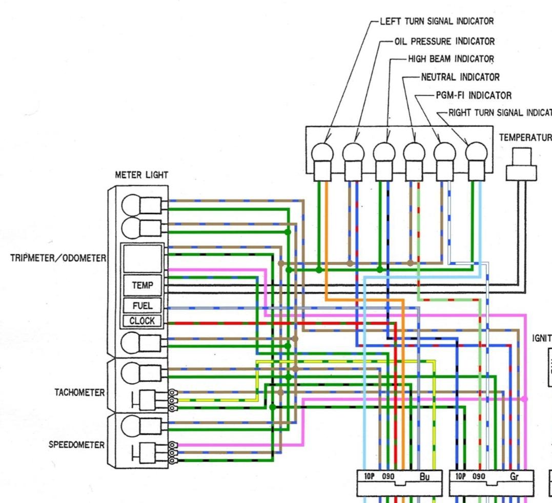

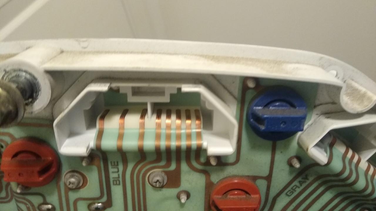

Member Contributer Grum Posted September 17, 2023 Member Contributer Posted September 17, 2023 And while you're doing as vfrgiving suggested. Both Tacho and Speedo share the same power source and ground source. So make sure at the mounting screws for both instruments you measure a good ground which goes back to the Green/Black wire, and 12v that goes back to the Brown/Blue wire and to Fuse G 10amp. Check for any corrosion on the PCB copper tracks. Refer partial drawing attached. Quote

vfrgiving Posted September 17, 2023 Posted September 17, 2023 Spray the connectors on the blue and gray plugs and the copper tracks in the plug cavities. I use Deoxit brand contact cleaner, but any electrical contact cleaner is fine. Just don't scrub those copper tracks with anything. Quote

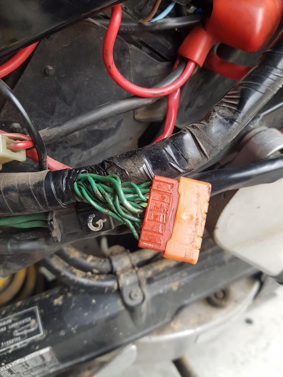

Member Contributer Grum Posted September 17, 2023 Member Contributer Posted September 17, 2023 And if all of the above doesn't work check the dreaded Orange Ground block, its the main cause of many strange Ground faults. Quote
Member Contributer Mohawk Posted September 17, 2023 Member Contributer Posted September 17, 2023 I'd just say to anyone out there with a 5th Gen to check the fairing below the headlight. There is a small infill panel that pops out to allow the parking bulb to be changed. It also pops out accidentally & then lets rain & spray in that corrodes the tracks on the dash circuit board. Just tape it up if you don't have the infill, its not visible so most people don't know its there ! ☹️ Quote
Member Contributer Mohawk Posted September 17, 2023 Member Contributer Posted September 17, 2023 52 minutes ago, Grum said: And if all of the above doesn't work check the dreaded Orange Ground block, its the main cause of many strange Ground faults. I checked this block on mine & on opening it & removing the bridge pieces it all looked great. When checking the cables entering the block green corrosion was apparent. So I cut all the cables off the block & half a dozen had bad surface corrosion. So I stripped them back, cleaned up the individual strands with abrasive & intertwined & soldered all together then sealed with amalgamating over wrap. All my weird issues went away 👍 If you do this I would advise adding an additional thick ground wire to the bundle & run it direct to the battery negative terminal. Quote

Member Contributer JZH Posted September 18, 2023 Member Contributer Posted September 18, 2023 On 9/17/2023 at 3:19 PM, Mohawk said: I checked this block on mine & on opening it & removing the bridge pieces it all looked great. When checking the cables entering the block green corrosion was apparent. So I cut all the cables off the block & half a dozen had bad surface corrosion. So I stripped them back, cleaned up the individual strands with abrasive & intertwined & soldered all together then sealed with amalgamating over wrap. All my weird issues went away 👍 If you do this I would advise adding an additional thick ground wire to the bundle & run it direct to the battery negative terminal. I did exactly the same on my yellow bike. However, having since gone down the "motorsports wiring" rabbit hole, instead of soldering I would bunch them all together and apply a massive brass crimp (maybe a Sealey 16mm2 or 25mm2 ring terminal with the ring part cut off), crimped using a Draper battery terminal crimping tool (the kind you slam with a sledge hammer), followed by adhesive-lined heat shrink with the end pinched off. The ground wire can be used with that method as well. Ciao, JZH 1 Quote
Member Contributer Bren Posted September 19, 2023 Member Contributer Posted September 19, 2023 I think I read once that those ground wires should be joined together into 2 groups as that's how they are in that orange block? I've never had to do this, yet, but probably will one day so I'd like to be prepared. Quote
