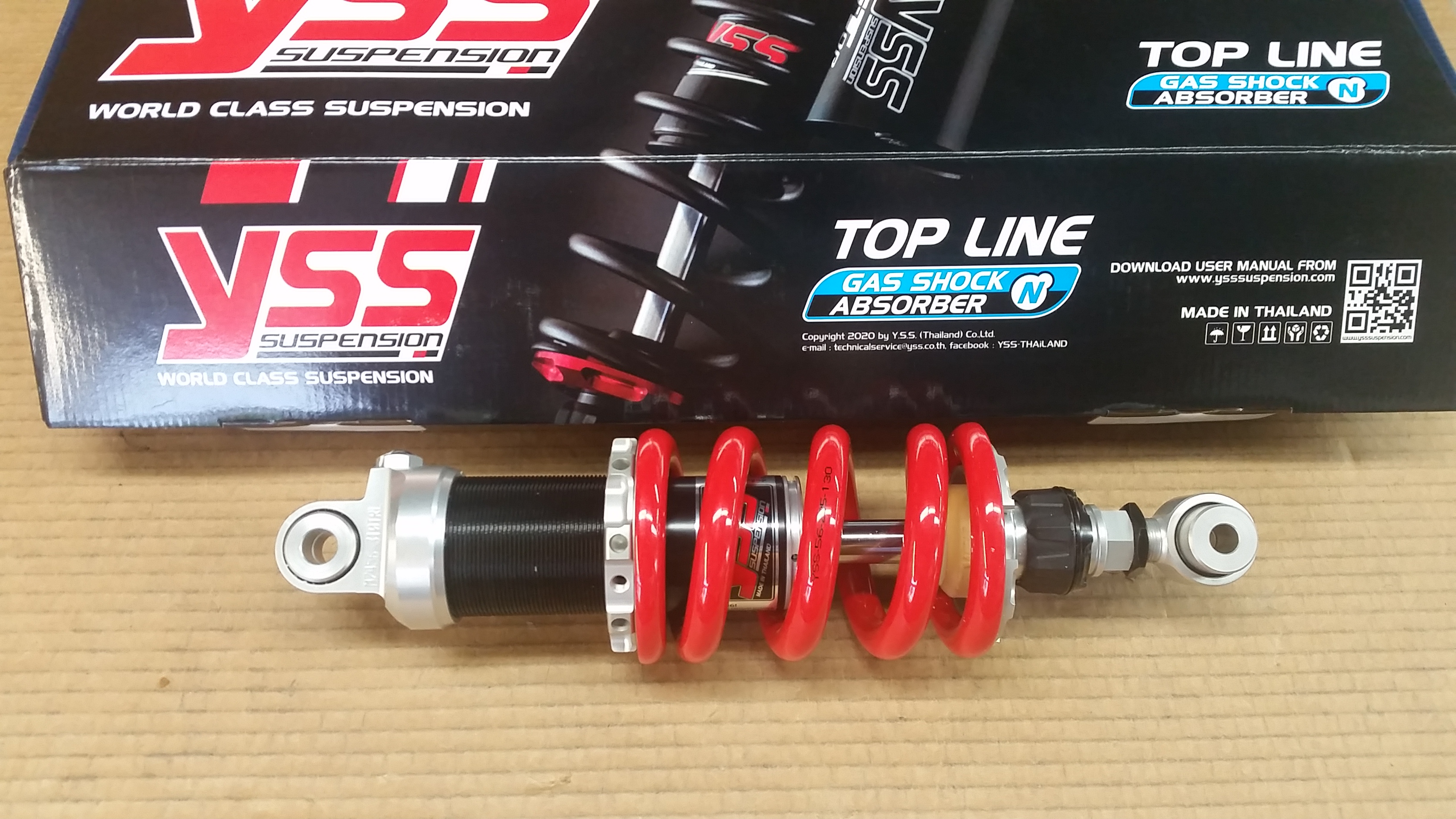

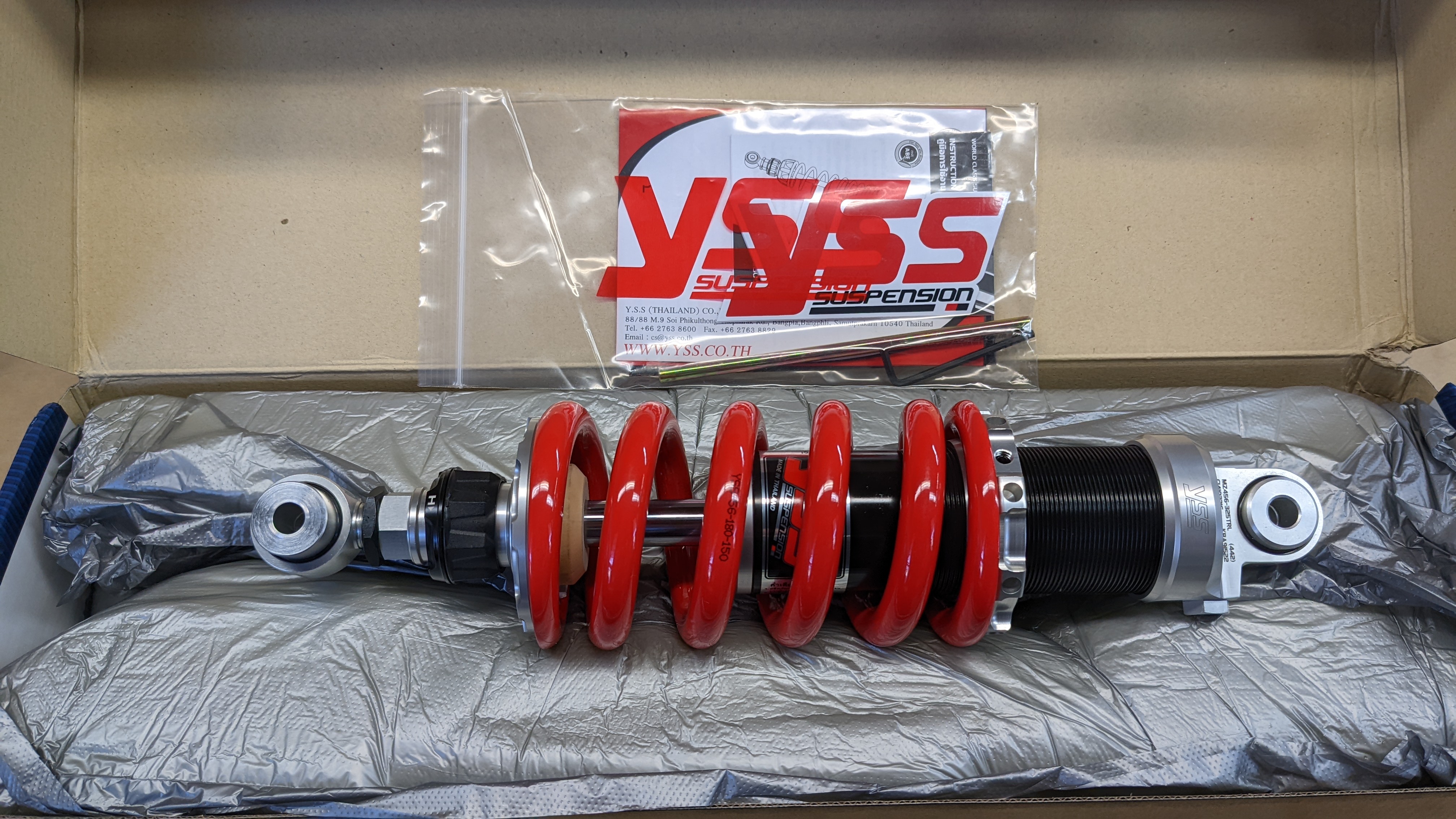

Maccers Posted November 16, 2022 Posted November 16, 2022 Hi all, working my way round the bike. Installing Black Widow headers and YSS rear shock. Got all the bits in, headers came away really easily. The YSS shock, the bottom connection to the triangle plates. The old original Showa shock has a sleeve and roller bearing. The new shock does not, just an alloy insert. I looked at other brands, Nitron for example, and they also dont seem to have any bearing/sleeve just an alloy insert. The bolt fits perfectly. Is this correct ie no roller bearing or I need to remove what YSS put in there and fit original Honda bearing/sleeve/seal? Quote

Member Contributer Captain 80s Posted November 16, 2022 Member Contributer Posted November 16, 2022 Run it. And yes, someone added some rear ride height to try and liven it up a bit. Pretty common mod. 1 Quote
Maccers Posted November 16, 2022 Author Posted November 16, 2022 Cheers for that. So just use the new YSS shock as is, bolt through the bottom with no bearing etc? Quote
Member Contributer Captain 80s Posted November 16, 2022 Member Contributer Posted November 16, 2022 32 minutes ago, Maccers said: Cheers for that. So just use the new YSS shock as is, bolt through the bottom with no bearing etc? That's what I have done 5 times now. Didn't end up in a ditch. 1 Quote

Member Contributer Captain 80s Posted November 16, 2022 Member Contributer Posted November 16, 2022 I think they are a great value. I have them on: 1984 VF1000F 1986 VF1000R 1988 NT650 Hawk 1995 VFR750F 1998 ST1100 Soon one for a 1989 CB-1. Rebound damping adjustment, separate ride height adjustment, threaded pre-load collar. The spring rates that come on them are good, if a touch on the stiffer side, which I like. They have transformed all of the above bikes. And they are good looking if you have a bike that you can see the shock. If you buy from biketyresuk on eBay you can swap out the spring fo your choice for a up charge. I don't think it's terrible. They are also the eBay store for the UK YSS R&D center (FireFox Racing), so you are getting good support. They have answered my emails quickly and politely when I have inquired about length or application questions. Fully rebuildable too. 3 1 Quote
Maccers Posted November 17, 2022 Author Posted November 17, 2022 18 hours ago, Captain 80s said: That's what I have done 5 times now. Didn't end up in a ditch. Thanks for that, will do. I got mine from WeMoto, I was getting some other bits there and they came up as a reseller on the YSS site. I must say it does feel and look great. Feel as in out the box, solid kit. Not yet on bike so cant say how it feels when riding. It must be better than the 23 year old one thats was on there! Quote
