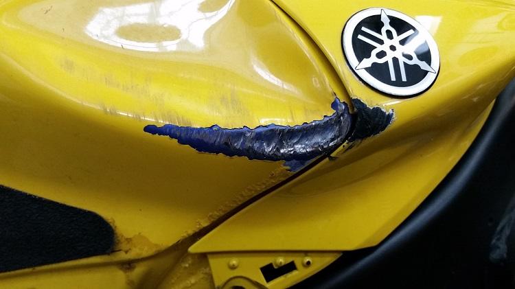

Member Contributer tbzep Posted January 27, 2022 Member Contributer Posted January 27, 2022 1 hour ago, DesertKyorugi said: Yes, the pivot shaft is badly corroded and does not provide a seal even with a rebuild kit. I guess last resort I can try to JB Weld the shaft and grind it back into shape but how long will take work with gas? There have been thousands of cager fuel tanks permanently repaired with JB Weld. The shaft is a moving part so it won't be permanent, but if you can get it shaped well enough to seal, it will last a while, especially if you aren't turning it on and off all the time or having to hit reserve a lot. I never turned my little 500 Interceptor off except when I parked it in my apartment bedroom for Christmas break one year, but I did have to hit reserve pretty often. lol 1 Quote

Member Contributer bmart Posted January 27, 2022 Member Contributer Posted January 27, 2022 20 minutes ago, tbzep said: There have been thousands of cager fuel tanks permanently repaired with JB Weld. JB Weld is right up there with PB Blaster and E6000, and it is impervious to fuel. Cheapo track repair on creased tank w/out leaks. I'd get that NOS tank on teh way...packed properly and insured. Quote
