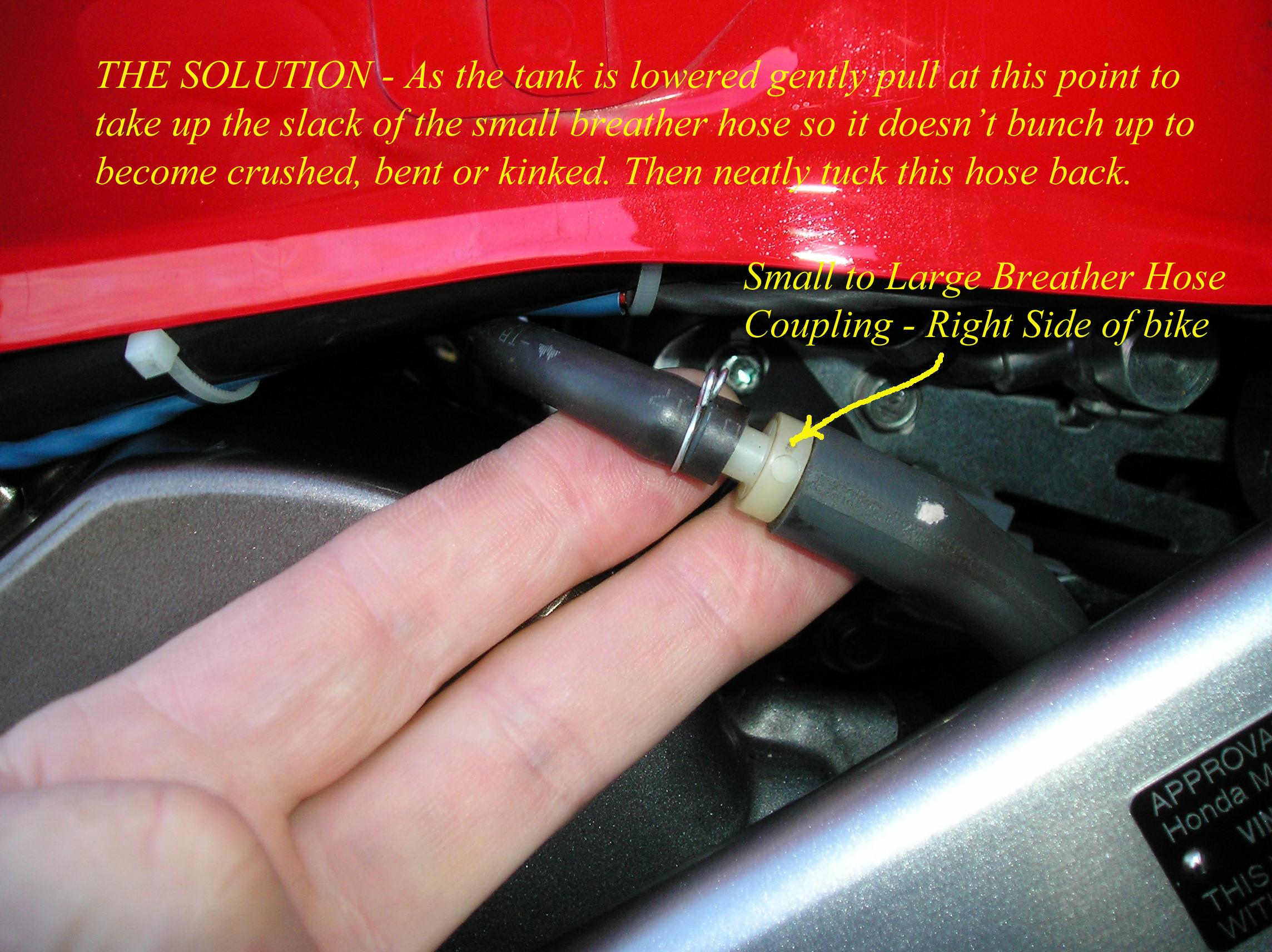

Blocked, Kinked or crushed Breather Hose = DANGER!
The problem with the 8gen is the first 12 inches or so of small diameter breather hose. When the Fuel Tank is raised to the maintenance position, the hose is pulled up through a lot of piping and general clutter in this area. If this hose is not manually pulled outwards at the small to large hose coupling taking up the slack as the tank is lowered, you run the chance of a blocked kinked breather hose. See photo.
The nasty effects of a blocked breather cannot be overstated on these bikes!
- Strong Vacuum, can make it impossible to open your filler cap. The Fuel Pump has enough strength in increasing the vacuum while riding to physically damaging your tank, bending the sides inwards.
- Whilst having the bike in the sun strong positive pressure can distort the underneath of the tank deforming it outwards. Or virtually blasting the filler cap open as you unlock it.
Any signs of strong pressures, negative or positive when opening the filler cap is a warning to check the breather hose.
